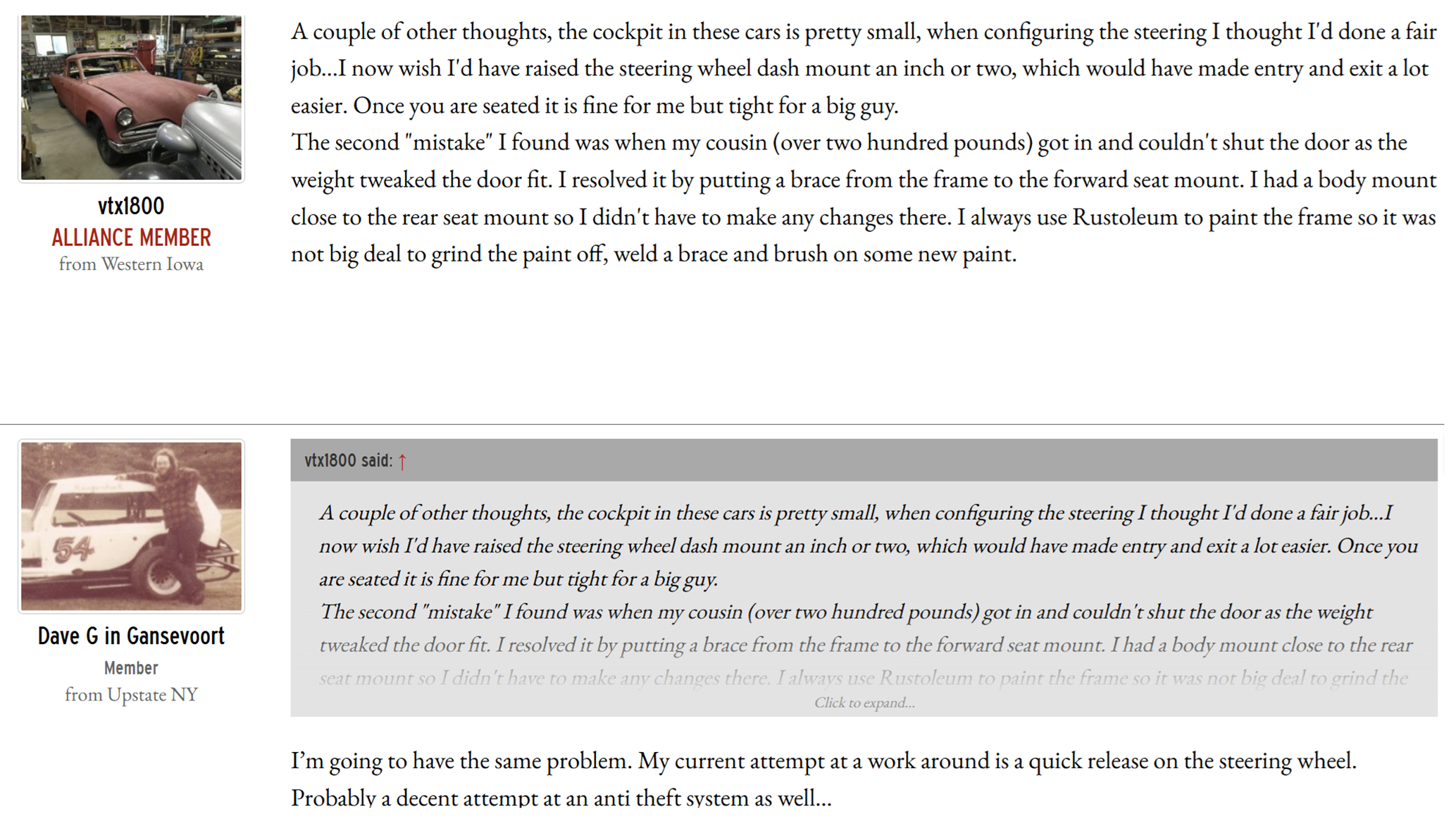

    A couple of other thoughts, the ****pit in these cars is pretty small, when configuring the steering I thought I'd done a fair job...I now wish I'd have raised the steering wheel dash mount an inch or two, which would have made entry and exit a lot easier. Once you are seated it is fine for me but tight for a big guy.
    The second "mistake" I found was when my cousin (over two hundred pounds) got in and couldn't shut the door as the weight tweaked the door fit. I resolved it by putting a brace from the frame to the forward seat mount. I had a body mount close to the rear seat mount so I didn't have to make any changes there. I always use Rustoleum to paint the frame so it was not big deal to grind the paint off, weld a brace and brush on some new paint.

    I’m going to have the same problem. My current attempt at a work around is a quick release on the steering wheel. Probably a decent attempt at an anti theft system as well…

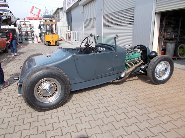

    “I remember seeing a T roadster with a steering wheel that flipped up. Someone called it a Fat Man Wheel.”
    Hello,
    A long time ago, I took some photos of a cool T-Bucket. The seating arrangement was typical T-Bucket… almost non existent. But, the T-Roadster was an outstanding build. I sat in the driver’s seat and it was tight. I am 6 feet with big shoulders. I managed to squeeze in the seat and felt comfortable behind the wheel. It was not my cup of tea, but I would drive it… as @anthonymyrick would say.
    I felt much better sitting on the p***enger side when we went for a ride. The acceleration was almost instant with the slight touch of the throttle. An open roadster feel was evident and the wind blasted us as we went down the street and back.
    Jnaki

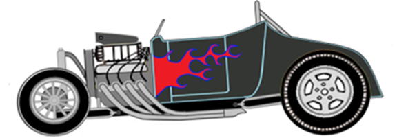

    A few months ago, I drew this version of a 27 T-Roadster with early claw flames for a Friday Art thread. . I got the idea from several old drag racing photos showing one of the earliest actual “claw” flames known to the hot rodding world.
