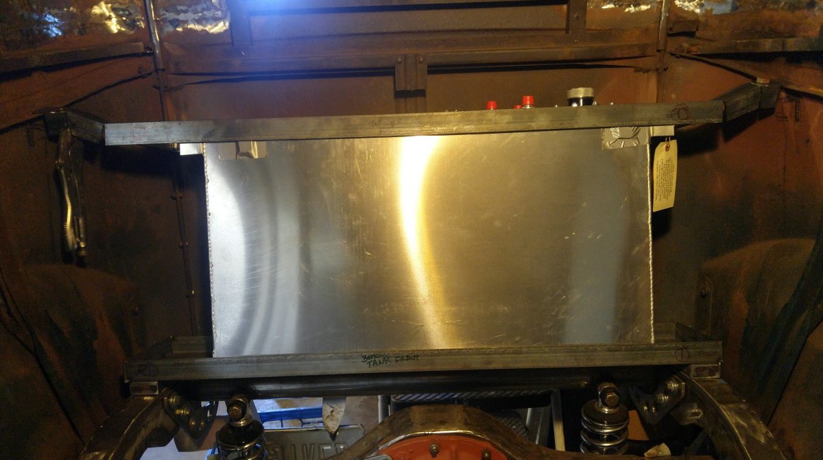

    Give serious thought to where you want the gas tank:
    1) Stock cowl tank: Convenient, but a serious fire hazard and limits your wiring and gauge options.
    2) Dual saddle tanks between the frame rails and running boards: H***le to fill unless you have a crossover fuel line.
    3) Deuce tank: common, but IMO, looks like a baby with a full diaper.
    4) Vertical tank behind the back seat: Best option IMO, but consumes some back seat space.
    I planned for my kids to ride in back of my '28 sedan, so chose #4, using four stock Tudor front bucket seats with a bulkhead separating the tank from them. It's a highboy, so #2 wasn't an option.
    Here are some construction pics. Hope this helps.

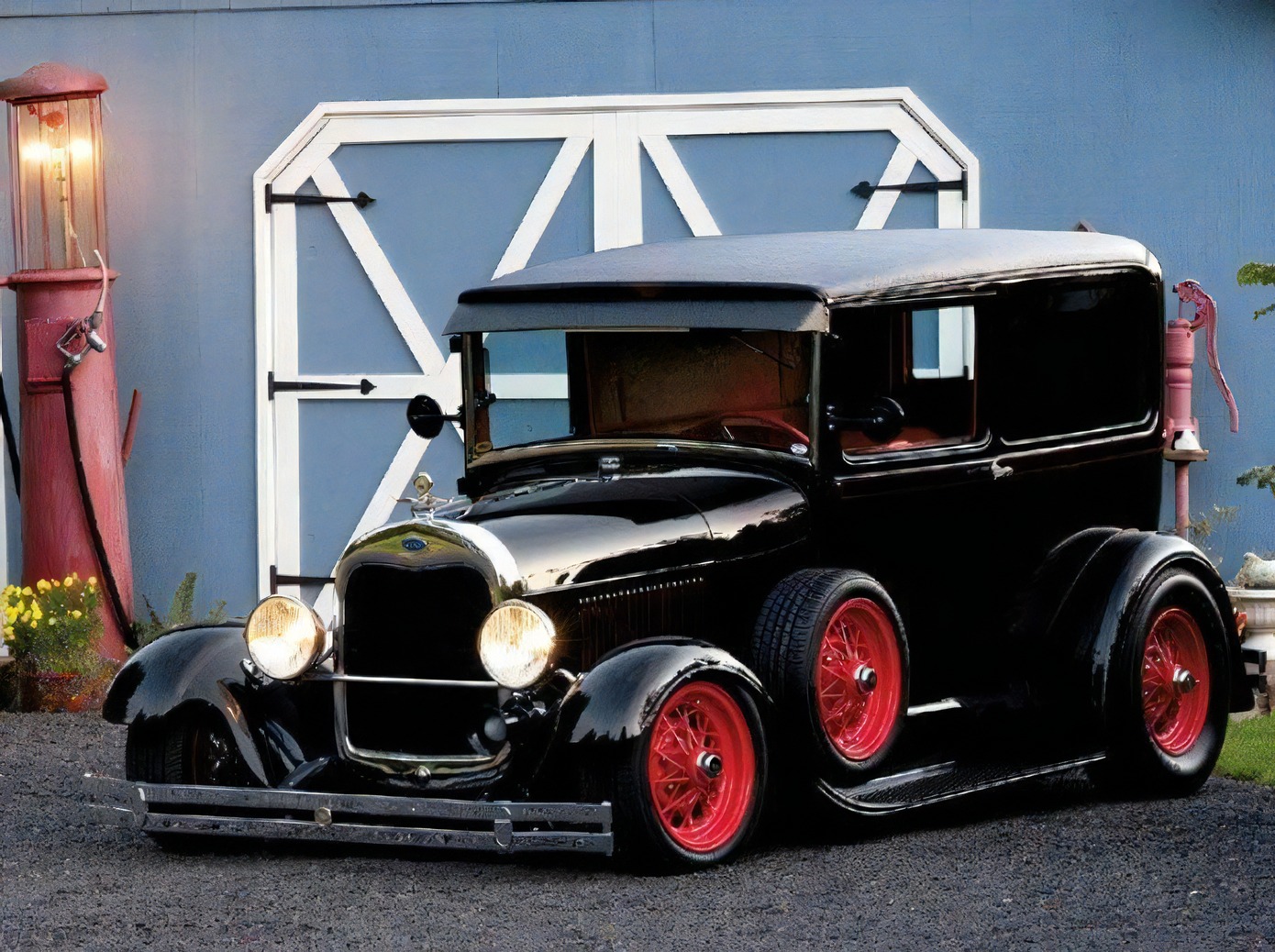

    Build a banger. It will be far cheaper to put a cam, head and pair of Strombergs on it than a whole drivetrain swap that will also require beefing up the frame. Add juice brakes and a dropped axle. Use a quick change if you have the $ and a T5 overdrive. Get Jim Brierley's book on building the A & B engines. Work towards 100 hp. That along with the T5 will let you keep up with traffic. And don't forget chop 2-3" out of the window height. You can use a reverse eye spring at the back or lose a leaf or two. That works at the front too but if you're going to get a dropped axle it's redundant.
    I'm ***uming the green car in post 2 is what you are shooting for?
