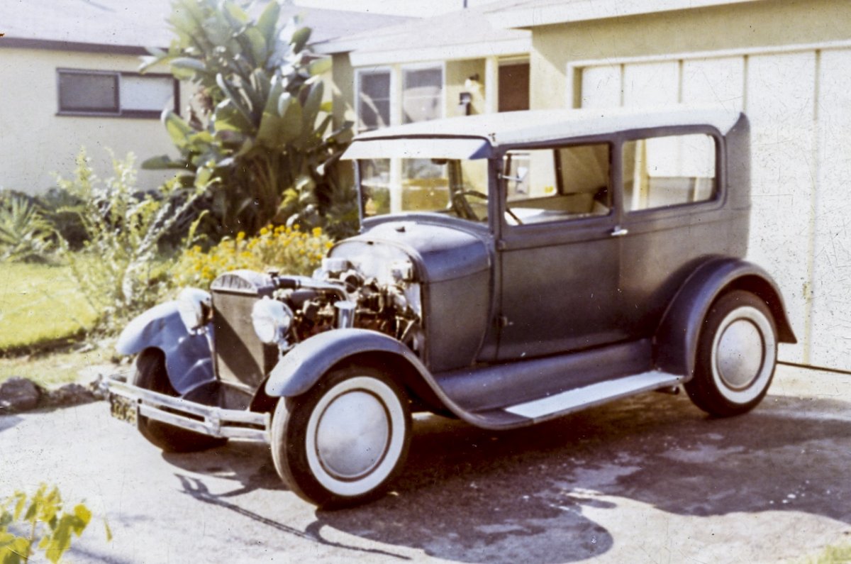

  7. Forged I-Beam Split Wishbone Front End Kit please tell me thats a good one
  8. alchemy
    Joined: Sep 27, 2002
    Posts: 23,471
    alchemy
    Much better, but you can’t tell the width of the axle. I think a 46” axle looks best in a full fendered A. Especially if you get it real low so the tires tuck up into the fenders like the dark green example you posted.

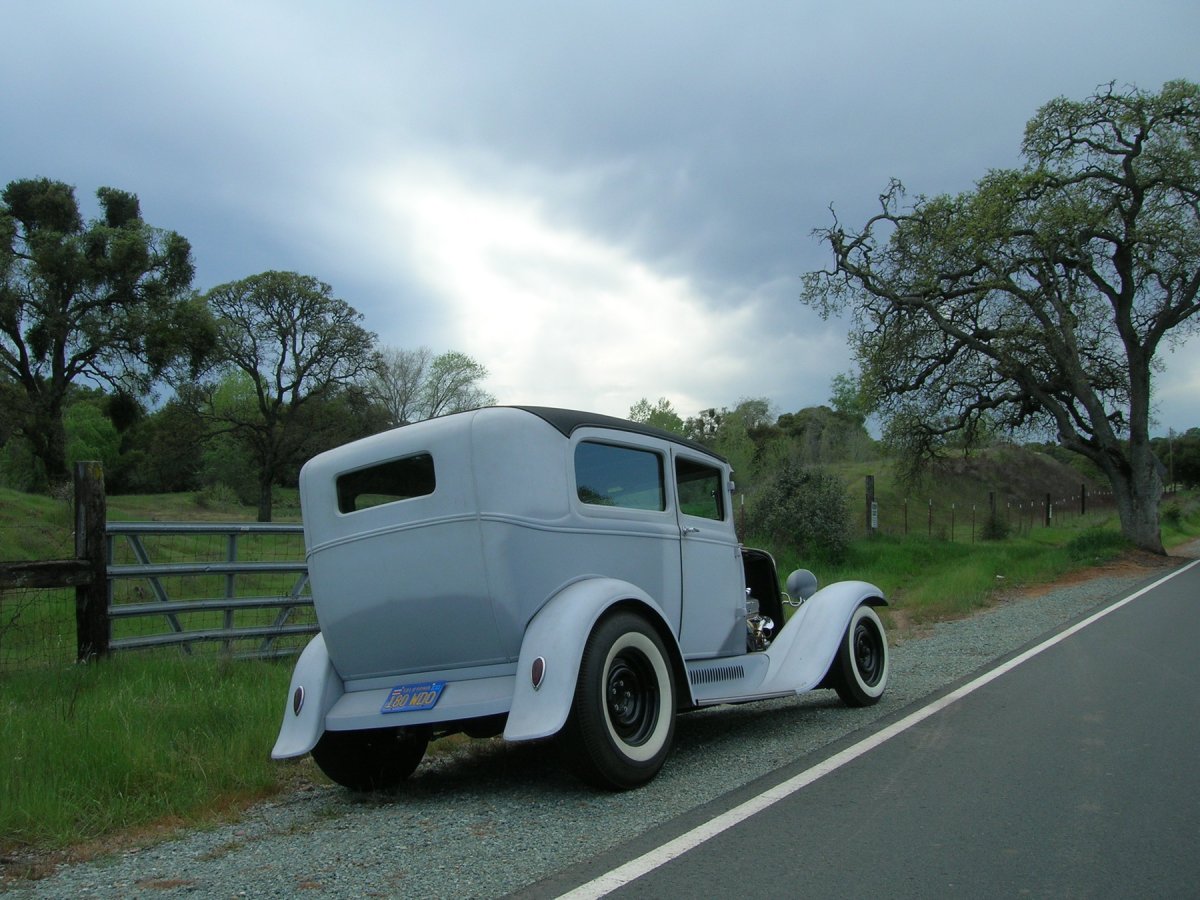

  9. I pulled my fenders, running boards and aprons off this evening, the aprons had quite abit of rot i couldn't really see when they was on the car, but just like those old gear heads decades ago, as soon as I stood back and looked at it with no fender, I was like wow, now its looking like a hot rod lol, So i may ditch the fenders, Verdicts still out
  10. alchemy
    Posts: 23,471
    alchemy
    Still buy a 46” axle.
    Just Gary likes this.

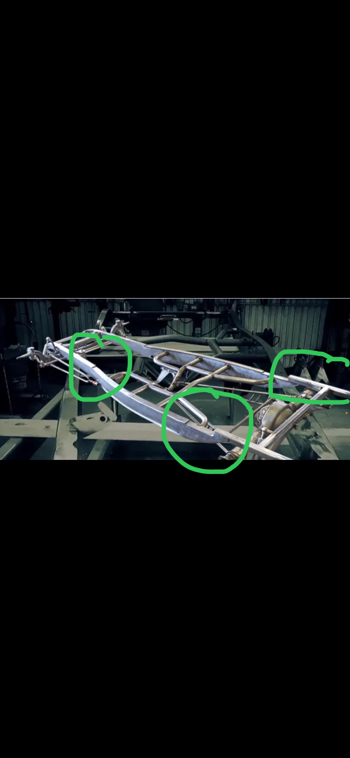

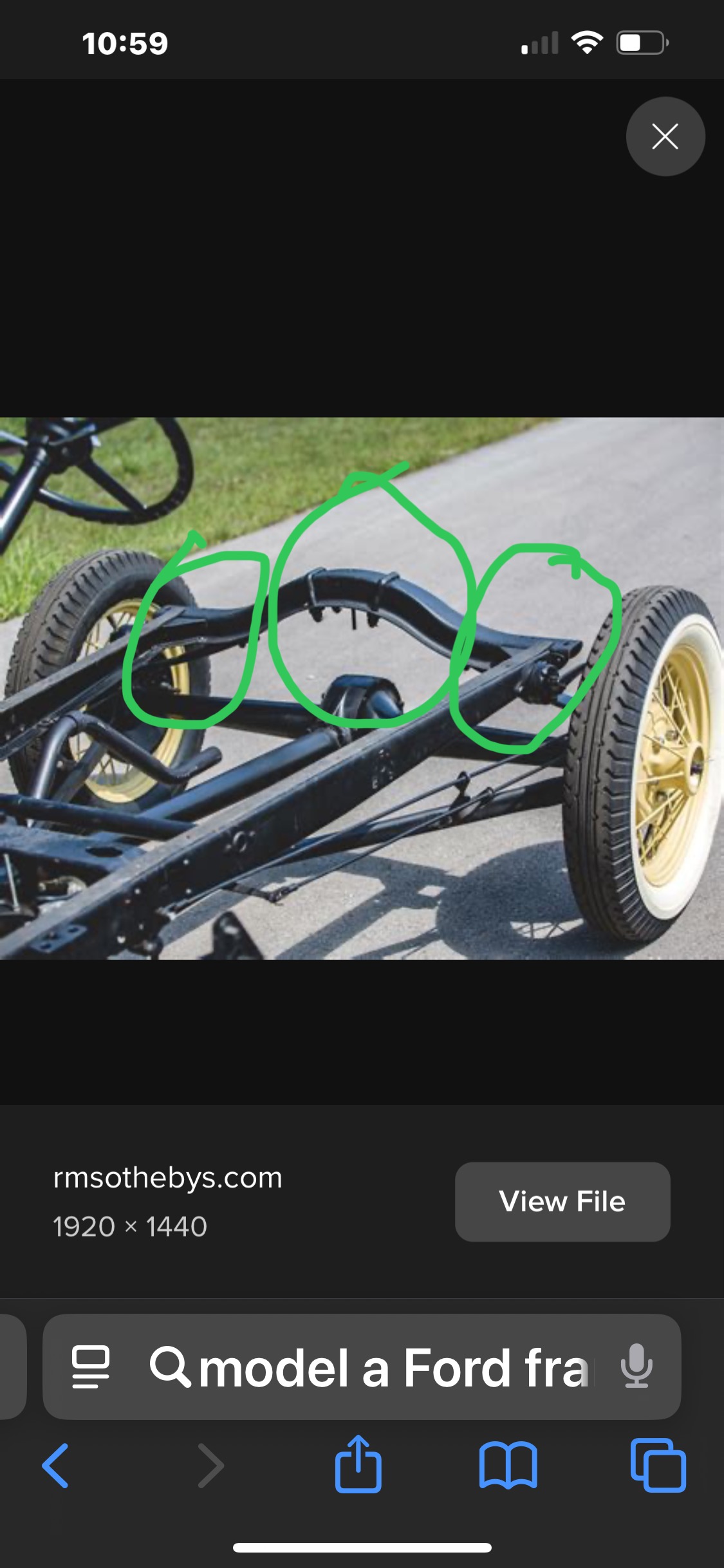

    On Rear cross member
    To get to set lower , more then 1-1/2 from stock , thought needs to be taken , part of rear crossmember is also
    rear body mounts
    On model A frame
    Also need to think where you going go mount Battery,
    & A frame is Narrow run's directly down the center of the front seats planning mounts and transmission is critical in mock up you run out of a lot of space you might see some other 28 to 31 they are on 32 frames which is a lot wider and follows the body shape without fenders and running boards.
    If your seats have the factory flip up hinge seats save those parts hard to find.
    If removing front seat You need narrow I believe it's 40ish inches from door-to-door on the inside, & tall like me I had to move front seat back 6 inches from stock , I am 6 ft tall , pedles also if you have big feet

    Still there's an issue with the stock frame thought needs to be taken ,
    I did things different I notched axle tube's so I could use stock crossmember.
    Most would not do this mold
    Look @ both pic of frame you will see difference in the rear stock versus hotrod
    In the picture I posted earlier was my A I dayley drove and drag race with stock frame with the engine north of 650hp
    100mph in 1/8

    '26/'27 T rear cross member lowers the car by 1.5" and is a direct fit for the stock Model A rear crossmember.

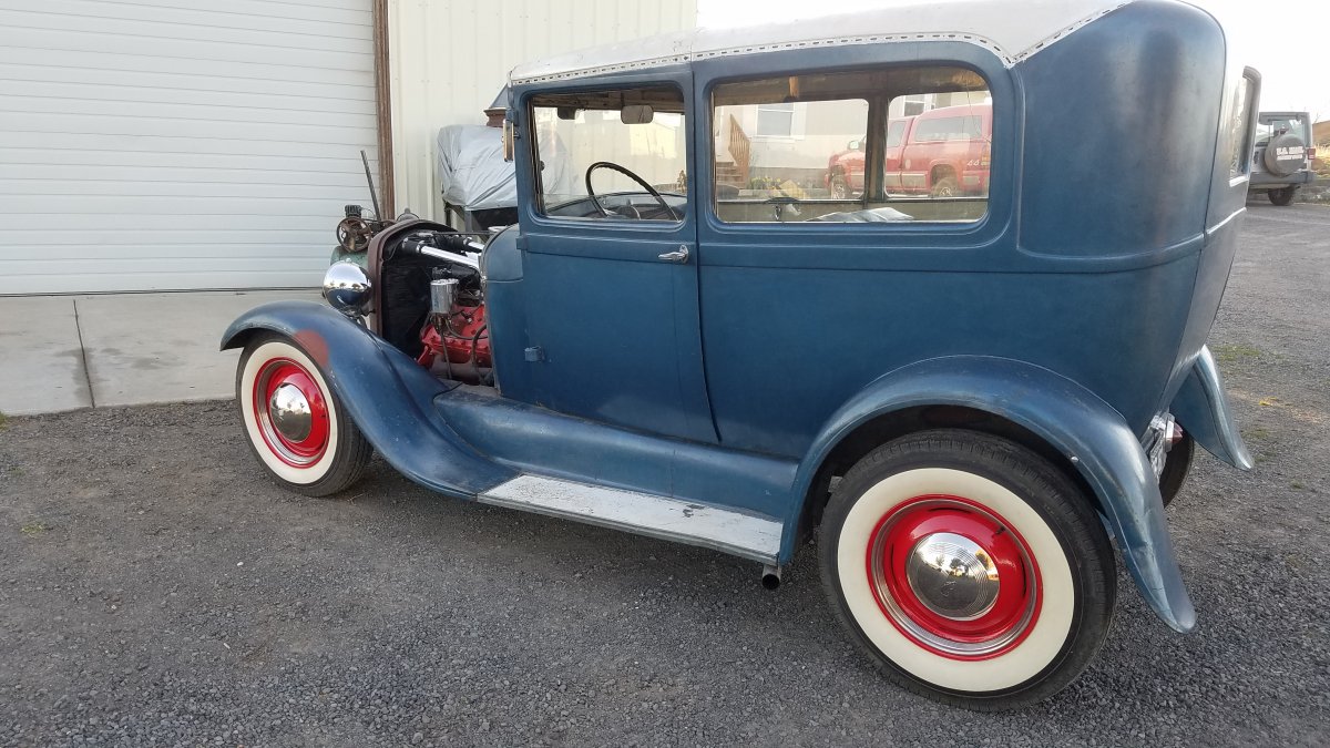

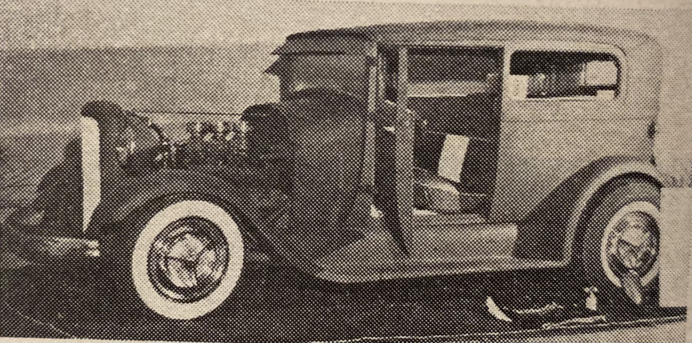

  18. after taking the fenders off, i think ill leave them off for good, which bring us to our next adventure, putting this car on 32 frame rails

    IMG_1631.jpeg I used a 47 inch forged with 145/15 front tires and there’s no rub.

    Not what you asked for, but… I vote for full fendered all day long. I mean, since you already have all the stuff. Model A sedans just looks so great with their traditional fenders left mounted.
    And with all that said, I’m gonna head away and work on my non-fendered tudor sedan…which I kinda wish it wasn’t…!
  22. They look good both ways, im still not completely sure which direction im going, I have a customers 32 tudor here doing the upholstery in it and I love the stance it has with no fenders

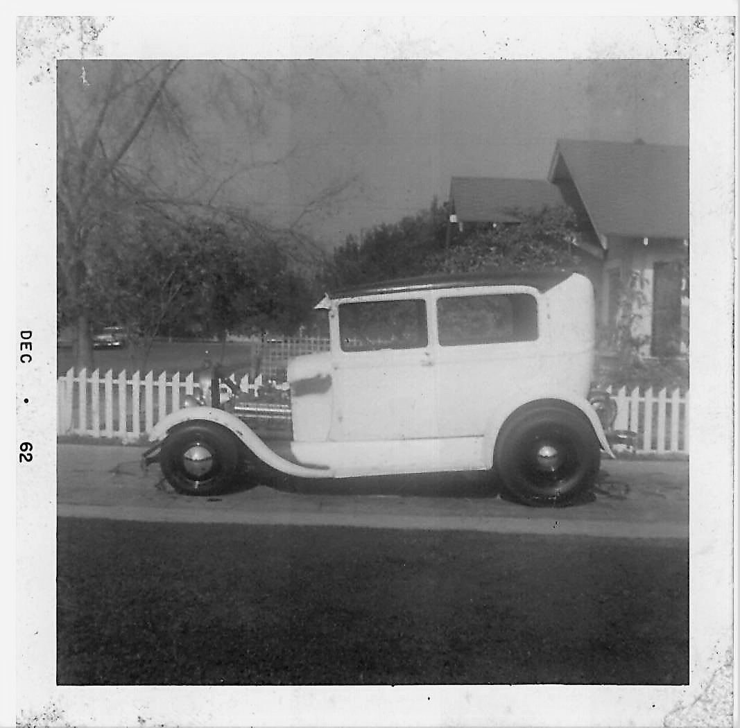

  23. ratamahata
    Joined: Oct 25, 2009
    Posts: 1,438
    ratamahata

    Joined: Jul 30, 2004
    Posts: 4,966
    banjorear
    '28/'29 A's on a '32 frame scream hot rod. You don't need to pinch the frame if you don't want to. If you rather not, you'll need to slightly pie cut the lower portion of the cowl. Either way you go, you will need to notch the rear sub rails if using a '32 frame and may have to relocated the cross member hump under the rear seat.
  25. ratamahata
    Posts: 1,438
    ratamahata
    from Argentina
    Love this!! body is slighty channeled on the deuce rails...I think!
    Theres a bit difference between the past and present interpretation of a hot rod... maybe in the past a common swap of putting a model a ford body on a 32 frame, was looking for porsuit more speed and power with less care about aesthetics.
    That golden sedan sure have a lot of frame and body work!!
