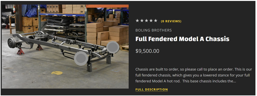

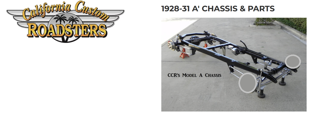

    A rolling ch***is from places like the Boling Brothers, has the style and ch***is for your needs. The cost and time for doing what they can provide makes up for what the cost may be. You can buy what is needed or a complete rolling ch***is.

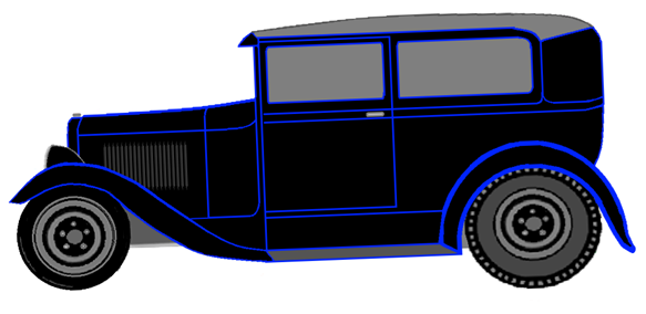

    Here is a 1929 Ford Sedan artwork I had started months ago and details are still up in the air…

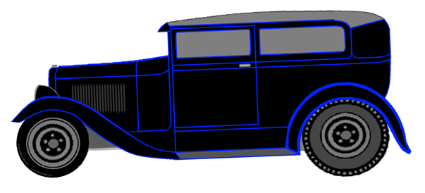

    Here is the same sedan chopped and on a slight rake. The low stance roofline gives a sort of intimidating look...
    I was starting a full Model A Sedan for an old Gas Coupe and Sedan Cl***, art work. It takes me a while to get one down in a rough form to then do some detailing. If the two sedans were a choice for my wife and I, it would be the non chopped version to give us as much room above our heads as possible. The chopped version looks intimidating, but for a long road trip or even a short trip to the beach, the top would feel like it is pressing down on our old heads. But, the ch***is would be a rolling ch***is from one of the above companies. Ha !
