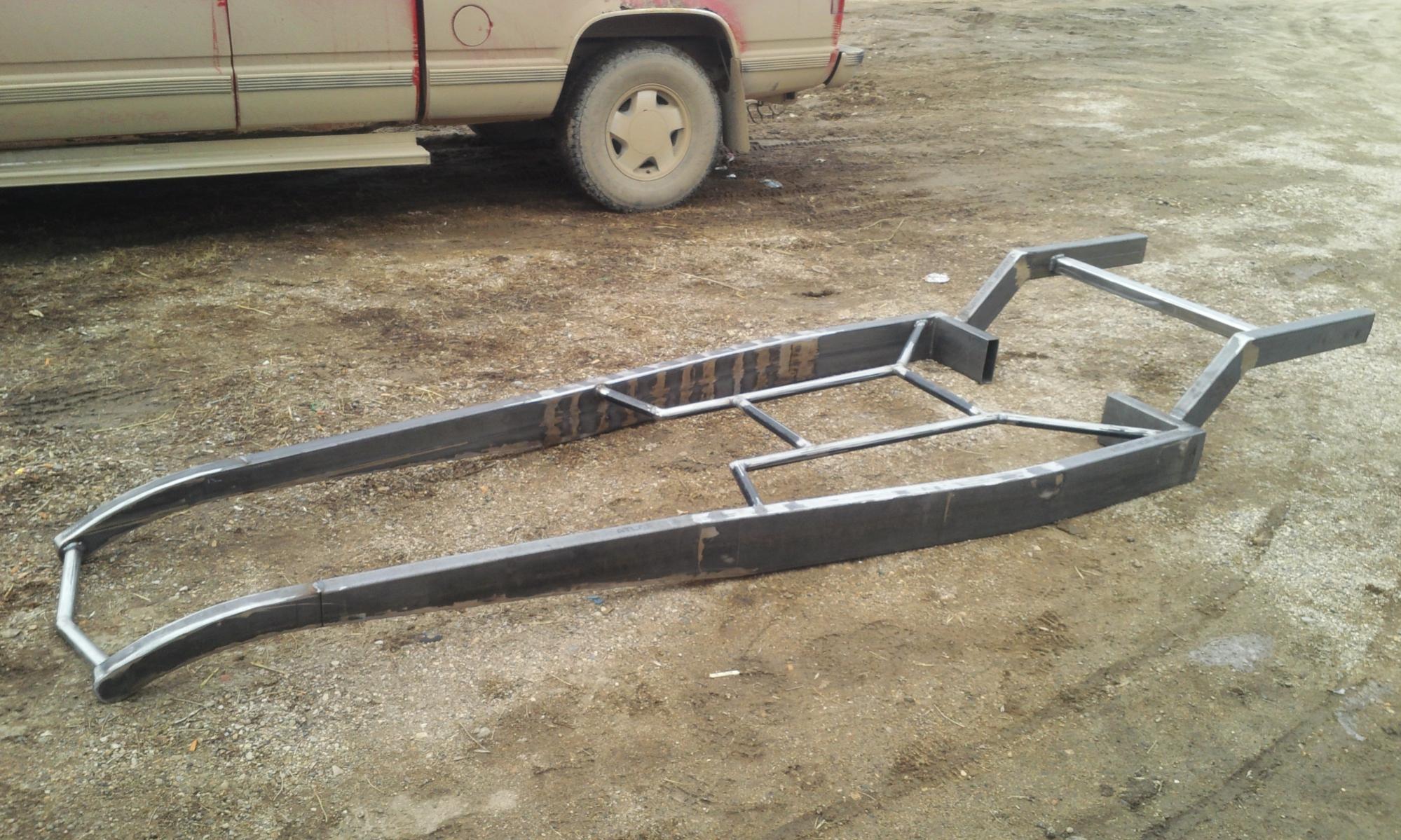

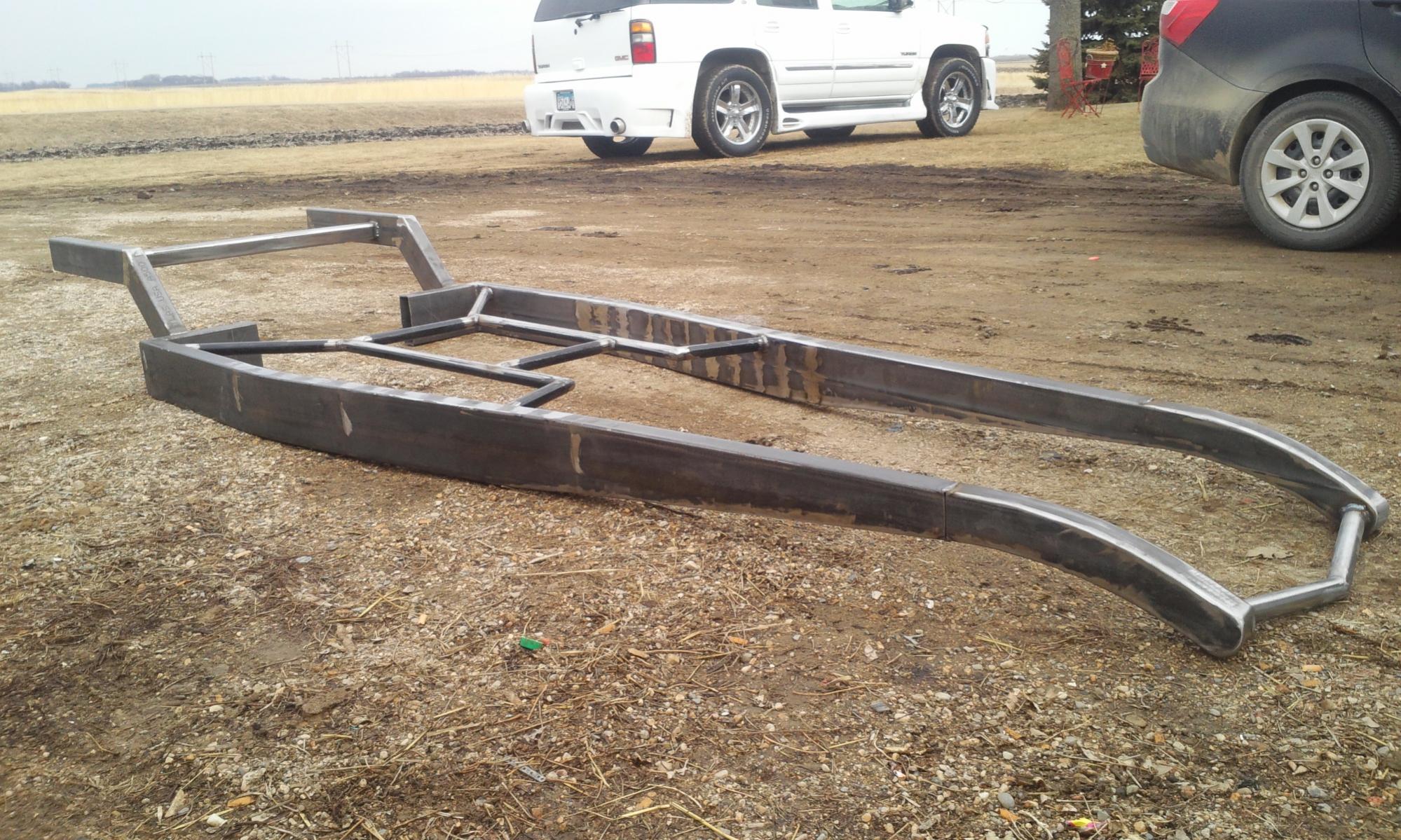

    well. got the car home couple weeks ago. in the mean time i managed to get a frame built for it. just made it out of a 2x6. did some cutting bending and shaping and came up with this.

    Did you fab the frame to Model A dimensions? Maybe someone else will offer advice, but your frame looks to wide, and I think the kick-up at the rear is a no go for full fenders. If you are a tall guy, you may want to find an A with a 4" chop and take a ride before you get out the saw.

    as far as the frame being to wide i think the car fits nicely on it. and im 6' tall and after the chop ive got about 5 inches over my head
