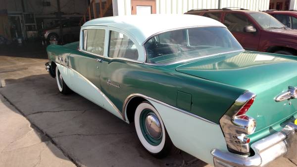

    Looks like your buick is a 2 door tourback sedan. Similar in color to mine.
    Gotta love these old buicks, in my mind, they pick up where the 55 chevy left off as far as styling and features. Here is a pic of my 55. 00z0z_4Nbx2o413dg_600x450.jpg
