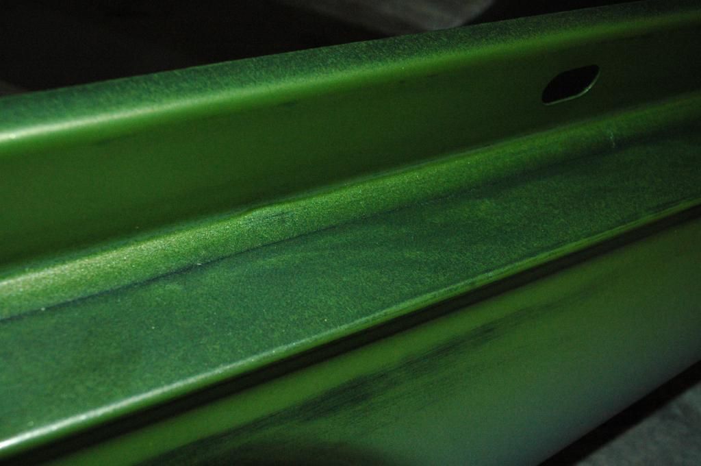

    Quick version: So Im painting an early bronco, limestone green metallic, base clear. Ive painted single stage in the past and the paint goes on thick, however this time Ive got 5 coats on what is photographed and its so transparent one could read newspaper through it! The black showing through is the base primer that the fender came in (once the high build primer was sanded it showed through). At this point I stopped so I dont use up all my product so only the jambs are sprayed.
    Exhibits:
    Long Version (for those who like to read ha)
    So Ive been prepping cars since I was a freshmen in highschool (about fourteen years ago) and admittedly only did it because in return my teacher/boss/neighbor helped me with my projects. So I know quite a bit about the prep side and recently decided I wanted to try my hand at refinishing a few cars and being able to have those skills doesnt hurt.. especially when I have multiple friends who are willing to pay me to paint their cars as well, if I end up being good at it.
    Now, while I have all this experience prepping, spraying paint is new to me (although not the hardest thing to figure out). What is getting me at the moment is the transparency of this base coat Im spraying. Now, I realize its best to have a solid base color to spray on top of but this color just acts like its WAY too thin.
    Its a nason paint, mixed 1:1 sprayed out of a devillbiss gun, ambient temp was about 50 today. Whats even more odd to me is when I stirred up the paint it looked very nice, stuck to the stirrer and just ..looked great. BUT, when I mix the appropriate thinner with the color it wont even show up on the stir stick! Just runs right off its so thin.
    So the big question Im wondering is: Am I an idiot and this is how base clear goes on and it literally takes a million coats? OR, did something happen during mixing and the paint isnt acting quite right?
    Yall I appreciate any help at all.
    -Webb

    If the paint is correct out of the can and reduced correctly the color may require a specific tinted sealer.
    Also apply check hiding labels to help assure hiding.

    I agree. Perhaps a tinted primer/sealer would help, but doesn't explain the excessive transparency. This sounds silly, but did you really, REALLY mix up the Basecoat in the can it came in? Sometimes stuff really sticks to the bottom. Also, 50 is a little cool, so use the appropriate reducer. Maybe it's an underlying issue with the primer/prep? Keep us posted!

    The 1st pix looks like long sand scratches are still there. Another tip, if you go with this paint again paint (sealer) something else as a test. Note everything as you go to learn the characteristics of this brand. Maybe a YT clip
    to see if others have a demo.

    Slammed: I think what youre seeing is the tape edge, thats the drivers side rocker panel and only a small part of the inside edge is getting painted.

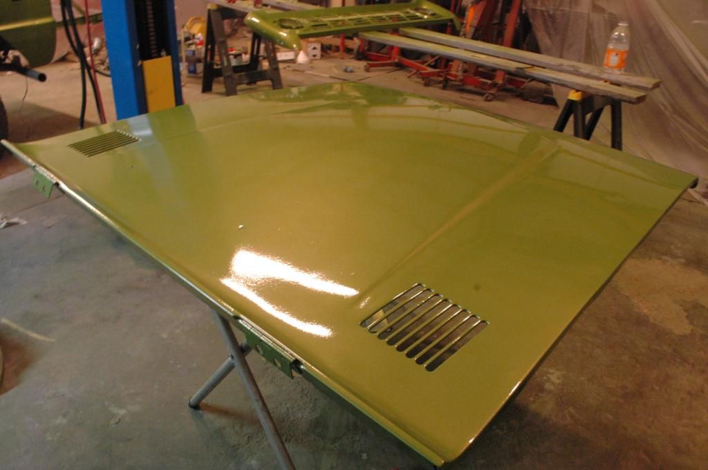

    So, I just got done. It didnt take nearly as much extra effort as Id anticipated. And for the trouble here are some pics!
    Only an hour old at this point so it should settle a bit more...
    So, after fiddling around with everything I came to two conclusions.
    1: Im new and apparently just didnt stir the base as much as I thought I had, so when I thinned it.. it WAS too thinned. But the paint wasnt at fault.
    2: I did need to go back and spot paint some places because even though the paint went on and covered pretty well after I mixed it for a solid five minutes it still wouldnt have covered up Black AND Gray.
    Thanks for allowing me to pick your brains today guys! I appreciate it, this forum is full of exactly the knowledge I need most times.
