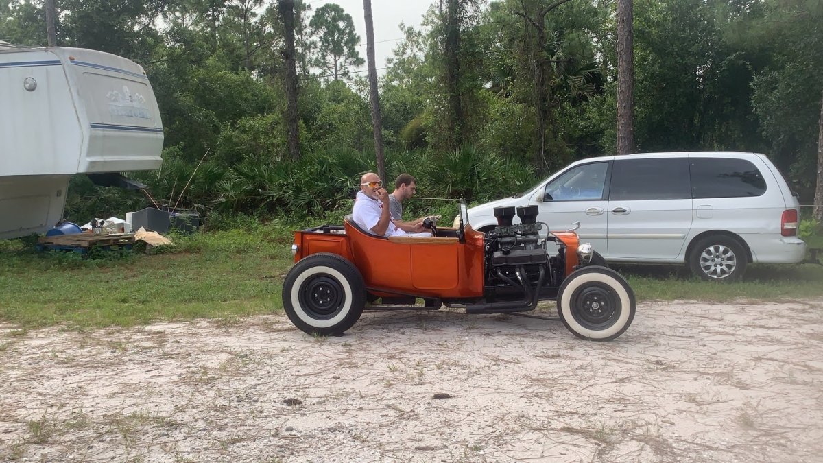

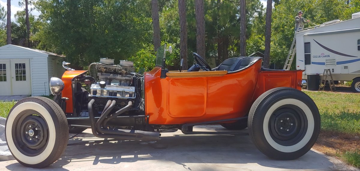

    With help from a lot of the guys here I think I might have something I can finally take for a cruise around town. Big thanks to everyone that helped along the way.
    This was the first ride where something didn't break during or immediately after so I'm pretty happy about that. Not sure why the damn temp gauge isn't working now though.
    Curious what you guys think about the car and what you would change or add to give it some more flavor or functionality. I have not seen many of these cars in person, other than my buddies "Mint Julep" which ill throw a picture in.

    Looks pretty good. I would loose that steering wheel and add some other valve covers, chrome or another color not black. :)

    A few things I would change on your car, steering wheel would be one .
    But why do you care what I like or not ?
    It’s your car have fun with it !!!!!
    it runs and drives nothing better then that.
    mint julep was posted here a while ago, a car that captures 70’s excess perfectly !!

    Your car looks good, and if your happy that is really all that matters.
    Being your on this website that is much more traditional, I am guessing that if you are asking, that your trying to get a car that looks more so that way. If that is the case, there are several things I would change personally. The car has a bunch of parts from different era's. The fact they are muted dark colors, helps to hide them, but I'd still remove some of them. A set of stock steel valve covers to start, probably painted orange--or even chrome stockers---not the later really squared of versions, different air filters, and the steering wheel has to go, and if possible the shifter too. That would get you alot closer in my opinion. Don't change the wheels and tires though, they look good...at least to me.
    Again, YOU have to be happy with the result, and the target your shooting for. We are just the opinion that may or may not be wrong.
    BTW< your drivers headlight lens looks crooked...easy fix there.

    Looks good to me. Steering wheel, valve covers, & air cleaners, as mentioned, would turn the corner on it. Good job.

    Turnouts on your headers, at minimum. You don’t value your hearing until it’s gone.

    What most everybody else sez and........................any way to drop the front and raise the back some?! It needs some rake! And some 'fat tarz' for the rear! Like discussed on another post....This puppy needs some 'at***ude' than only these two changes can give. IMHO

    Nice that it is on the road . Agree with ^^^^ steering wheel, matching orange valve covers some 50’s/60’s painted or rechromed air cleaners and tell your friend your whitewalls better match is top and you will trade him straight across for his wheels and tires .:D

    If youre asking for opinions, everything in the engine compartment is black, you have an exposed engine car, find some vintage parts to brighten it up.
    Get rid of the wood, brushed or machined aluminum or painted steel would be an improvement.

    For the exhaust, If it was me, I'd try to build an exhaust that could sneak back under the car and just add a removable cap to the header. Otherwise, id probably try and modify the header so it was more parallel with the ground and add a "sidepipe" of some type, heck, even a gl***pack with a turn out would be better that just being open. My hearing already ****s, I wouldn't want to listen to that open header for more than a 1/2 hour of driving.
    But again, I'd try to find a style to build from. Not just add parts willy nilly. BTW, great score on the air filters, plain old wing nuts are fine for them....remember, less is more.

    I would use block mounted gauges if my engine was visible a few feet from my dash.. Most times its the capillary tubes that block the pressure or temperature signals to the gauges...
    That car looks too new, to 80s.. I'd look at rods from the 50s magazines.
    1 Get a Grant steering wheel with the holes in it, maybe even metal flake.
    2 Get rid of those velocity stacks and air cleaners and use two smaller air cleaners. I would also get rid of the intake and run a low riser. Maybe go trip duce.
    3 Get stock valve covers and paint them the stock engine color.
    4 I'd get rid of that shifter and use a Hurst Autostick I or some other old style looking shifter.. Make it regular length too.. Or just get rid of the base of that shifter. Make a steel box to cover the shifter or just let it all show. That shifter base and that steering wheel just ruins the look of that interior. I would use chrome gauges and put some vintage indicator bee hive lights in the dash..
    5 The wheels and tires look great! They are what's holding the cars look together..
    6 Maybe a pair of Pontiac tail lights..

    Are your valve covers aluminum? If so, you could strip the paint and polish them. They might be tall to give clearance for roller rockers and shorter VC's might not clear. I like the stance as is, and believe it probably handles good because of it!
