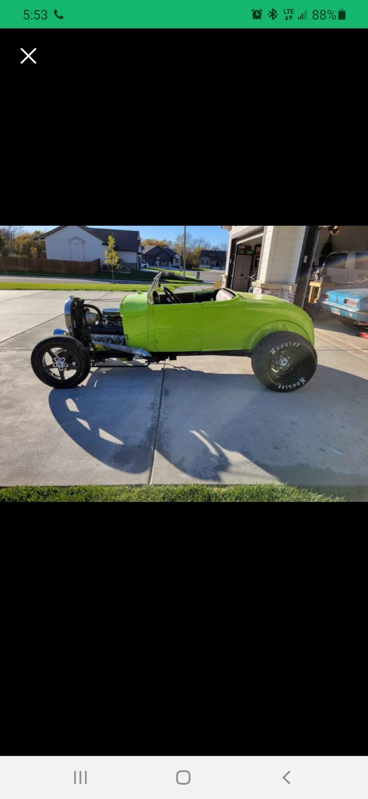

    Thanks for the insight. Had a 1929 rpadster come up and had that thought of getting it back to more of a traditional build and maybe making a buck of two on it . Its hard finding an actaul number on what these cars are going for though. Even roadster sales on sites are everywhere on the charts and none are built the way i am invasioning one. What do you think this would go for its a steel brookville body . 9" 350/350 with sniper efi . Id have the body and engine block repainted or just leave the body bare and put black skinnies on it was my thought to make it more era correct . Screenshot_20221230-175351_Facebook.jpg

    Well, that ****er's pretty ugly as it sits, so if you can swap some better looking wheels on there and re-dress that poor, unfortunate small block, you'd definitely be moving the needle in the right direction.
    Problem with pricing is, hot rods are really hard to nail down. They're not at all like, say, a '65 Mustang, where you have a pretty obvious price range from previous sales and you can narrow it down by options and condition and whatnot.
    Hot rods are all over the place price wise. Sometimes you strike gold, sometimes you lose your ***. They're great fun if you like to build cars, and they're fun to drive too, but they're very unstable as an investment to buy and sell.
    If you told me you could buy that car for the right price, and you were going to repaint the body red (or black, or really any color that isn't neon green), add some finned valve covers and a proper carburetor/intake setup, and put some chrome reverse steel wheels on it (in no diameter larger than 15"), I'd cheer you on and say that's a great plan. You'll be doing that car a favor and you'll end up with a nice roadster when you're done.
    But if you're doing it to hopefully cash in, you're taking a big risk. The finished car might sell for $40K or it might languish for a long time for sale at $20K, even if you spent more than that on it.
    If you really want to do it, do it for fun/because you enjoy it. If you come out ahead in the end, that's great. But if you're just doing it in the hopes of a big payday, you're barking up the wrong tree.

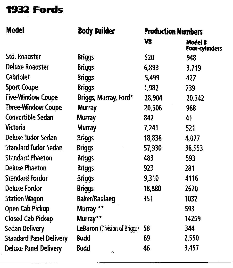

    Why are model A Bodys so much cheaper than 32s?
  10. Reddog sawmill
    Joined: Sep 18, 2019
    Posts: 47
    Reddog sawmill
    Because they made millions of model a's over 4 years and there are far fewer one year only 32's

    And also this was the first Ford to go into production with a V8 option. 1932 Ford body styles.jpg Faith%20and%20the%20Deuce%20of%20Spades%2011.jpg

    The green roadster is a 29 model A. Looks like an original steel body as its got the cowel gas tank... could be 20k, or 30 depending on the spec of the other parts.

  15. The model A pictured is scary looking. I think that it would take too much time, money, and effort to try to make a profit on it.
