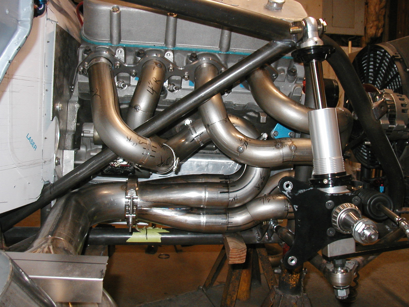

  11. I like using S.S. V-Band clamps. Just a little spendy but never leak. They are built for Turbo's and seal with no gaskets. You can take them apart over and over and they still don't leak. You won't regret using them. If you go that way and don't know be sure to overlap seam by 1/8". Here is what they look like on the collector. A.M.X. Headers 002.jpg

    The V-Band Clamps are Modern Hi Tech Shit! LOL (and yes they work very well, but are out of place on an old school car)
