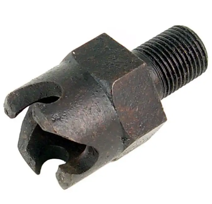

    On my 1940 Flathead the pulley had that exact same snout on it for the crank to engage, but it also had a hex head that was like 1-3/16" as part of it. Here's a pic from Eckler's Catalog:
    I must join the others and agree that trying to turn over a stuck engine by the crank pulley is risking damaging the threads on both the nut and the crankshaft. Pulling the heads and soaking cylinders might be where I'd start.

    Remove the spark plugs and squirt Marvel Mystery Oil into the cylinders and let them soak for a few days.
    With the plugs still removed put a socket on that odd looking crank not with claws and turn it clockwise to turn the engine over. Originally, the claws on that nut were used for attaching a hand crank to turn the engine over.
  15. I'll just add that the Hand Crank was meant to turn a motor that was "NOT" stuck. It was for tune up and valve work. Take your chances if you want and I'll try not to say I told ya so.

    That photo helps a lot! It’s so dirty I couldn’t see past the teeth to see it is actually a nut. Is it 1 1/8? I think i read that somewhere? Or a 32mm I read may for which I do have.

    I will try other methods and if I use the crank bolt I will be very gentle knowing what y’all have told me. Don’t want to strip it!

    Just checked, all Flatheads up to 1938 had 1-3/16", starting in 1939, they began transitioning to 1-1/8". So more than likely a thin wall 1-1/8" socket would work for yours.

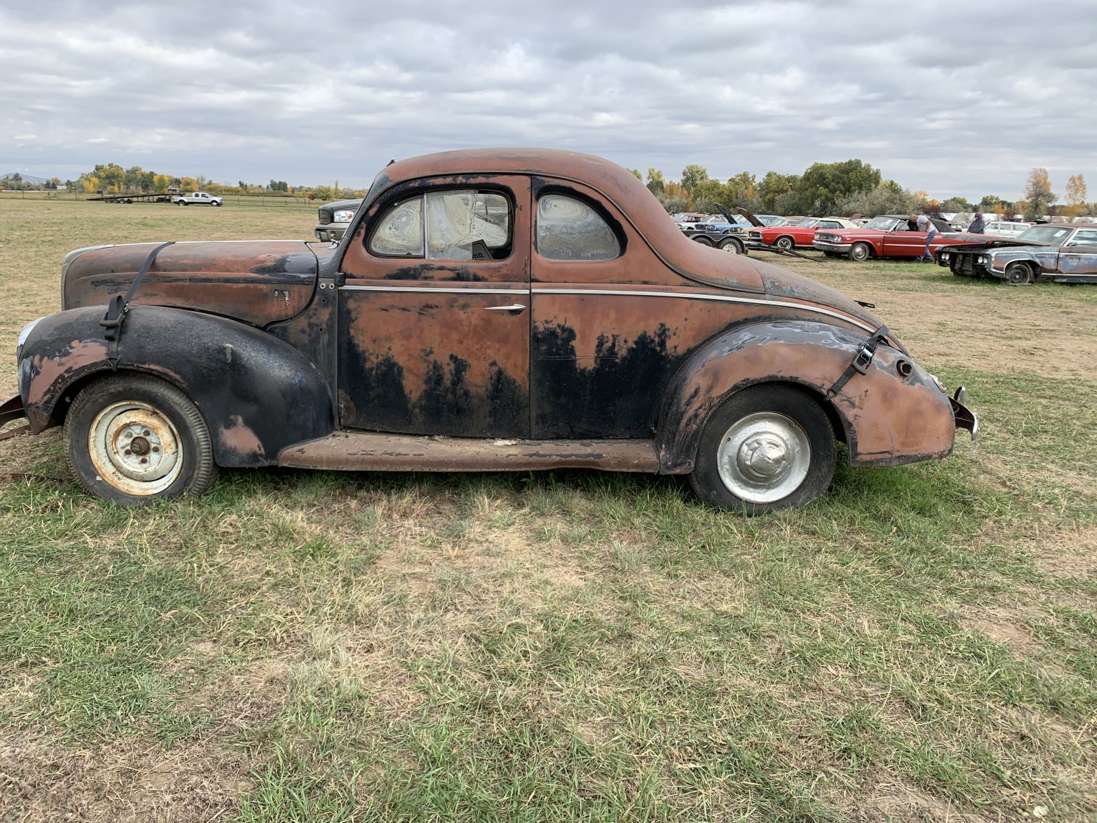

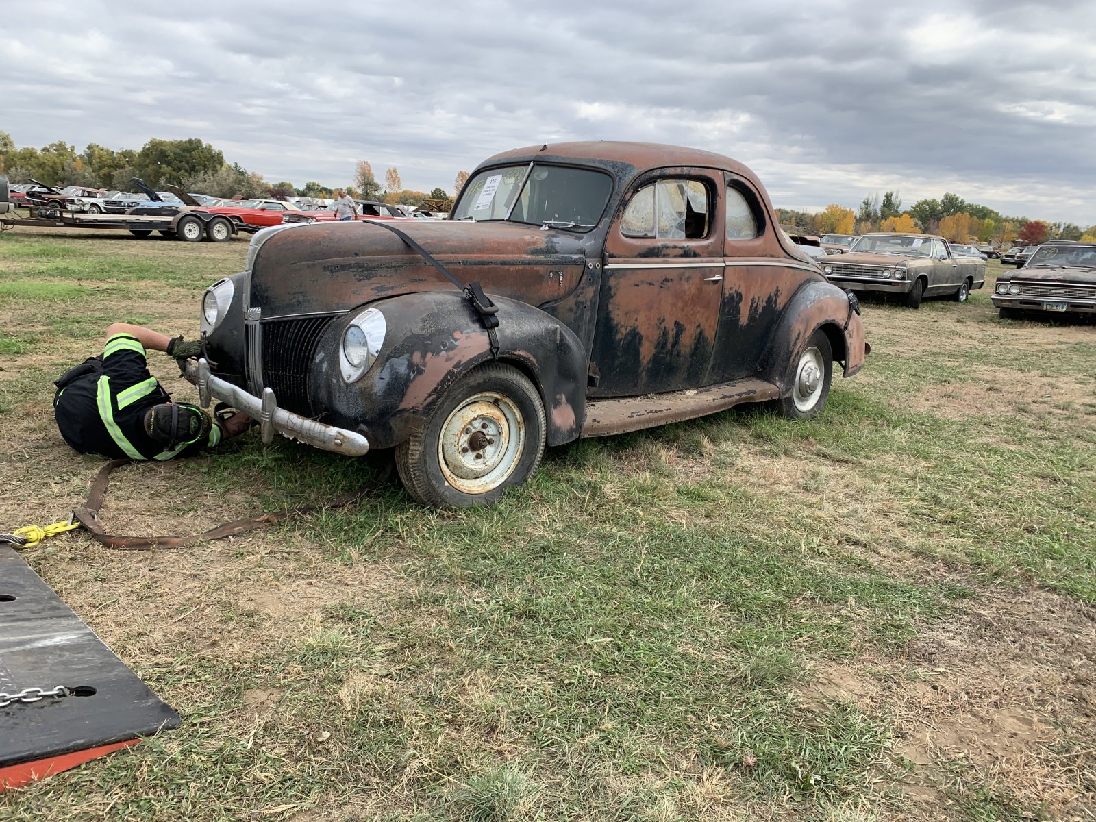

    Busmania
    from Denver
    Here are a few photos. Pretty pumped for it. The only rust I have found is a very small amount in rear apron and a little in the p***enger rocker area. From underneath the floors look solid. Very complete car.
    4250CF8C-EFCE-406C-A613-DBD4703466D8.jpeg 659B055F-FD14-430A-8601-778C787653A4.jpeg C8BE583B-D02C-446A-9C81-05215F2D94C8.jpeg
  21. caprockfabshop
    Joined: Dec 5, 2019
    Posts: 698
    caprockfabshop
    Cool, the one from the Colorado Auction surfaces! I saw that they had a couple of good early Fords in the sale.
