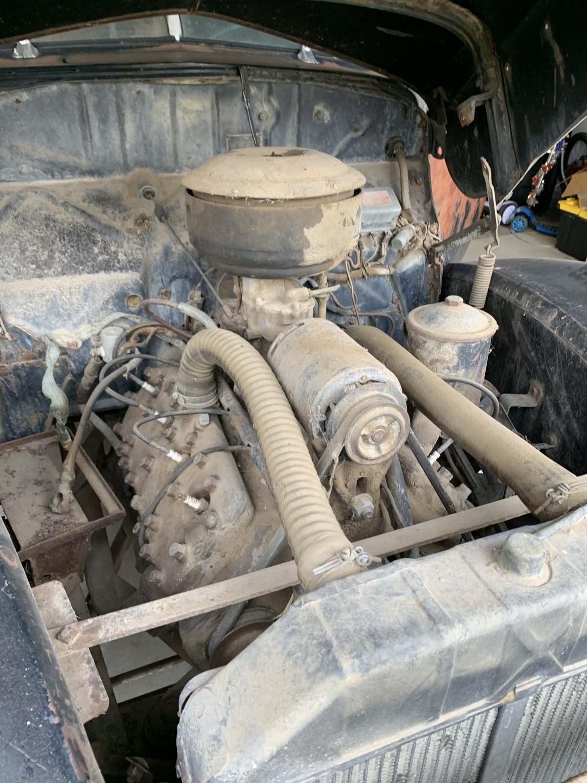

  4. I think you'll find all of us here have our own way of doing things. Personally, I think KISS. Looking at the photo of the Motor the Last thing I would do is start tearing it down. There is no evidence that moisture or vermin could get inside the motor. Pull the dipstick. If there is water in it the oil mark will be quarts high past the full mark. If none is there that's probably okay also, just means it wept out over the years of sitting. If it was here, I would already have the starter off and MMO in each cyl. So let's talk about removing the starter. When you first look at it you're going to wonder where the bolts are that mount it. There are no perimeter bolts on them. The 2 bolts that hold the Barrel to both end bolts actually go all the way through and hold the total starter to the Tin plate. If you remove them totally you're going to have a battle on your hands. What you want to do is remove the outside bolt from just being threaded in but don't remove it. Now you loosen the other bolt about 3/8 of an inch, pull the barrel and end cap back and take a 1/4" nc nut slide it between the tin plate and barrel and put it on the first bolt you removed. Don't thread it back in the tin plate. Now it's a balance act of removing bolt #2 some and tightening the nut on bolt #1. A little back and forth and you will have a starter in your hand all in one piece. Anything less than that and you'll be cussing Henry in green words. Now I can take a proper pry bar and try to move the motor both directions easily.
    I'm in the crowd of see if it will run at all first. No doubt it will come all apart someday but if it will run in any fashion and you decide to run something else it will bring more money if it runs and smokes and knocks than in a big pile of parts. Save your $$$$ and make sure you're moving forward.

    Thank you for hte info on the starter! I would have totally botched that. I do know that these flatheads are unlike most engines and require their own knowledge and set of skill so everything I do will be done with care and research first.
    I will eventually pull the motor but I'd love to see if I can get it started so I can see what I am working with before I tear the whole car apart.
    On the dipstick there is red oil which to me tells me someone tried to get this thing moving at some point. However, judging by the dipstick and the gunk around it and just hte way it was sitting, it was done a LONG time ago. There is no sign of water on the dipstick. No signs of rodents in the car save for a little bit of a pile of fur in the glove box (seems like a perfect place to make a bed). My biggest concerns is the two spark plugs that were very difficult to remove. They were on the drive side bank, one on each side of the water hose. That makes me fear that water got in there but not knowing much about these engines, I don't even know if that is possible. I also feel like I saw a little rust down one of the plug holes before I pour the marvel mystery oil in.

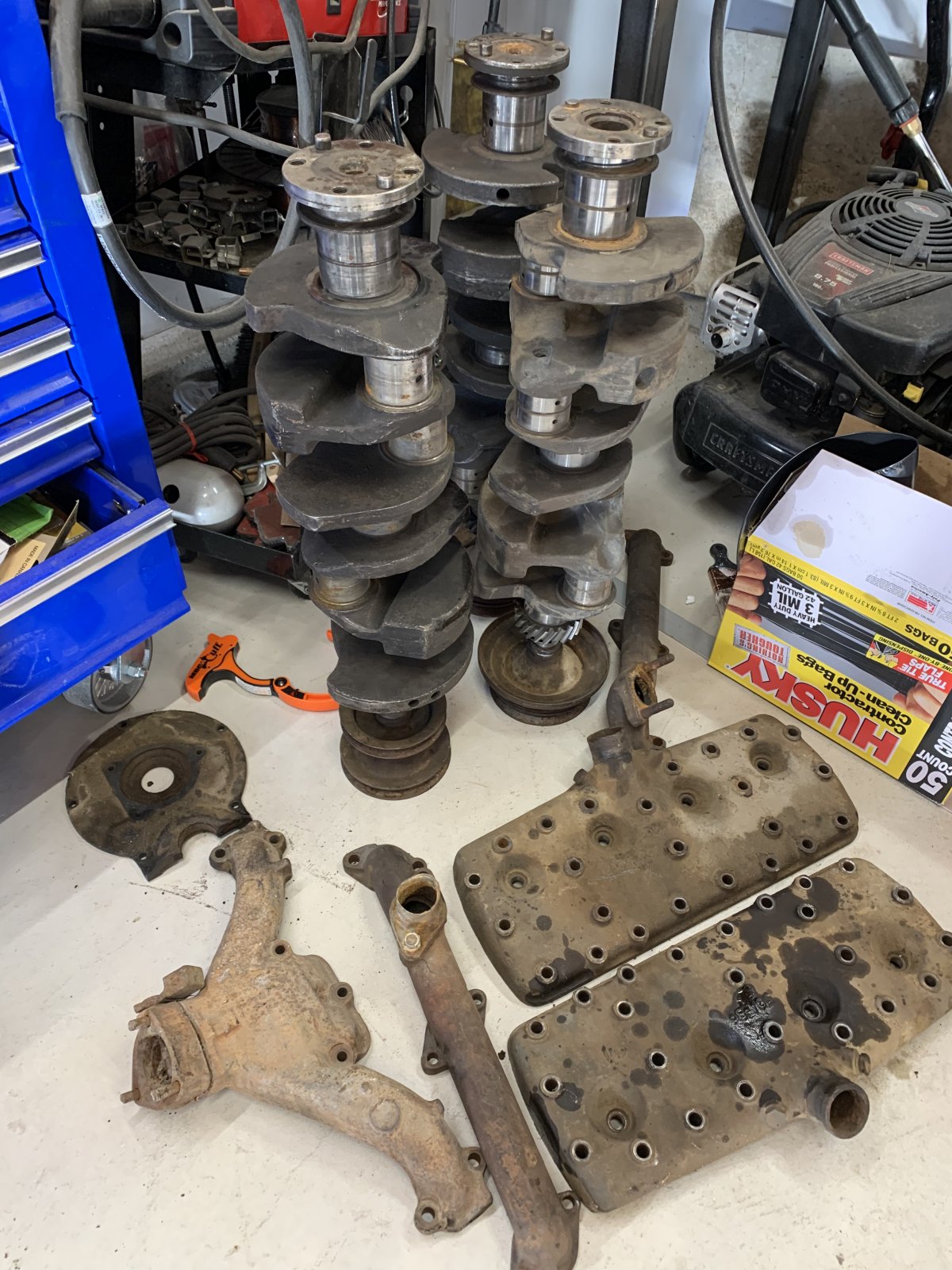

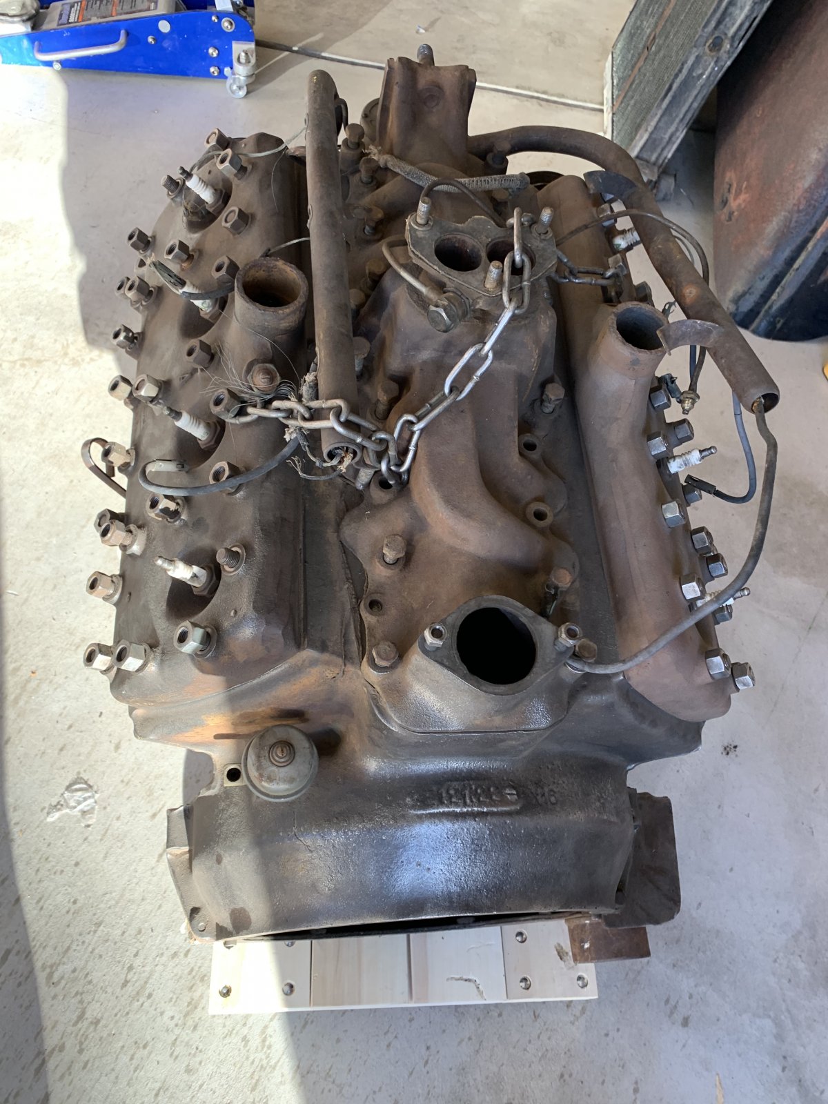

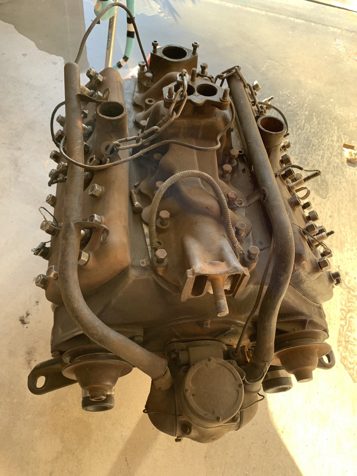

    DFCC1E19-EC1D-4648-8F37-95471B3BD0C1.jpeg E5FB9BC5-D591-410B-ACF0-5E3693ADAE49.jpeg 24B9FE36-4FDD-4FDF-A122-E5216BBFFF85.jpeg Well, I picked up a spare Flathead long block just in case! It was $100 and so I could not say no. It also came with 3 extra cranks, head covers (what do you call these on a Flathead…the part the water hose goes into that on a traditional engine is the “head?” It also came with two exhaust manifolds and something else that I’m not sure what it is. The longblock turns and has distributor, coil, manifold etc. nice to have a back up!
    is there anyway to id they year of the engine?
  17. 51504bat
    Joined: May 22, 2010
    Posts: 6,085
    51504bat
    The almost round plate is a timing cover for a 3 bolt distributor. And the one exhaust manifold in the photo isn't from a flathead but the other 2 are. And yes, the are called heads on a flathead.

    Welcome and great find. Just one thing...Since you pulled the flatty, it won't start in this condition with out the carburator and a starter. You might as well just give it to me...
    Hopefully you can get it to turn. I hope you take photos before pulling it apart like someone mentioned.
    It's good to have extra parts around just in case but, don't throw your money away before you get a good look at it.
    Invest in a flathead mount for the engine stand. You'll be glad that you did.

    dan c
    that is the cylinder head. the hoses go on the water outlets. as far as identifying the various years, you can start on the hamb. at the top of the page, you'll see what looks like a magnifying gl***. click on that and type in what you're looking for. also google. don't be afraid to read everything you can find about flatheads, either. it's a 1931 engine design and there's a lot to learn!

  26. Something else to know. Cracked Flathead blocks are way more common than a good one. You can't tell one from the other by eye most of the time. What the majority of byers have done in the last 20 years when shopping is include a machine shop in the deal. The byer tells the seller that he will pay the price after it goes to a machine shop to be Maged foe cracks and pressure tested as well as bore checked. That keeps the seller honest and the byer from adding to his S**** pile. It's just honest dealing.
