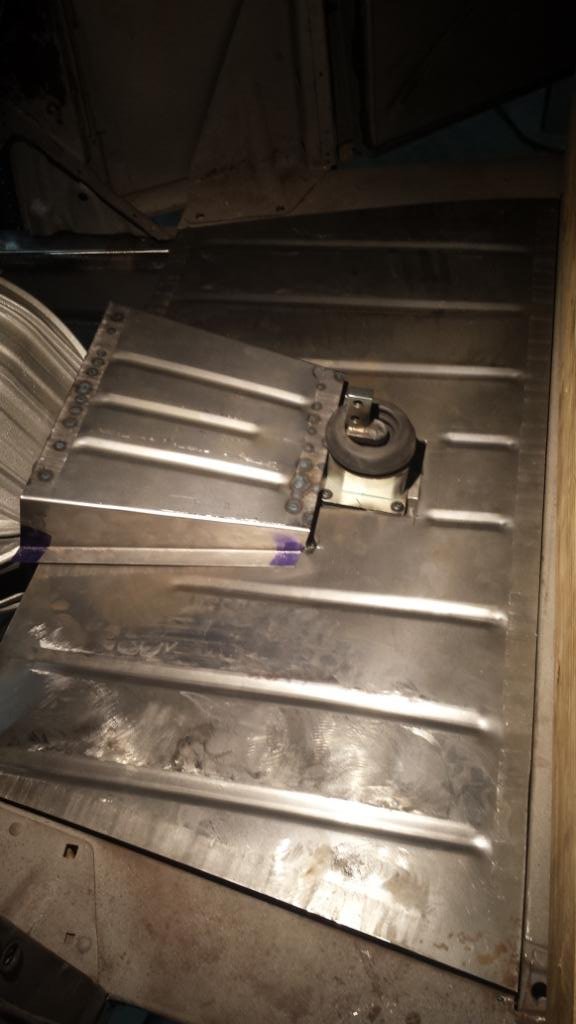

    Made an attempt at floor pans today. I was pleased how they are coming out.

    Nice job on the floor pans. Me likey. If you want more 'rubber rake', you can go with 7.50 tires out back. Keep the pix coming, this is biscuits and gravy!
