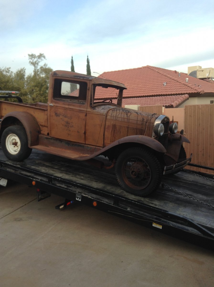

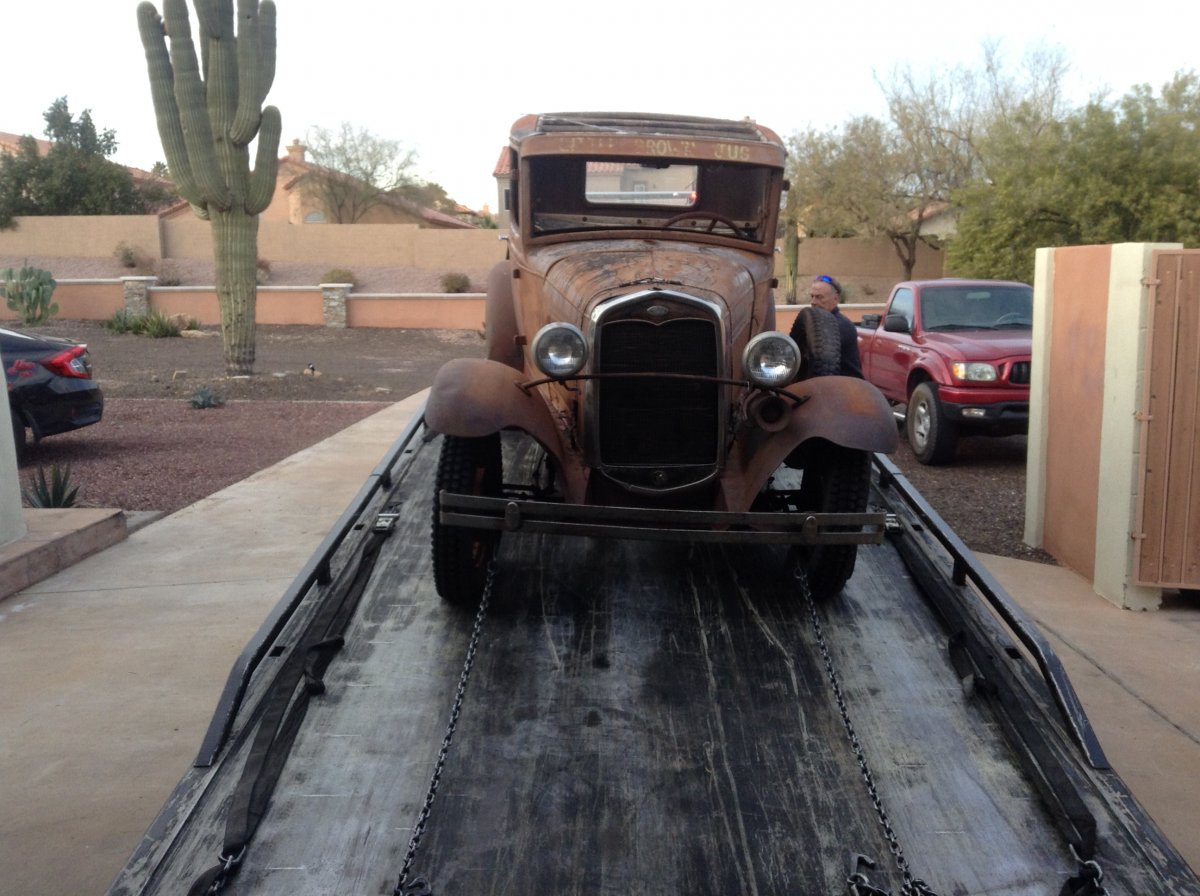

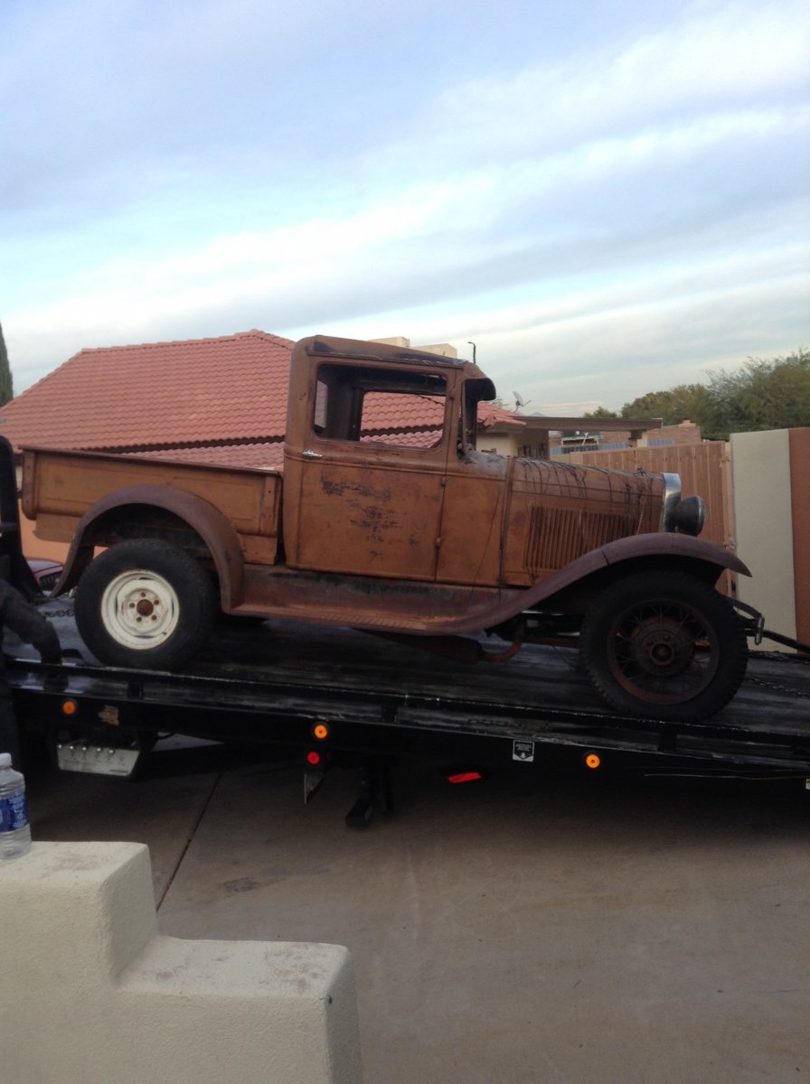

    i will post some pics. the truck has been in AZ all its life. it was in a storage barn for the last 50 years. the only rust it has is about a quarter size on the running board and below the tail gate on the bed. its all complete with motor and ******. i have been drenching it with penetrating oil to loosen some joints and nuts. i got the hood open and window frame. its amazing how well the doors open and close. no effort at all.

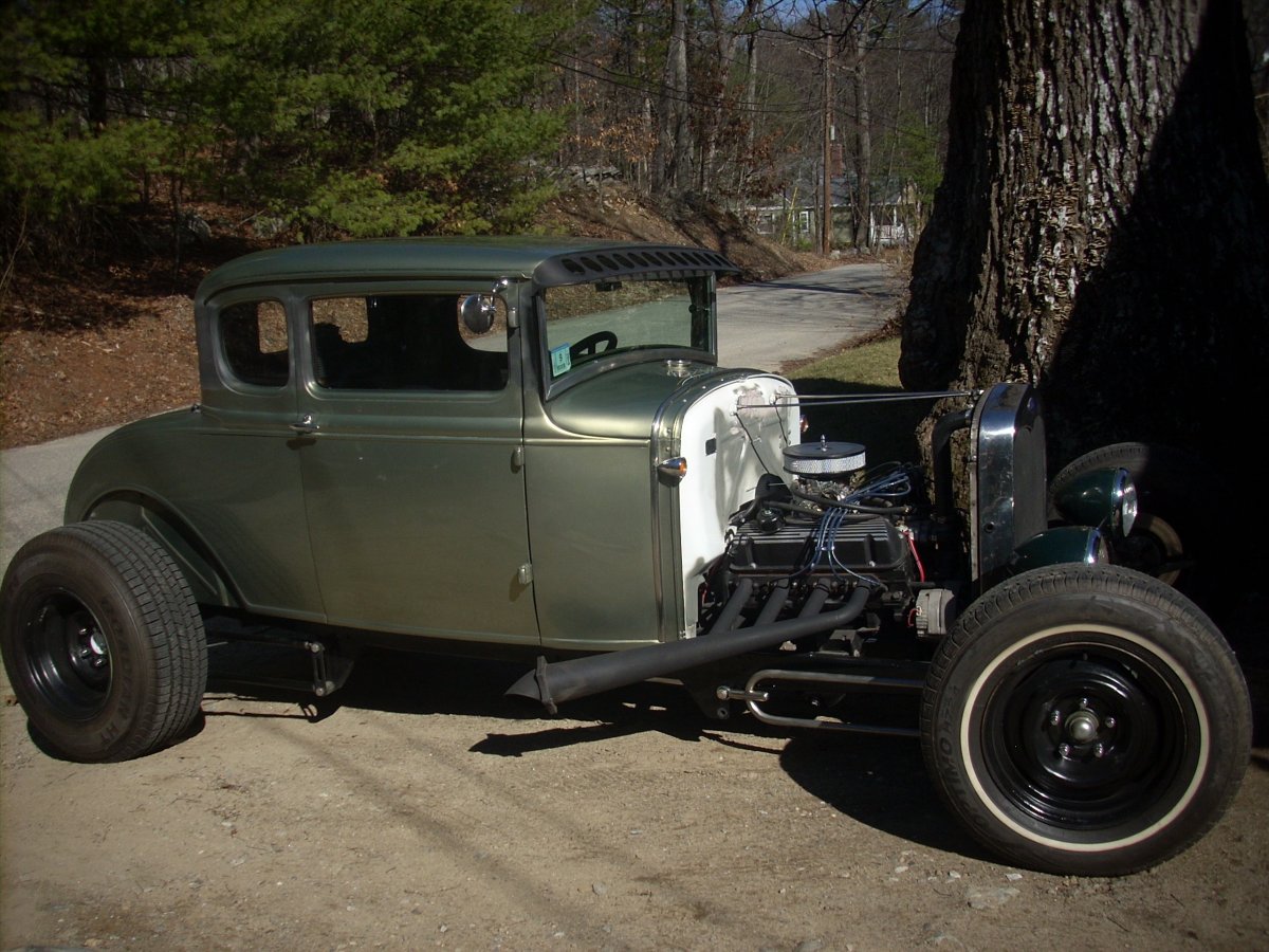

    #1-Green coupe, Mustang 302, c-4 ( yeah, I know) 10 b0lt posi GM
    #2-Sedan-302, 4 spd Mustang , '57 Chevy rear ( went great, FUN to drive)
