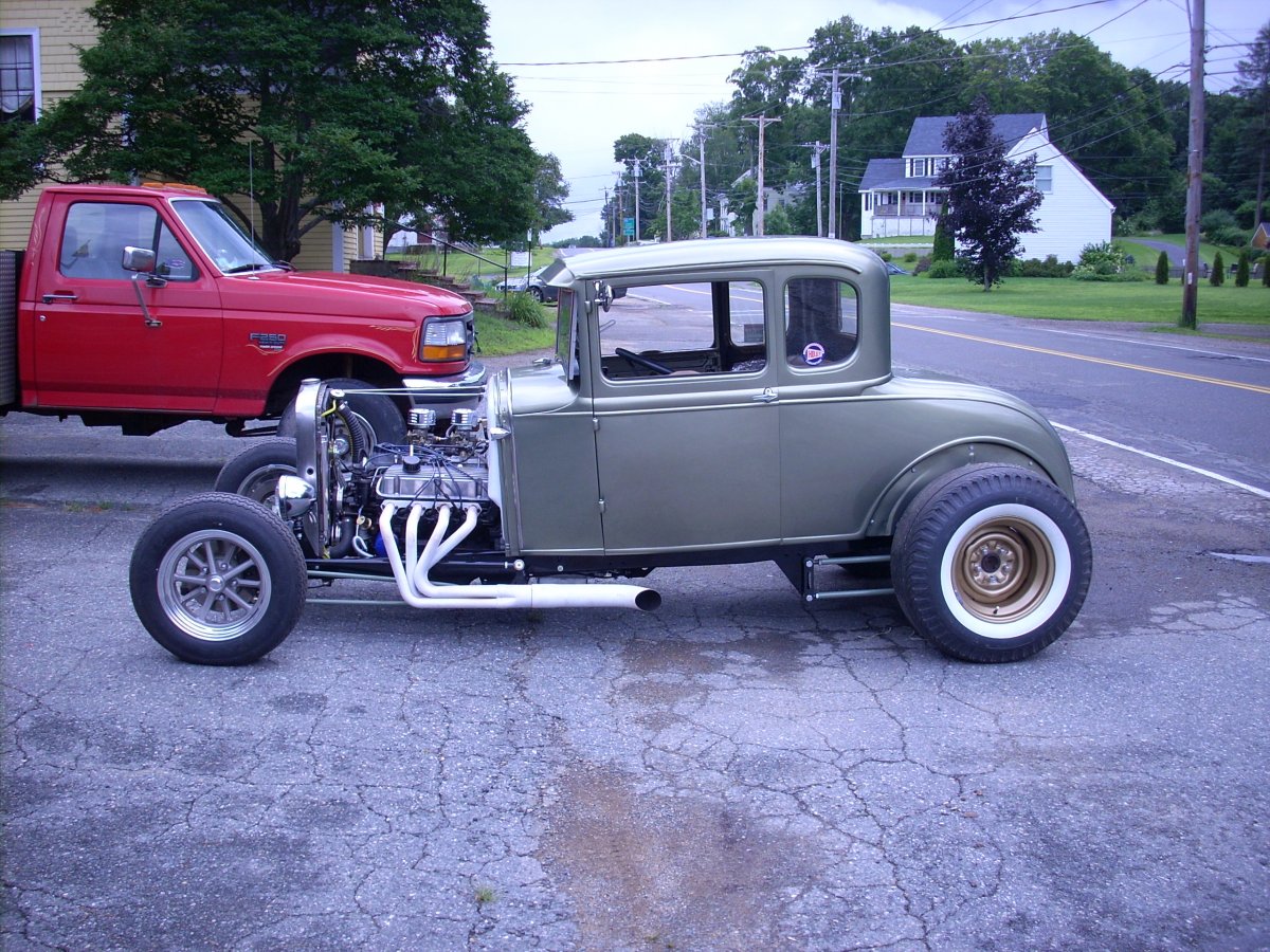

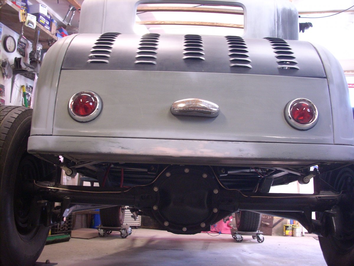

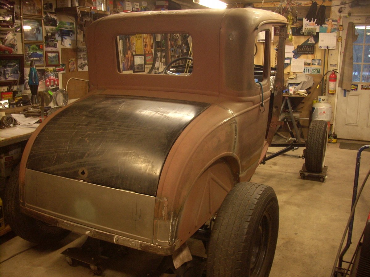

    Pic of '82 Camaro 10 bolt on my 30 coupe with deep offset rear steel rims ( 12 years ago)
    gray primer coupe with an Olds Cutl*** rear end ( free, so I used it- stock 15" rollers))
    red primer car I'm working on now, another 80's Camaro 10 bolt ( stock 15" rollers)
