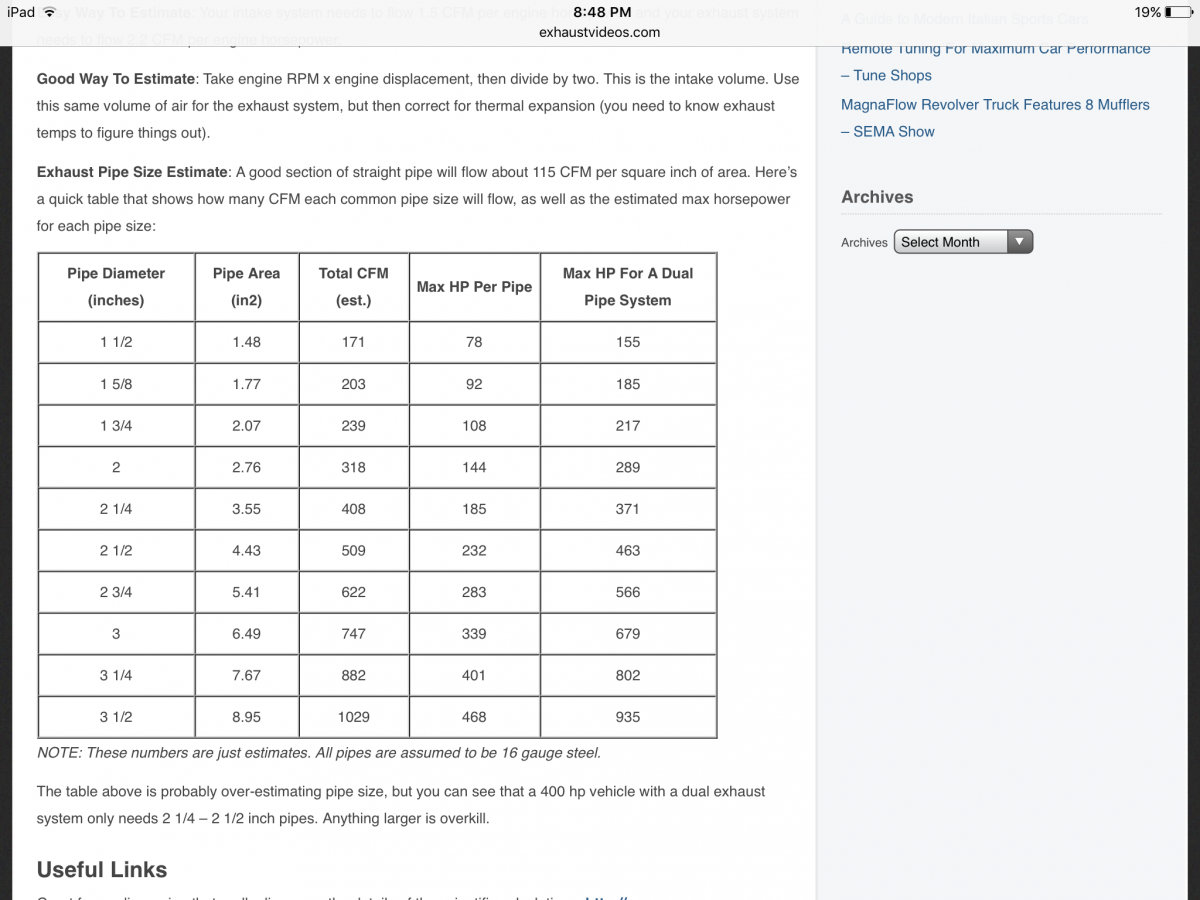

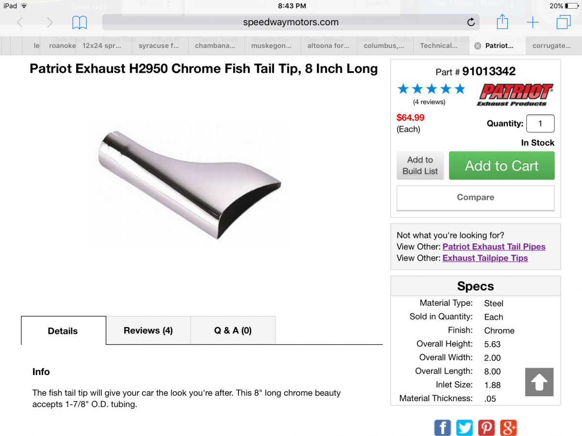

    See where it says 1-7/8" ????
    See where his exhaust is 3" ?
  26. 3" pipe duals needs 600ish horsepower to work right.
    See the bottom line?
  27. Ok I see the table, what will happen if I run this truck with the 3" exhaust?

  29. Yeah I am just gonna run em. And with fish tails coming out the sheetmetal. If you try to kick them off you're gonna break your foot.
  30. It Will certainly be a deficit to the package.
    You'll never build the power that your engine has the potential to make.
    You'll loose velocity of the gas flow and that means loss of torque.
    X38 likes this.
