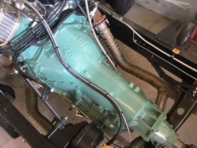

    @Black_Sheep those clips that hold the wire...I've never seen anything like that, where do you get them?

  3. Black_Sheep
    Joined: May 22, 2010
    Posts: 1,519
    Black_Sheep
    They are called beam clips and they are commonly used on semi trailers for securing hose tender springs, wiring, etc...
    Tectran #94-0108,
    Tramec #34118
    I sell them at work, but you should be able to find them online for less than $1 each
    With the appropriate sized poly clamps they are great for fuel line too.

    The OEM wire was linen wrapped many years ago . It needed to be somewhat protected from the weather . Newer wire is ok to be out in the weather with connections sealed . Run it outside and down the frame as suggested , and wish it well .
  7. bobss396
    Joined: Aug 27, 2008
    Posts: 18,764
    bobss396
    I ran them along the tunnel on my Ford, it was actually done that way from the factory. It wasn't a big bundle at all, I ran it through shrink tubing.
