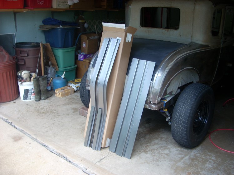

    Steadfast mfg in mansfield oh. makes the subrail kits to put an A on a B frame. Call hank at 419 526 3132 He manufactures them he has the answers, and is more than happy to help you. dave
  14. chopt top kid
    Joined: Oct 13, 2009
    Posts: 959
    chopt top kid
    These are the rear subrails mfg. by Steadfast Mfg. Co. that I got to mount my Model A Coupe body onto my '32 frame rails.
    The Rolf Coupe, Chris Casny's Coupe, and the Tindall Coupe are all excellent build threads showing the fabrication of the rear subrails by the builders.
