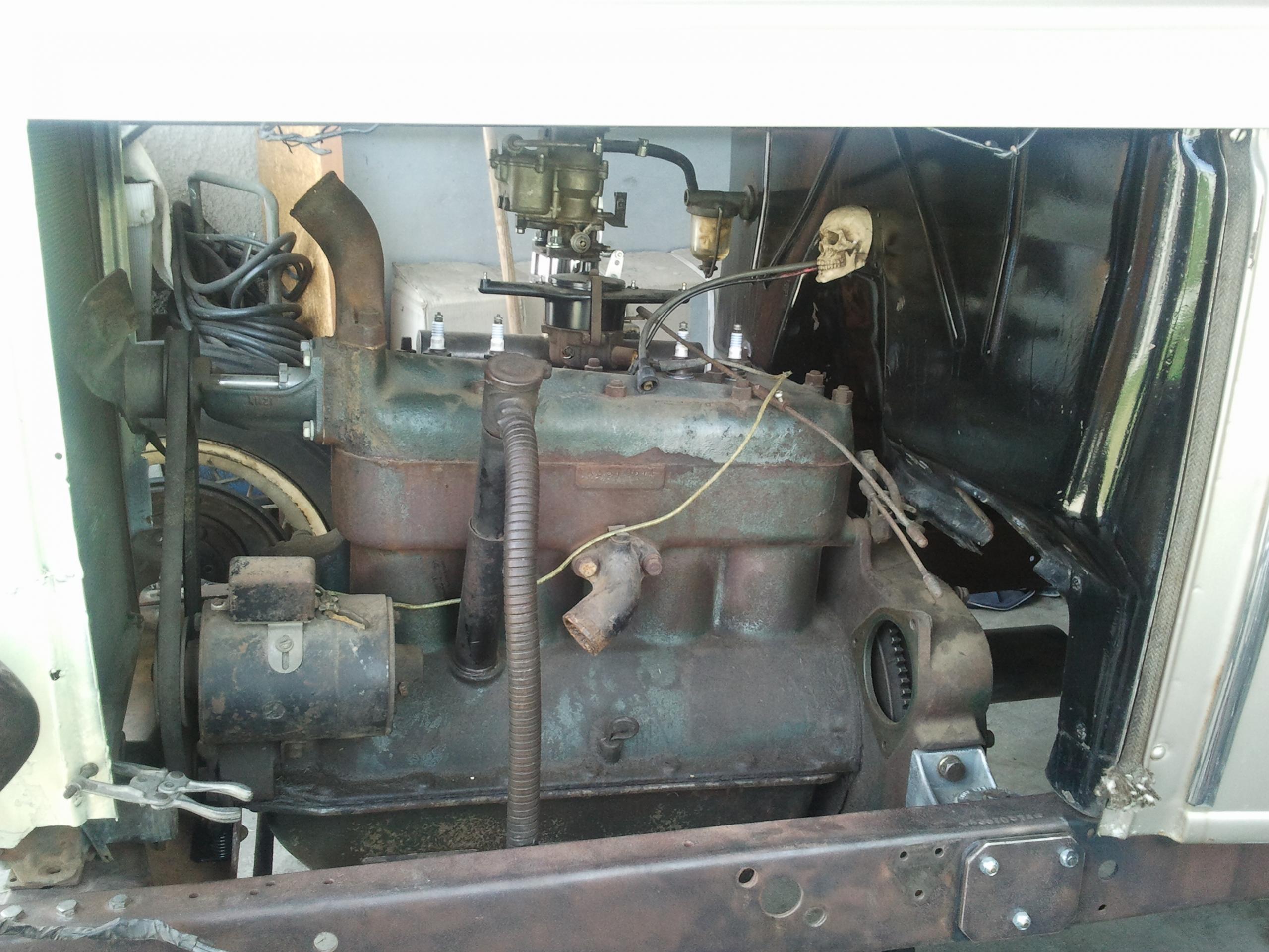

  28. elmitcheristo
    Joined: Nov 10, 2007
    Posts: 351
    elmitcheristo
    I just took this pic for you. This is my 30 coupe with a "B" motor. I laid a straight edge along the front of the firewall. As you can see, it is in line with the rear of the rear driver's side head stud. Also, I have approximately 5/8" of clearance between the fan castle nut and the radiator.
    Hope this helps,
    Mitch
  29. Working Class Zero
    Joined: Jun 4, 2008
    Posts: 316
    Working Class Zero
    How is that straight edge sitting? Flat on firewall or on its edge? Hard to see.
