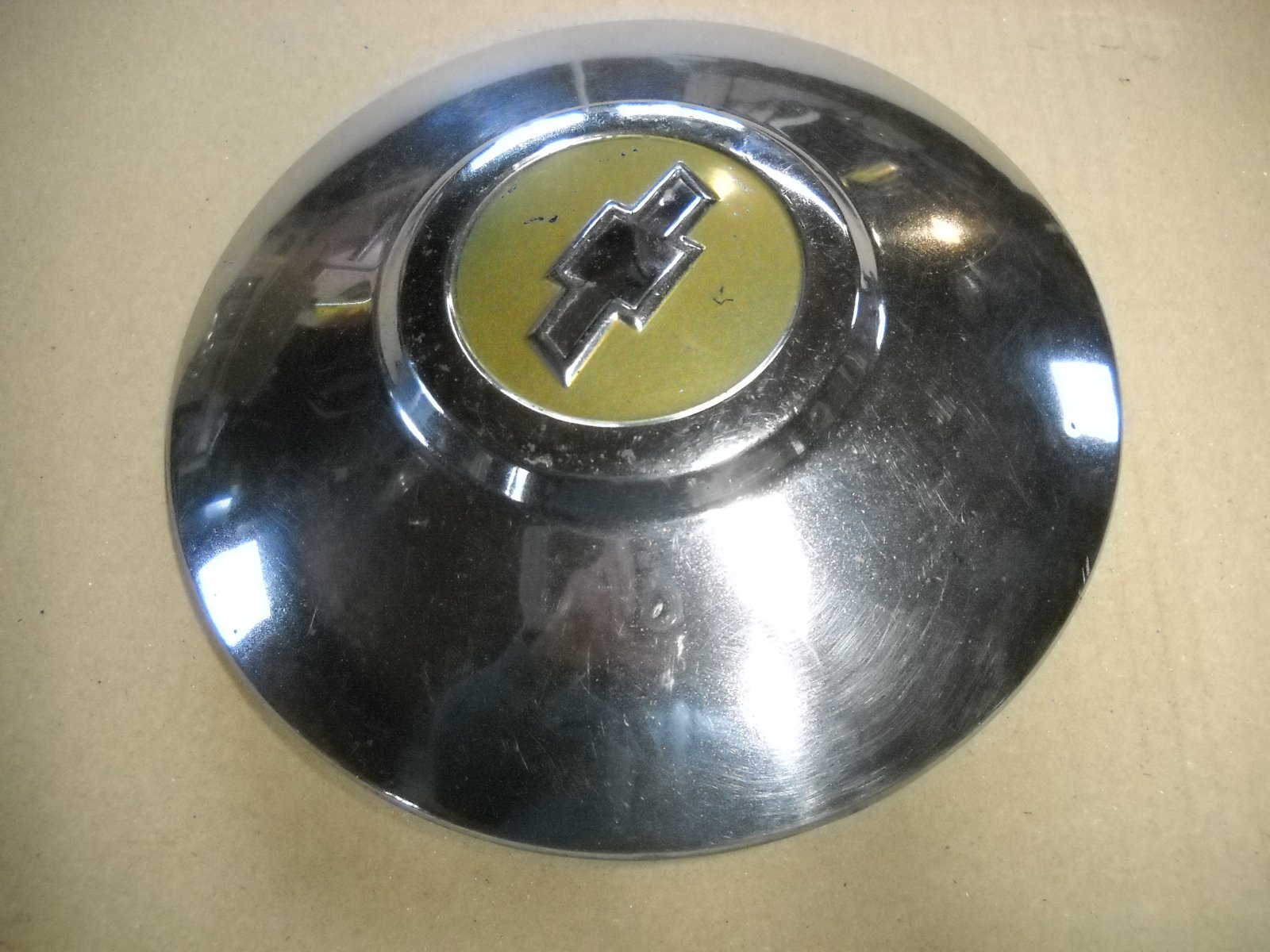

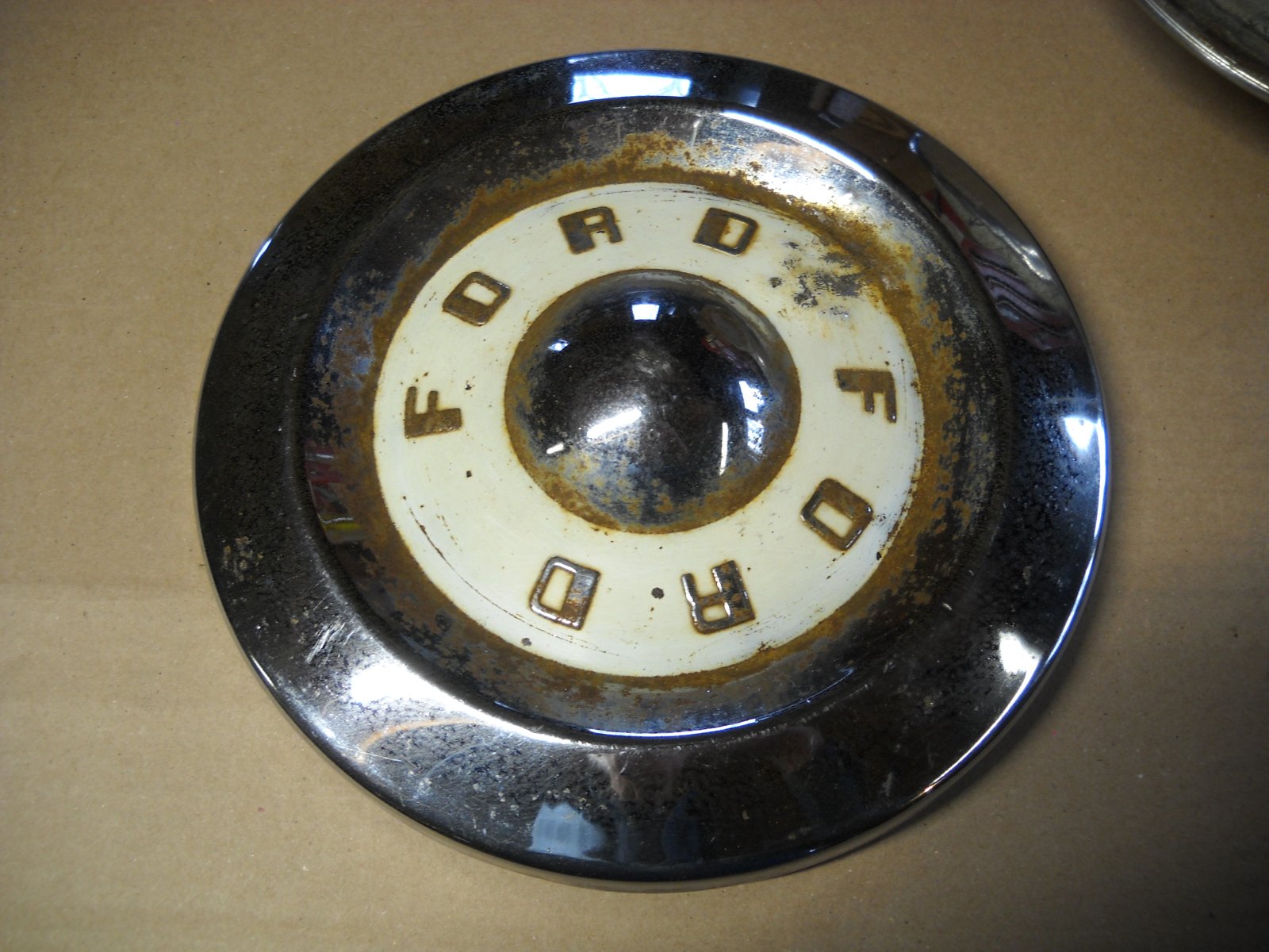

    ...have these 60's-70's steel wheels with the hubcap bumps at 10 1/4'" diameter, but wanted to run my 49 Chevy caps,/...so I cut the flange off the 49 caps, tap'd what was left flat, and pop riveted them to some 57 Ford caps that fit my wheels...

    ^^^ that mite work on some caps but these had the extra flange on the back that needed to be trim'd off to lay flat on the ford caps. (see 2nd pic)
