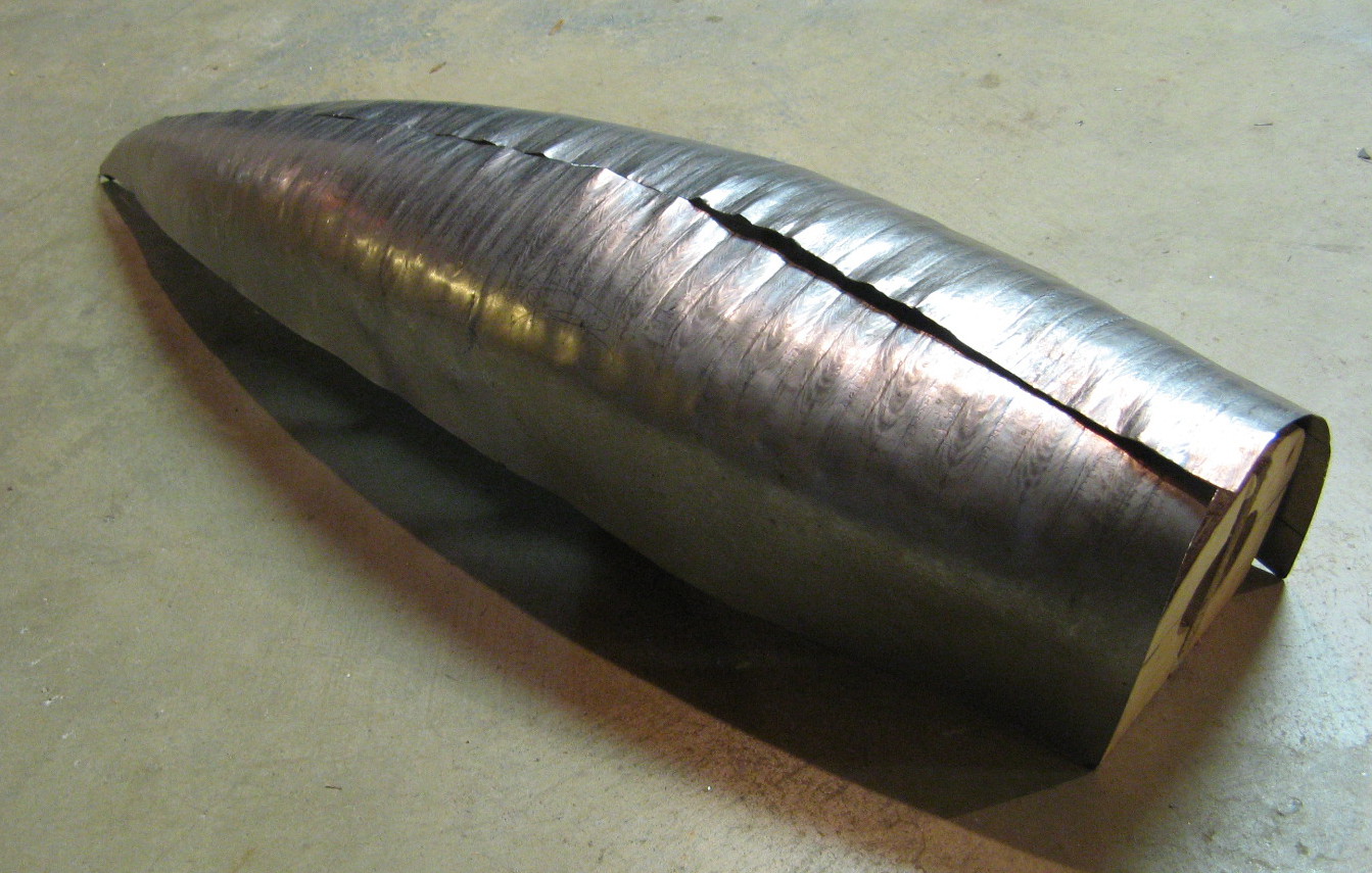

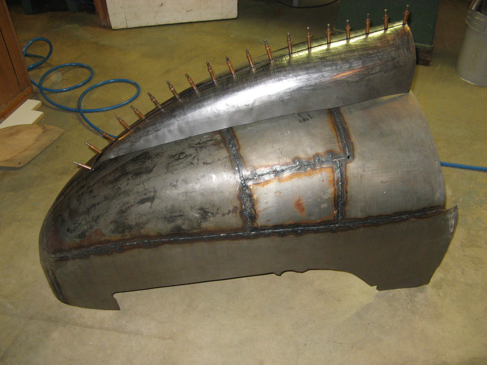

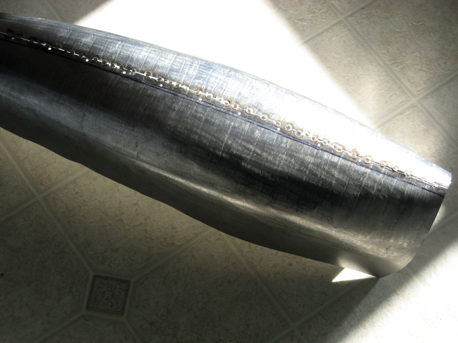

    I **** weld using tabs offset with a bead roller. Similar technique - same result.
