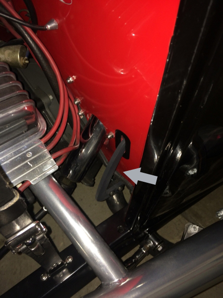

    I've owned this '32 Ford for a couple of years and I've posted all the brake issues I've had with it since the day I bought it. First and foremost the front disc brakes would eventually lock up and I'd have to open a caliper bleeder to relieve the pressure, then I was good for a little while. The car never did stop that great but worked well enough to drive. I replaced calipers, front hoses, the line flares were poorly done so I replaced all the brake lines and changed residual valves. I even added a proportioning valve for the rear drum brakes but still it didn't brake worth a ****. Upon digging into the problem I found that the power booster rod was advanced well into the MC giving it a preload which was the reason for the brakes building pressure and locking up the brakes. Two days ago I was thinking that I needed to look elsewhere so I unbolted the master cylinder and set it on wood blocks so I could see the power booster rod. When I depressed the brake pedal the booster rod protruded barely 3/8". The problem was all in the pedal because it would bottom out on the bottom of the car (when idle) and when pushed all the way in it wouldn't throw the rod far enough into the MC. I pulled the pedal ***embly off and cut it so that it had approx three inches sticking out from under the firewall. I drilled two 1/4" holes in it 1" apart. Then I cut the curved end of the pedal at the base to open up the upright angle and then "m***aged" the curve that enter the firewall. I added about three inches of steel to the pedal end. I welded the **** out of the pedal once I had my clearances and cleaned everything up. Sandblasted it and painted it. Once dry, I bolted the two together with (2) 1/4"-20 SS nuts and bolts and now the rod extend almost 1". So the original builder didn't have his ratio correct and didn't bother fixing it but rather preloaded the booster rod so the brakes would stop the car. Thanks for everyone's advice and if you're in the same boat with your brakes check out how far the brake stroke is because you might have a similar situation. I feel stupid that I didn't check it first but it just didn't dawn on me that someone could have gotten this so wrong when putting the car together. (See pics, the before photo was taken when the builder was finishing the car)

    Glad you got it figured out. One thing i would be concerned with are the two 1/4 inch bolts 1" apart holding the pedal arm together near the pivot point. I think I'd be inclined to use larger diameter bolts.

    Weld it, , the shear strength of 2 1/4-20's ain't enuf.

    I replaced them with 3/8” SS bolts... good call, thanks!

    The problem with welding them is even with taking the steering column out there's not enough clearance to get that ***embly in there in one piece.
