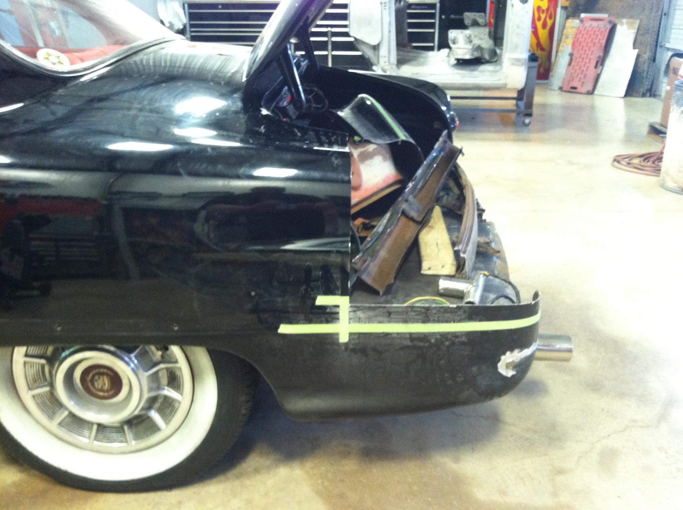

  1. christopher 78
    Joined: Jun 24, 2012
    Posts: 136
    christopher 78
    This one got smashed during the LSRU by a uninsured ***!

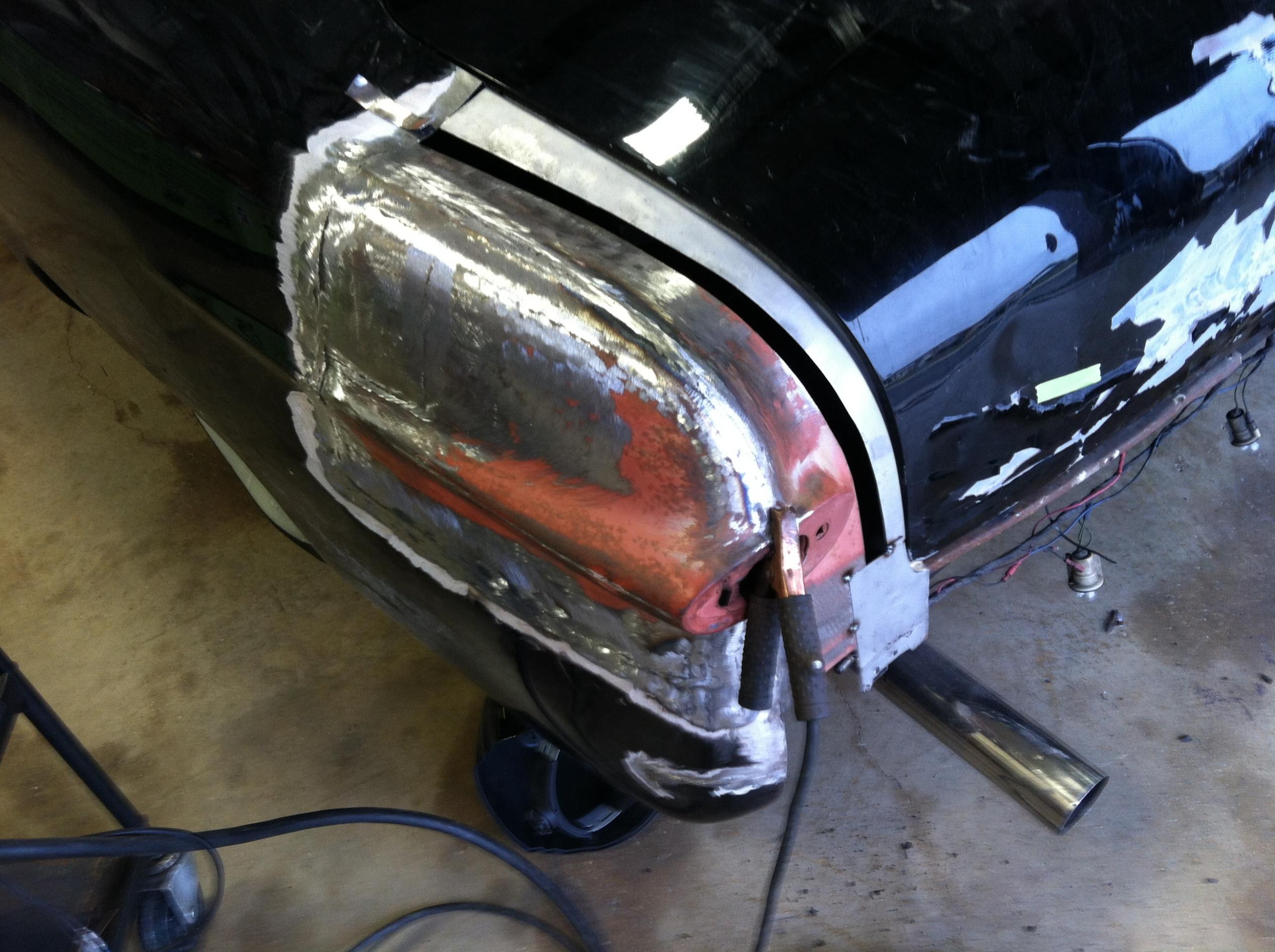

  2. christopher 78
    Posts: 136
    christopher 78
    Another pic!

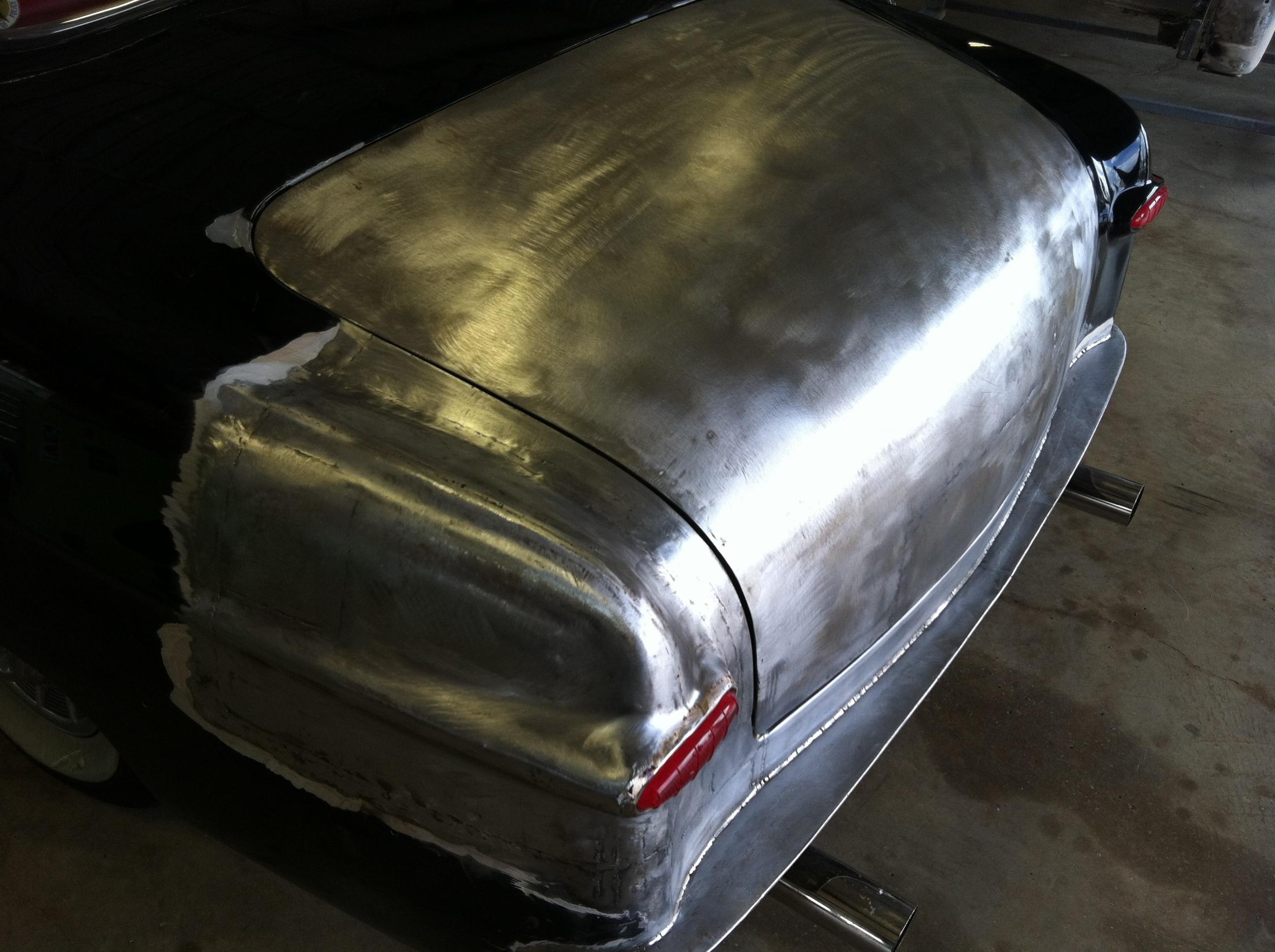

  3. christopher 78
    Posts: 136
    christopher 78
    some progress !

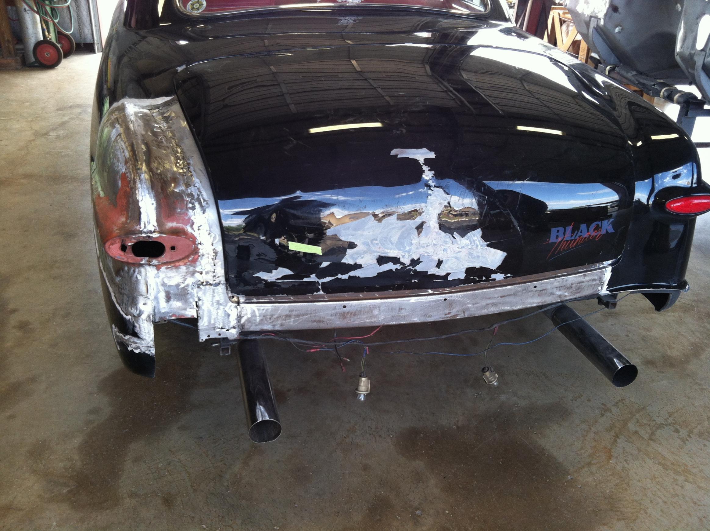

  4. christopher 78
    Posts: 136
    christopher 78
    skinned the bottom of the outer skin on the deck lid and sectioned the shell 3 in. And fixed some poor patch work. Built a nicer filler for bumper and frenched the taillight to match the other side.
