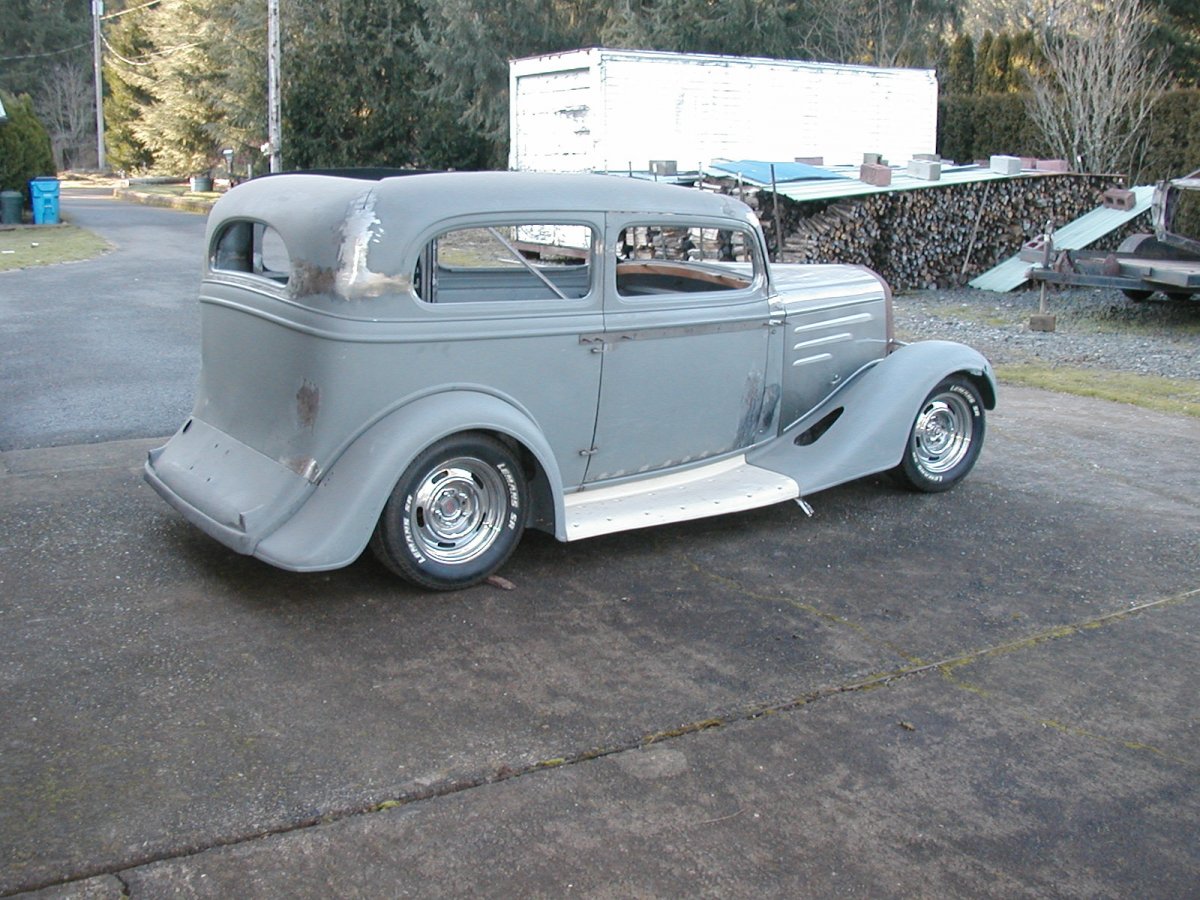

    Your right, there is quite a bit more involved than just getting the door in the opening. I spent a lot of time pushing and pulling and hammering things around to get everything squared up. So far I think I have more time in squaring stuff up and bracing it than I do in actual fabrication work. There doesn't appear to be an instruction manual on piecing one of these back together, so I am just making things up as I go.

  5. One of the things I discovered by accident was the 2 doors had different arch's top to bottom on the B post edge. That was very clear when I leaned the doors against the wall B edge to B edge. That was a Holly Cow moment. Explained partly why I couldn't get a good X number at the B pillar on the body. And it went on and on. I can understand how your feeling right about now.

  6. 33 chev parts are very hard to come by, especially rear fenders !! I hope you picked them up from behind the car , even if your not going to use them .
    Are you going to make you own trunk lid or do you have one ?

    Yes I have all the fenders, I never throw anything away no matter how rough.
    I will be making my own trunk lid, I have the original hinges but nothing else.

    Hey how did you make that rear rain gutter? Shrinker strecher to get it to turn? I have to do the same thing.

    Basically. I made it out of 2 L shaped halves, shrinker stretched them to contour, and then welded the 2 sections together.
