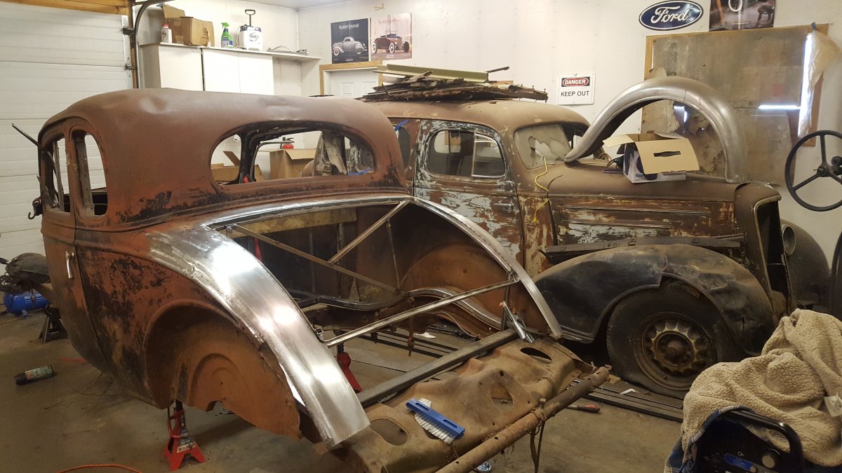

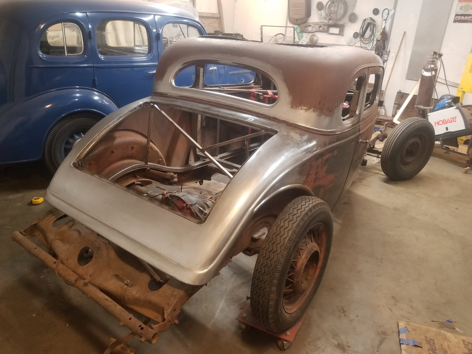

    UPDATE!
    Well obviously I lost interest and this ones been sitting in the back corner of my garage for the past 4 years being used as a junk shelf and an engine stand. I finally dragged it out a couple weeks ago and tack welded some axles under it so I could dump it outside because I need the space...then I got inspired and figured I should just finish getting some of the metalwork roughed in and then find it a new home instead of letting it rot in my backyard for eternity. I finished building the back of the body and got it all welded together, then did a bunch of other random stuff including a 3" chop last week. There's a few more things left to finish up in the next couple days then I'm going to be finding this one a new home, now I kind of hate to see it go because I've been enjoying working on it, but realistically I need the space and cash right now haha, plus it deserves better than to collect dust in my garage or rot outside.

  17. Love that you kept the back window full sized ,I dont know why some guys chop thru the back window and they look like **** ...

    Far better than a lot of car stuff on TV!!!!!!!!!!!!! Thanks for taking the time to shoot the video. I judge all 5Window chops by the look of the quarter windows. you got that chop perfect. Good luck with all your future projects.

    Thanks, I ended up taking 1.5" out of the back window just so it would line up with the roof contours better, but I agree. I'd rather do a little more welding than end up with the squashed mail slot look.
