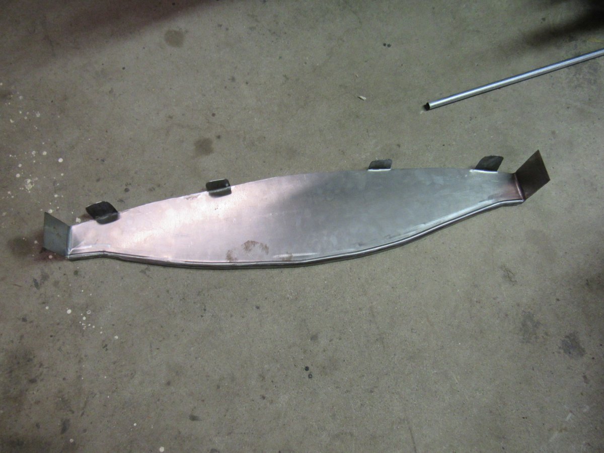

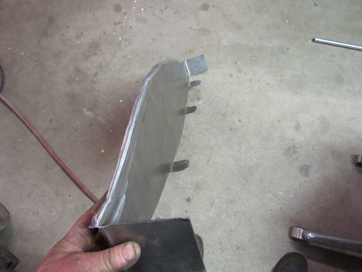

    Charlie wanted to keep the "tunnel" so I trimmed it, added a bolting flange and bolted it to the bottom of the dash. I then made some small pieces of angle to bolt the front of the tunnel to the firewall. IMG_9800.JPG IMG_9801.JPG IMG_9803.JPG IMG_9805.JPG

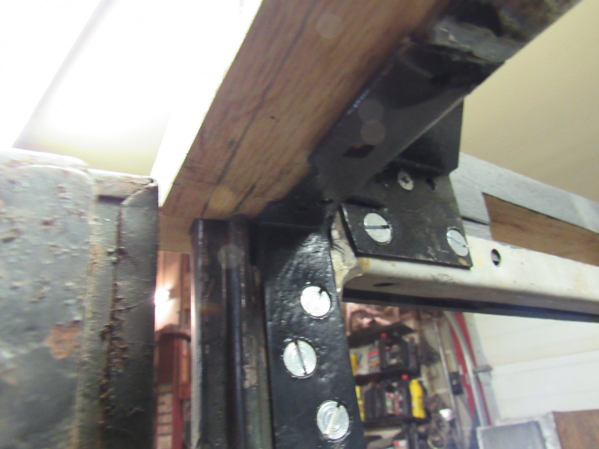

    I went ahead and put the header in place and put the flat head bolts in. I am using flat washers and regular nuts. IMG_9844.JPG
    IMG_9845.JPG IMG_9846.JPG it also gets one wood screw through the bracket

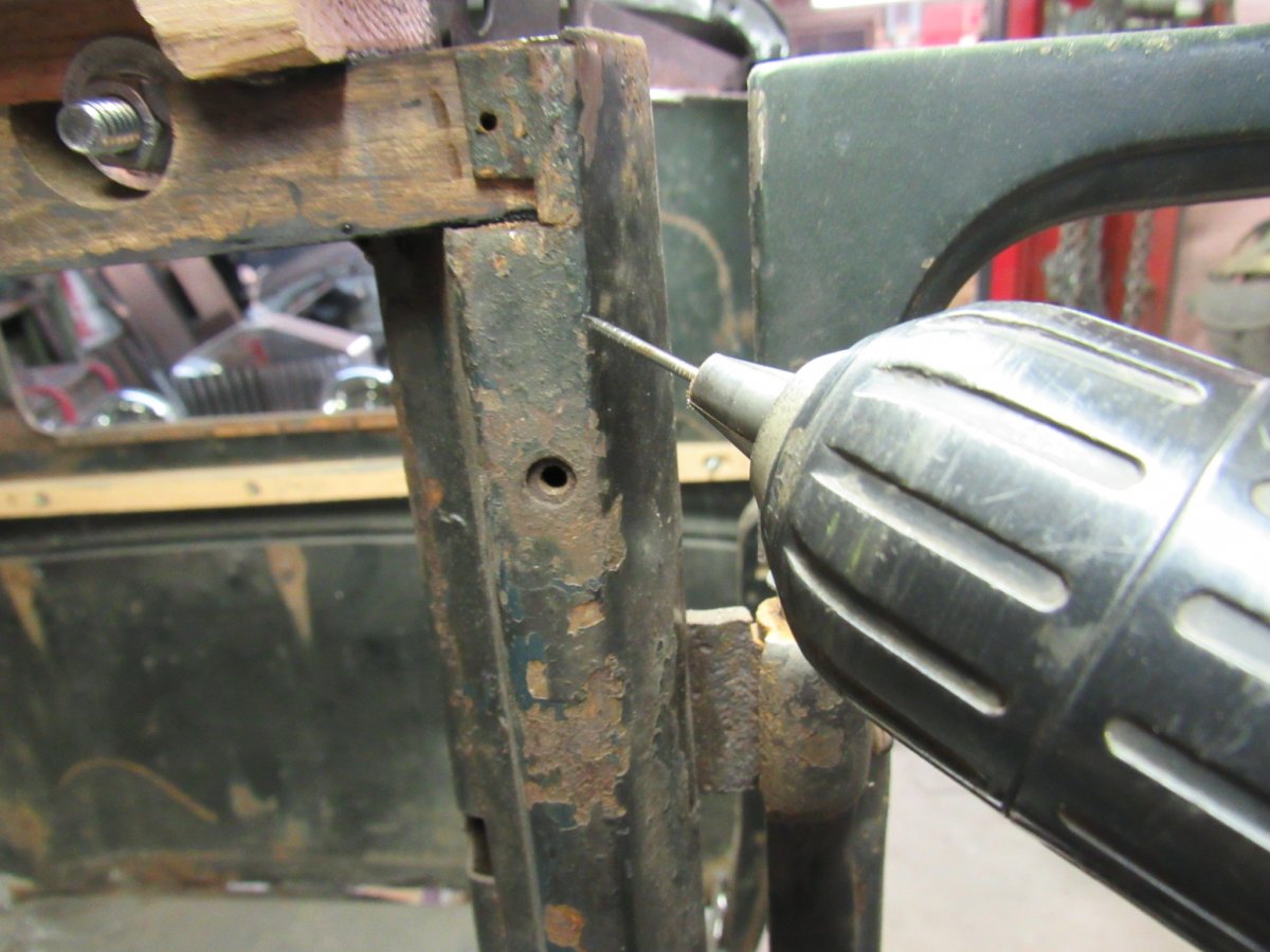

    the post sheet metal gets a nail to hold it to the wood. I cut a head off of one of the nails and used it to "drill" a pilot hole. this is the way a boat/woody car builder I know told me to do it. IMG_9847.JPG IMG_9848.JPG
    kiwijeff, Thor1, brad2v and 9 others like this.
  7. Johnny Gee
    Joined: Dec 3, 2009
    Posts: 15,000
    Johnny Gee
    from Downey, Ca
    ^^^^^ It's also a great trick in wood working when doing fine molding.
    kiwijeff, OFT, Stogy and 2 others like this.
  8. harley jim
    Joined: Mar 12, 2012
    Posts: 591
    harley jim
    We use the same nail in the drill trick to install hardwood trim like oak baseboards.
    The truck is coming along nice.
    Sent from my SM-A102U using Tapatalk
    Stogy, loudbang and tb33anda3rd like this.

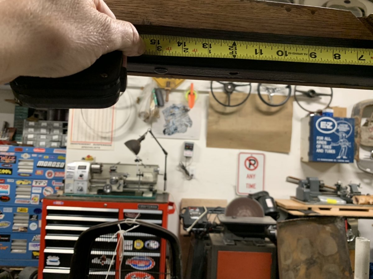

  13. 31Apickup
    Joined: Nov 8, 2005
    Posts: 3,769
    31Apickup

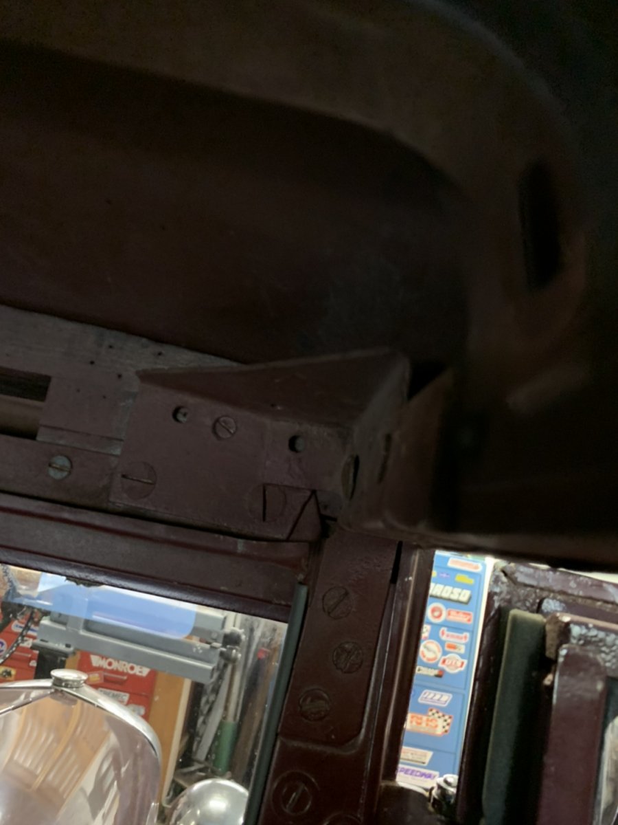

    They’re 14.75” in, here’s a picture of them in my coupe, bit dark, but measure the same on the pickup. Also the corner brackets go behind the angle. IMG_0946.JPG IMG_0947.JPG

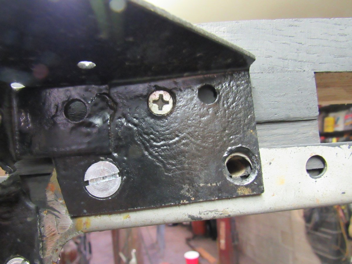

  15. 31Apickup
    Joined: Nov 8, 2005
    Posts: 3,769
    31Apickup
    I did a lot of research on those. The outer hole on the angle across has a taper hole for the screw while the bracket does not. When ***emble the other way the taper screw doesn’t fit properly and there is also a gap on the bracket.
  16. 31Apickup
    Joined: Nov 8, 2005
    Posts: 3,769
    31Apickup

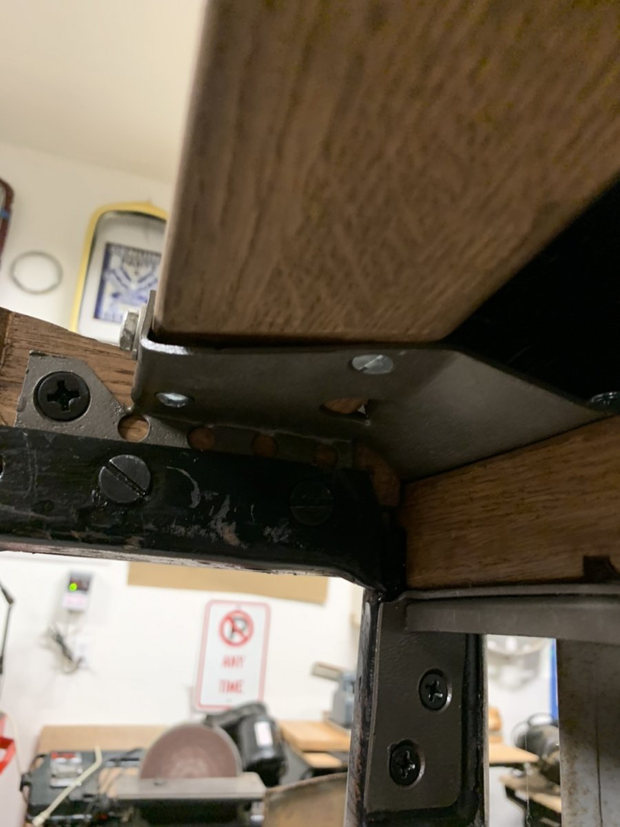

    I could be mistaken for the pickup. My pickup is a late 31 with the steel roof, they have to go on the outside, but the brackets were tapered on the outside as compared to the coupe, should have looked there first. IMG_0949.JPG

  17. tb33anda3rd
    Joined: Oct 8, 2010
    Posts: 17,595
    tb33anda3rd
    this truck the bracket goes like we have it, like your coupe. you can see the taper on the bracket. there is a bump for clearance of the carriage bolts in the square holes. IMG_9850.JPG IMG_9853.JPG

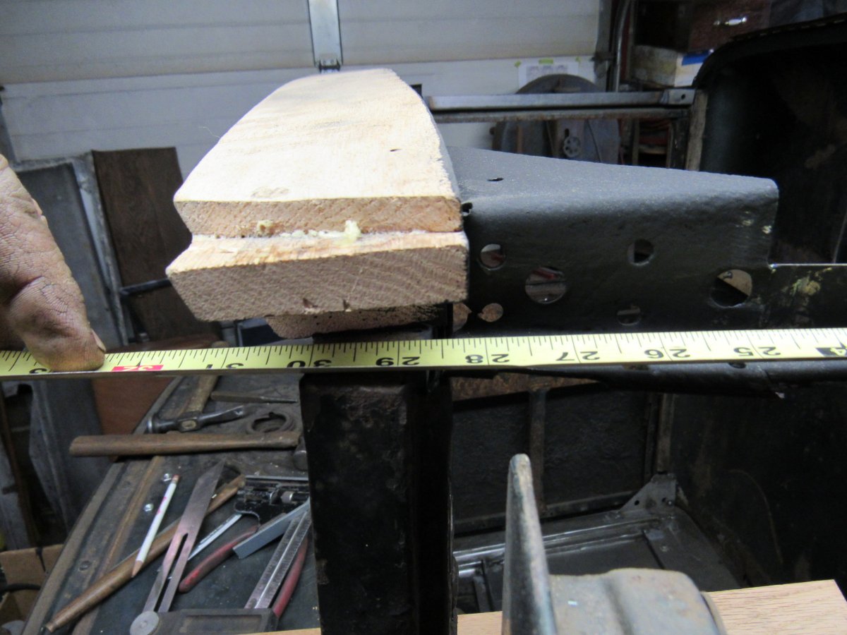

    I started making the board that goes over the driver door. I used my angle finder to get the proper angle against the header, then measured the distance from the back end against the door jamb. I marked the piece and measured the depth of the rabbet. IMG_9854.JPG

  19. tb33anda3rd
    Joined: Oct 8, 2010
    Posts: 17,595
    tb33anda3rd
    instead of walking down to the house [300 ft.] to cut this on my wood bandsaw I just cut this with a hack saw. I cut it big and finished the fitting with a rasp. IMG_9858.JPG IMG_9859.JPG

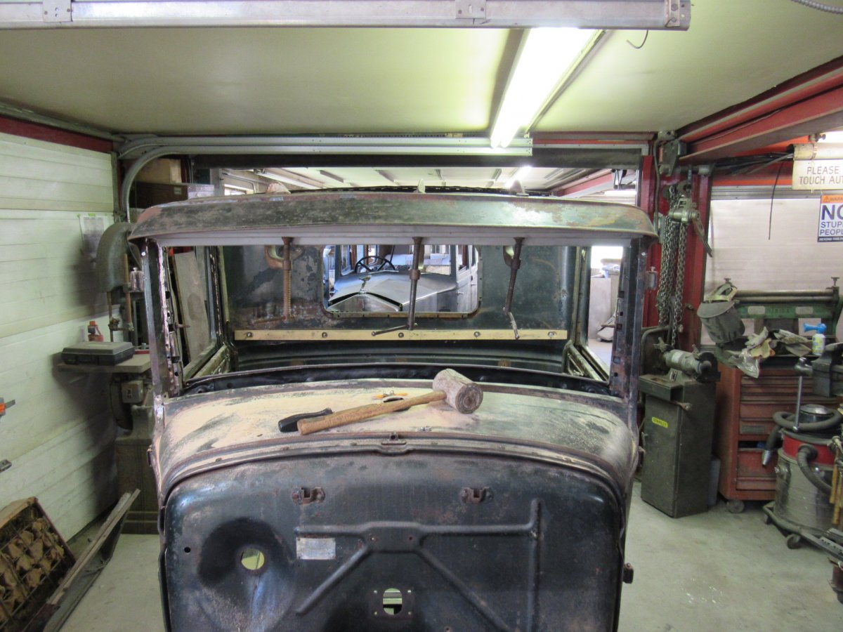

    with both pieces in place I trimmed the over hang on the front then fitted the filler panel over the windshield. I blasted the panel. I then cut the pieces over the door about a 1/8" away from the line I marked. I will use the sander to get them to the right size . both pieces had almost the exact same profile which leads me to believe we have the truck pretty squared up. IMG_9866.JPG IMG_9867.JPG IMG_9864.JPG IMG_9865.JPG IMG_9868.JPG IMG_9869.JPG

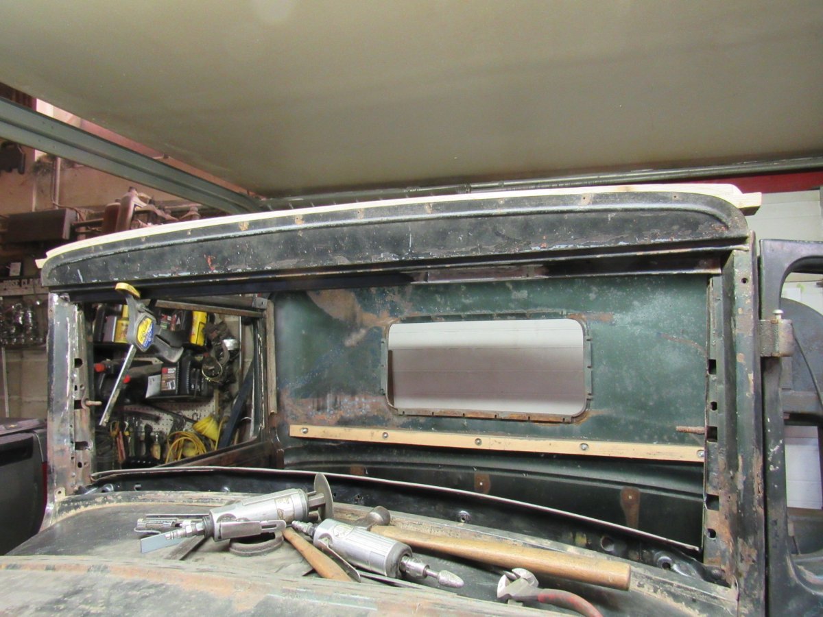

    I clamped them together and sanded them to the same shape, then clamped and bolted them in place. started sanding the header to the proper shape. IMG_9870.JPG

    sanded the header and fit the panel over the windshield. the header needed to be sanded to get the correct shape for the visor. once the visor was clamped on it needed to be shaped to square up. it had a bad twist. IMG_9873.JPG IMG_9873.JPG IMG_9874.JPG IMG_9876.JPG

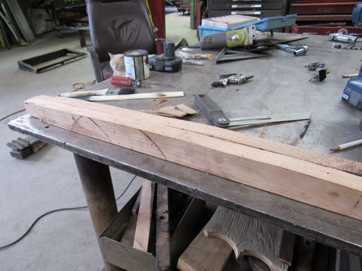

  26. tb33anda3rd
    Joined: Oct 8, 2010
    Posts: 17,595
    tb33anda3rd

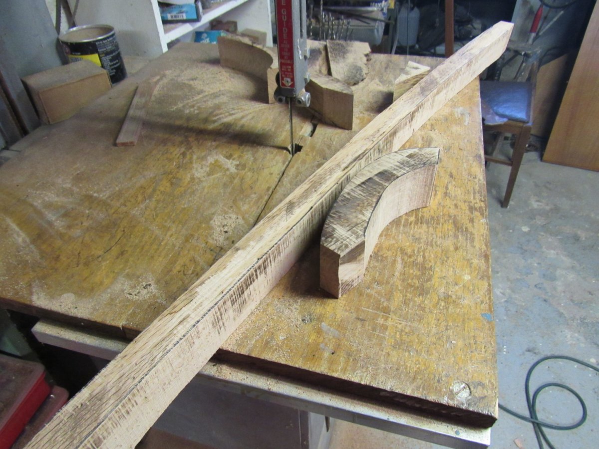

    I then traced out the old piece that went over the back of the cab and made a template for the corner pieces. then cut them on the bandsaw. IMG_9880.JPG

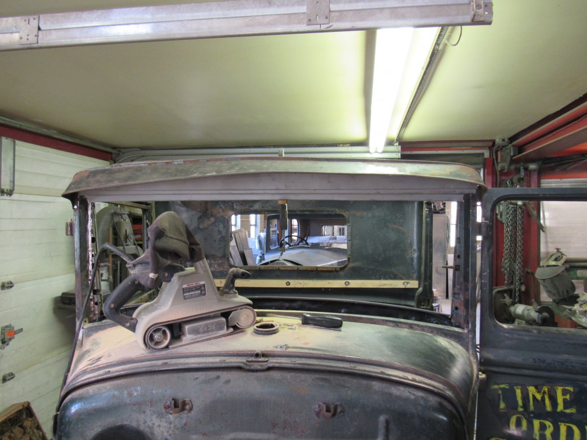

  30. tb33anda3rd
    Joined: Oct 8, 2010
    Posts: 17,595
    tb33anda3rd
    I am not sure if this is a photo of me after sanding, or getting ready to go grocery shopping. IMG_9875.JPG
