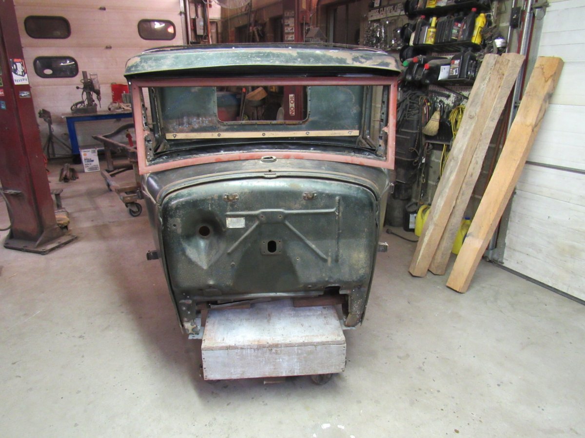

    I screwed the cab down to a lower cart I have, this will allow me to finish the top wood and fit the windshield without climbing. IMG_9938.JPG IMG_9939.JPG
    off the frame, the door alignment is still right on and they open and close as they should.

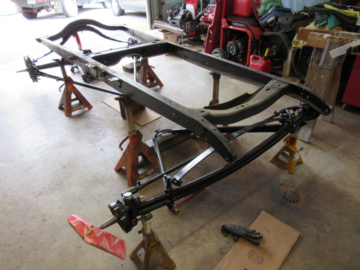

    Charlie was almost all ready for the frame. he still needed to put the front spring together but he was not happy with the condition of the main leaf. we set the Frame on jack stands. IMG_9946.JPG IMG_9949.JPG

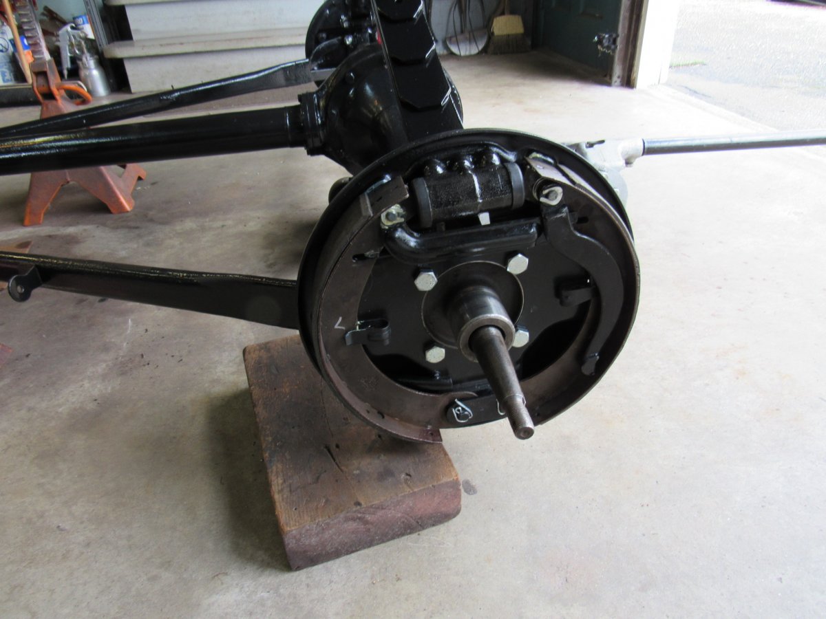

    brakes all done, front end ready for final ***embly. IMG_9950.JPG IMG_9951.JPG

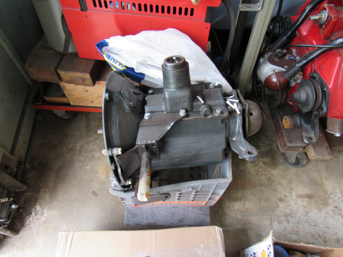

    the slacker has the motor and ****** waiting for when the rolling ch***is is done. IMG_9947.JPG

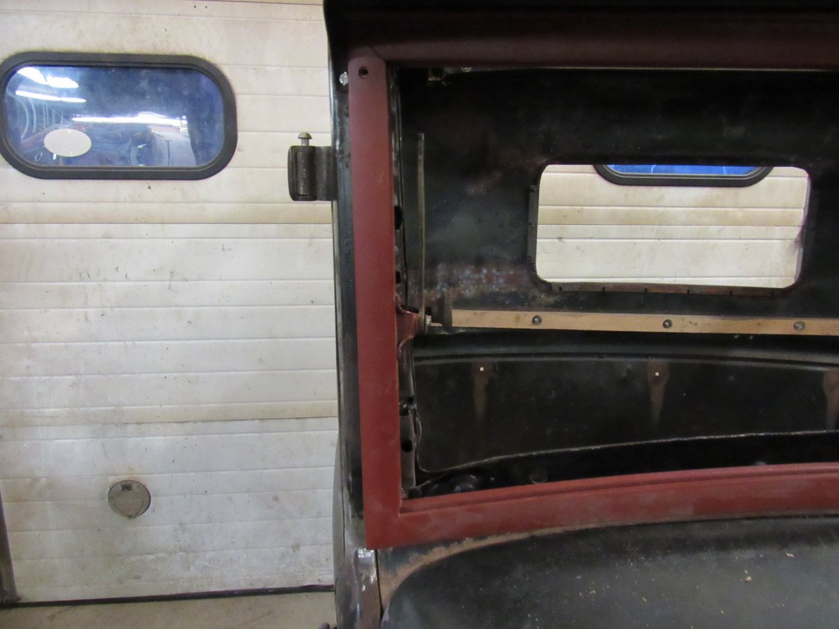

    removed the hinge from the windshield frame, clamped it to the body, predrilled holes and put all the screws in. IMG_9954.JPG IMG_9955.JPG IMG_9956.JPG
    TFoch, OFT, loudbang and 5 others like this.
  17. tb33anda3rd
    Joined: Oct 8, 2010
    Posts: 17,595
    tb33anda3rd
    I took all the screws out
    IMG_9957.JPG the hinge had quite a bend in it when it was slid out of the frame. I straightened it by hand and put it back on the frame.

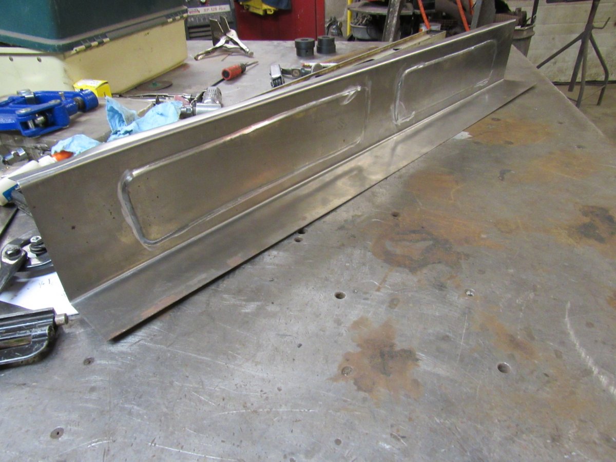

    felt like bending up a little sheet metal tonight so I started making a new seat riser. got three of the pieces done. IMG_9974.JPG IMG_9975.JPG IMG_9976.JPG

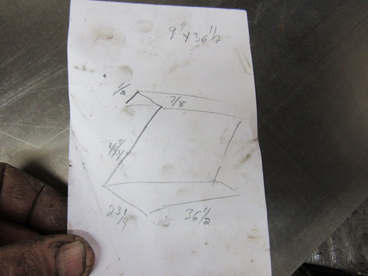

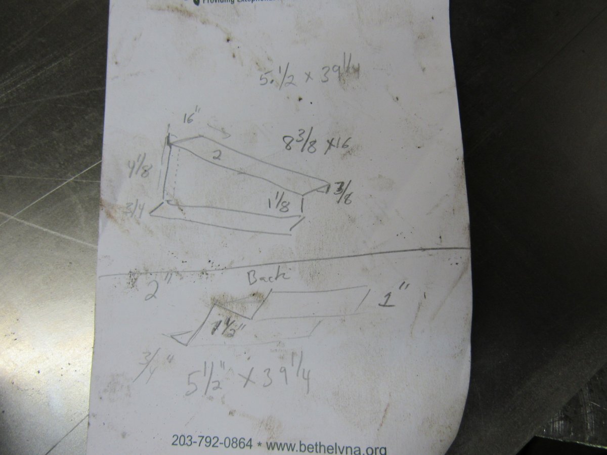

  23. tb33anda3rd
    Joined: Oct 8, 2010
    Posts: 17,595
    tb33anda3rd
    here are the drawings and measurements I made to make these pieces. IMG_9978.JPG IMG_9979.JPG

  25. tb33anda3rd
    Joined: Oct 8, 2010
    Posts: 17,595
    tb33anda3rd
    I used the bead roller to make the raised portion and then neatened it up with the hammer. IMG_9981.JPG IMG_9982.JPG IMG_9983.JPG
    chryslerfan55, brEad, OFT and 5 others like this.
