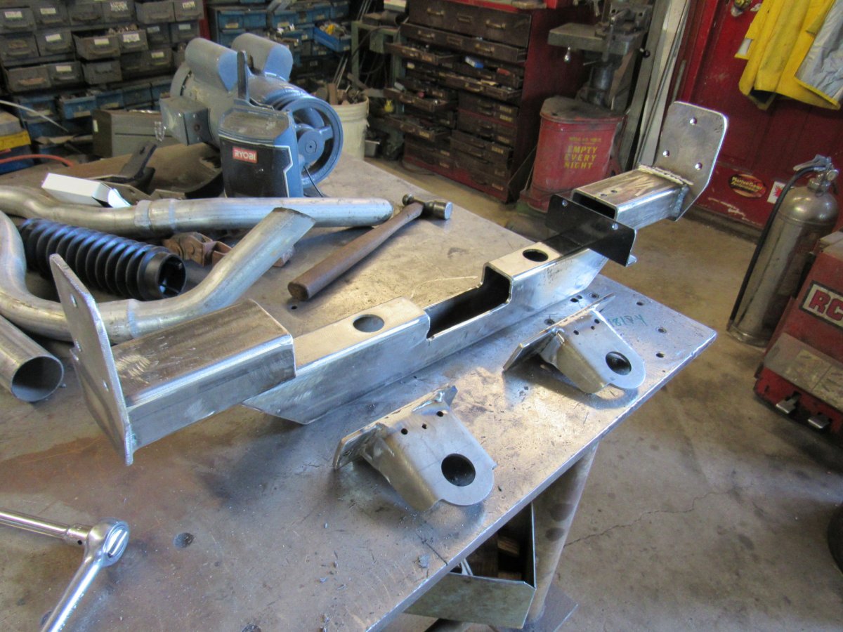

    Charlie came by today with the cross member arts he made to install the flat head and later 3 speed. it is the first time in two months he has seen the truck cab. we mocked up his crossmember on an old piece of model A ch***is I had. he had measurements off certain bolt holes and we duplicated it's location on this frame. I cut out some side brackets and tacked them to his crossmember. IMG_0168.JPG IMG_0169.JPG IMG_0170.JPG IMG_0171.JPG

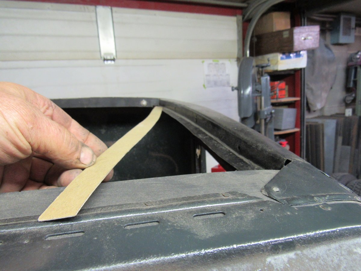

    I had a little time left tonight so I made a template for the two side top members. IMG_0176.JPG

    the Slacker took the crossmember home and it fit almost perfectly. pretty amazing that the chunk of frame I had matched his as well as it did. after some final set up he brought it back, with the front motor mounts for me to weld up. IMG_0179.JPG IMG_0180.JPG

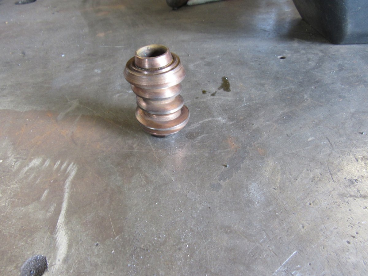

    I had given the slacker a '51 ford pickup steering box with the shaft cut off. he found a 36 ford pickup shaft and worm but the worm gear wasn't right. so we pressed off the cut shaft, pressed off the 36 worm, then pressed the '51 worm onto the 36 shaft. Charlie made a set of blocks that clamped to the shaft, loosely, to remove the worms, then tightly to install the worm. IMG_0186.JPG IMG_0187.JPG IMG_0188.JPG

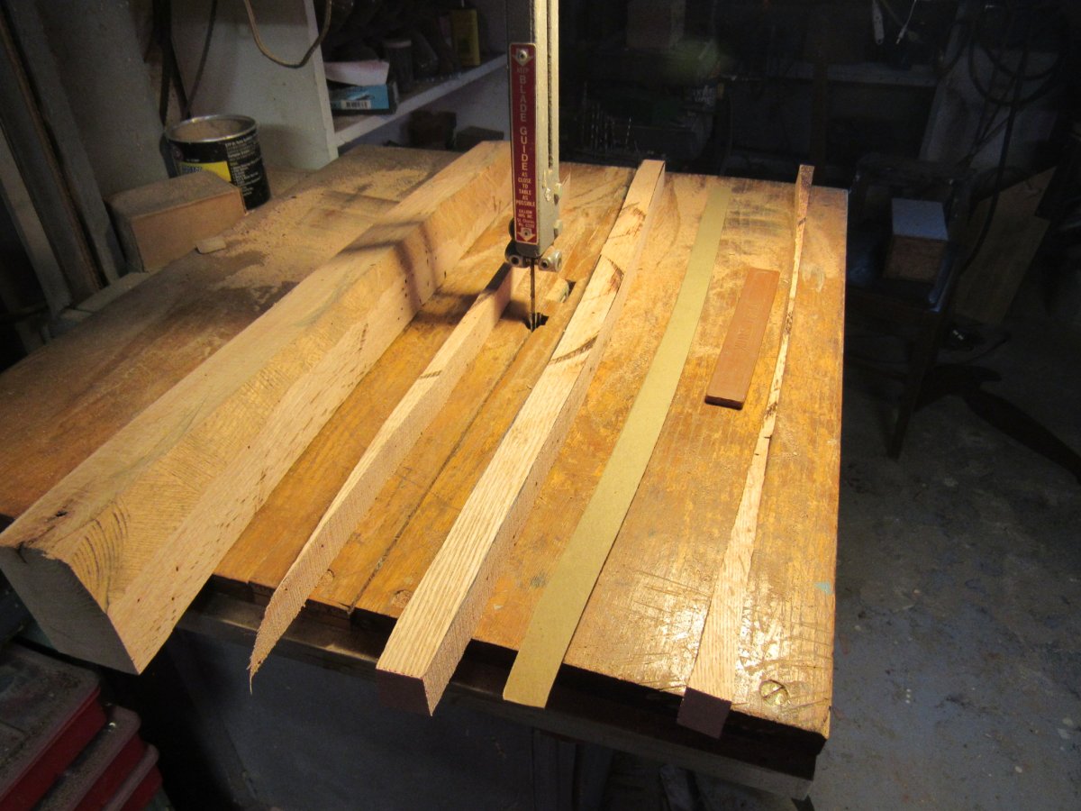

  20. tb33anda3rd
    Joined: Oct 8, 2010
    Posts: 17,595
    tb33anda3rd
    I also cut the two pieces that run front to back along the sides of the roof opening. IMG_0192.JPG

  23. tb33anda3rd
    Joined: Oct 8, 2010
    Posts: 17,595
    tb33anda3rd
    that whole band saw is made from wood. it must have been a "kit" from many years ago. Charlie found it at the transfer station and grabbed it for me. it works pretty good and was built and designed well........could something like that kit be sold today? I doubt it with the "too much work, just buy one from china" mentality.

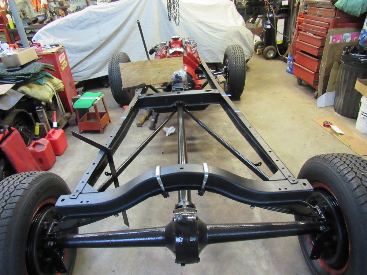

    stopped at "Charlie's garage tonight to check progress. IMG_0237.JPG IMG_0238.JPG

    Charlie is battling with exhaust clearance with the steering box IMG_0229.JPG IMG_0230.JPG

    tb33anda3rd
