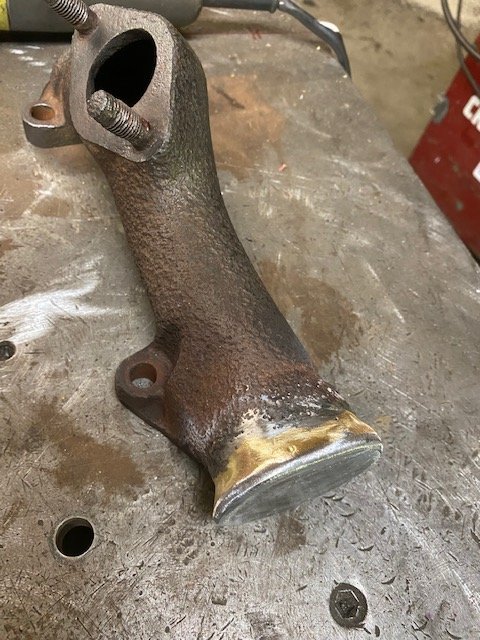

    I cleaned it up. Charlie will make a y pipe that will go from the original outlet and the rear exhaust port towards the rear. image0.jpeg image1.jpeg

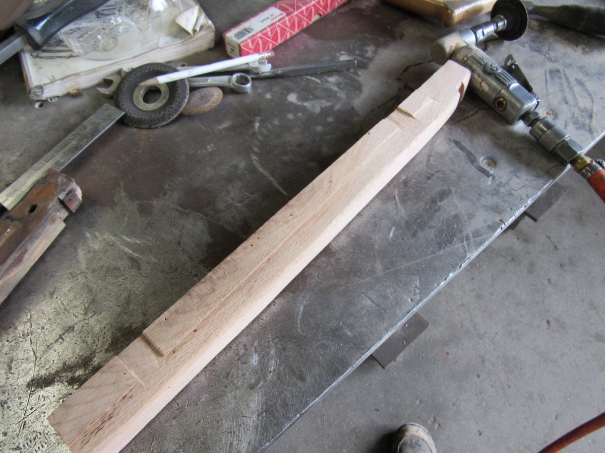

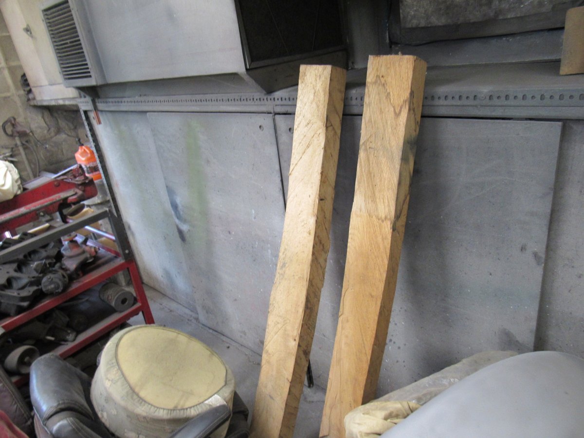

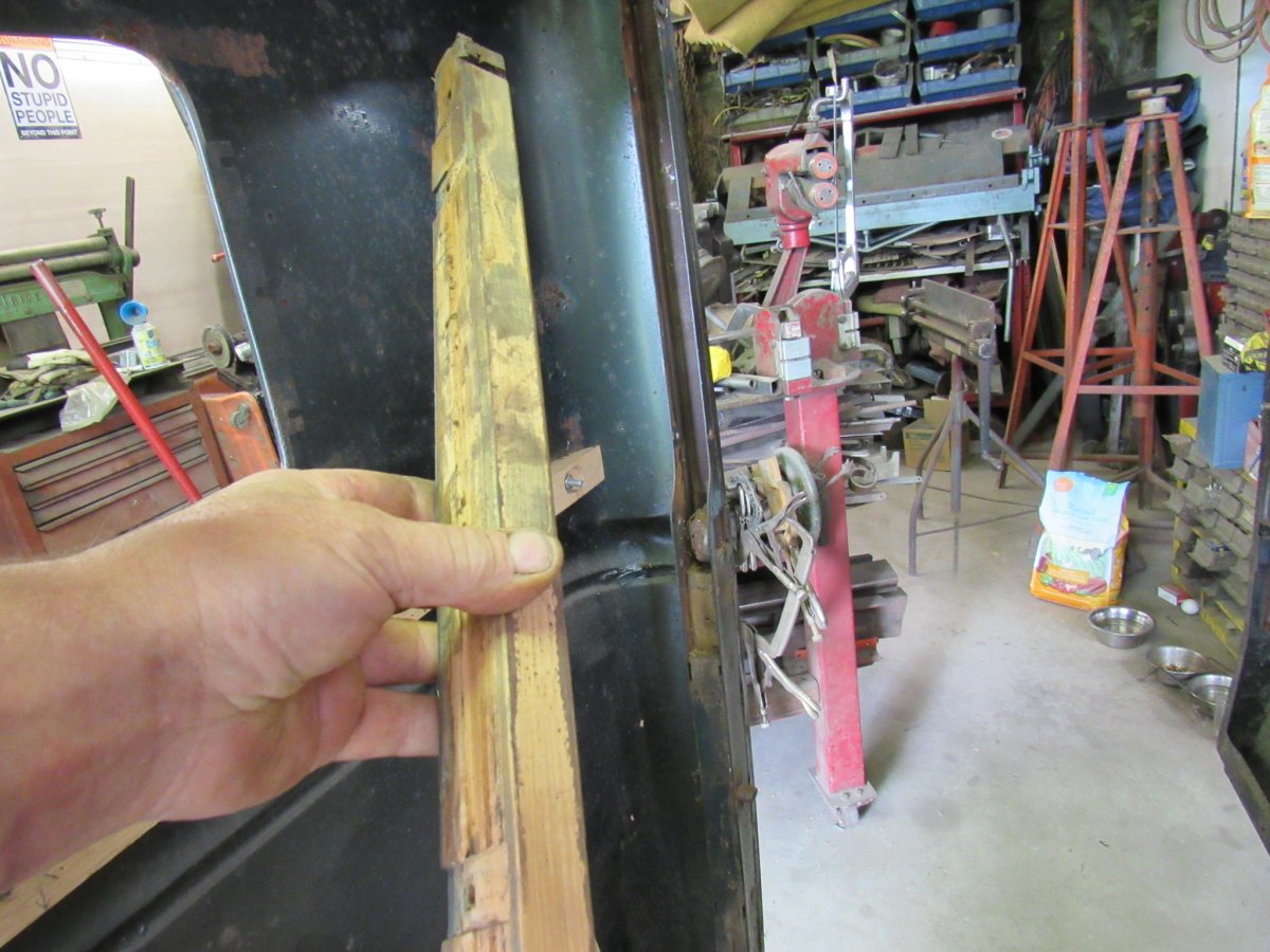

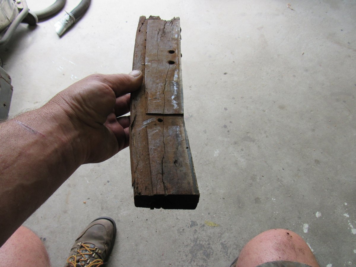

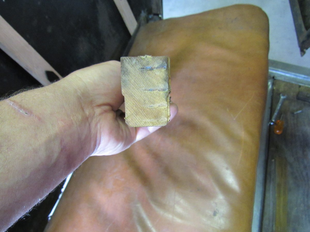

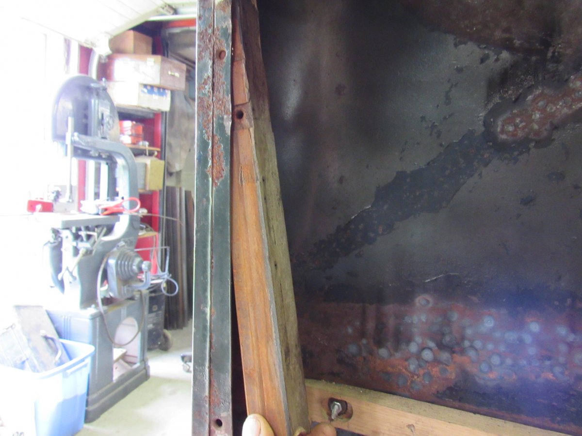

    the final pieces of structural wood left were the pieces that ran up the latch post of the cab. the p***enger side pieces were rotted and broken. I was saving making the upper piece till after it was chopped but Charlie wants to get it together then maybe chop it later. the driver side was in good shape so I could use them as a template. IMG_0280.JPG IMG_0281.JPG IMG_0282.JPG IMG_0283.JPG IMG_0284.JPG

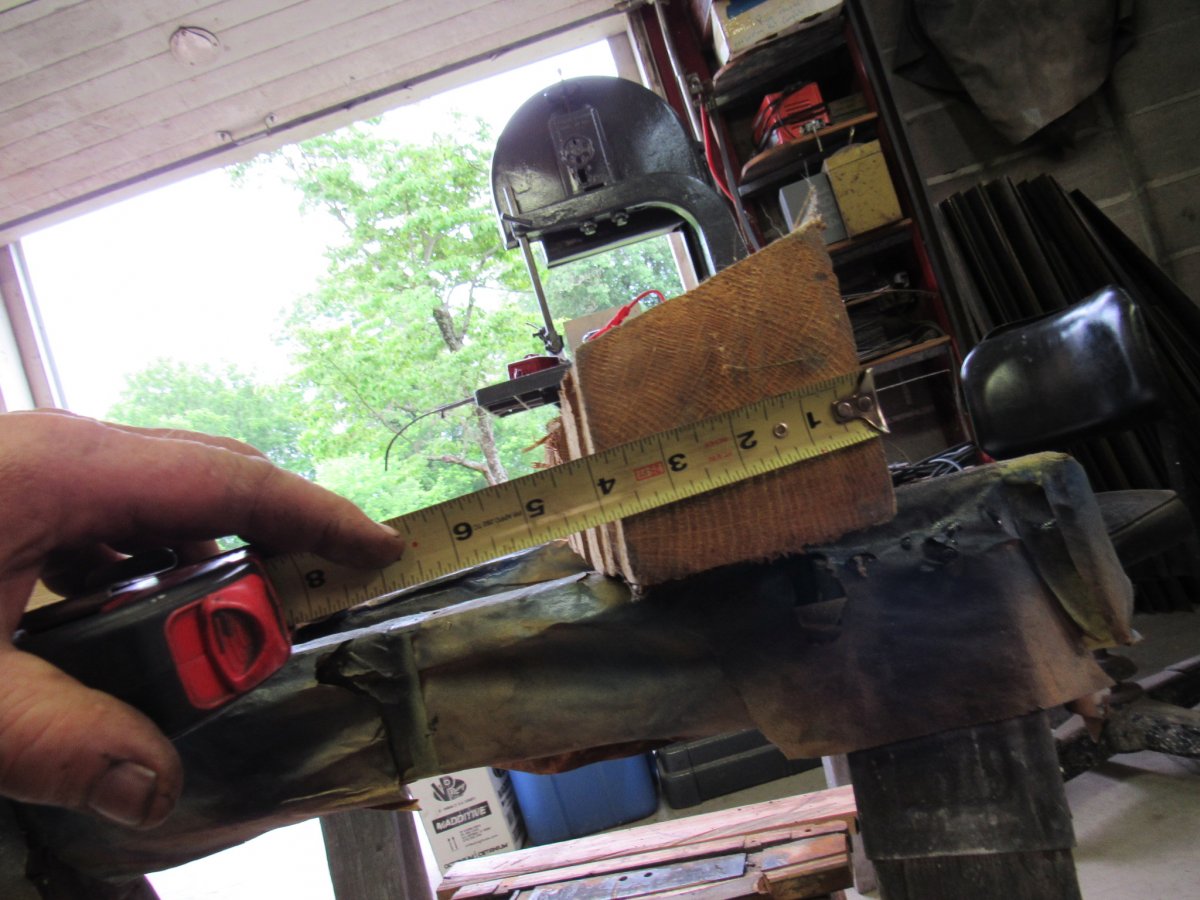

    I had 3 pieces of the tree left and a few cut offs. one of the pieces I cut a section off to make these 4 post pieces, the other half I should be able to get the roof slats out of. the other two chunks we will use to make boards for the bed. IMG_0285.JPG

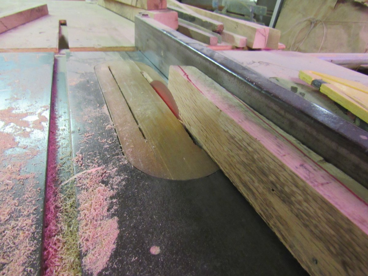

    to make the little rabbit along the edge I set the blade on the table saw to the height and adjusted the fence to hold the depth. IMG_0289.JPG IMG_0290.JPG
