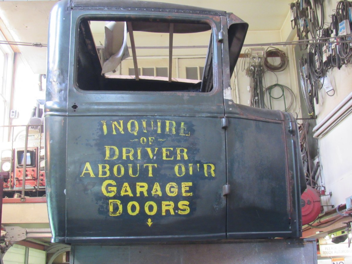

  5. tb33anda3rd
    Joined: Oct 8, 2010
    Posts: 17,592
    tb33anda3rd

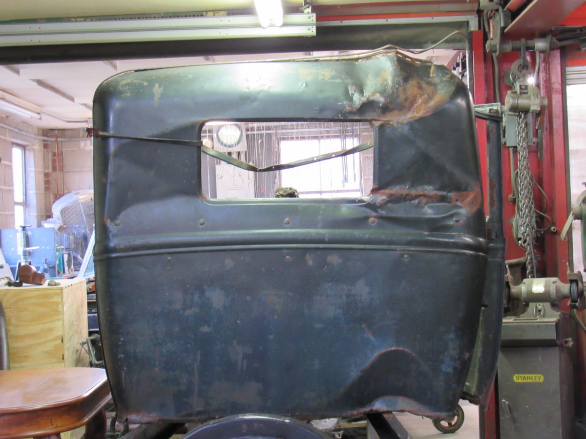

    Charlie dropped off his camera for me to get photos out of it. here is the truck when the Slacker first saw it. IMG_2404.JPG IMG_2405.JPG IMG_2406.JPG IMG_2408.JPG IMG_2409.JPG IMG_2410.JPG

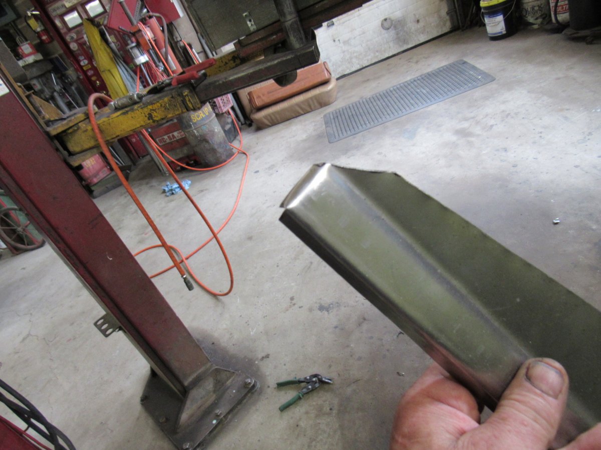

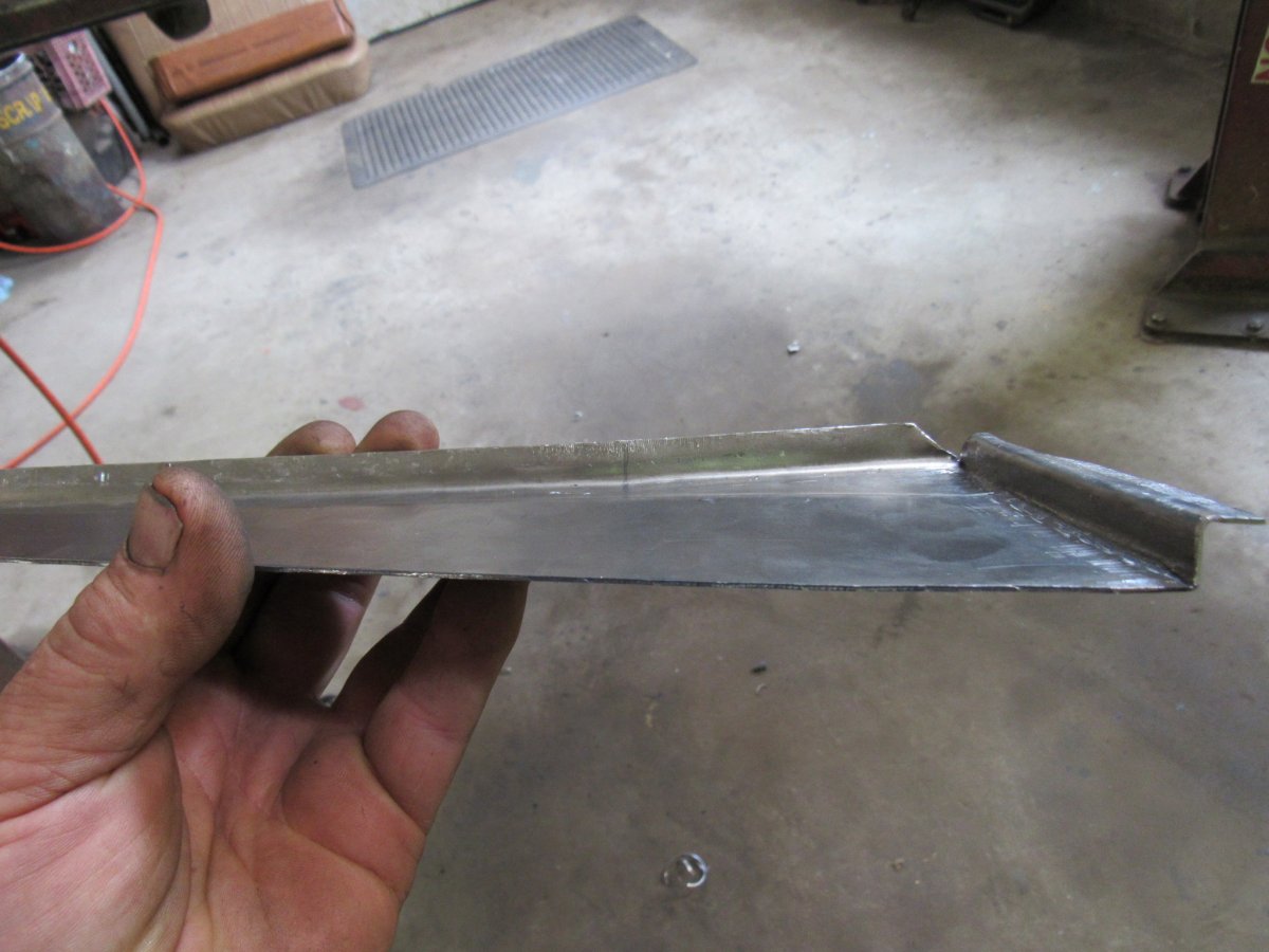

  13. tb33anda3rd
    Joined: Oct 8, 2010
    Posts: 17,592
    tb33anda3rd

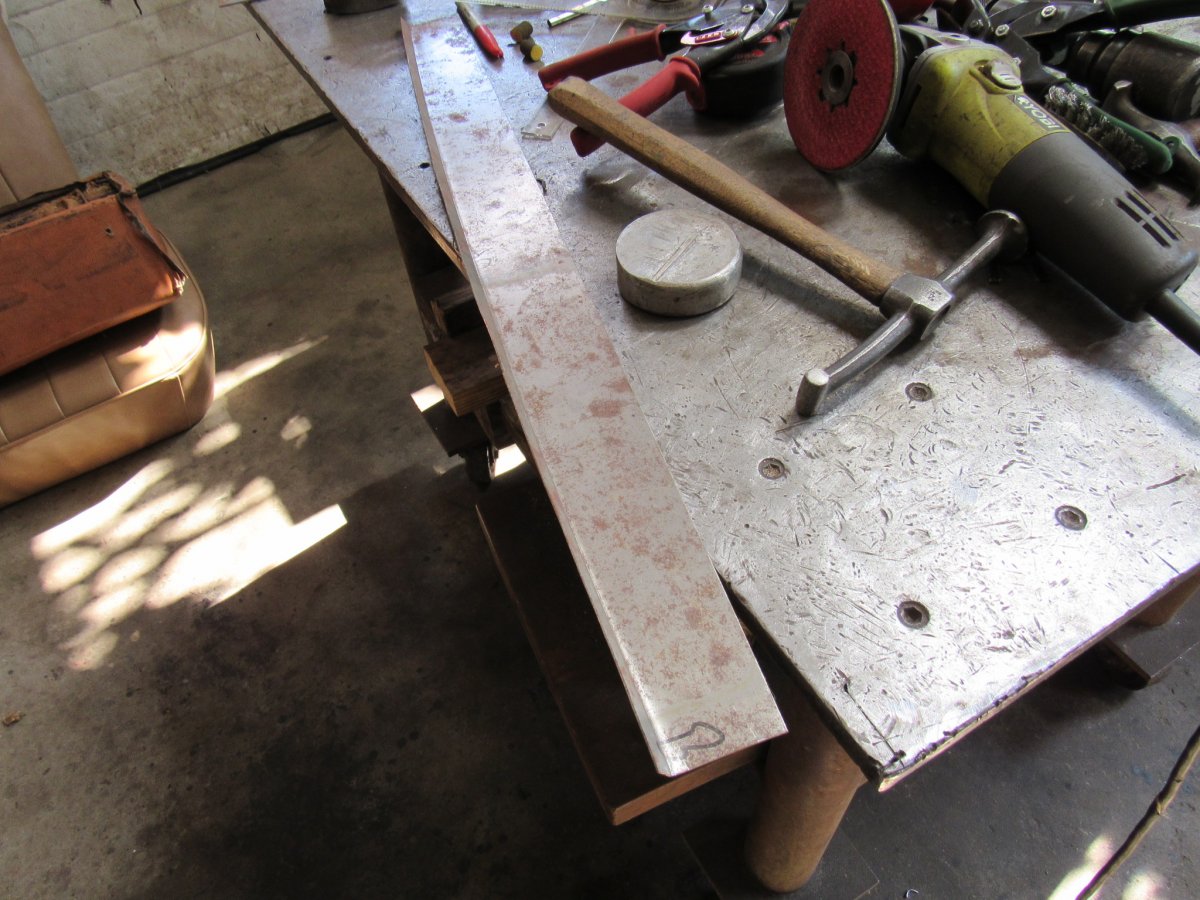

    I made a new one using 16 gage like the original and bent it like I have been doing the beads on the outer. it also needed to shrink the lower flange to follow the cowl. I coated the joining surfaces with weld through primer. when it dried I welded it in. IMG_0402.JPG
  14. tb33anda3rd
    Joined: Oct 8, 2010
    Posts: 17,592
    tb33anda3rd

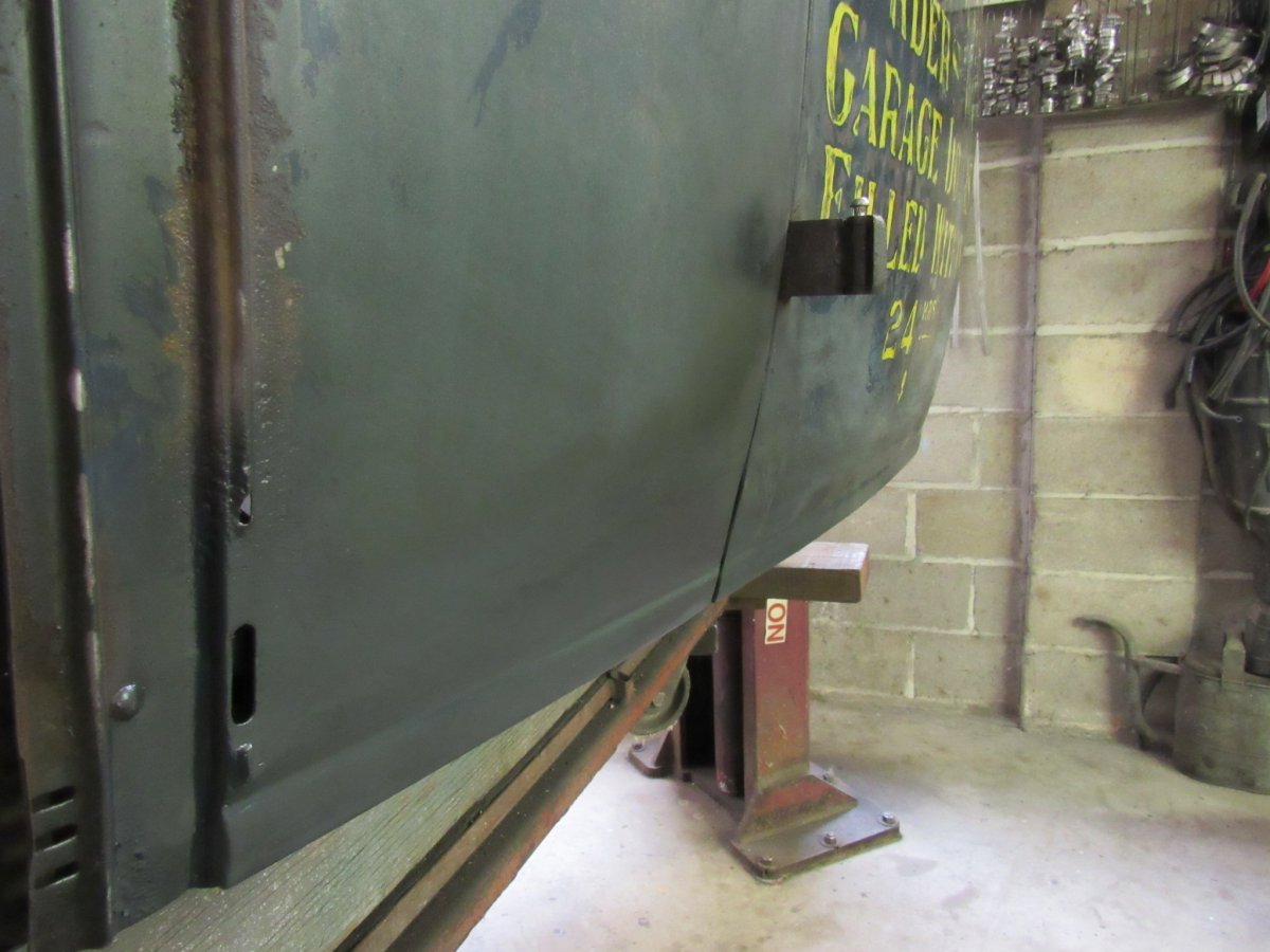

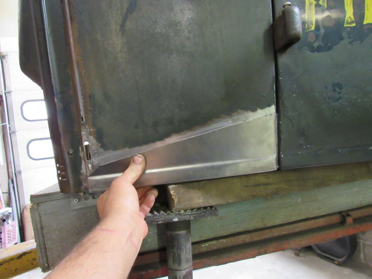

    when I had bent the door patch I used a four foot piece for this whole side. I checked the angle of the bottom of the panel and the door edge . it is slightly off 90 degrees. I bent the ends and trimmed it to fit. IMG_0406.JPG IMG_0408.JPG IMG_0407.JPG
  15. tb33anda3rd
    Joined: Oct 8, 2010
    Posts: 17,592
    tb33anda3rd

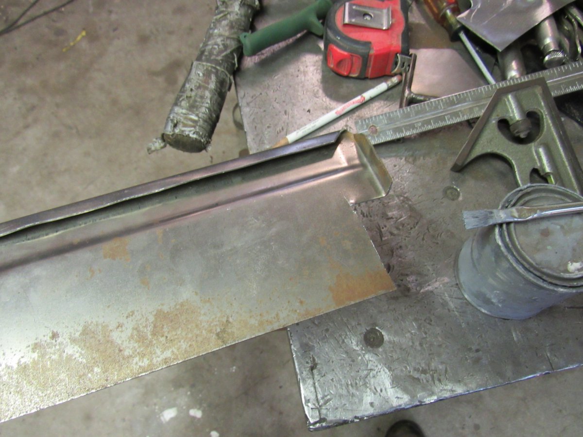

    the piece needed to have a bow in the jamb edge. I shrunk it before I made the second bend. the panel also needed a bend 3 1/4" from the jamb on the bottom edge. I found this by holding a straight edge above the bead. I struck that edge in that spot. trimmed it to fit . IMG_0409.JPG
    cactus1, kidcampbell71, brEad and 8 others like this.

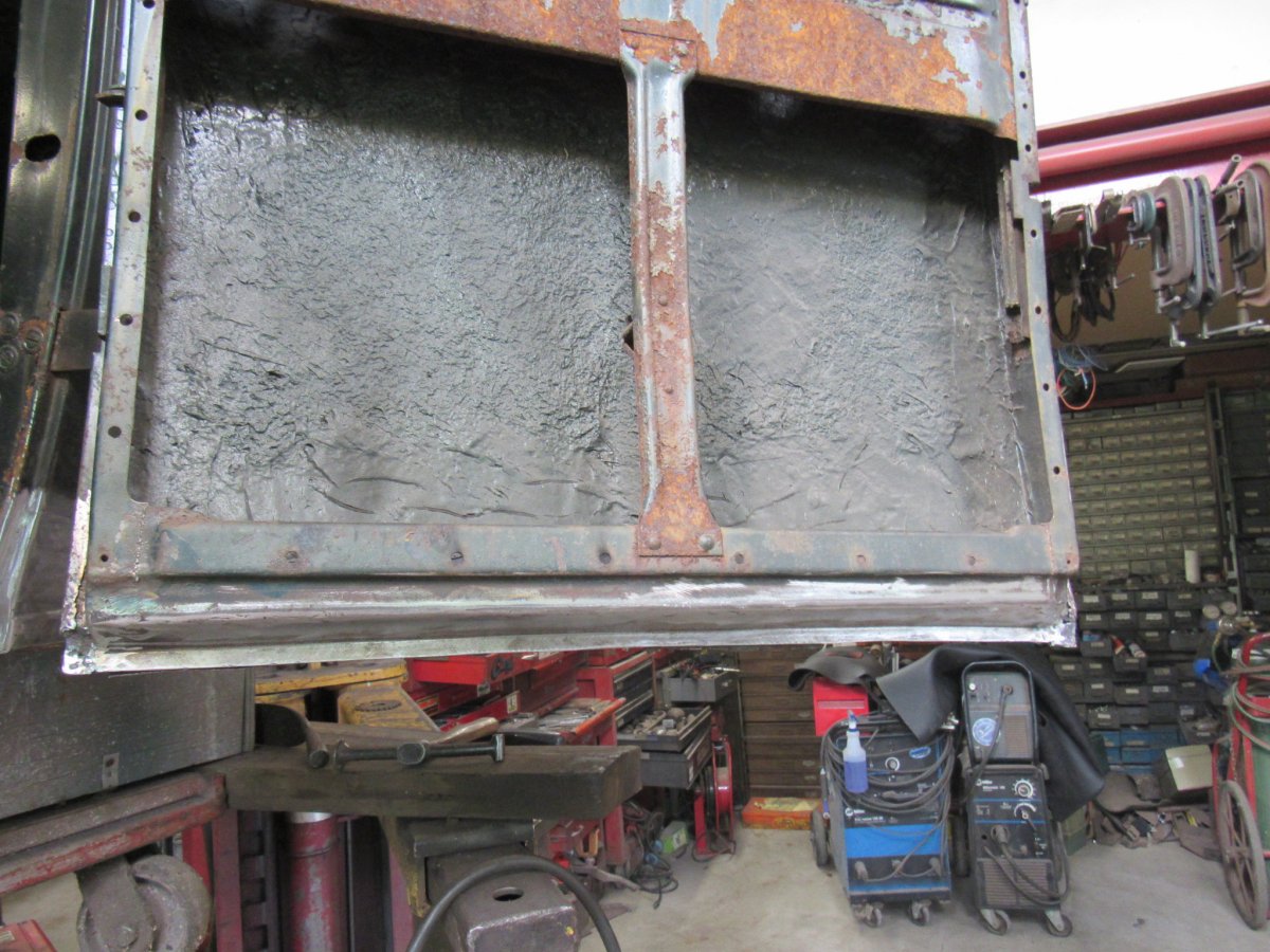

  18. tb33anda3rd
    Joined: Oct 8, 2010
    Posts: 17,592
    tb33anda3rd
    dwollam, kidcampbell71, TFoch and 6 others like this.
  19. tb33anda3rd
    Joined: Oct 8, 2010
    Posts: 17,592
    tb33anda3rd
    inner and outer made, fitted, welded and finish ground. IMG_0423.JPG IMG_0424.JPG

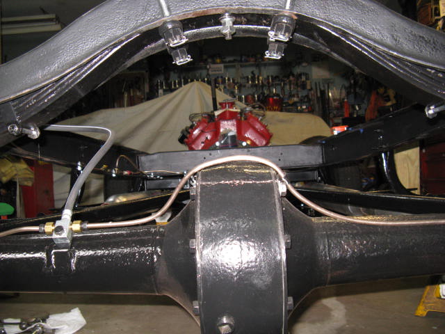

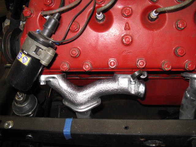

    pictures from Charlie. he has been working on the steering box, exhaust pedals and brake lines. IMG_2472.JPG IMG_2473.JPG IMG_2474.JPG IMG_2476.JPG

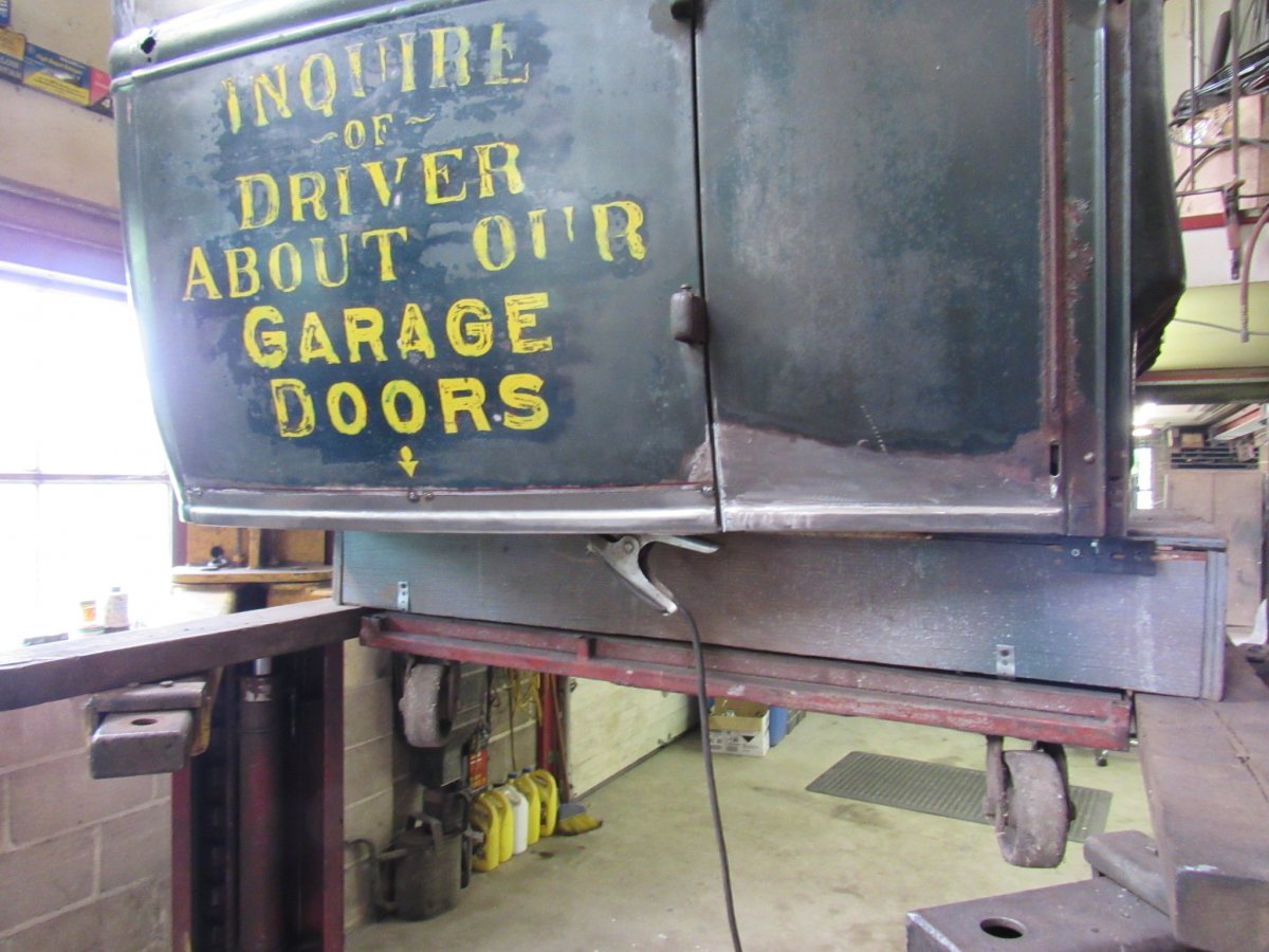

    inner panel was bad on the drivers door. a friend had given Charlie the correct patch panel which I made fit. IMG_0426.JPG IMG_0425.JPG IMG_0429.JPG

  27. tb33anda3rd
    Joined: Oct 8, 2010
    Posts: 17,592
    tb33anda3rd

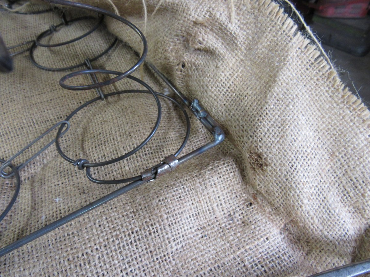

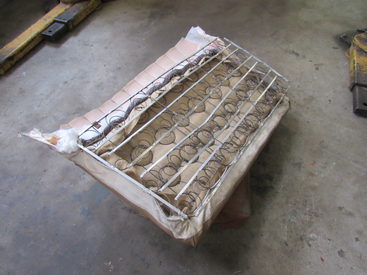

    with all the welding done I decided to cut the coupe seat down so it would fit under the wood on the back of the cab.
    I pulled the hog rings out and peeled back the upholstery on the upper edge. I needed to remove one row of springs so I pried open the clips holding the springs to the frame, cut the vertical supports. IMG_0434.JPG
    dwollam, TFoch, nunattax and 3 others like this.
  29. tb33anda3rd
    Joined: Oct 8, 2010
    Posts: 17,592
    tb33anda3rd
    I cut the metal support rods using the bolt cutters. I removed the section of springs trimmed and welded the outer frame support in the shortened position. IMG_0439.JPG IMG_0440.JPG IMG_0441.JPG
    dwollam, TFoch, brEad and 3 others like this.
  30. tb33anda3rd
    Joined: Oct 8, 2010
    Posts: 17,592
    tb33anda3rd
    I then straightened out the little clips that held the springs and rods on. shortened and bent the support rods and clipped it back together. the rods that slid into the aluminum channel I pinched tight like they had done originally on the piece I removed. IMG_0442.JPG
