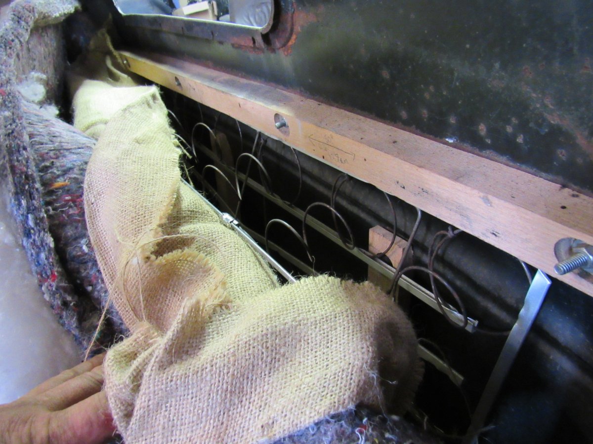

    seat back now fits under the wood brace and rests against the back boards like the original. seat is comfortable for me. not sure how we will finish the upholstery off on the shortened cushion yet. IMG_0447.JPG

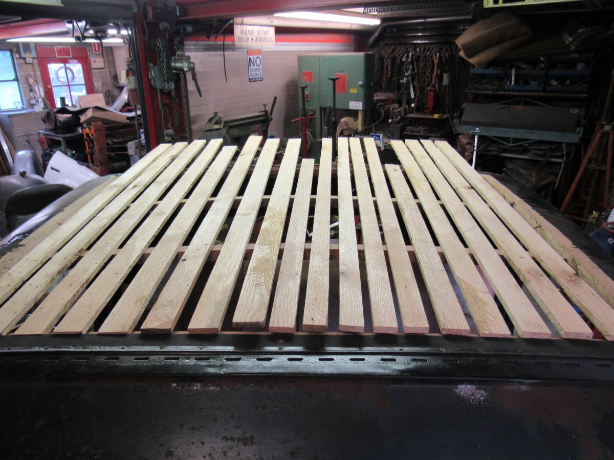

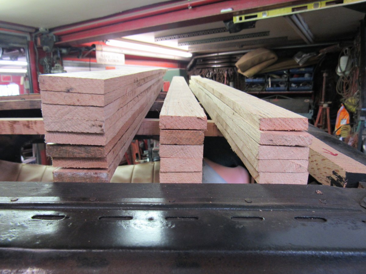

    last project before priming and painting the sub panels and undersides, is fitting the slat wood. I have 3 sizes of strips do to trying to get the most out of the wood I "milled". my plan will be to rip one of the 1 1/2" strips down to 1 1/4" to give me even amounts so I can space them symmetrically . I think I have the math right? IMG_0448.JPG IMG_0451.JPG

    Unbelievable, is there anything you can't do???
    Beside painting wheels RED!;)

    these will be trimmed to fit, sanded and varnished before installation. IMG_0449.JPG

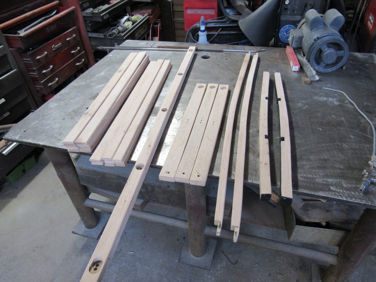

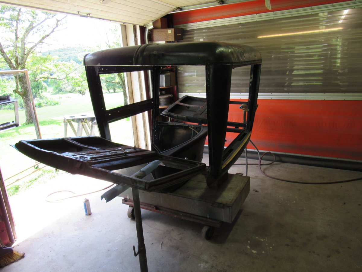

    today I removed all the top wood and cut the slats to length. since the new plan is to finish all the wood that will be exposed I removed the paint from the rear beam and sanded it down. I also removed the seat riser and seat back boards. IMG_0452.JPG IMG_0453.JPG

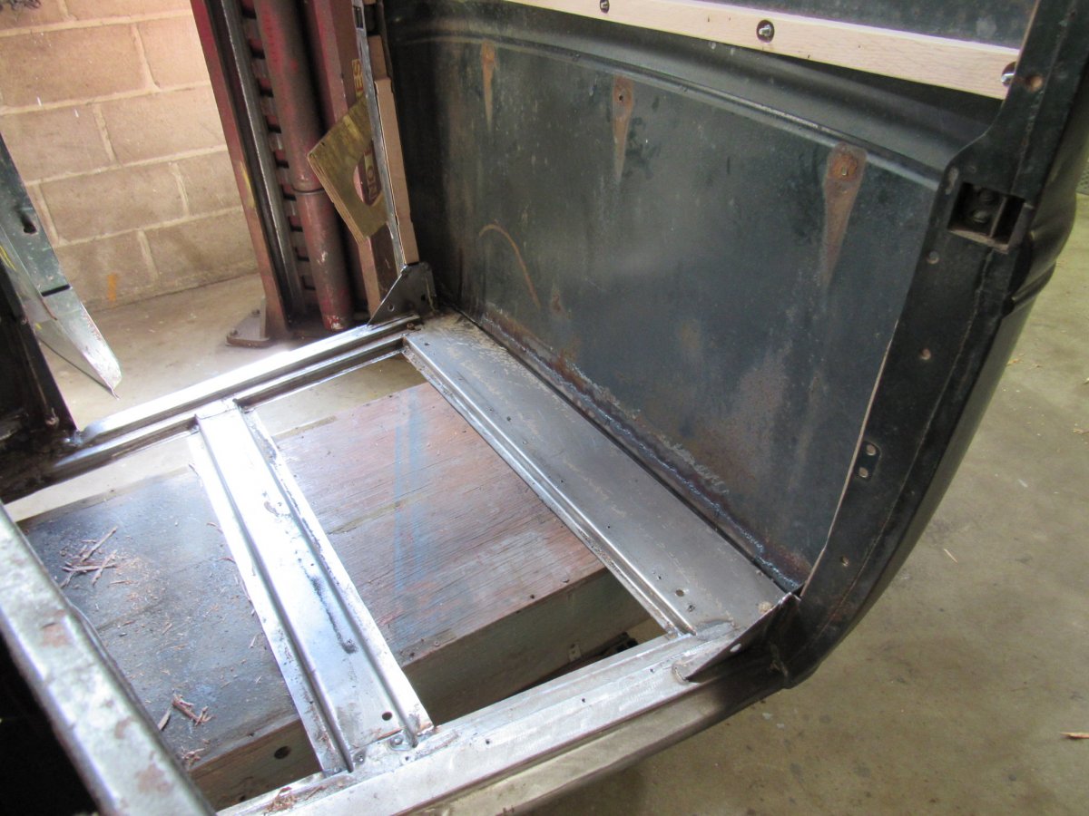

    I then stood the truck up on it's firewall so I could paint the sills top and bottom. I sanded and used a cup brush to clean it up. I also put spot tacks in the bottom lips of the outer panels I made to attach them to the inner panels. I then cleaned up all the welds and under sides IMG_0454.JPG IMG_0455.JPG IMG_0456.JPG IMG_0457.JPG

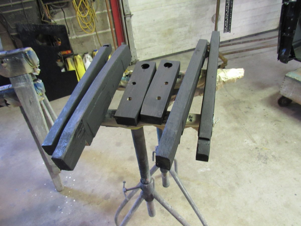

    after thoroughly cleaning I sprayed a polyurethane 2k frame/ch***is blacken the sills and undersides. I then painted the under side of the cowl [inside of original tank] white, which makes it easier to see when working under the dash later. I also paint ed the seat riser, the wood floor board and the pan that goes under the seat. IMG_0457.JPG

    I went through each slat and chose a "good" side to face down. these boards have knots, weird grain and worm holes which should give the truck a little more character. ;) I then sanded all the boards with 180 grit on my DA. I also softened the corners of the slats. with all the fans running in the shop I now have a thorough coating of red oak dust on everything. IMG_0463.JPG IMG_0464.JPG IMG_0465.JPG

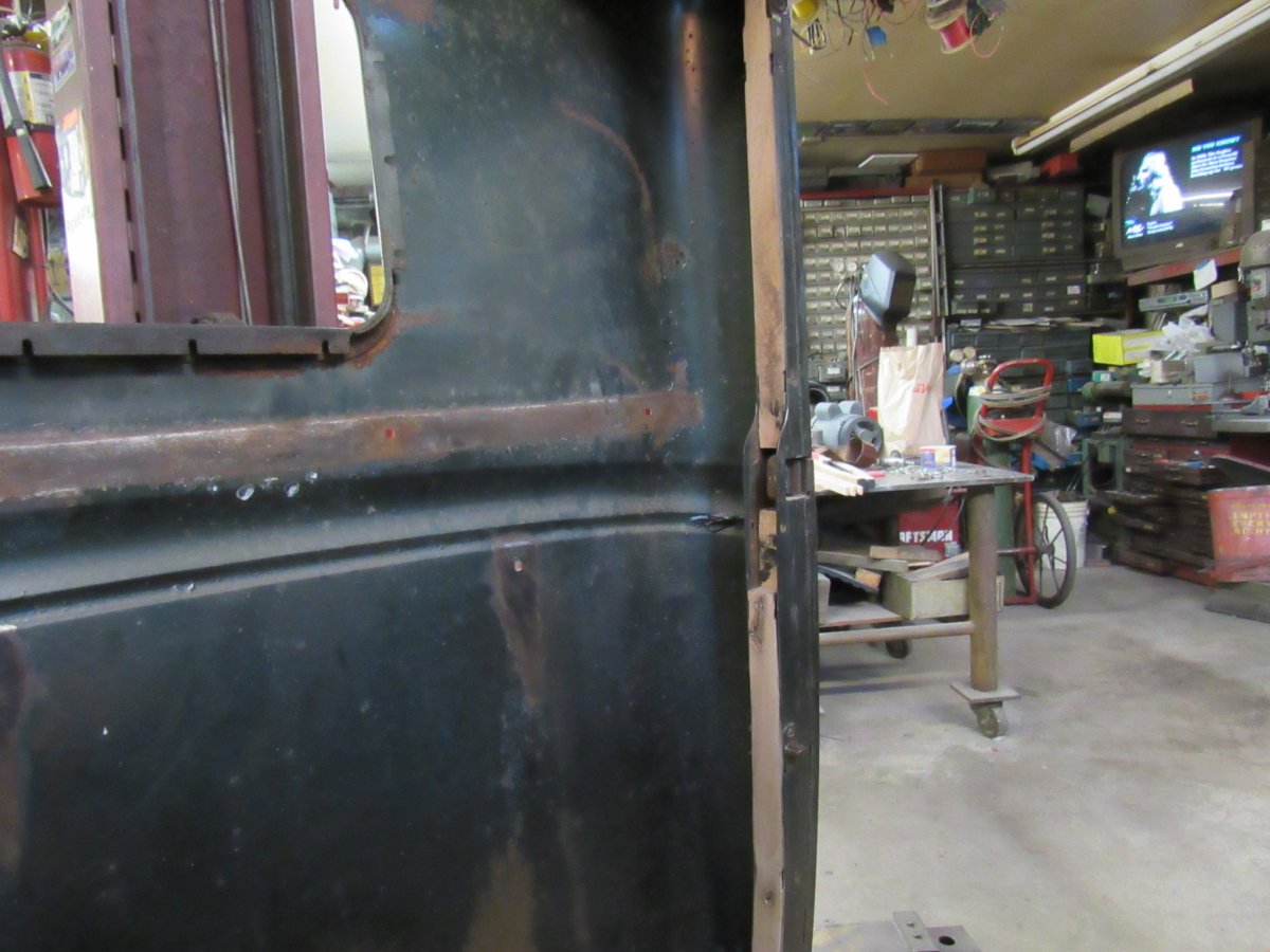

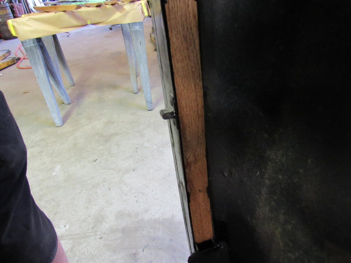

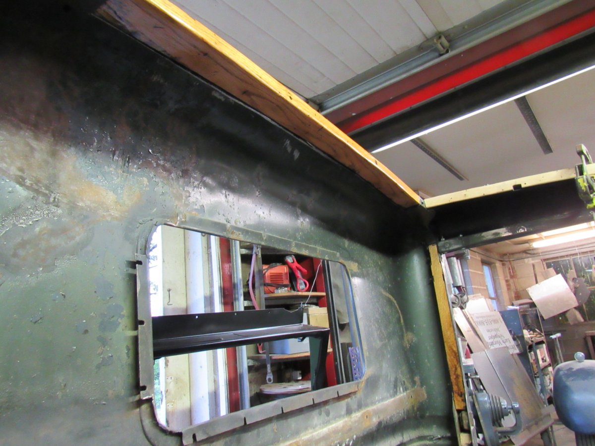

    I removed the wood from the latch posts and sanded and painted the back sides. IMG_0466.JPG IMG_0467.JPG

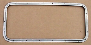

    anybody know what/how the rear window is attached and sealed?

    Ted, I thought they were held in like the 32-34. With a steel flange that screws down around the entire window squeezing the gl*** in a rubber seal that’s goes over the outside edge of said piece of gl***?

    Mine is held in like Runnin Shine says. The inside frame pinches the window and gasket.
  20. 31Apickup
    Joined: Nov 8, 2005
    Posts: 3,690
    31Apickup
    They use a frame as shown above. My gl*** has a rubber channel seal along the edge and just held in place with the frame. I’m sure I got the seal from one of the Model A parts places, but don’t recall as it’s been 33 years since I put it in.

    thanks for the replies, seeing the special frame makes sense. I have a Tudor frame and it seamed a questionable way to hold it in. to use the Tudor one I would have to build a wood frame/sill around the opening to hold the gl*** in place. we need to find the right frame.

    tonight I flipped the cab back up right, and put the post wood back in. I then drilled for the hardware that holds it into the post. IMG_0473.JPG IMG_0472.JPG IMG_0474.JPG
