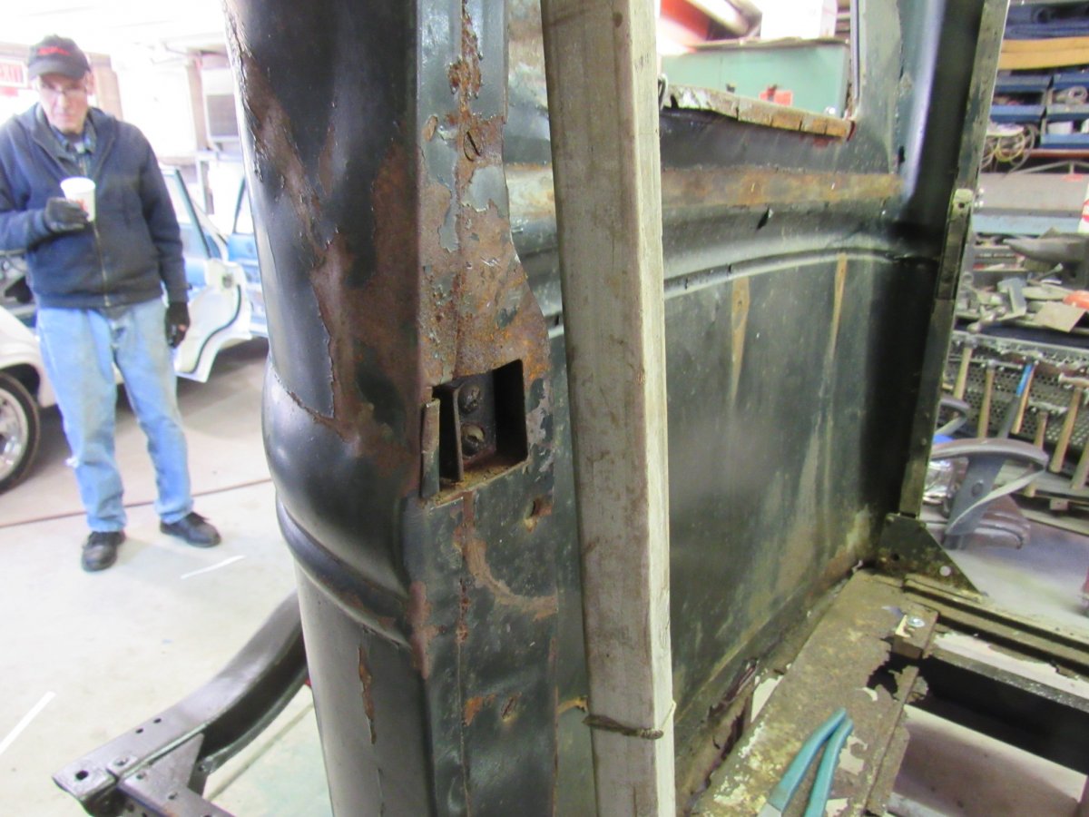

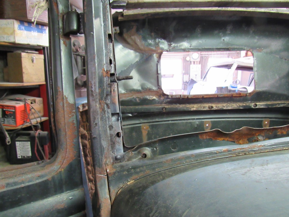

    Charlie worked on the cab today, he stripped off a Bunch of stuff and temporarily removed the doors. my dad stopped by to give him a hand. they removed the rotten floor, cowl band, seat riser etc....
    the doors will go back on when we start straightening. the rear crossmember will need to be changed but only after we do a pre pull to get the old one straight. IMG_4617.JPG IMG_4630.JPG IMG_4631.JPG IMG_4632.JPG IMG_4633.JPG IMG_4635.JPG IMG_4634.JPG

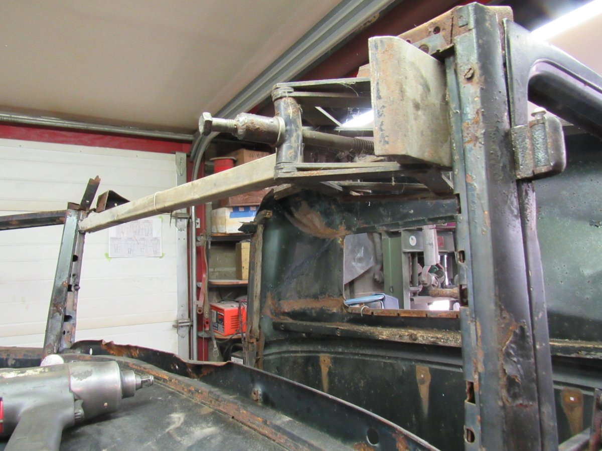

    the slacker showed up again today and got all the hinge pins fixed. some had to be replaced. he also removed the temporary roof bracing, the ignition junction box and put the doors back on. we set up the jack and pushed the posts apart while heating at the bend point. it pushed out easily. door fits better but we need to push the post forward but can't do that till we get the subframe bolted down. IMG_4643.JPG IMG_4644.JPG IMG_4645.JPG IMG_4646.JPG

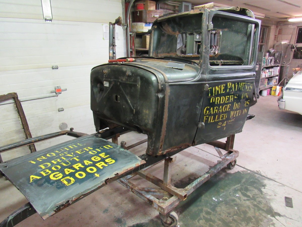

    the truck had been repainted a metallic green, a lot like the color of my coupe, and it looked as tho they painted over some lettering. I spent 2.5 hrs with a piece of 400 grit wet sand paper, gently removing the top layers, then buffed it. IMG_4618.JPG IMG_4619.JPG IMG_4649.JPG IMG_4650.JPG IMG_4651.JPG

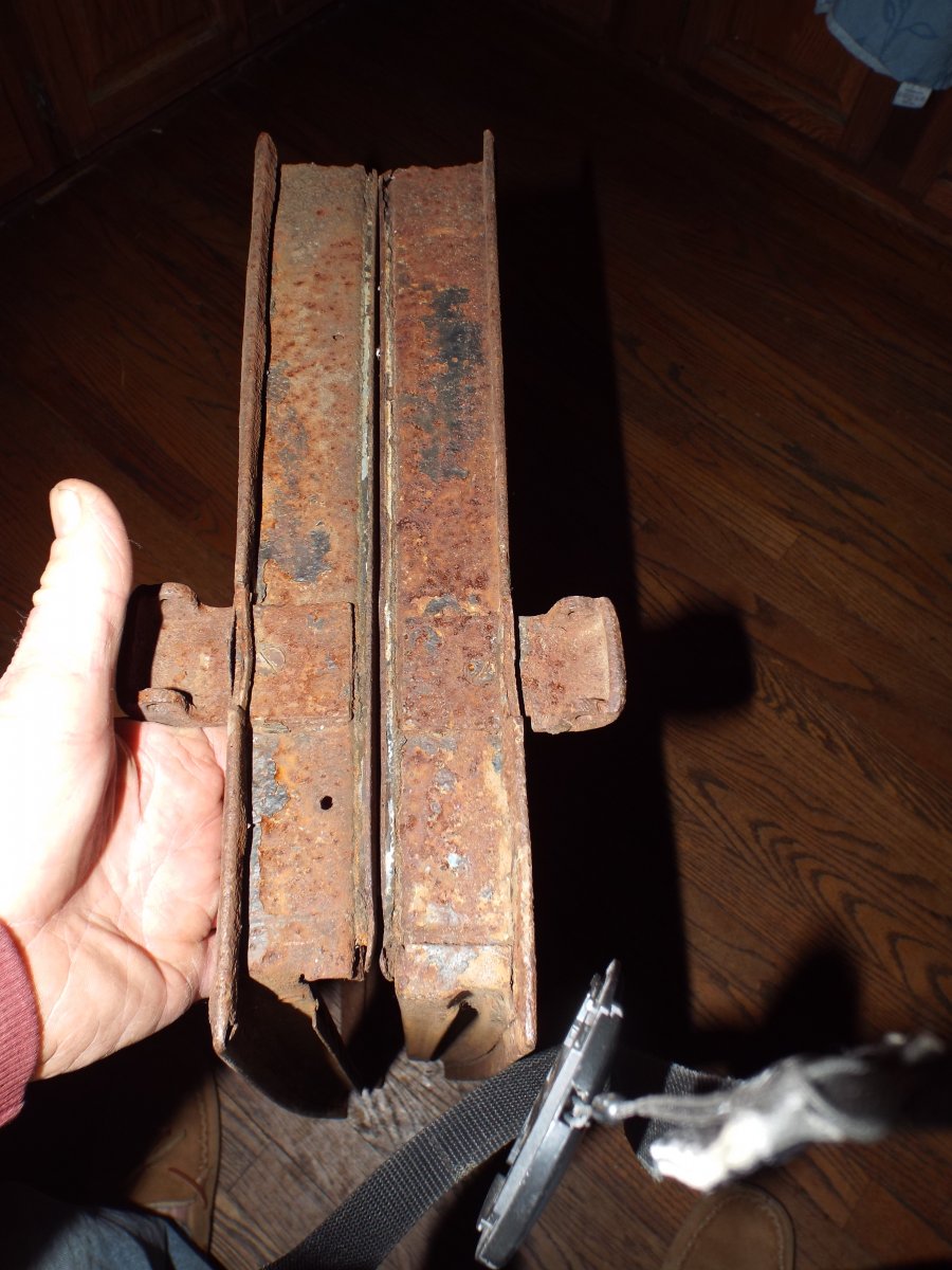

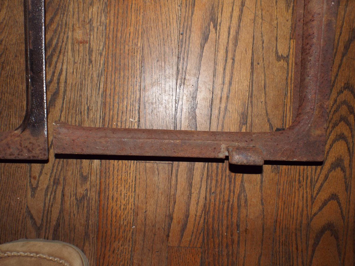

    Ted, I've got door tops if yours are bent too bad to fix.

    thanks, I have a customer who is building an Auburn cabriolet, who is also an "overhead garage door" dealer/installer. he was dropping a fender off and we could slightly make out that the "garage doors" under the paint. he said "overhead door" company started in 1921 in Michigan. this could have been a dealer for them if the truck was new when lettered. he said other companies came later. funny how the doors didn't match.
    I revealed this after Charlie left so I am not sure he will want to keep the lettering.

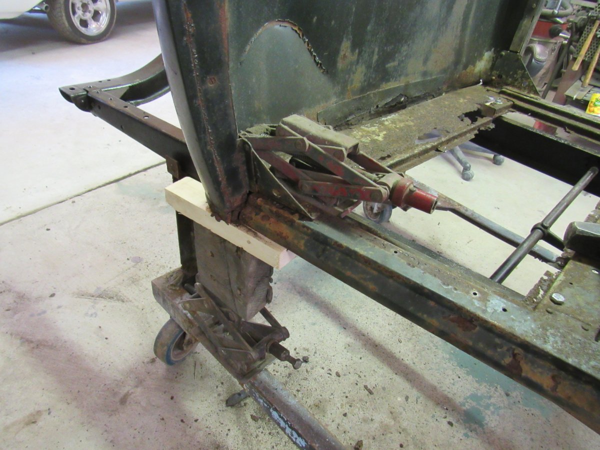

    Charlie was at it again, he installed the new body blocks and bolted the body down. he removed the wood above the body line in the back of the cab. we jacked up on the corner of the cab and worked the metal in the sill till it was straight. IMG_4652.JPG

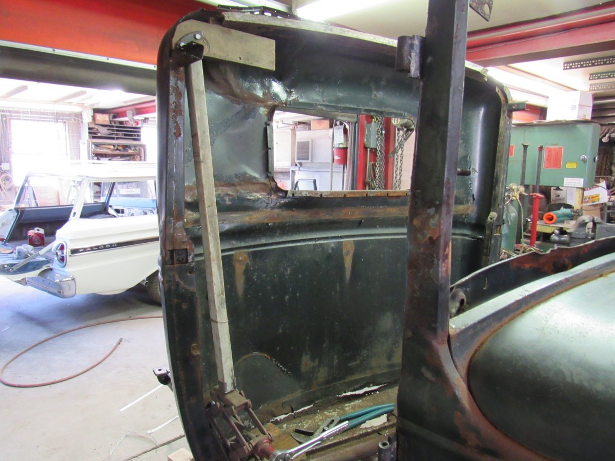

    then we put another jack on the sill, and made a jacking block that we bolted to the top of the back of the cab. we jacked it up and worked the metal on the post till it was straight. IMG_4653.JPG

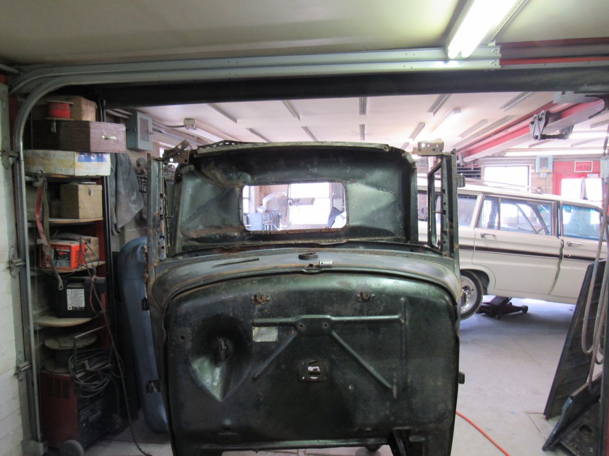

    with the post now straight, we could work the dents out of the back of the cab. still have a lot of work to iron it out but the cab is almost "square". IMG_4669.JPG
