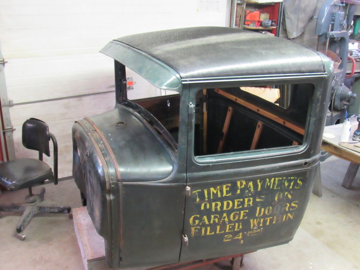

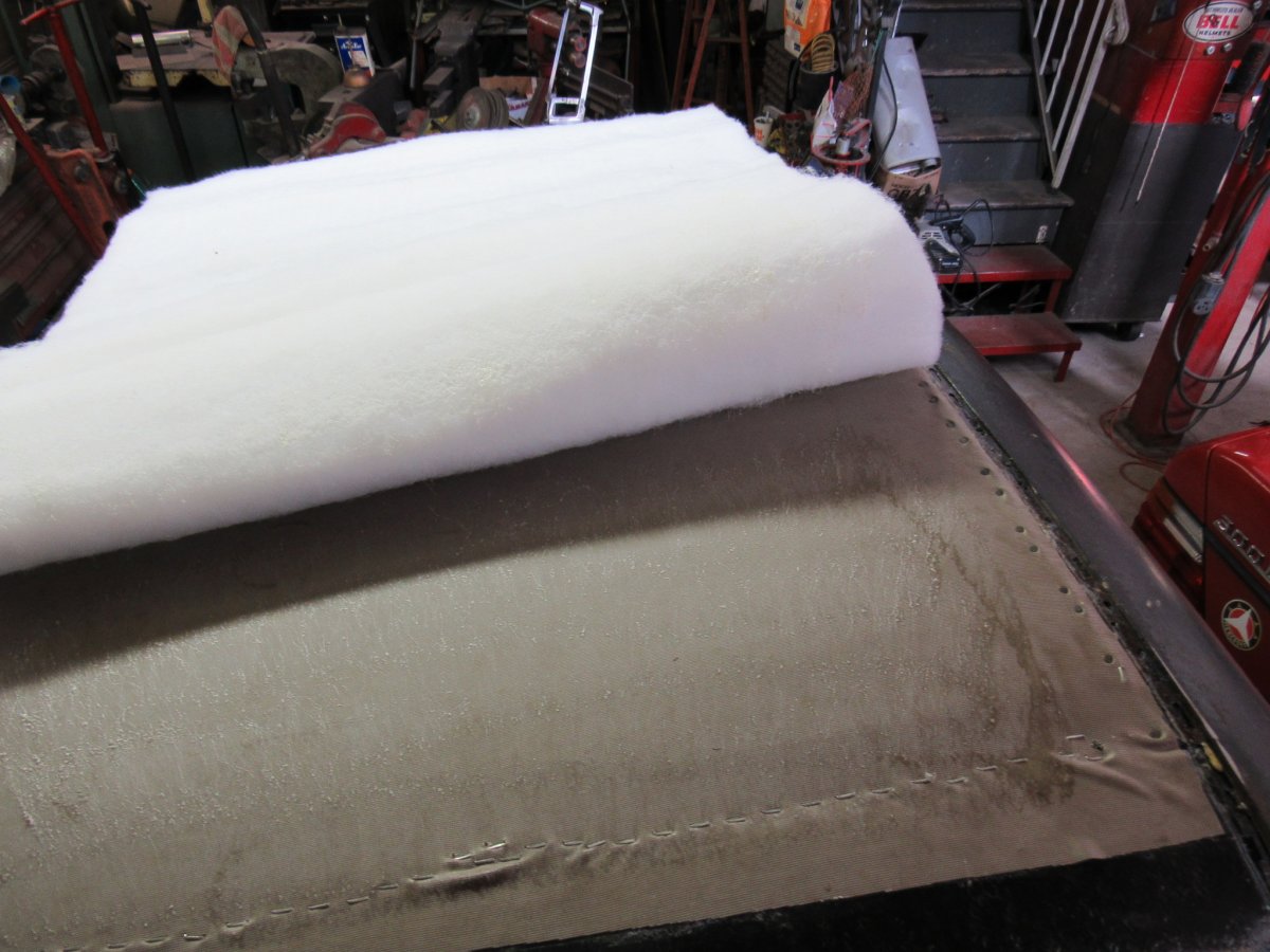

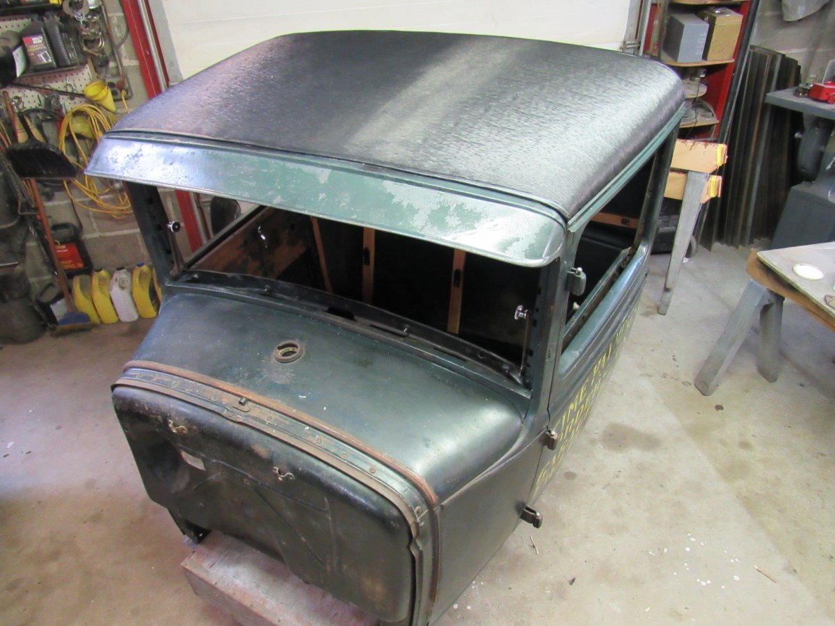

    used spray glue to glue the padding down. I did not have a piece big enough in one direction, so I had to seam it. I decided to do, one piece in the middle and piece each side symmetrically in case the seams showed, it would look even. IMG_0545.JPG IMG_0546.JPG IMG_0547.JPG

    after lunch I laid the material on the top and started to tack it down. I put two tacks on either end of each slot. I started in the middle of each side, pulling it tight. I did the front and back first then the sides. I made pencil marks to aid in finding the slots. IMG_0550.JPG

    once it was all tacked I trimmed close to the tacks with a razor knife. IMG_0554.JPG

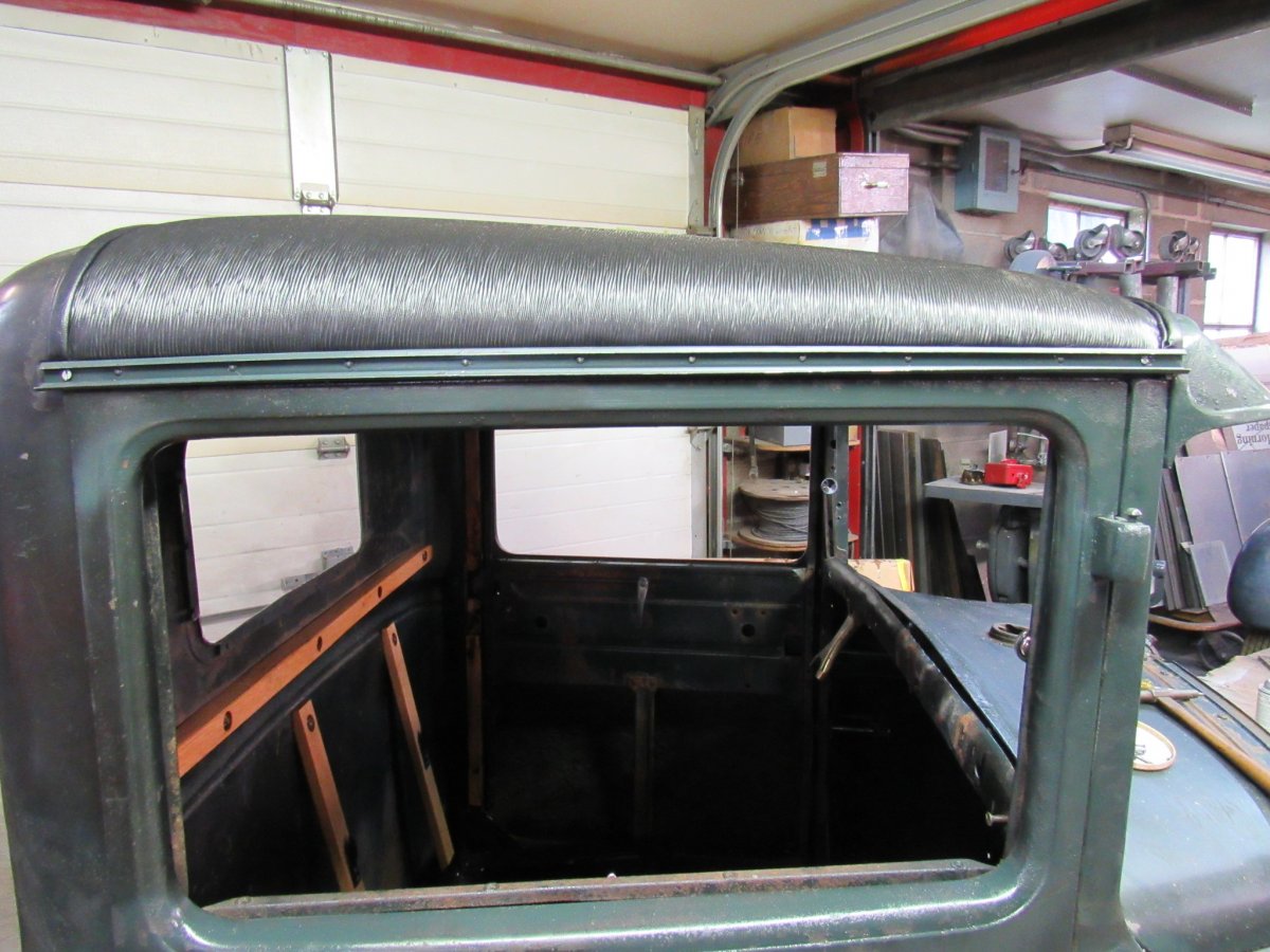

    I had to run the fabric in this direction because it was the only way it fit.

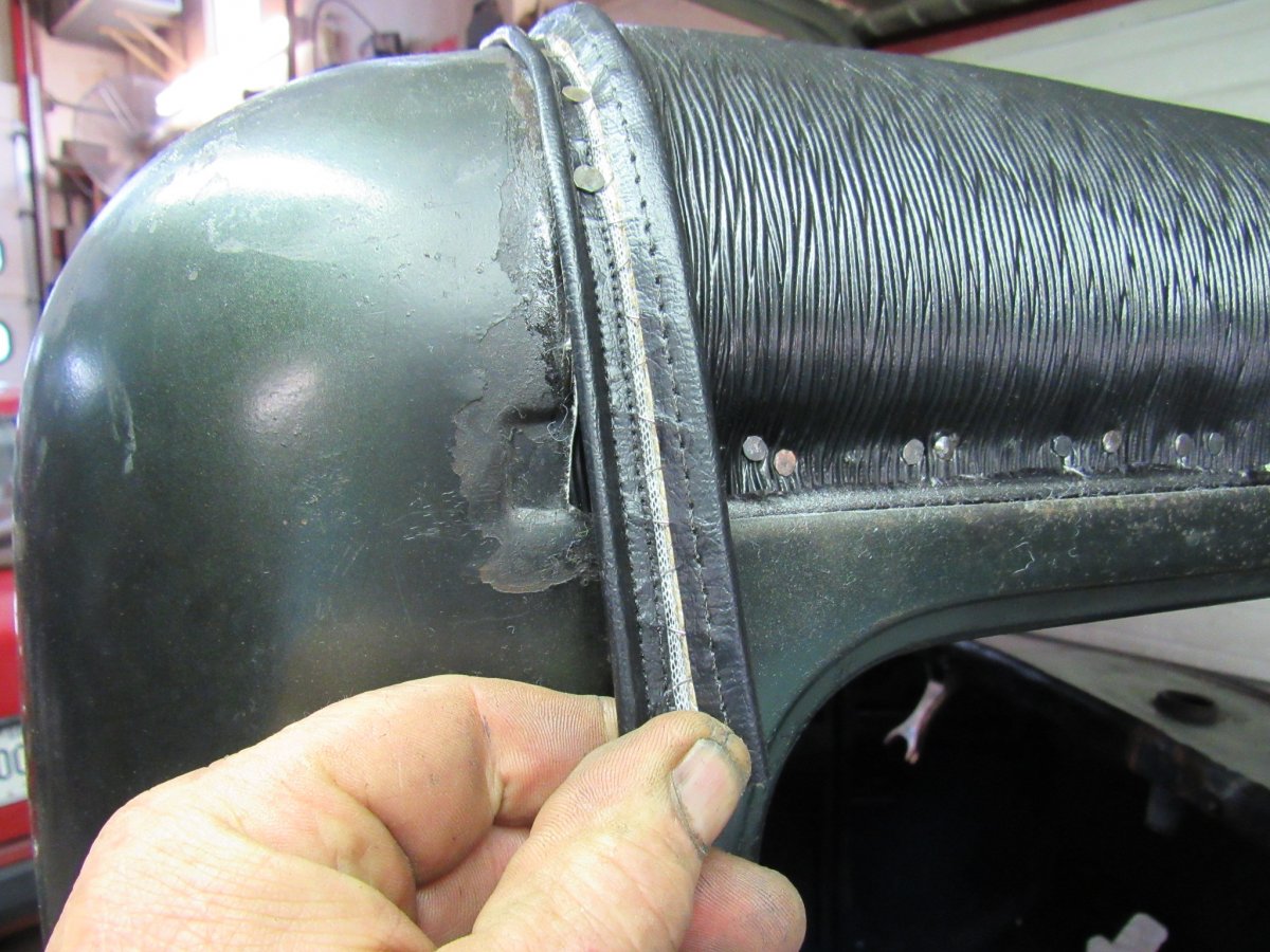

    the next step was to install the "wire-on" to hide the tacks. I tacked this in between the two tacks I already used to hole the top material down. IMG_0558.JPG

    I ran the big bead side of the "wire-on" towards the front of the truck this way any driving weather is sealed out better.

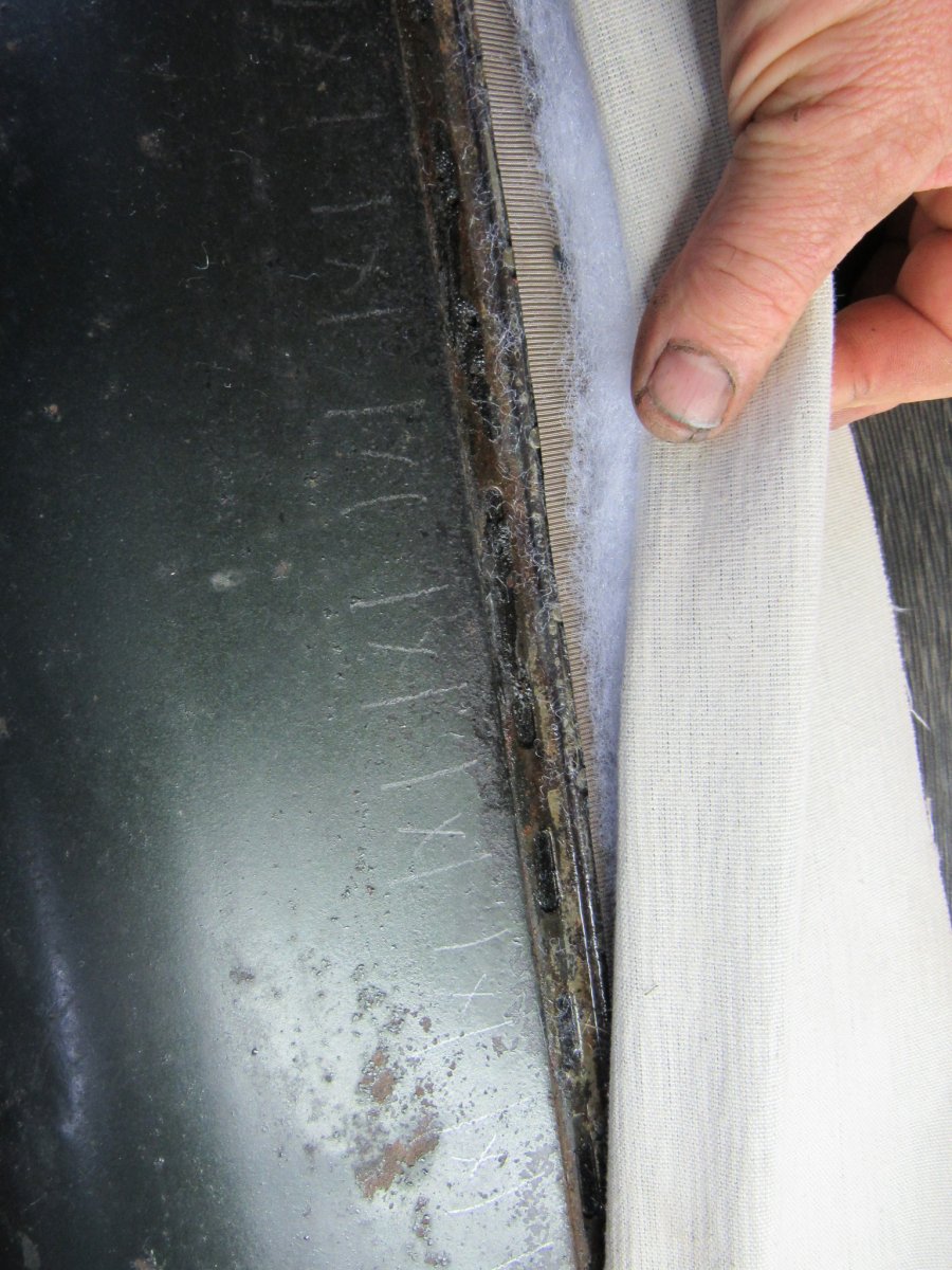

    on the ends that get tucked under the rain gutter I pulled the threads out and peeled back the material so I could cut off the inner structure. this will make it thin enough to go behind the gutter without making it stand out. it also finishes off the end of the "wire-on". the "wire-on" gets closed over the nails and then hammered shut with a rubber mallet. IMG_0560.JPG

    hmmm? I was worried about how it would look. I was dead against using it but Charlie thought it would be ok, and I have to agree.

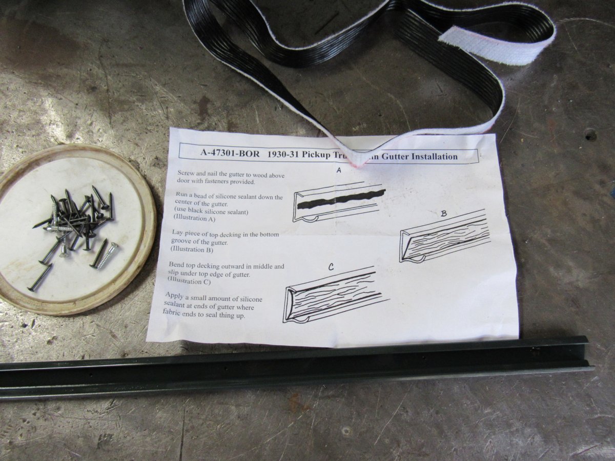

    great instructions on how to install the rain gutter. I decided not to put the trim strip in the gutter, I like the look of the nails and screws better. of course they did not drill the holes big enough for the nails they supplied:rolleyes: I did have to drill through the heads of the tacks under the rain gutter to get the nails in. IMG_0565.JPG IMG_0566.JPG IMG_0567.JPG

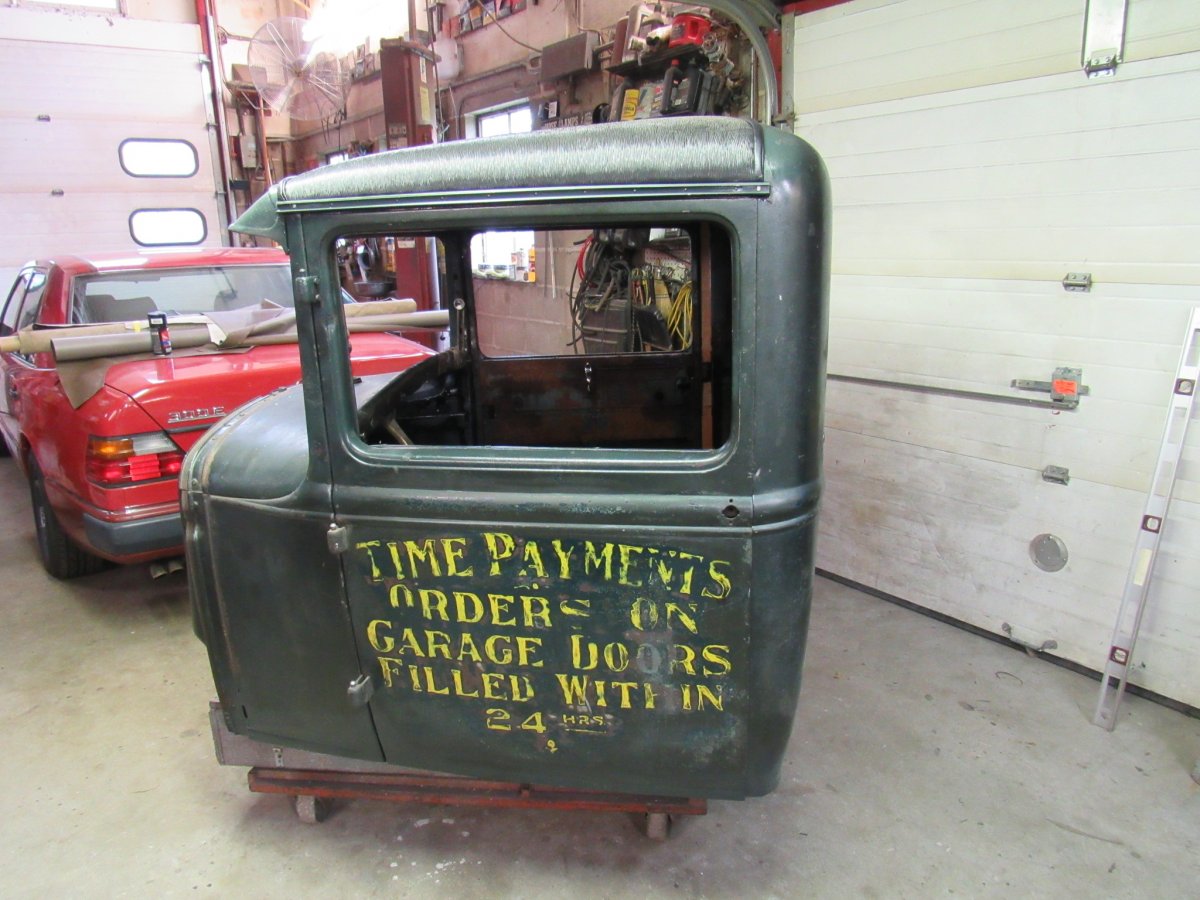

    ready for delivery tomorrow to put it on the frame...stay tuned. IMG_0569.JPG

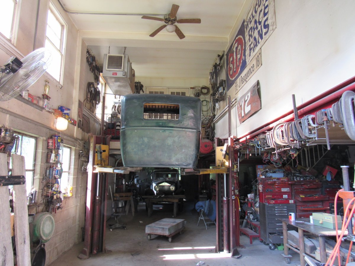

    loaded up this morning and headed out. 4 other buddies met at Charlie's to get it off the truck and on the ch***is. IMG_0574.JPG

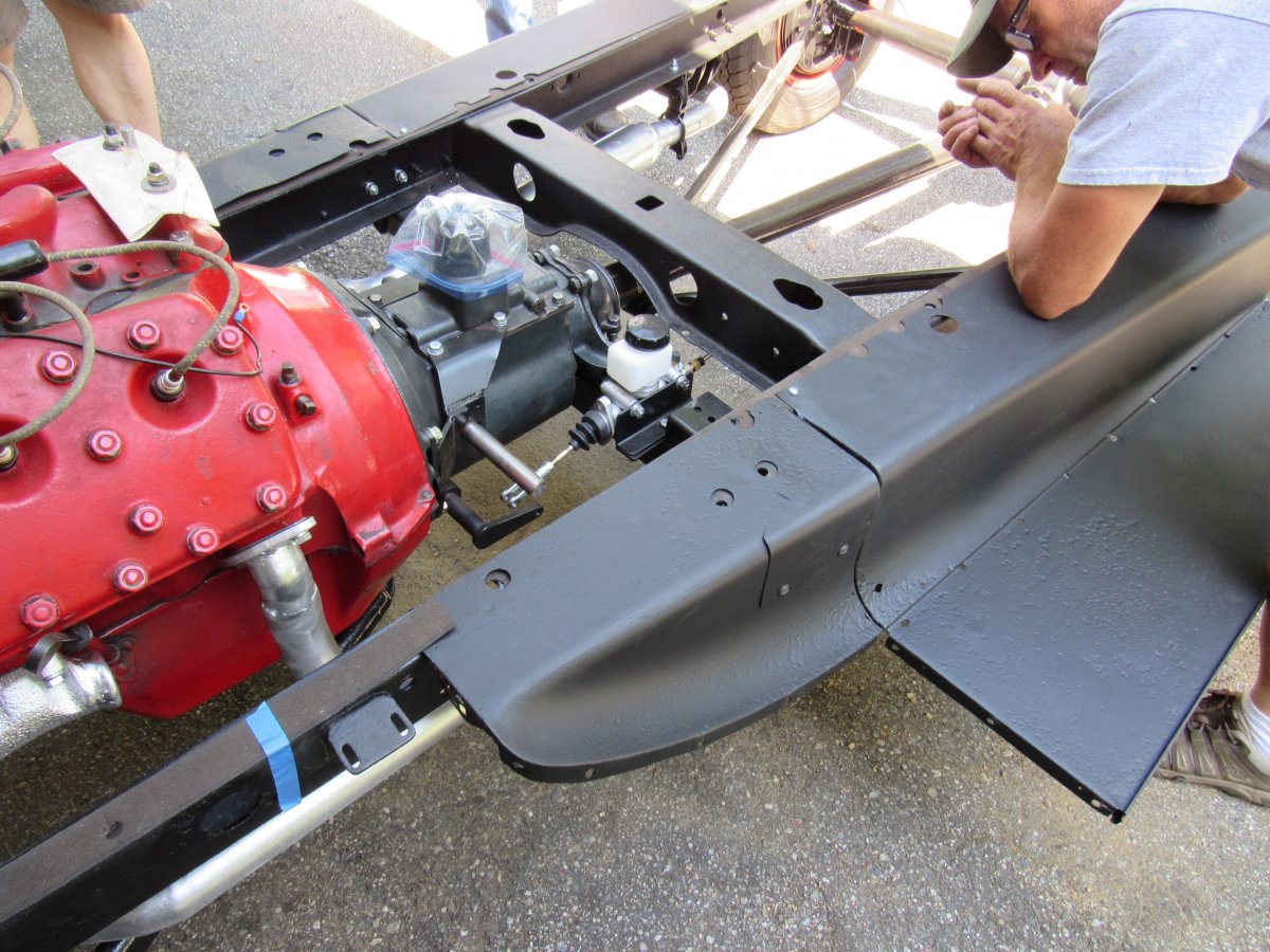

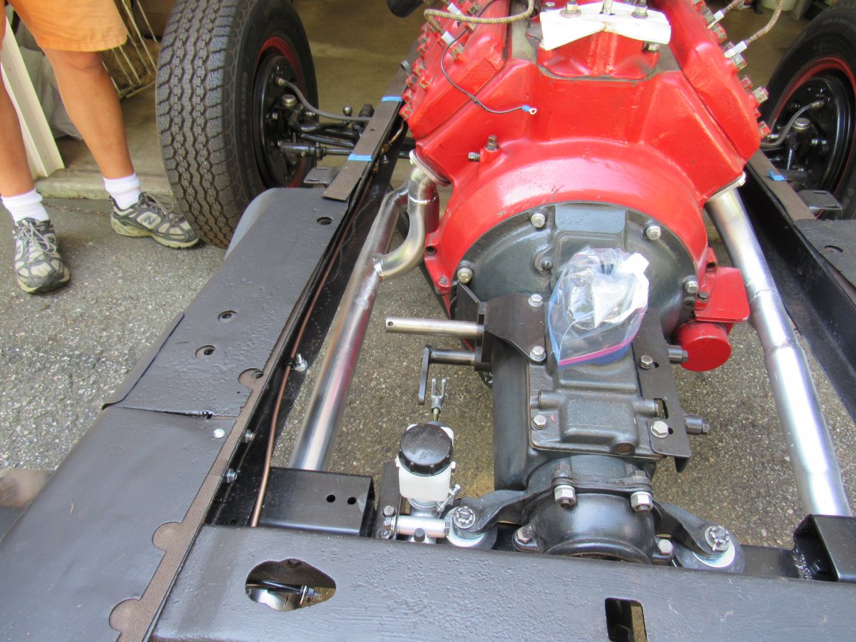

    some shots of the ch***is before we set the cab on. IMG_0589.JPG IMG_0590.JPG IMG_0591.JPG IMG_0592.JPG IMG_0593.JPG

    Excellent work on the roof. I raised an eyebrow at the vinyl direction, too, initially but I think it looks great!

    I was dead set against it like I said. but once I laid the piece up there it looked fine. I asked the guys if anything stood out about the top and they said no. when I pointed out the fact it was running sideways they said "I wouldn't have thought it was wrong"
