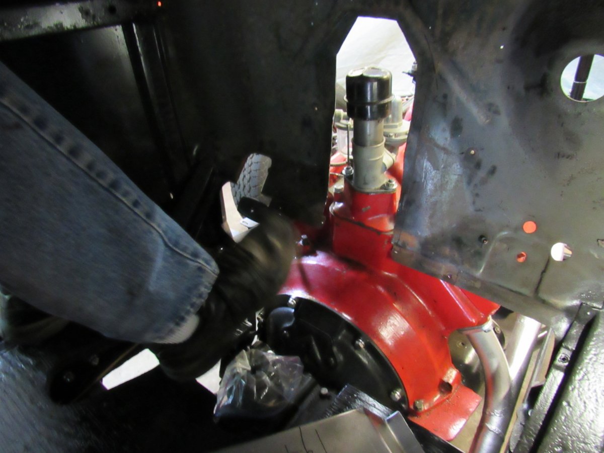

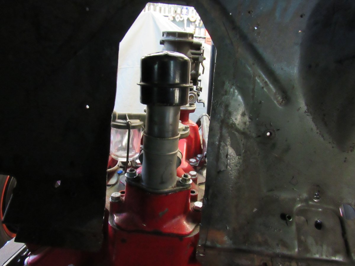

    went over to check out the fit this morning. firewall at the bottom doesn't need a very big recess.i think the motor is fine where it is. I had Charlie sit in it with the seat in place to get some idea how the gas pedal linkage will work. he still needs to make a toe board for a proper mockup. I did some more tweaking and have a "fit". IMG_0639.JPG IMG_0640.JPG

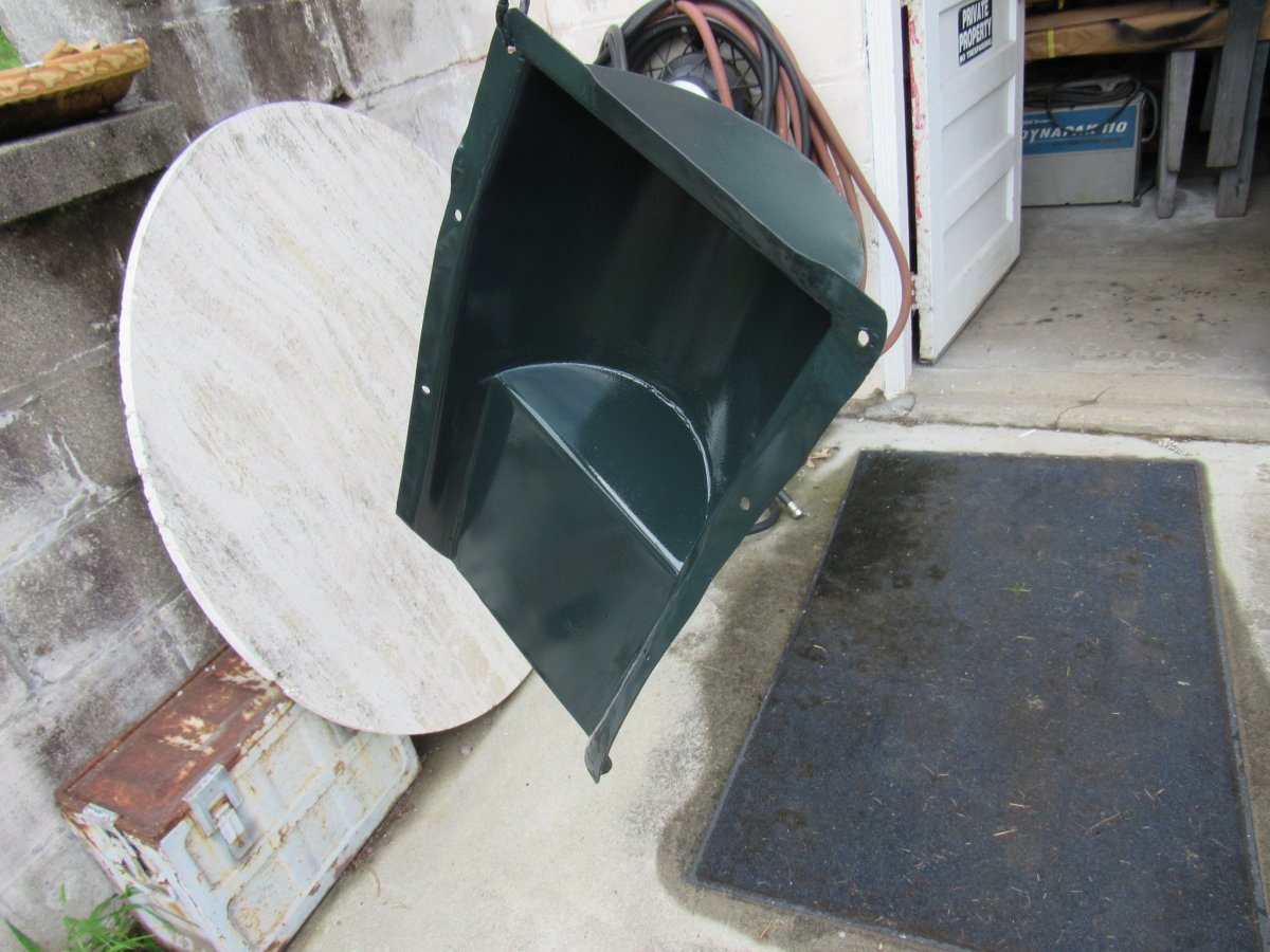

    Charlie had an extra firewall and I decided to take it home to finish the cover for the firewall hole. we needed to make the lower section flatter to allow the gas pedal more room. I marked out the hole for reference. IMG_0641.JPG

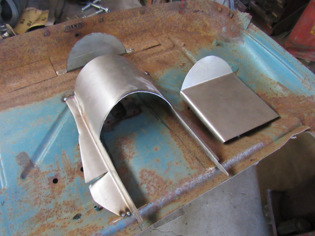

    instead of modifying the piece again I decided to start fresh, with a different look. I rolled a piece of 18 gage and bent the edges at the proper width. IMG_0643.JPG IMG_0644.JPG

    I checked the fit to the firewall and the upper flange needed to be re-bent to follow the bend in the firewall. I did this with a hammer off the edge of the table

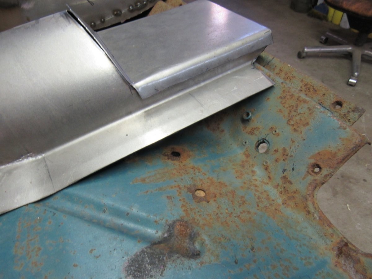

    I bent a flange and marked and cut out to close off the top. and then bent and trimmed a piece for the face side IMG_0649.JPG

    I had made one of the flanges long so that after I weld it together I can contour and bend it down to close off the gap along the side. IMG_0651.JPG

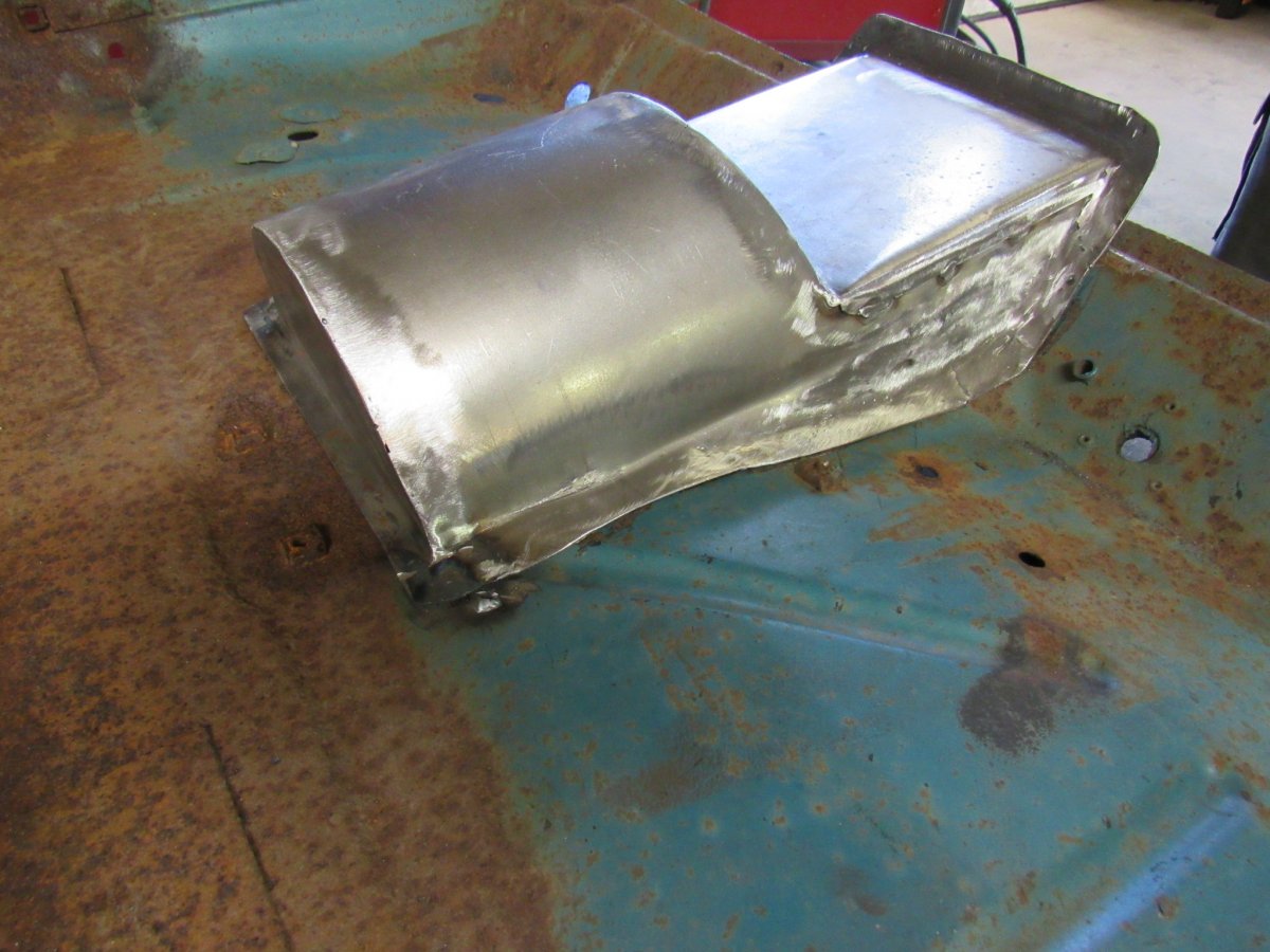

    tack welded the piece to the firewall so it wouldn't move and welded the three pieces together. i cut a relief in the long flange and contoured it to fit the firewall. IMG_0657.JPG IMG_0658.JPG

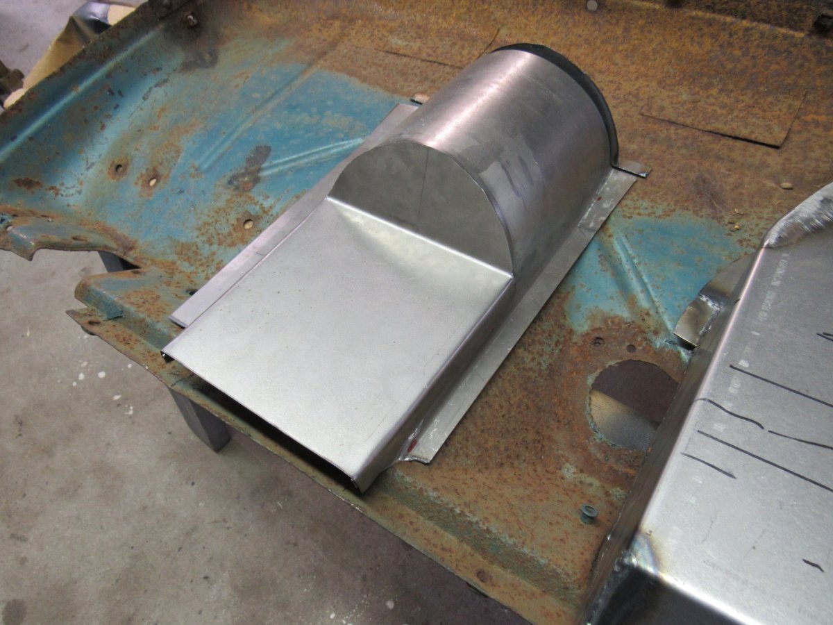

  11. tb33anda3rd
    Joined: Oct 8, 2010
    Posts: 17,595
    tb33anda3rd
    this panel gives us about an inch of recess.
    once all the flanges fit flush against the firewall I welded it up and did the finish grinding. IMG_0659.JPG

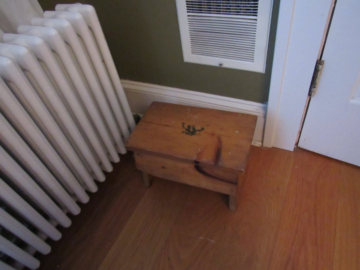

  20. tb33anda3rd
    Joined: Oct 8, 2010
    Posts: 17,595
    tb33anda3rd
    I find replicating the wood challenging, in a good way, and for this hot rod I did not need it to be factory exact. wood can be shaped with something as simple as a pocket knife, but when it comes to old cars it seams to intimidate most guys. Why?
    I made this step stool when I was 8 years old in 4H, using simple hand tools and s**** wood. ;) IMG_0667.JPG still works

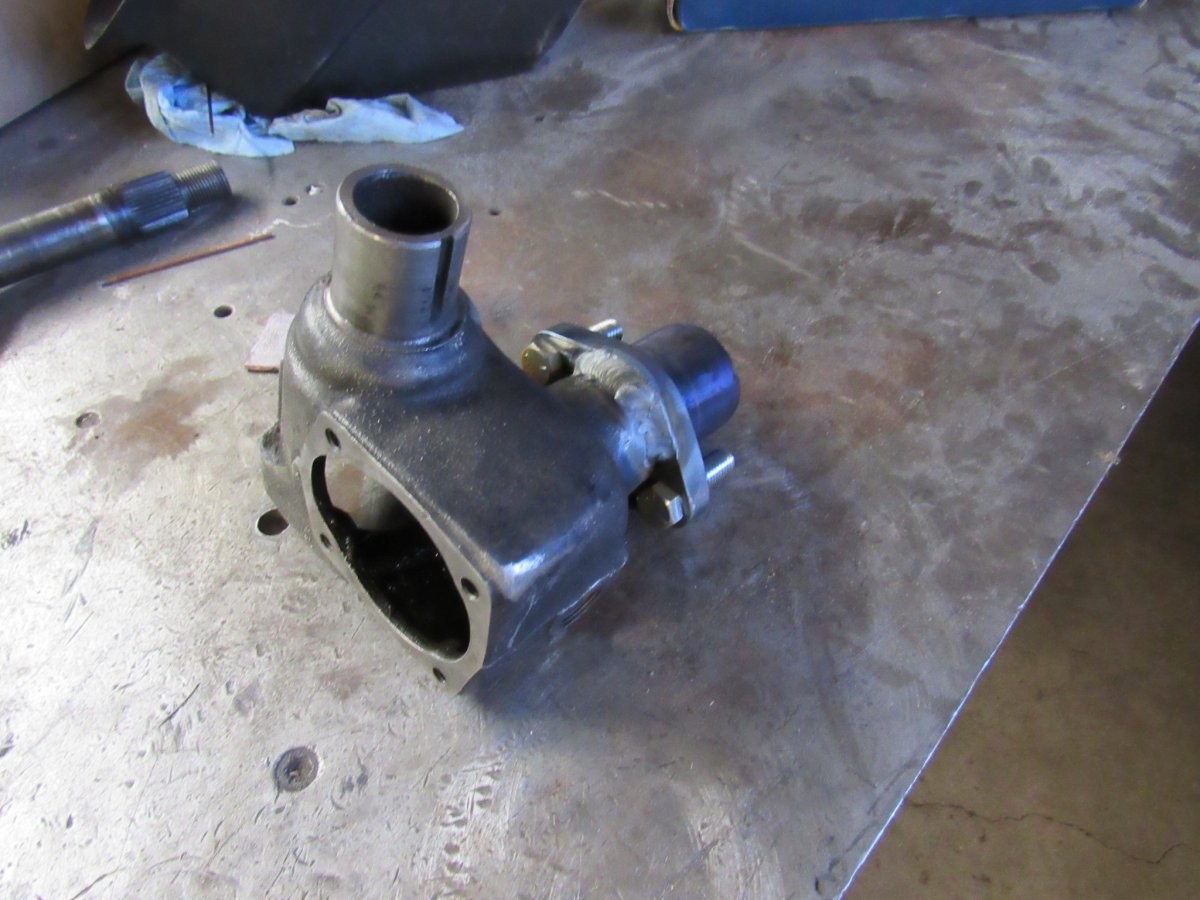

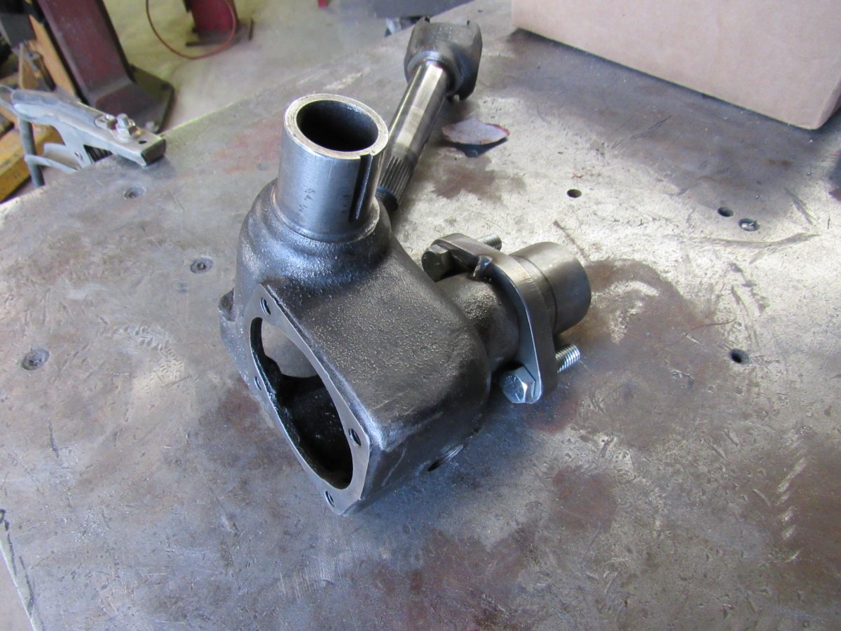

  26. tb33anda3rd
    Joined: Oct 8, 2010
    Posts: 17,595
    tb33anda3rd
    the slacker fit the steering box and tacked the flange in place. I welded it up for him tonight. IMG_0686.JPG IMG_0687.JPG

  28. tb33anda3rd
    Joined: Oct 8, 2010
    Posts: 17,595
    tb33anda3rd
    yes. I am not sure if I should weld them?
  29. nunattax
    Joined: Jan 10, 2011
    Posts: 3,394
    nunattax
    i dont think i would weld them.it would be ideal if the heads cant turn,it would make ***embly easier.id loc***e the nuts or use locknuts .
    tb33anda3rd and loudbang like this.
  30. tb33anda3rd
    Joined: Oct 8, 2010
    Posts: 17,595
    tb33anda3rd
    yep Charlie said I did it right. he plans on lock nuts or washers. this was another big hurtle for him to get over. I plan to stop tomorrow and photo some of his work.
