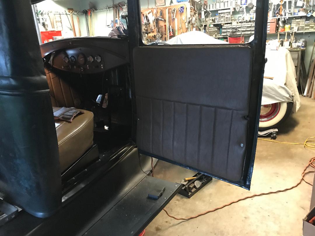

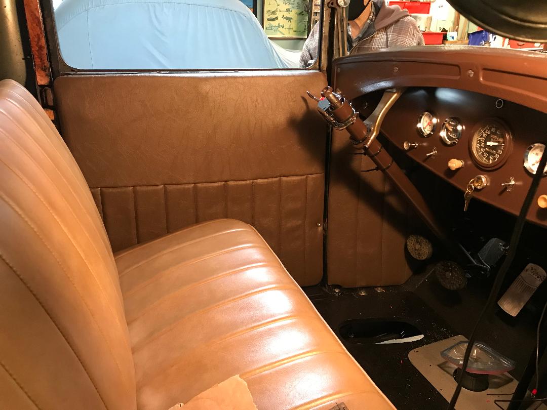

    @Street Is Neat made up the door panels for Charlie's truck.

    That interior looks great!

    Charlie had the material , so I hack it together . Charlie’s happy and that’s all that matters .
    I guess not bad for an Ole Iron Worker !

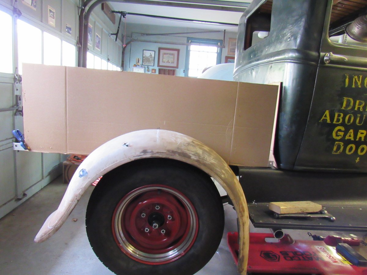

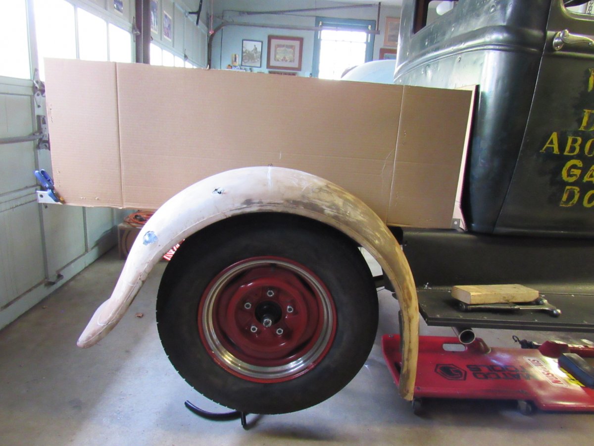

    Charlie mocked up the size of the bed and fender placement using card board. IMG_1438.JPG IMG_1439.JPG IMG_1440.JPG

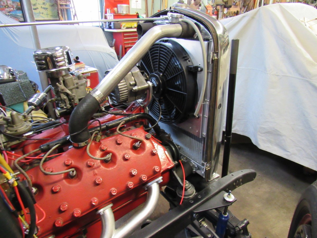

    he also got the fan and shroud cut down and fit. he did not want to use the electric fan but it was such a tight fit to get a mechanical fan to work with his set up. IMG_1441.JPG

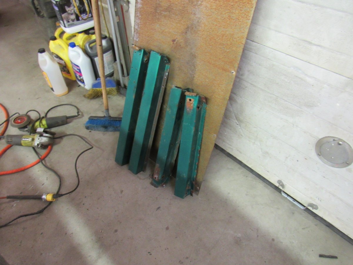

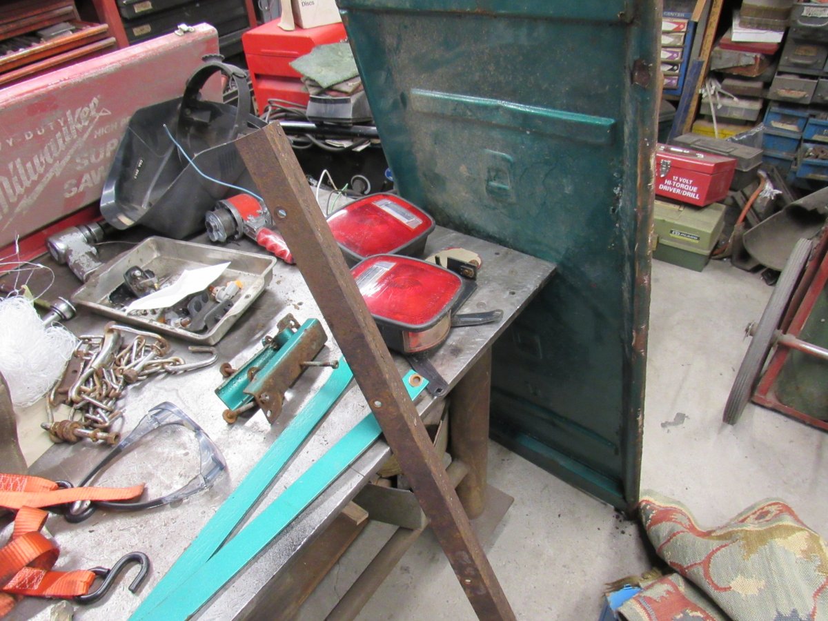

    not sure what this metal is. chromed steel, or a really bad stainless? it is magnetic and was on the head board of the bed. maybe it could be useful? looks like something Wyatt could use. IMG_1447.JPG

    I like the cardboard and it is easy to cut. Hard to weld though. Some stainless is magnetic.

    Is the cardboard side profile how tall he wants the bed with the angled top edge or without?
    Stogy and kidcampbell71 like this.

    that is without the side angles, but he is making another mock-up
    Stogy and loudbang like this.

    I was hoping that was with them from a proportions standpoint.

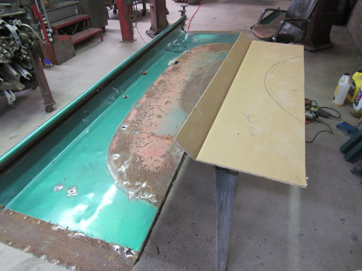

    Charlie dropped off the templates after double checking the proportions and marking the fender locations.

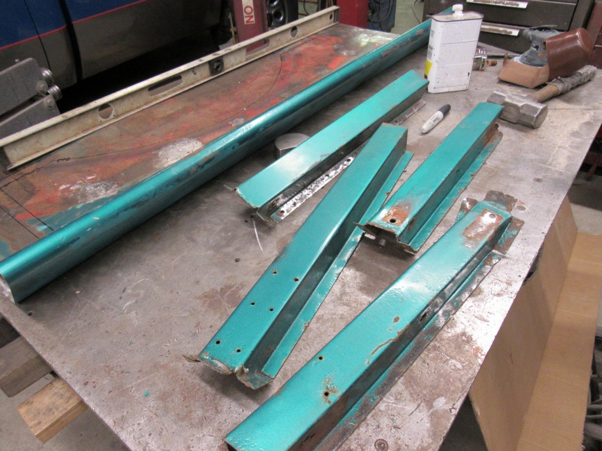

    I drilled out the spot welds and removed the stake pockets. IMG_1515.JPG IMG_1514.JPG

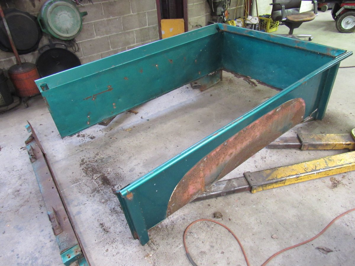

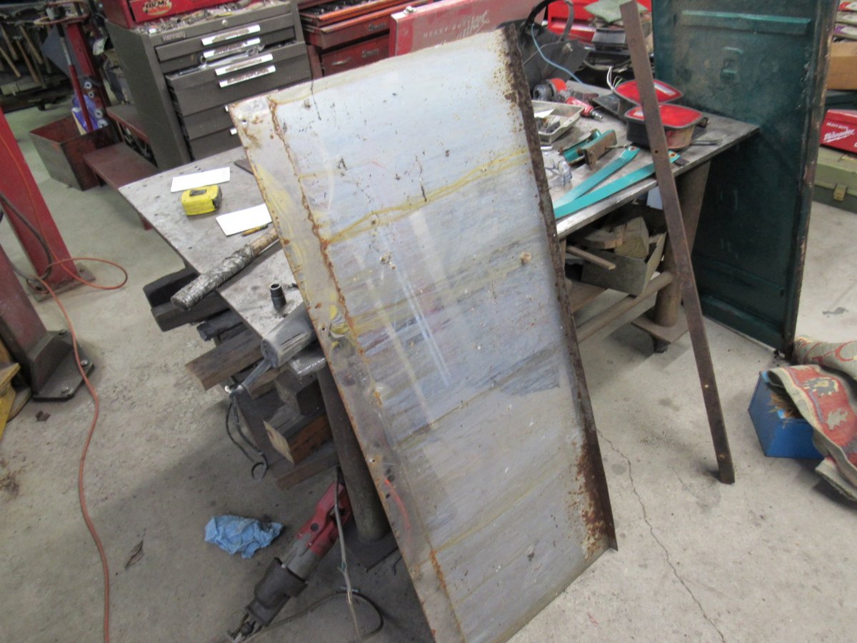

    I cut the bed to length and welded up the old fender stud holes. I then used Charlie's template to mark out the fender location so I can put a bead in the bed like a model A. IMG_1518.JPG
