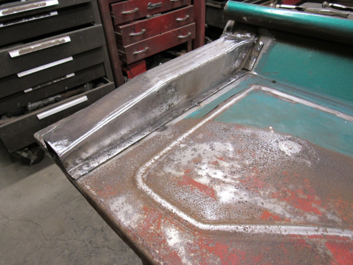

    I bead blasted the pockets and put a rust treatment on the back sides. IMG_1523.JPG

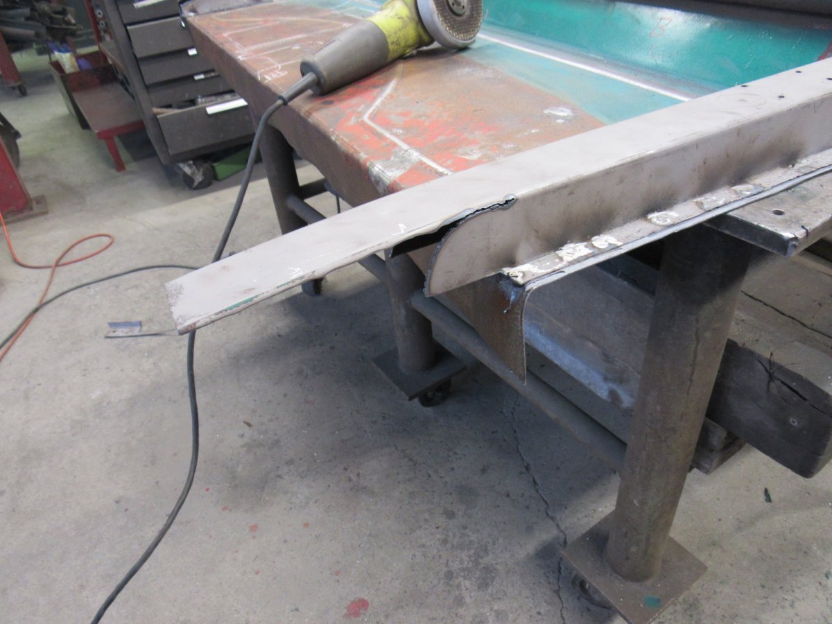

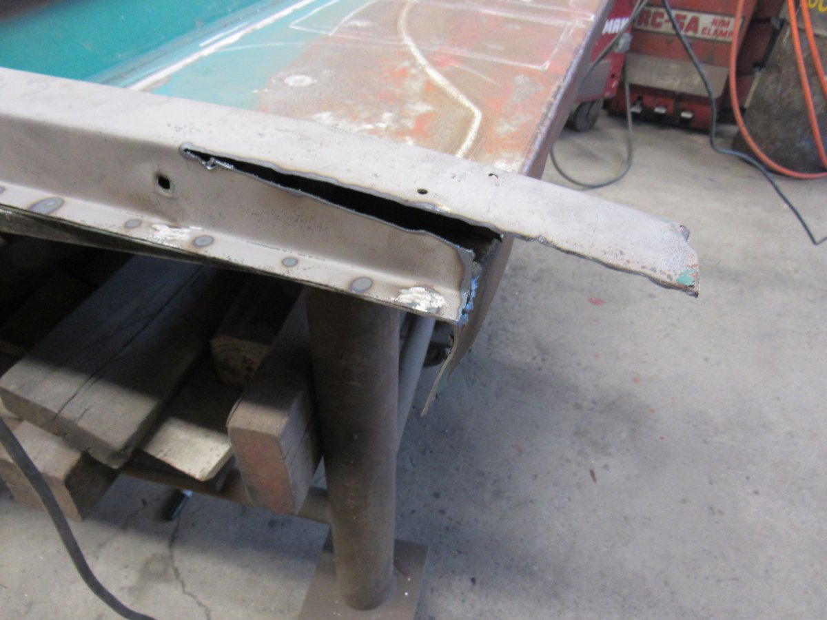

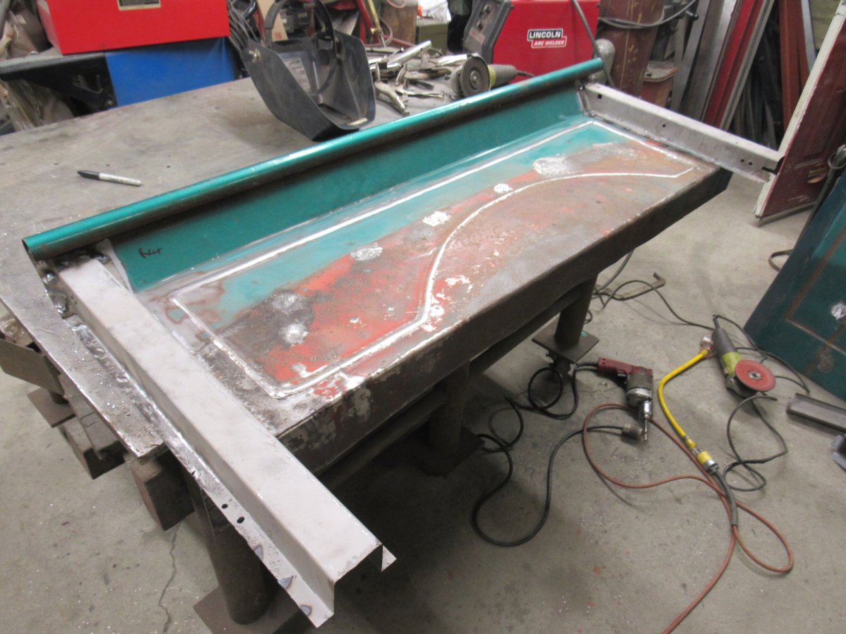

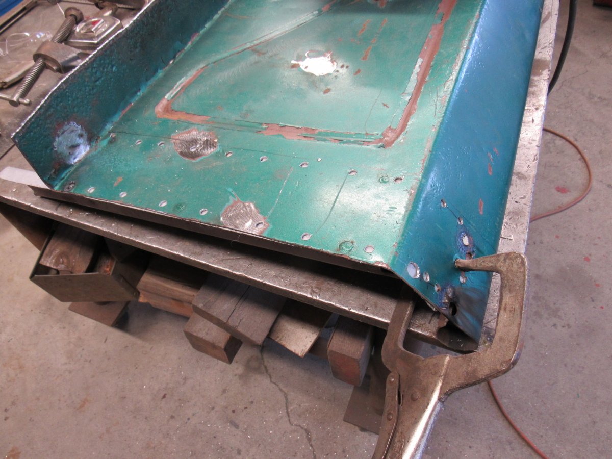

    my sheet metal break is not big enough to bend a 54 long piece so I had to clamp it down and bend it over the work bench. IMG_1525.JPG

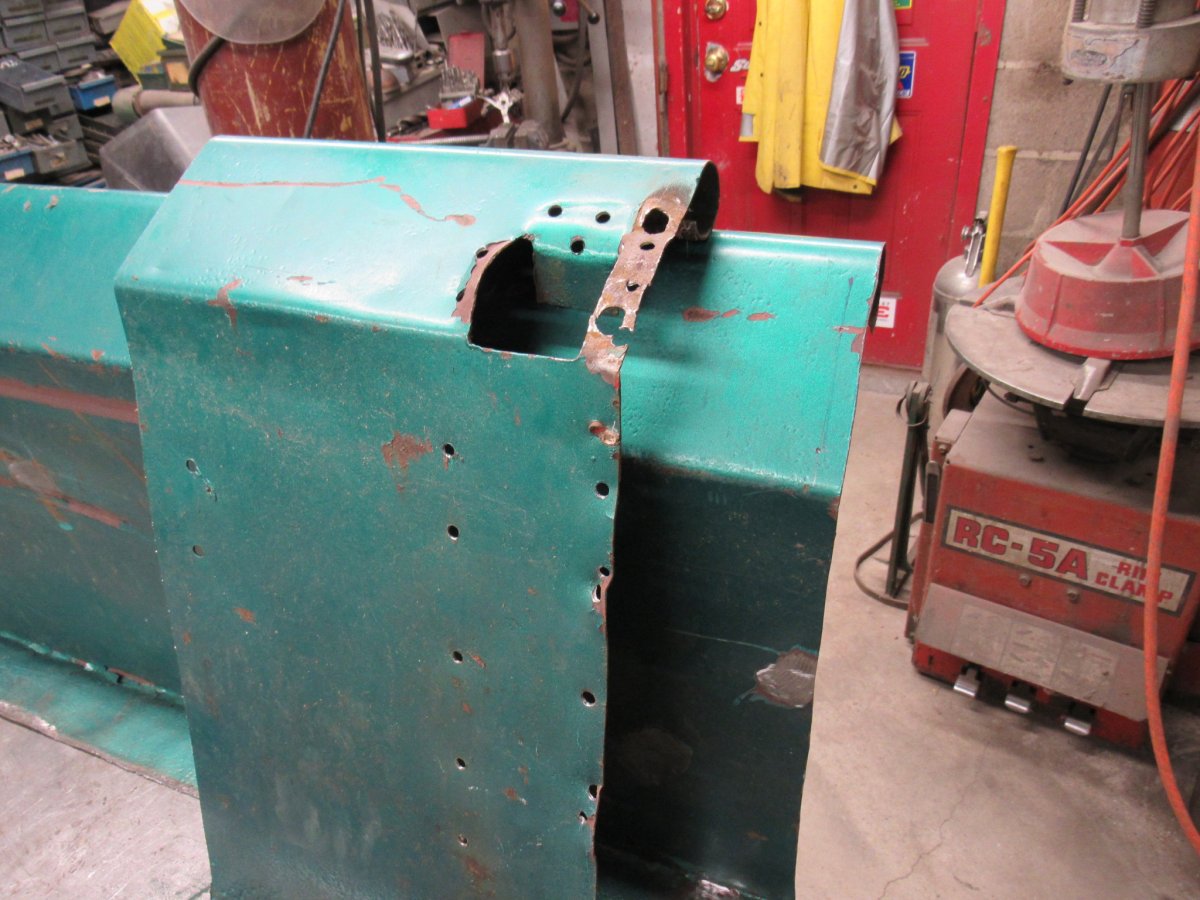

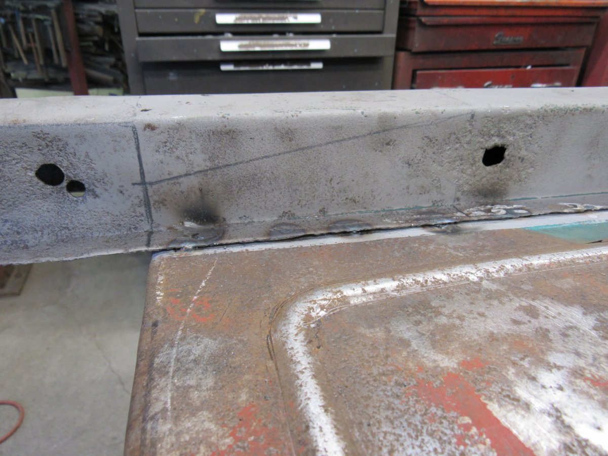

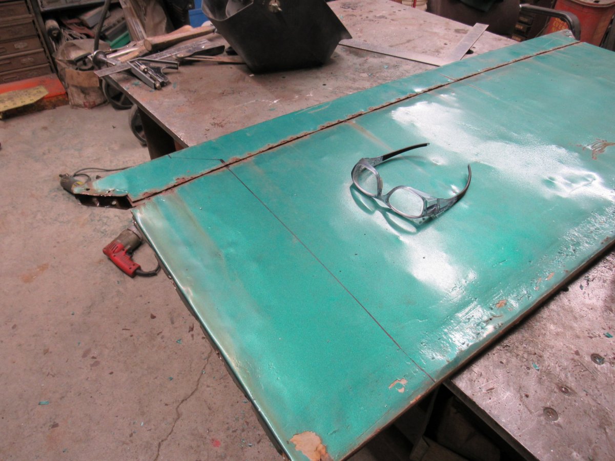

    I sanded the bed sides down and put a weld through primer on the flanges of the pockets and the corresponding faces of the bed sides.
    while that was drying I removed the bolting brackets from the head board. they had broken off when I took it apart and I thought it would be easier to fix it with them off. IMG_1526.JPG

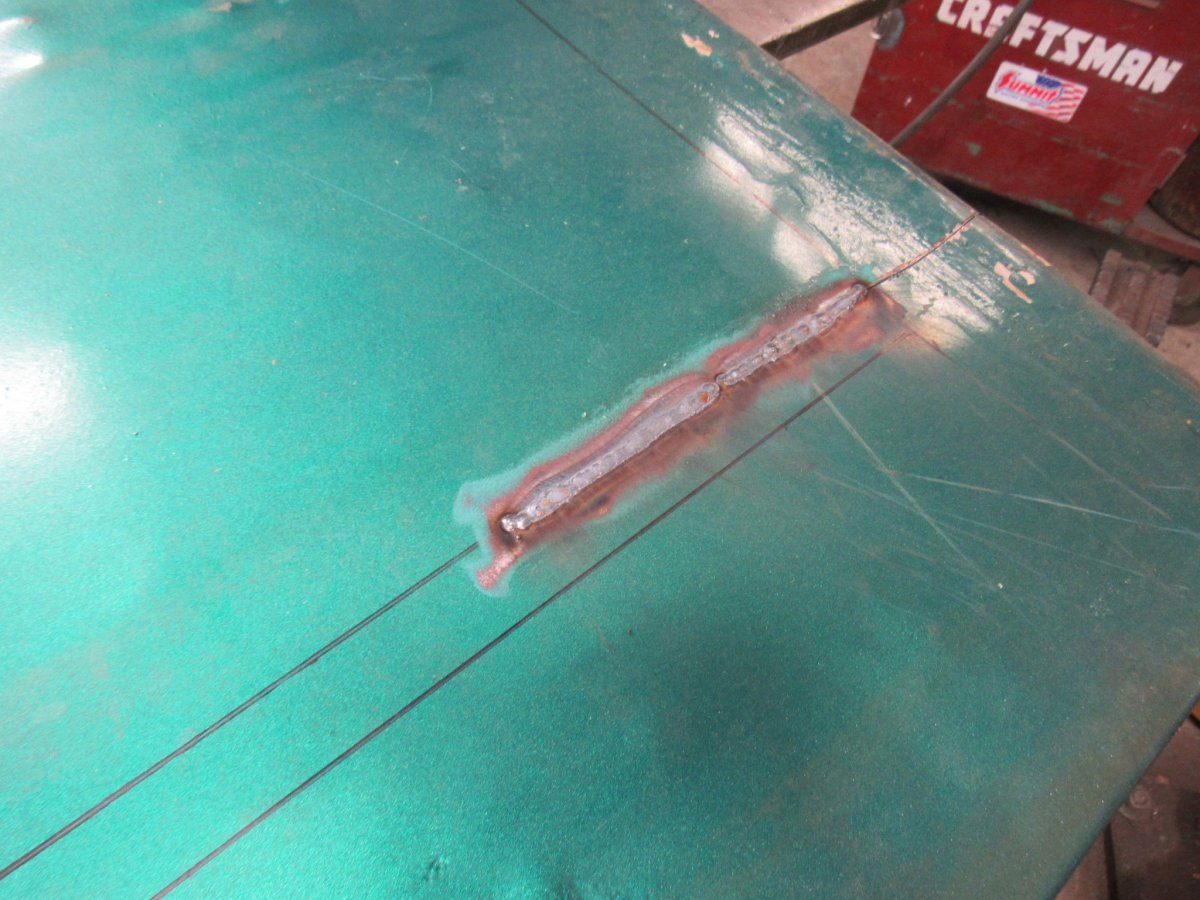

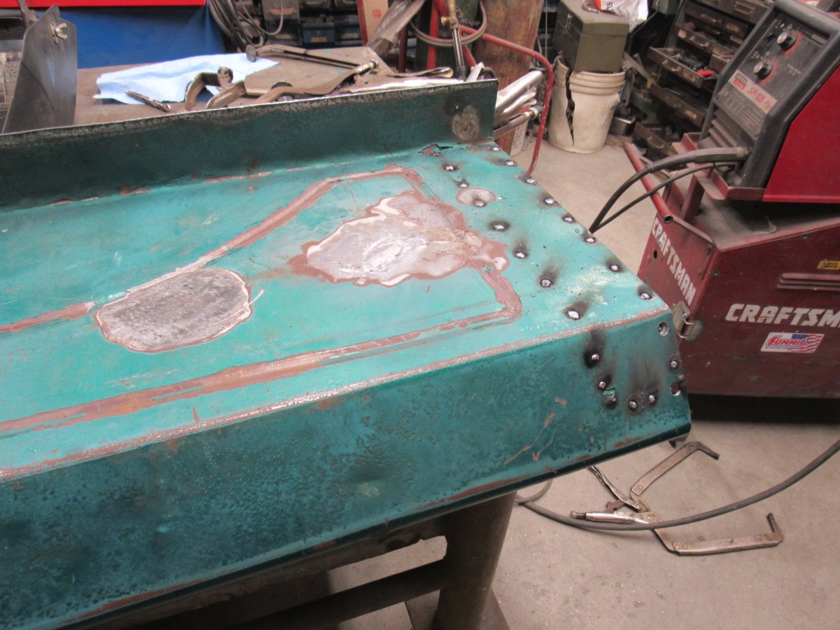

    I ground off the rusty parts of the bolts that protruded through, then welded a nut on the broken side and took the bolts out. once I fixed them both I welded one side back in. IMG_1528.JPG

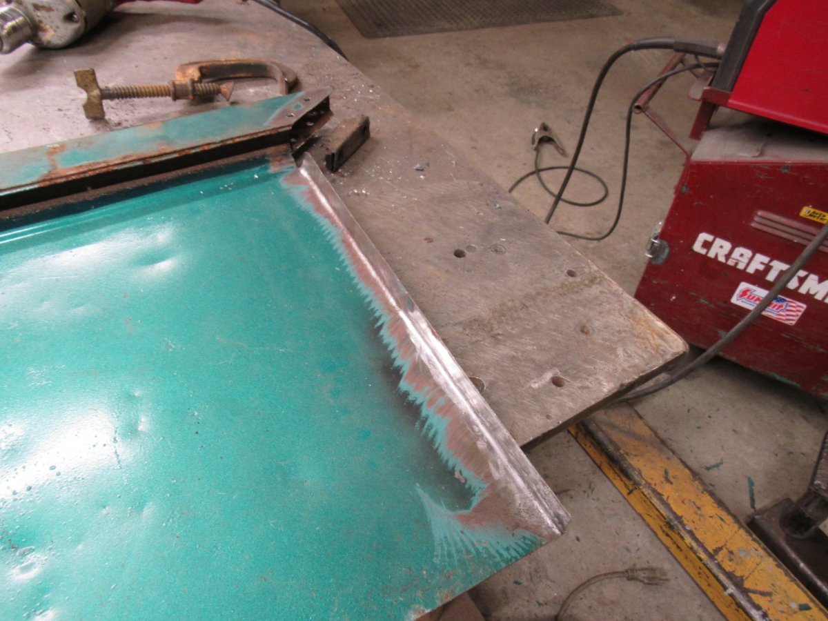

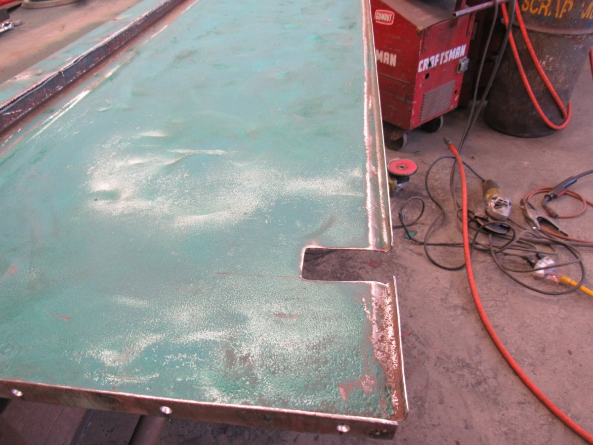

    of course I started cutting it out and half way into it I remembered I had to leave it 3/4" long to make a flange. so I had to weld it up. cut it in the right spots then bent up the flanges IMG_1530.JPG IMG_1531.JPG

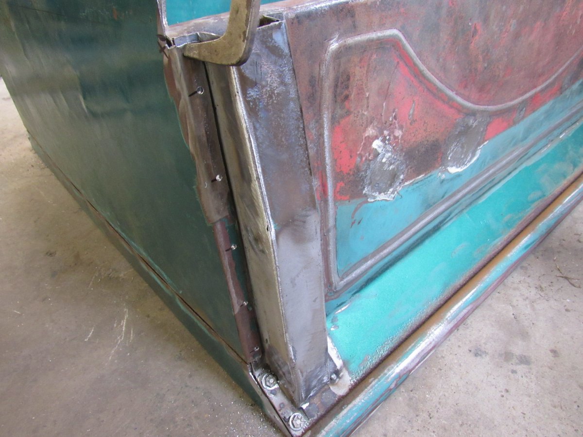

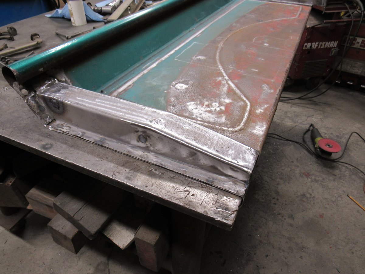

    I welded the bolting bracket back in the shortened side.
    IMG_1533.JPG it sort of looks like a model A bed

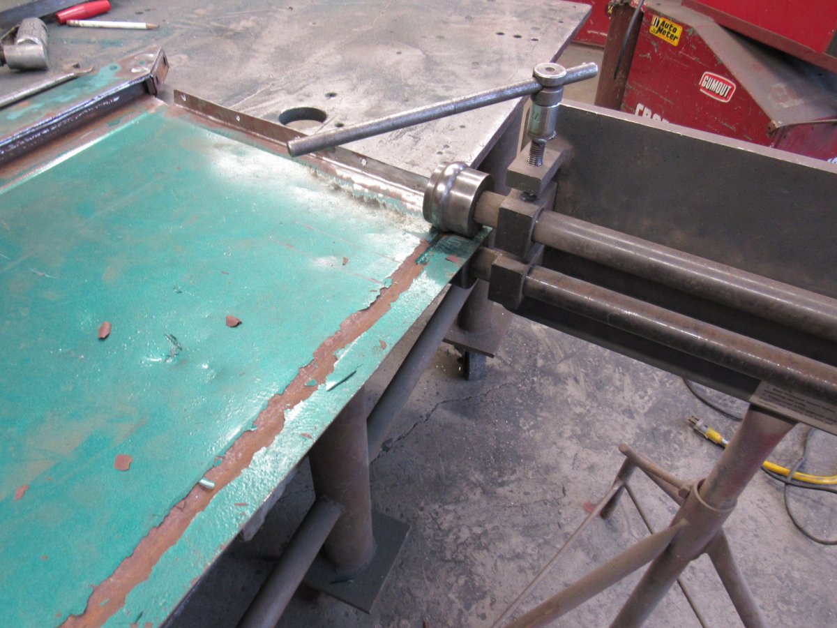

  13. TFoch
    Joined: Mar 31, 2010
    Posts: 2,414
    TFoch
    Looks great Ted. I like the idea of the wheel on the bead roller. I'll have to try it on mine.

  14. tb33anda3rd
    Joined: Oct 8, 2010
    Posts: 17,591
    tb33anda3rd
    Tom it really makes the bead roller so much easier to use. I did those panels by myself and was able to keep the beads straight.

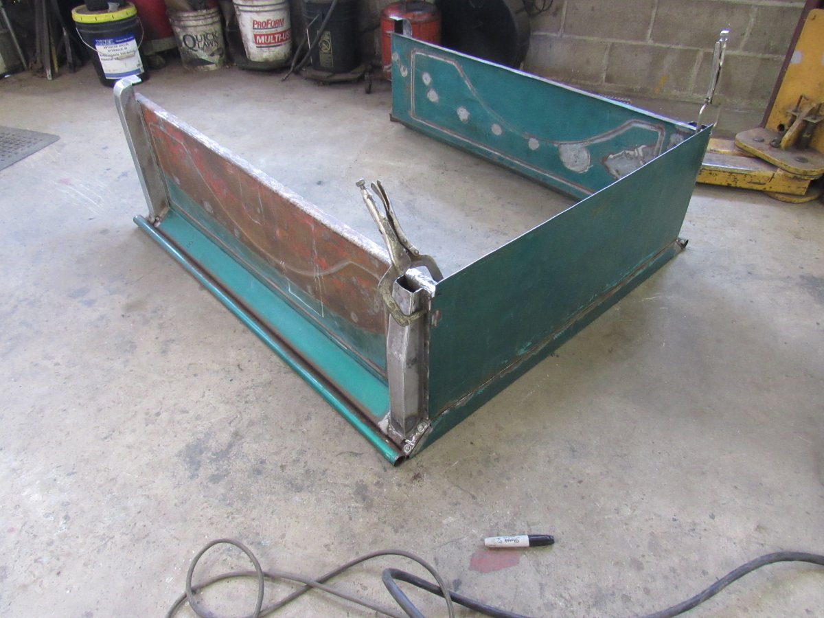

    if you look at my mockup, I even clamped the head board to the wrong end of the bed....o_O

    tonight I drilled the holes to bolt the head board on the bed sides. I used the piece I cut off as a template. IMG_1537.JPG I did drill them on the correct end.:)

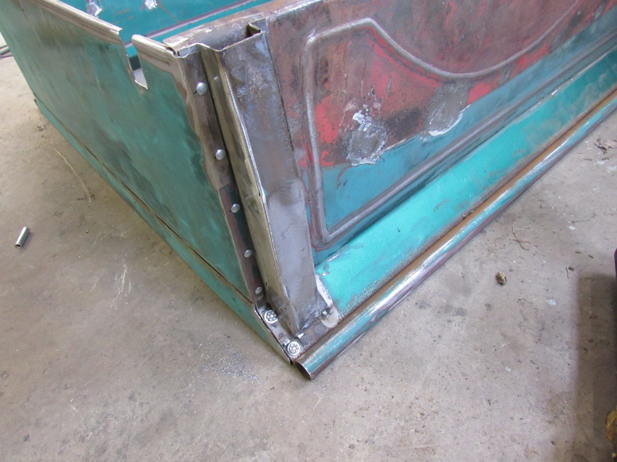

    I welded the stake pockets on, I put the shorter ones on the front and used the longer ones on the rear so I can extend below the bed to make a support across the rear. IMG_1538.JPG

    worked on the other side, welded the pockets on and cleaned the welds up. IMG_1548.JPG IMG_1549.JPG

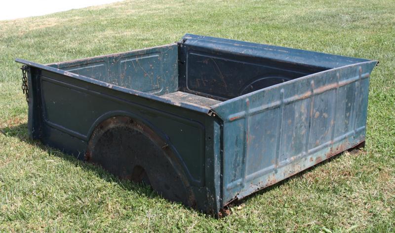

    this is the photo I have been using for inspiration. post-104573-143142842187_thumb.jpg
