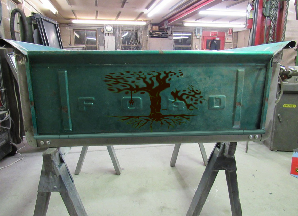

    yeah, and this gate is sooo beat up. there is nothing straight about it and is worn/pitted/ground thin.
    think, old celebrity with one too many face lifts. I am not a fan of the block letters and if I start cutting, I may just remove them. I can build a new gate faster and it would be perfect....but not perfect for this truck.
    I could cut just the letters out and raise them. I could cut a across the top just below the upper beam, take a section out and then add to the bottom by extending the flange I need to add anyway.
    I thought of a strip of the tree across the top to balance it out. I thought of painting a full tree with the roots starting at the bottom, the trunk running between the O and R and the canopy spreading out over the letters.

    Thee think too much! Anything you do will look good. Why? Because we are part of the same family.

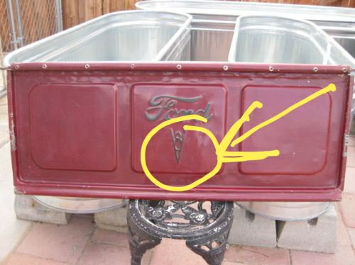

    Any chance you could come up with one of these stamped sections to fill that space? 20210114_114940.jpeg

    Charlie stopped at work today and i showed him this thread, he said he wants that V8 logo on it and likes the way the ford is low.

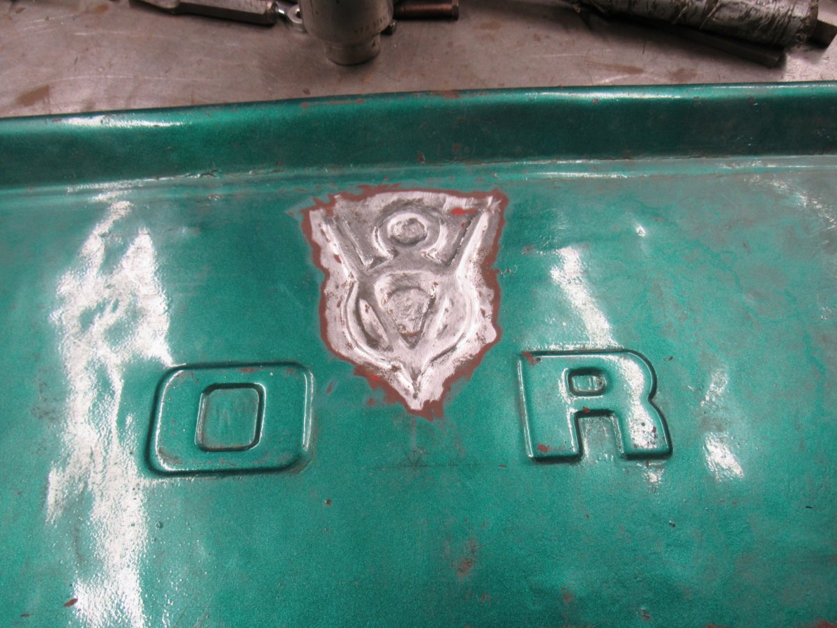

  11. tb33anda3rd
    Joined: Oct 8, 2010
    Posts: 17,595
    tb33anda3rd

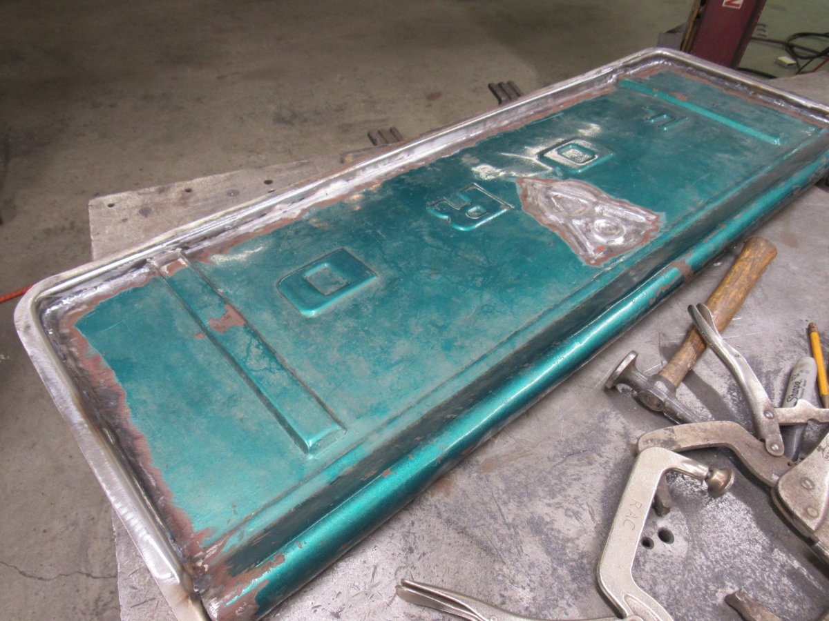

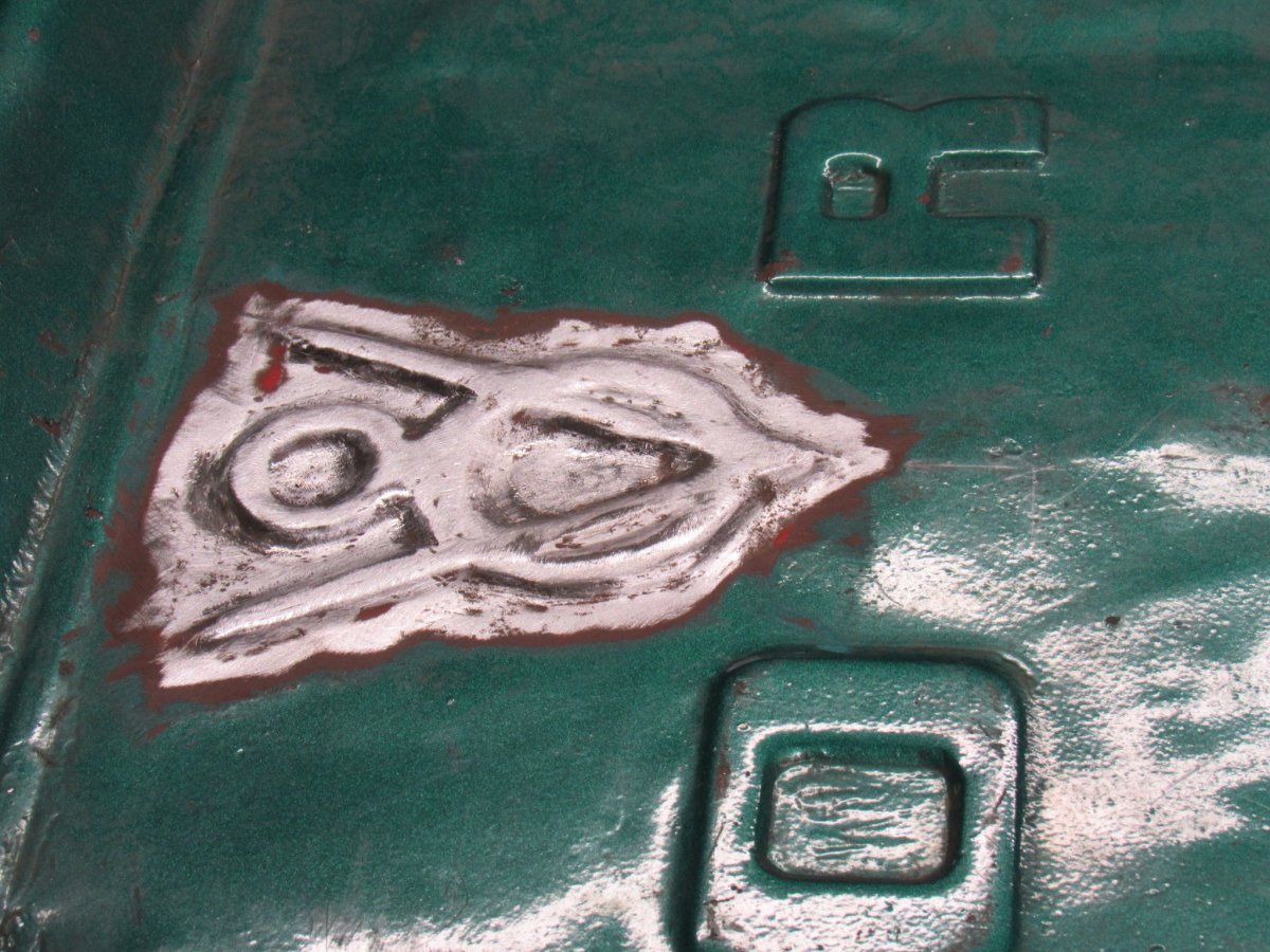

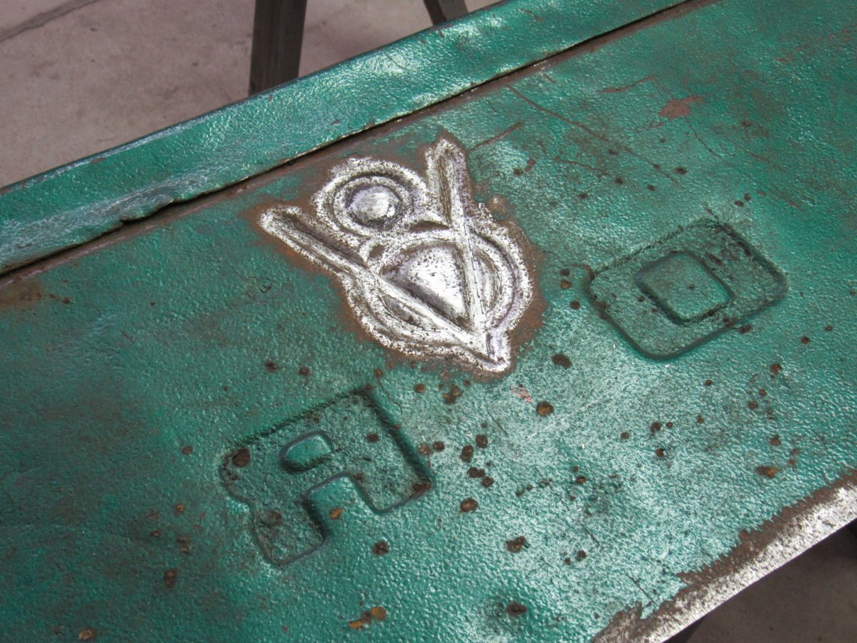

    then I hammered "off dolly" for a couple hours..... IMG_1587.JPG IMG_1588.JPG IMG_1589.JPG

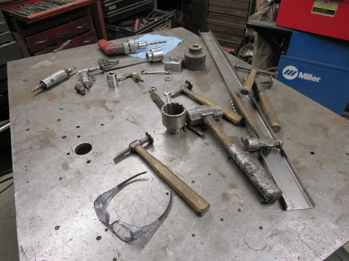

  12. tb33anda3rd
    Joined: Oct 8, 2010
    Posts: 17,595
    tb33anda3rd
    the back side, and the pile of tools. IMG_1590.JPG IMG_1591.JPG IMG_1592.JPG

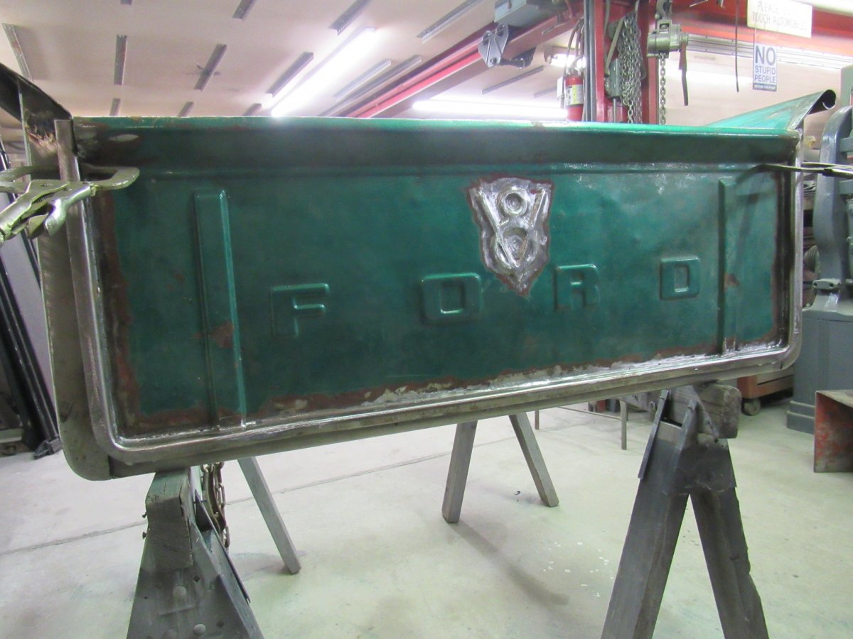

    snuck out of work early, Charlie came by to work on the bed. he sanded down the bed. IMG_1593.JPG
    chryslerfan55, brEad, TFoch and 3 others like this.
  23. tb33anda3rd
    Joined: Oct 8, 2010
    Posts: 17,595
    tb33anda3rd

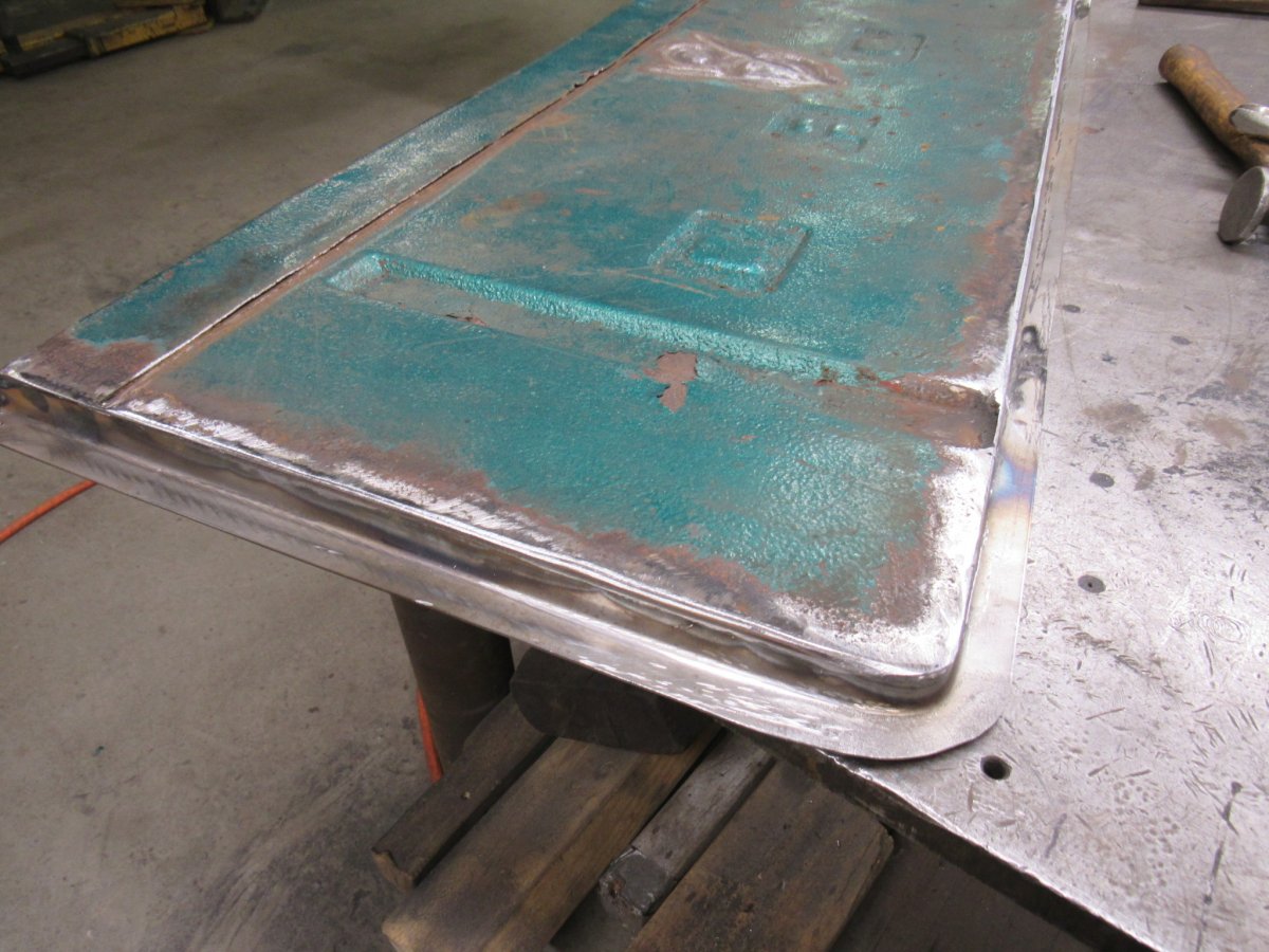

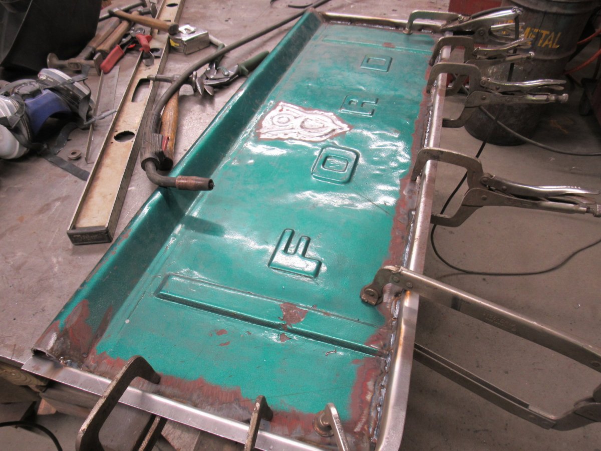

    I made up the angles for the perimeter. I had to stretch them to go around the corner. I welded them on with everything clamped to the table. IMG_1594.JPG IMG_1595.JPG IMG_1596.JPG
    chryslerfan55, brEad, TFoch and 5 others like this.
  24. tb33anda3rd
    Joined: Oct 8, 2010
    Posts: 17,595
    tb33anda3rd

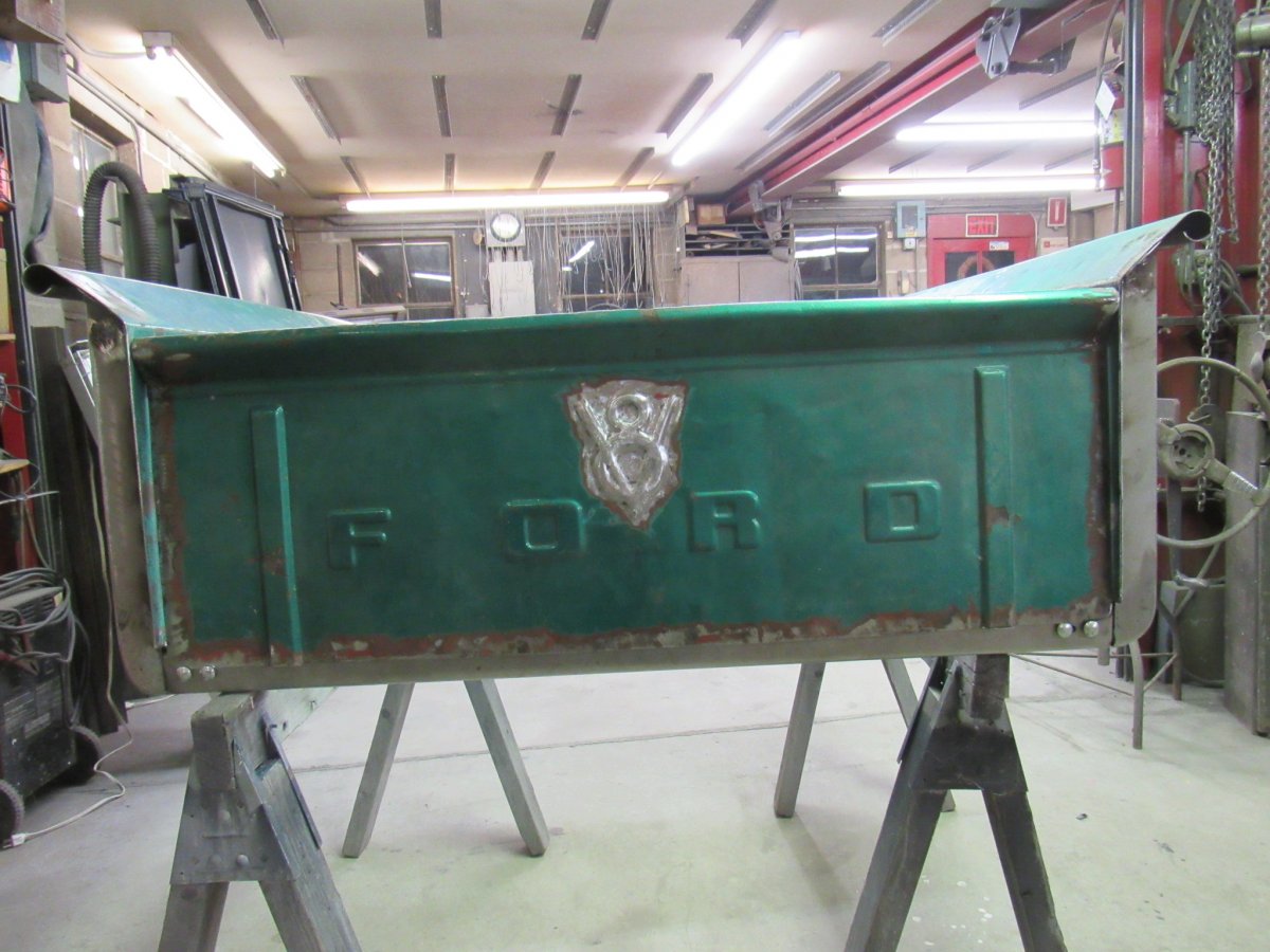

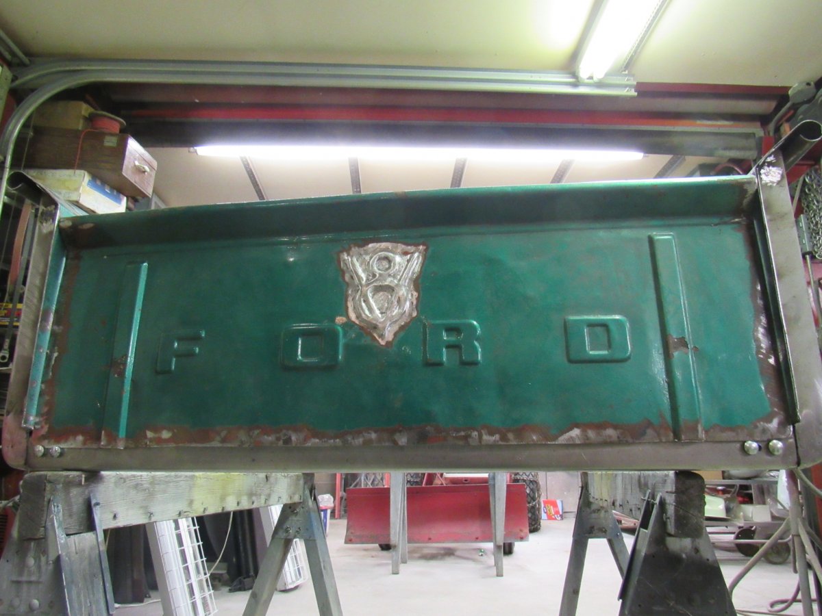

    cleaned up the welds and test fit it. IMG_1597.JPG IMG_1598.JPG IMG_1599.JPG IMG_1600.JPG

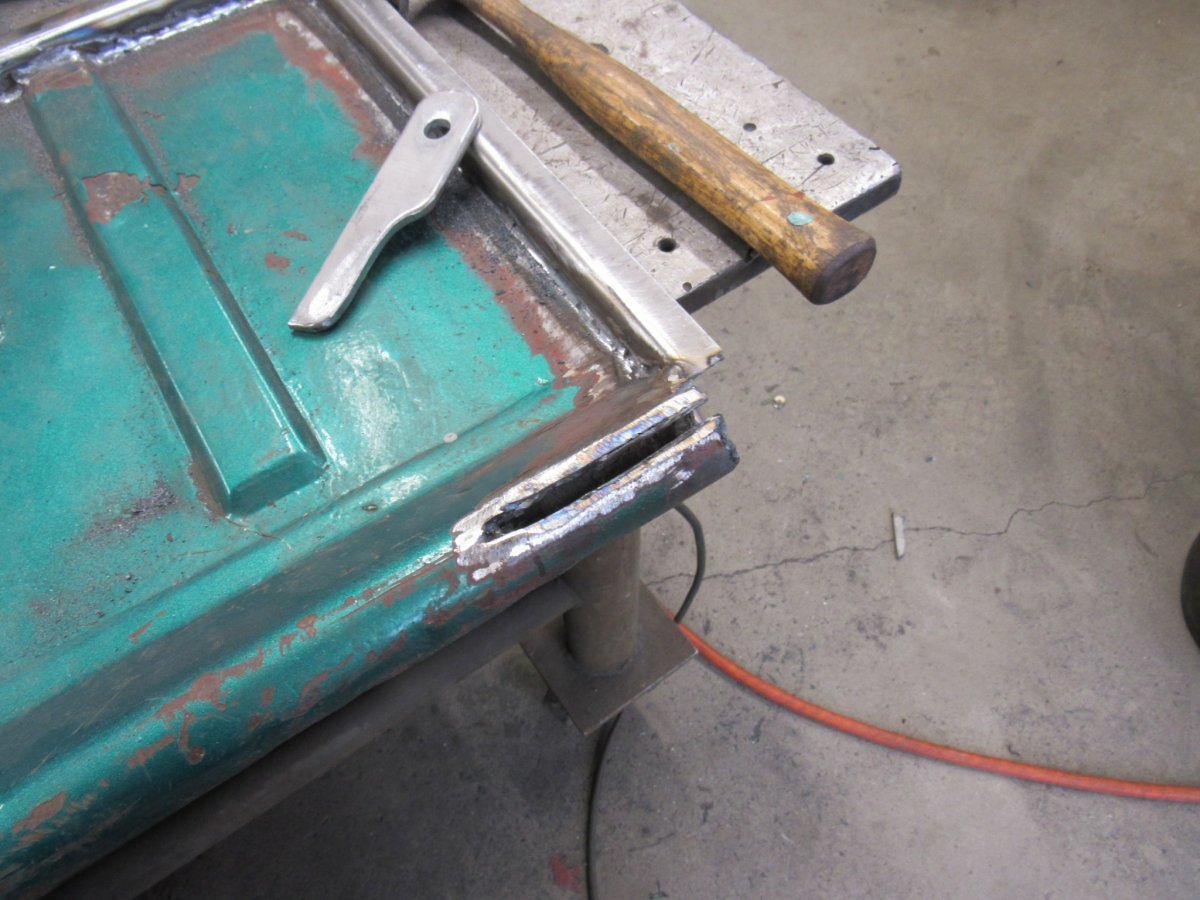

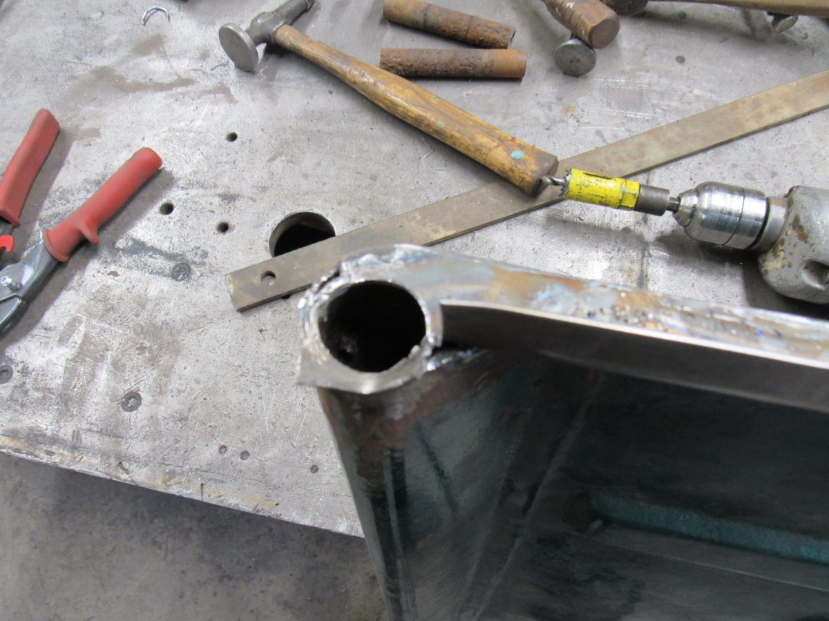

  29. tb33anda3rd
    Joined: Oct 8, 2010
    Posts: 17,595
    tb33anda3rd
    thanks guys!

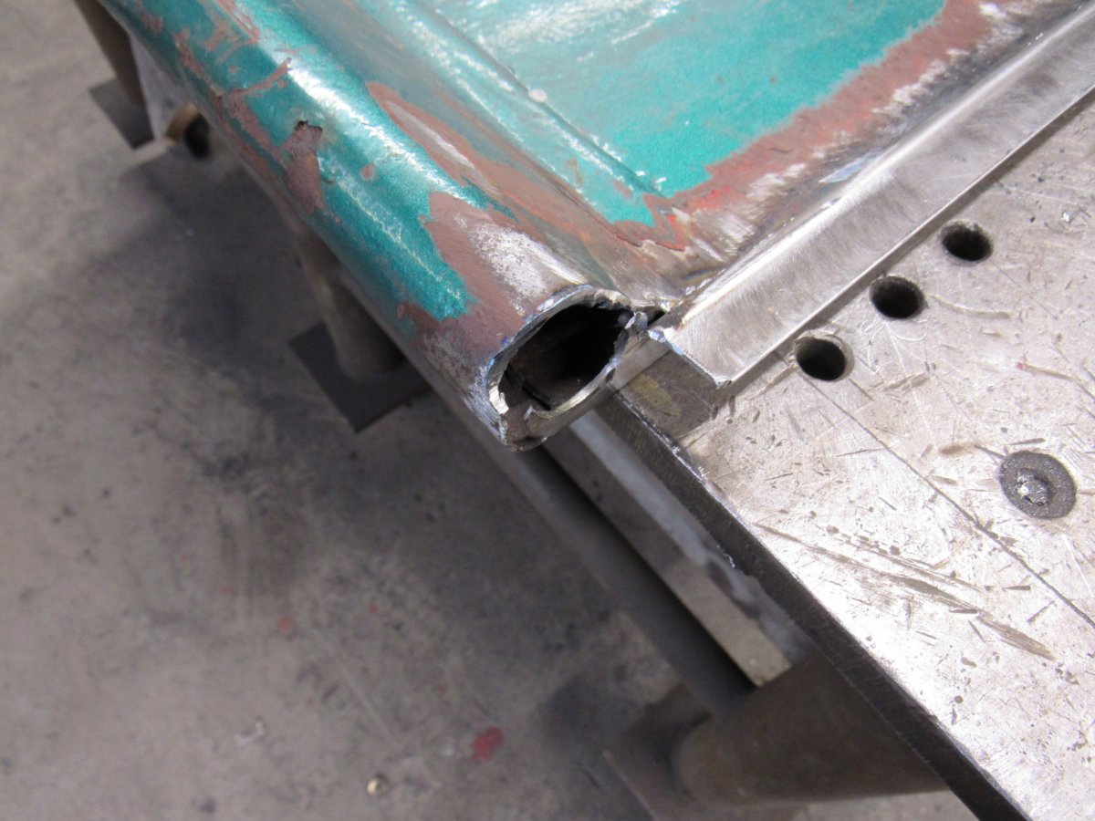

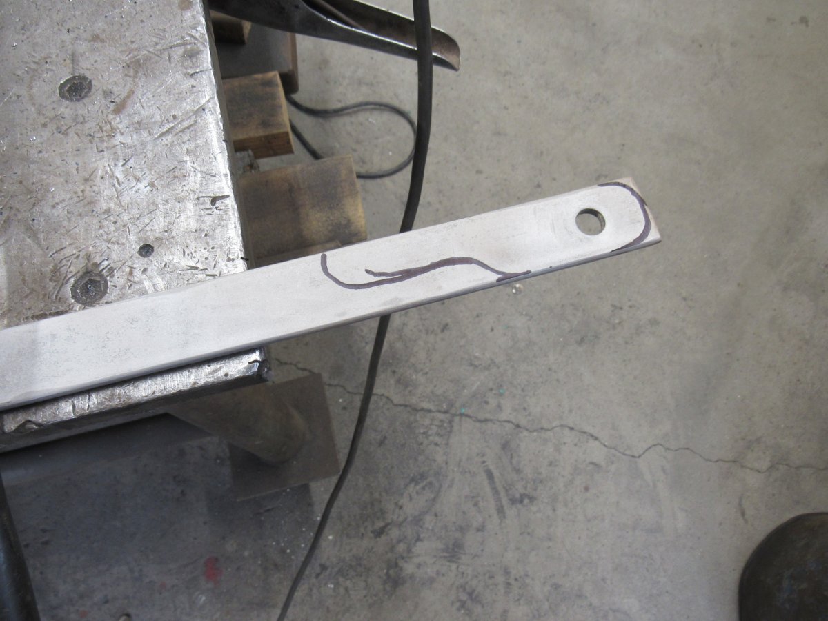

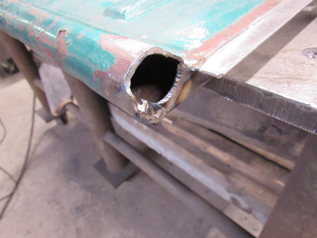

    I missed a few photos but I drilled into the ends of the upper tube and slid the original steel tube back in. I welded the ends up, the cut a couple grooves in the face side. IMG_1602.JPG IMG_1603.JPG IMG_1604.JPG IMG_1605.JPG
    chryslerfan55, Stogy, brEad and 4 others like this.

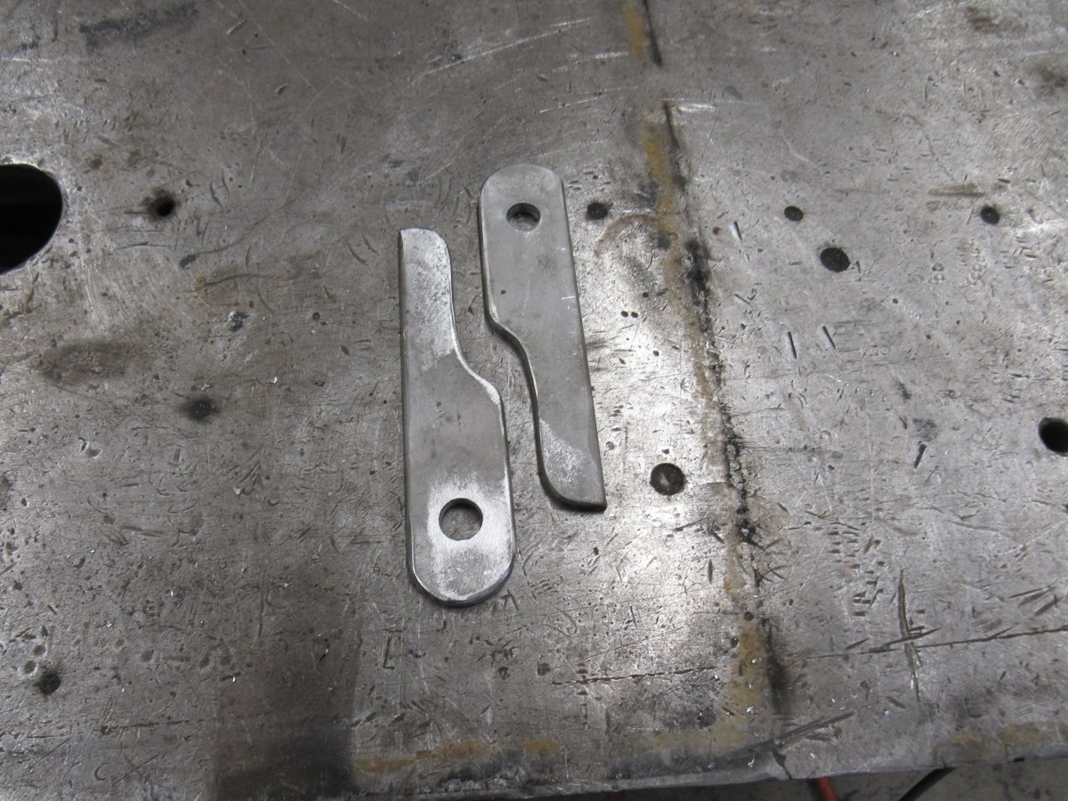

  30. tb33anda3rd
    Joined: Oct 8, 2010
    Posts: 17,595
    tb33anda3rd
    I cut a couple grooves in the face side through the sheet metal and into the ends of the pipe. I then cut a couple brackets for the chain hooks. I pounded them in and welded them up. IMG_1606.JPG IMG_1607.JPG IMG_1608.JPG IMG_1609.JPG IMG_1610.JPG
