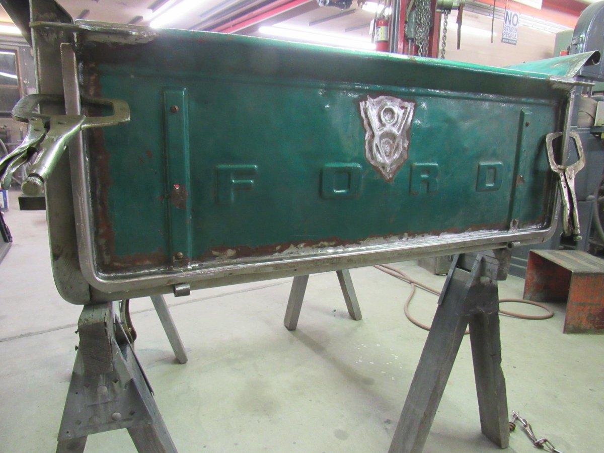

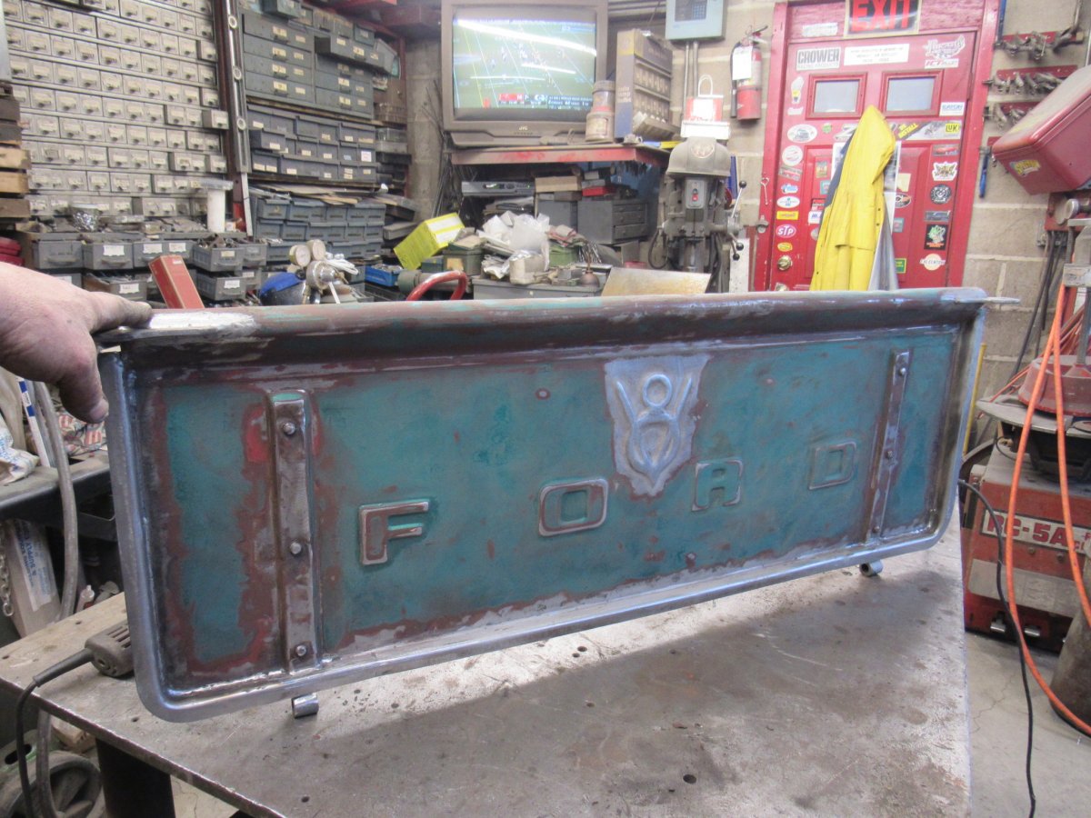

    I made up a strap hinge that will eventually get riveted in. I put a couple screws in till I prep the back sides. IMG_1611.JPG

    plan is to make up four brackets to bolt through the rear brace with a couple pins for the hinge. IMG_1615.JPG

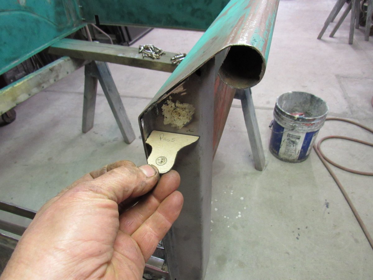

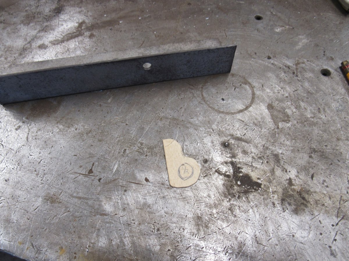

    made a template for the brackets out of card stock and cut them out of 2x1 angle. I drilled them out and made a couple pins out 1/2" rod, using a washer for the head and drilling out the opposite end for a cotter pin. IMG_1617.JPG IMG_1618.JPG

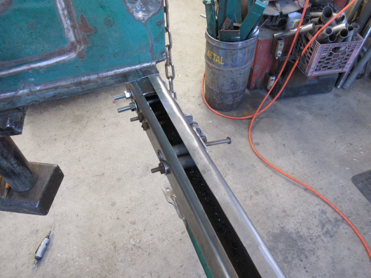

    I shimmed the gate on either side and clamped it in place, ***embled the hinges and clamped them down. I drilled out the crossmember. I used round head slotted 1/4" bolts IMG_1619.JPG

    once bolted down I tried the gate.

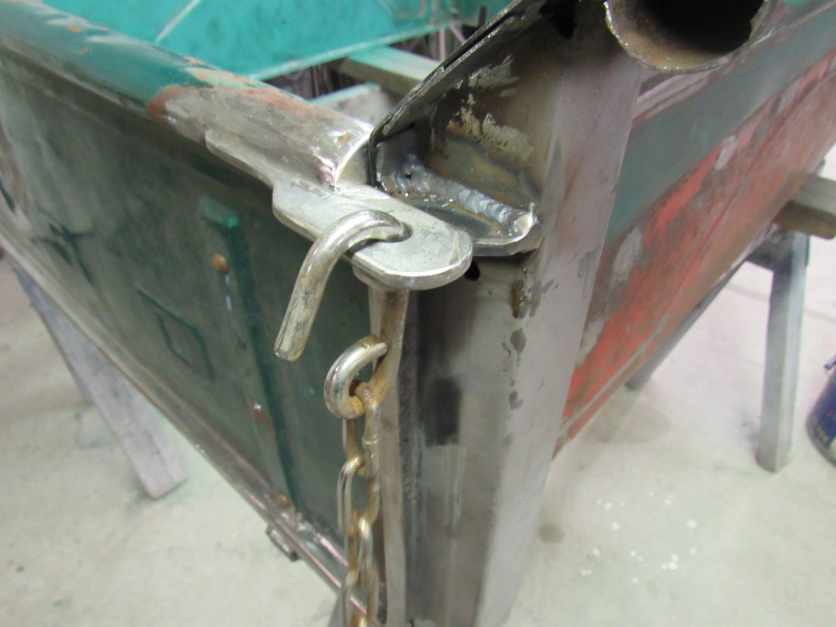

    almost done. I made a cardboard template for the other half of the hook system to hold the tailgate up. I cut them out and welded them in place. IMG_1624.JPG IMG_1625.JPG
  12. tb33anda3rd
    Joined: Oct 8, 2010
    Posts: 17,591
    tb33anda3rd
    while it was cooling I cut the belt buckle **** off the chains, and attached the chain right to the eyelet .I marked for the hole, drilled it and filed it square. IMG_1623.JPG

    gate swinging and latching and lays flat for sitting on. next step will be to finish the rear cross member. IMG_1629.JPG

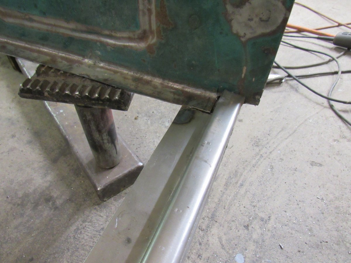

    made some tubes for the rear support to keep the hinge bolts from crushing it. I drilled a 3/4" hole through the back side and used EMT pipe. I also filed the holes for the carriage bolts that bolt it to the sides. IMG_1639.JPG IMG_1640.JPG IMG_1641.JPG

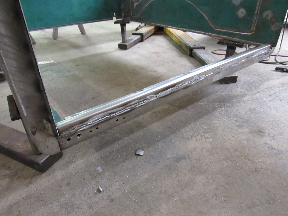

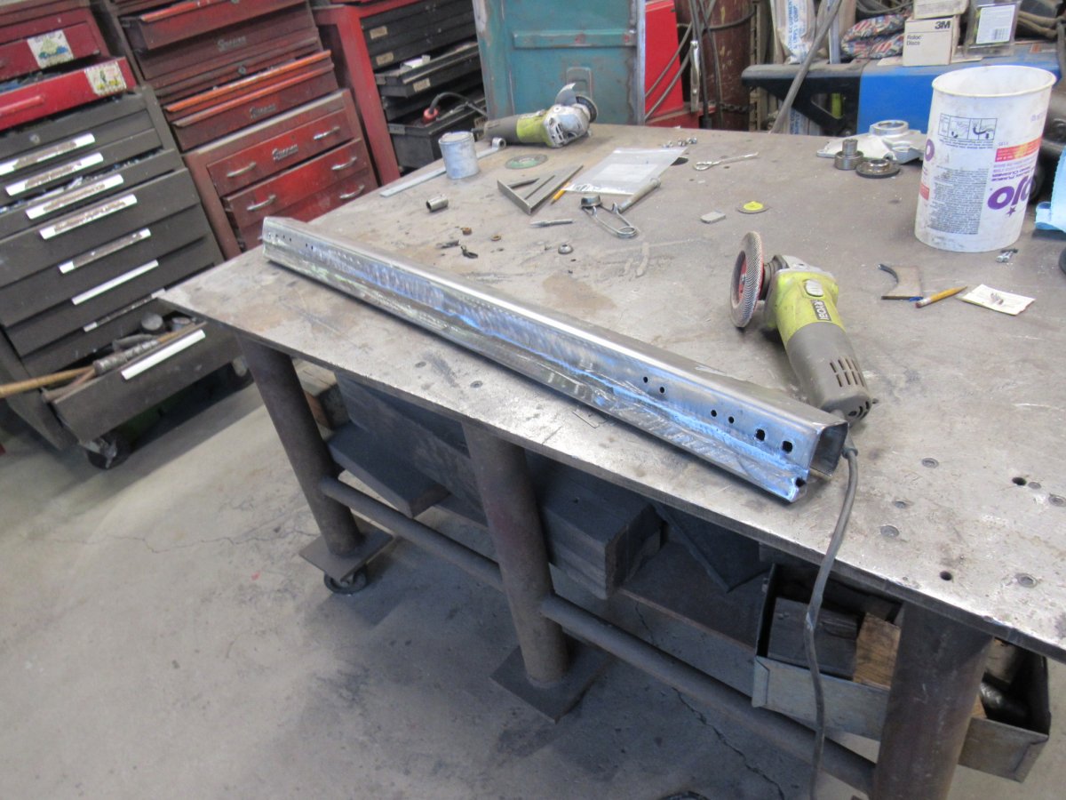

    I then trimmed the top flanges back on the cross member and coated the inside with weld through primer. I bent a piece of 16 gage to make the trim piece for the top of the crossmember. this will give a metal edge for loading the bed and finish and protect the ends of the bed wood floor. IMG_1642.JPG

    I ran out of wire in that machine so I couldn't finish the welds. but I did take it apart to prep for primer and paint tomorrow. IMG_1648.JPG

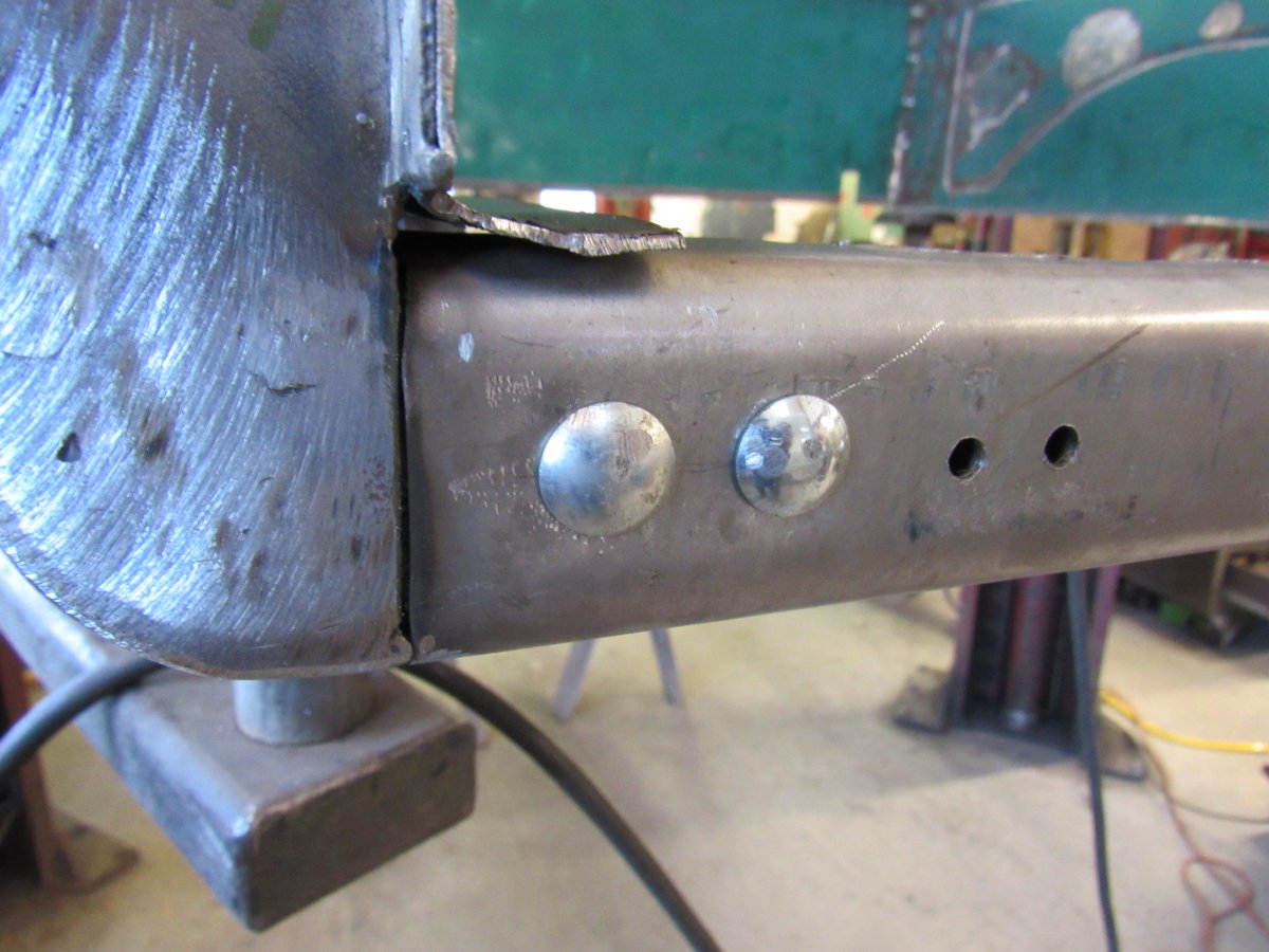

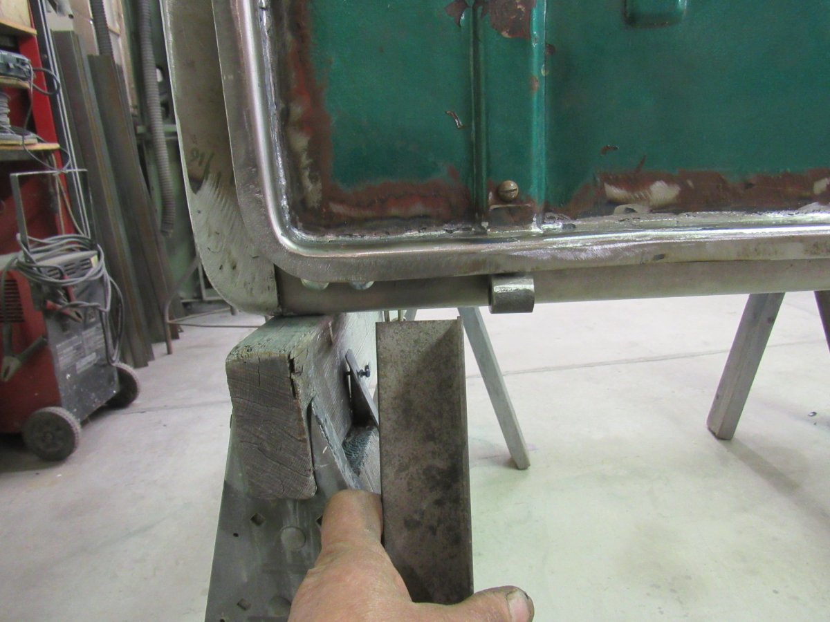

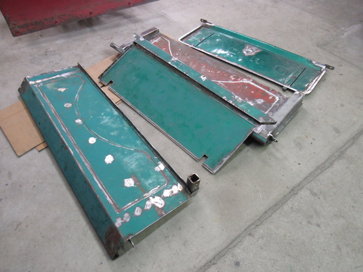

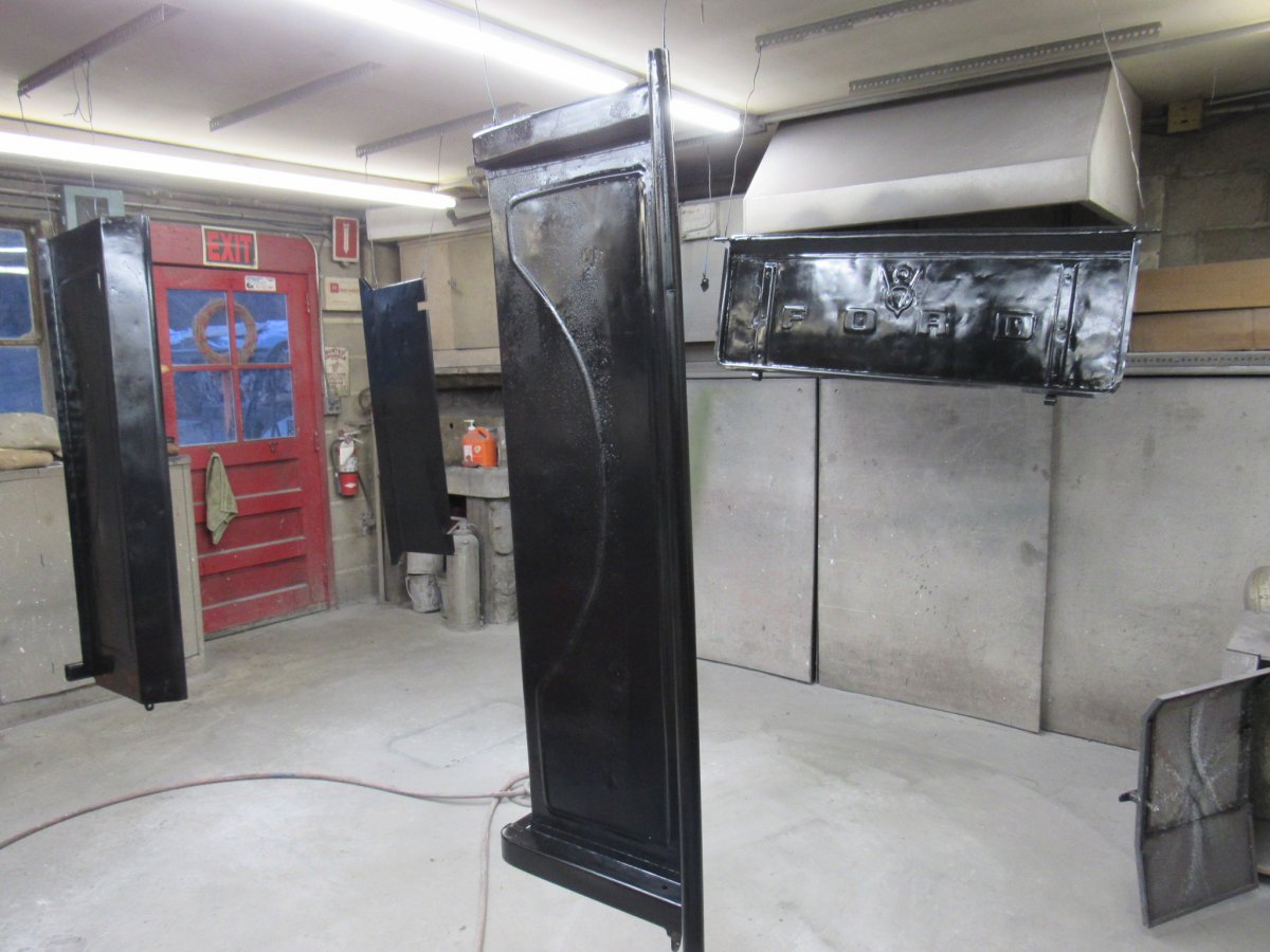

    I unbolted the strap hinges from the gate and sand blasted the area behind them. I then put a weld through primer on the adjoining surfaces so I could heat the rivets up that will hold them on. IMG_1651.JPG IMG_1652.JPG IMG_1653.JPG
