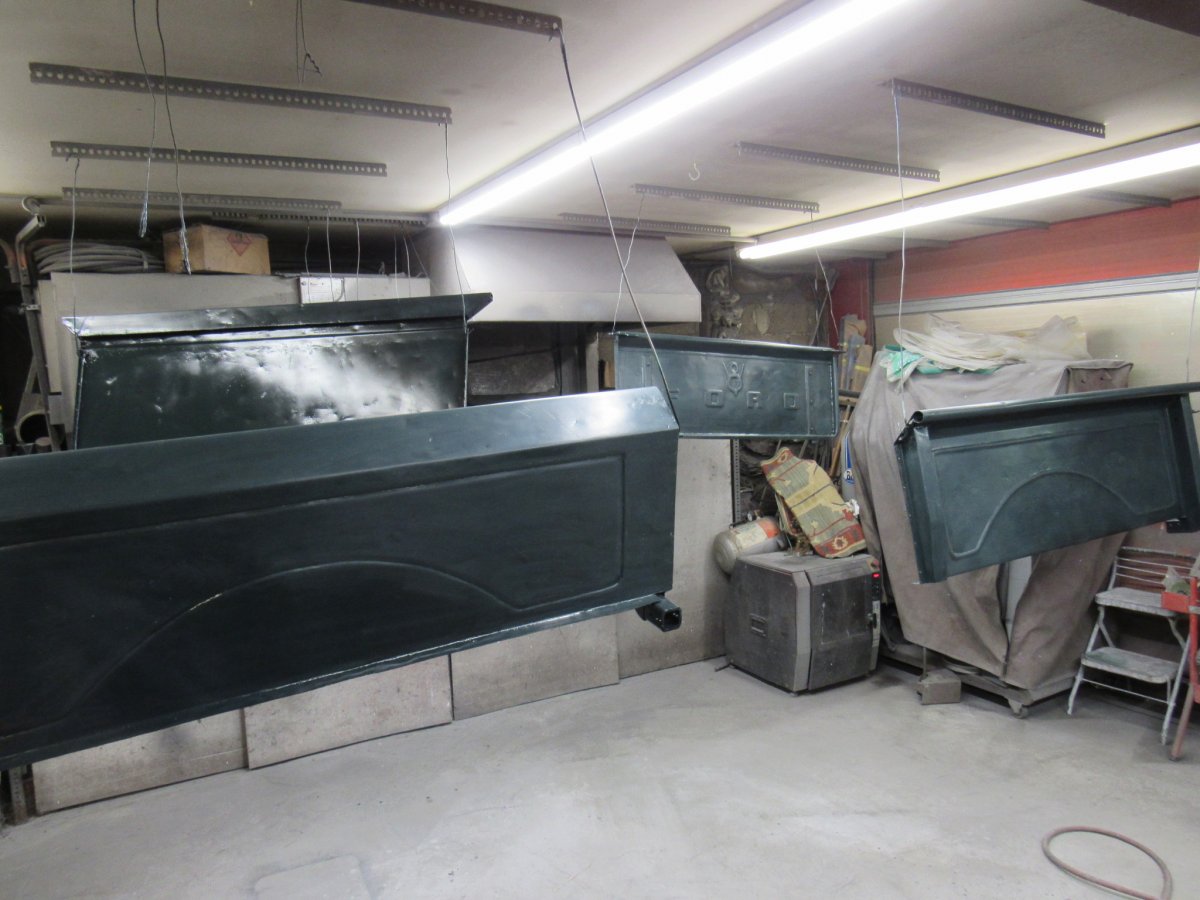

    took about a can and a third to spray. this is really nice paint and it dries fast. IMG_1657.JPG

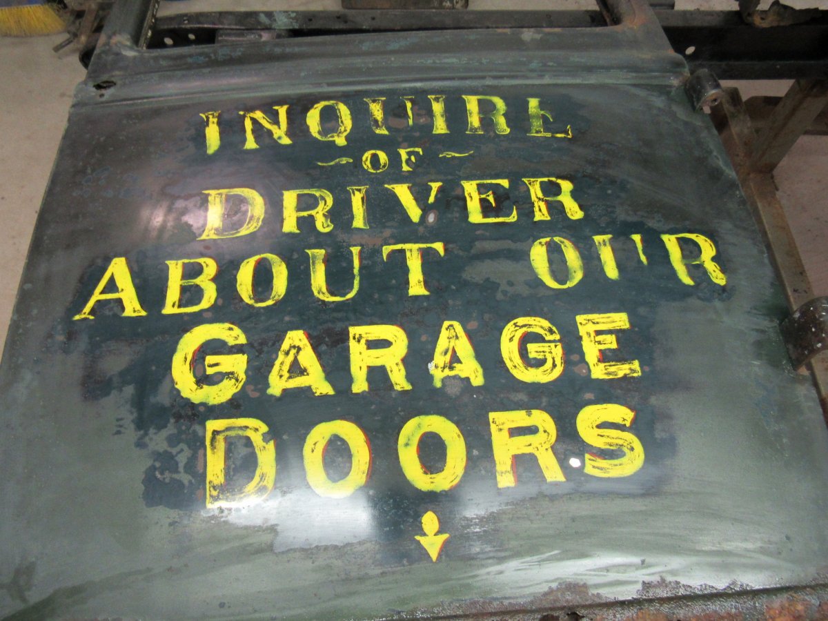

    Do you need me to do the letters on the tailgate. I will make them look old.

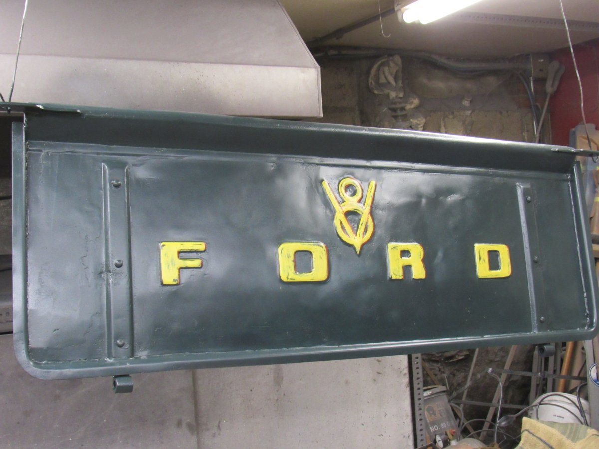

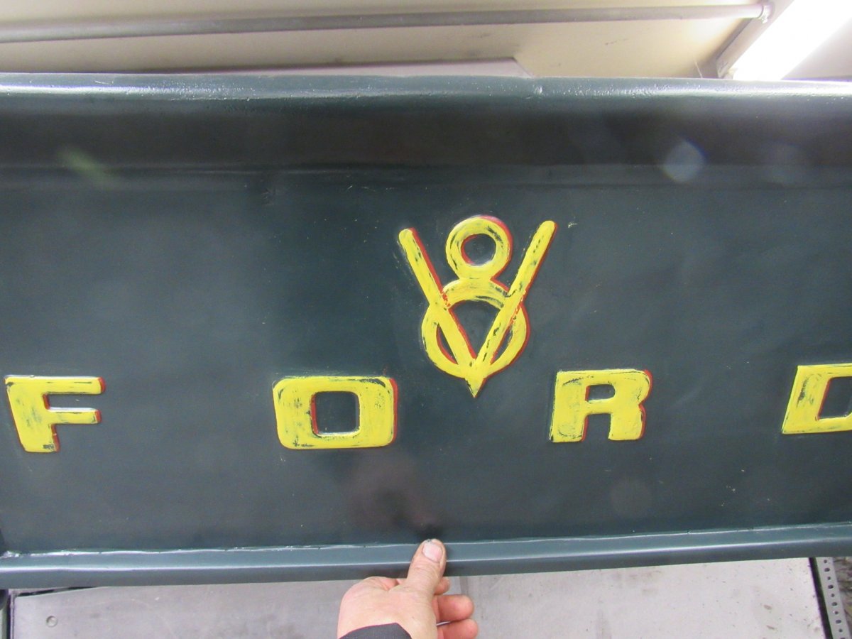

  5. tb33anda3rd
    Joined: Oct 8, 2010
    Posts: 17,591
    tb33anda3rd

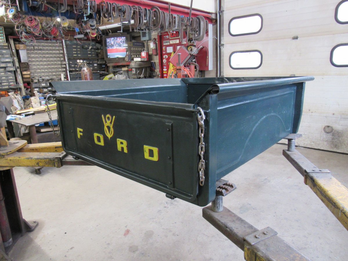

  7. tb33anda3rd
    Joined: Oct 8, 2010
    Posts: 17,591
    tb33anda3rd
    went to work and came home to find this. Nice job Mark and a perfect match to the doors. IMG_1661.JPG IMG_1662.JPG

  9. ct1932ford
    Joined: Dec 3, 2010
    Posts: 13,369
    ct1932ford
    Thanks! Enjoyed doing it since Ted is always there for me.:cool:

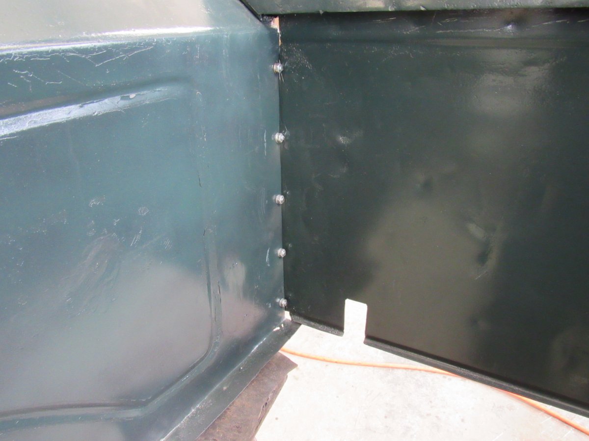

    just getting around to posting the little bit I got done. I painted the hardware and ***embled the bed. IMG_1670.JPG IMG_1663.JPG IMG_1664.JPG IMG_1665.JPG

    I put the front carriage bolts in then trimmed them down. I painted them with the spray paint after. IMG_1671.JPG IMG_1672.JPG

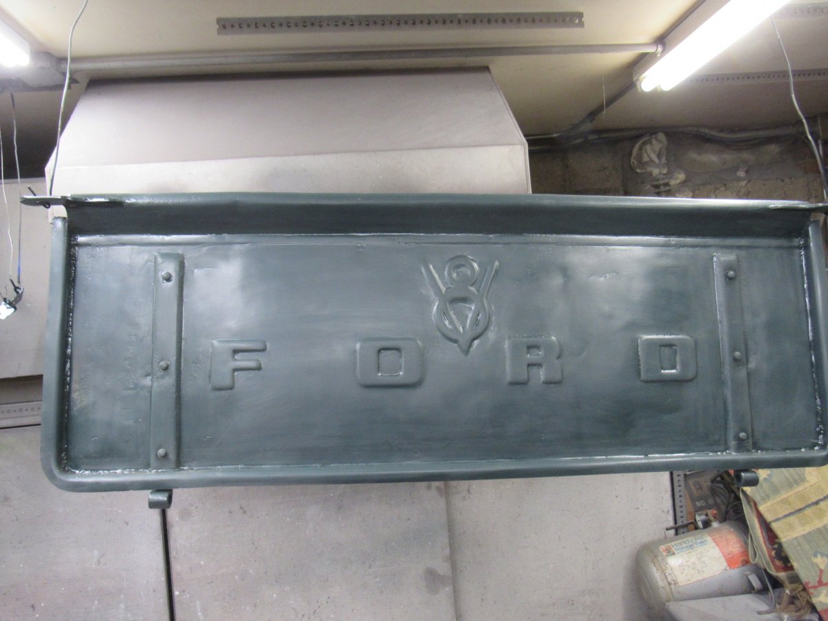

    on the tail gate I added a piece of dense weather stripping to keep the gate from rattling and chipping the paint. IMG_1673.JPG

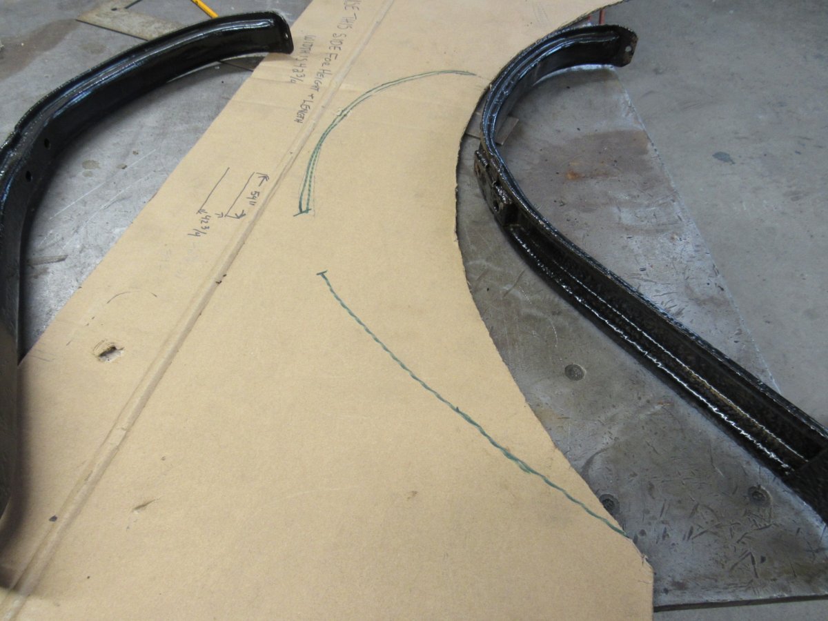

  16. tb33anda3rd
    Joined: Oct 8, 2010
    Posts: 17,591
    tb33anda3rd
    I traced the arch out on a piece of cardboard, then bent the braces to match. IMG_1675.JPG

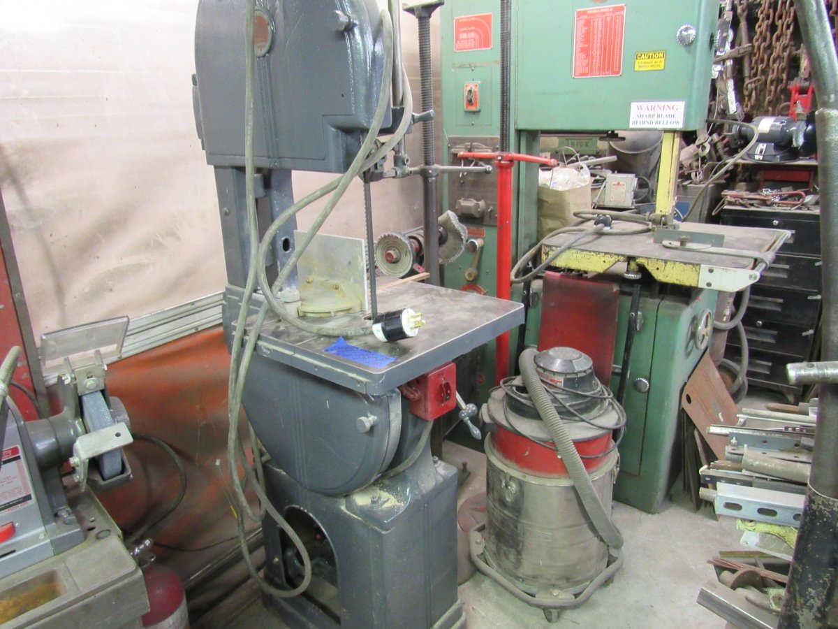

  17. tb33anda3rd
    Joined: Oct 8, 2010
    Posts: 17,591
    tb33anda3rd

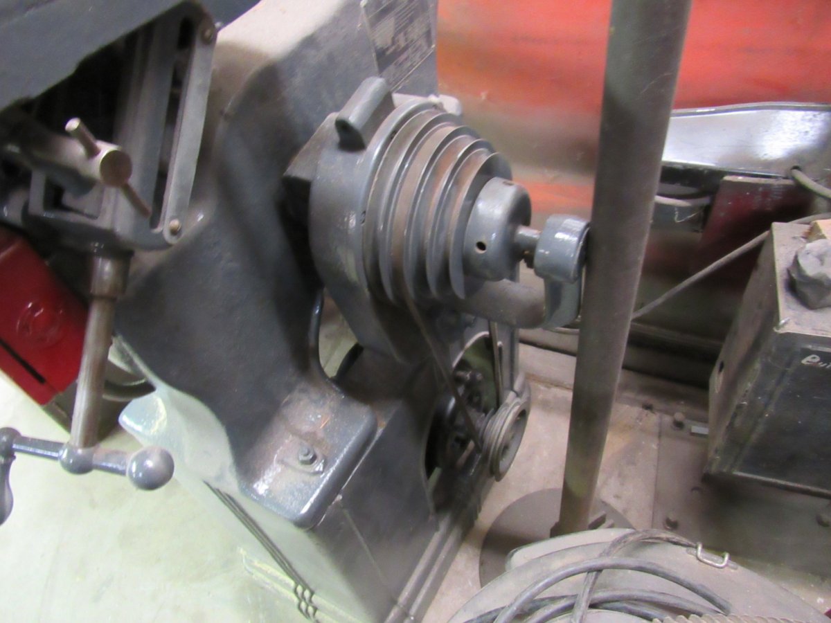

    I decided it was time to get the band saw working properly so I could mill the boards for the bed. I ran all new wires and cleaned the switch contact points. I found a 220 motor I had but had to make it mount to the machine, I made a new mounting plat and welded it to the motor base. I also had to found the perfect pulley in my stash. machine works perfect. IMG_1679.JPG IMG_1678.JPG

  19. tb33anda3rd
    Joined: Oct 8, 2010
    Posts: 17,591
    tb33anda3rd
    yep. I used the motor from the wood band saw in the other one. it had a double large pulley on it and it was better suited to it. I had to adapt that mount also. they are both 2 horsepower, the metal band saw turns 1725 rpm and has a 5" pulley. the wood band saw now has a 3450 rpm motor with 4 pulleys ranging from 1"4". they both seem to be happy.

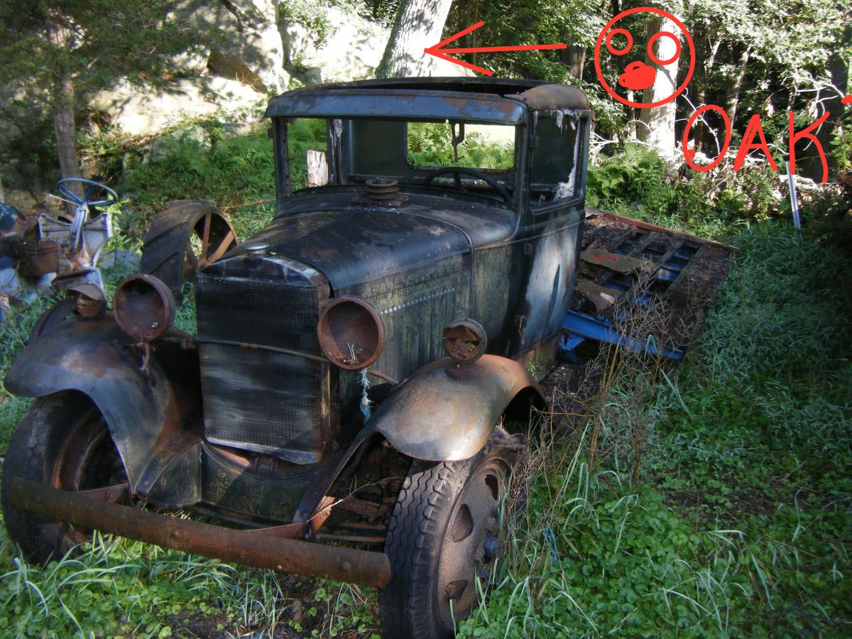

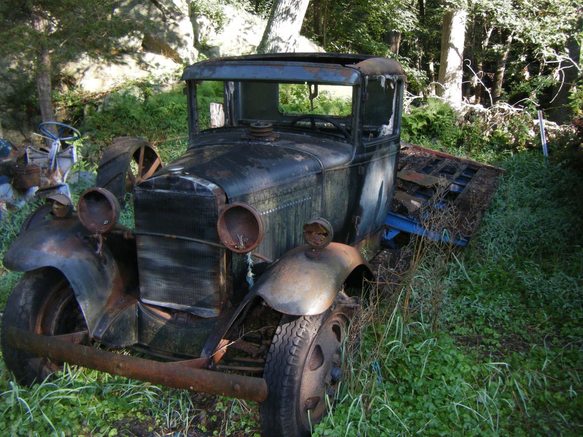

    I had been to the farm that Charlie had gotten the truck many years ago and had forgotten I took photos of the truck.
    I was going through my photos and ran across a couple pictures of the trucks BEFORE the tree fell on them. DSCF0917.JPG DSCF0918.JPG

    Looks great! What’s the process for aging the letters? Do you sand through them after they’re dry? Or is it just in the brush technique?

  22. tb33anda3rd
    Joined: Oct 8, 2010
    Posts: 17,591
    tb33anda3rd
    I think Mark just sand and buffed it.
    @ct1932ford ?
  23. ct1932ford
    Joined: Dec 3, 2010
    Posts: 13,369
    ct1932ford
    It looks best when you put the paint on then wear it down as if time has done it. It takes practice and patience to get the correct look. I use many different techniques. Thanks!

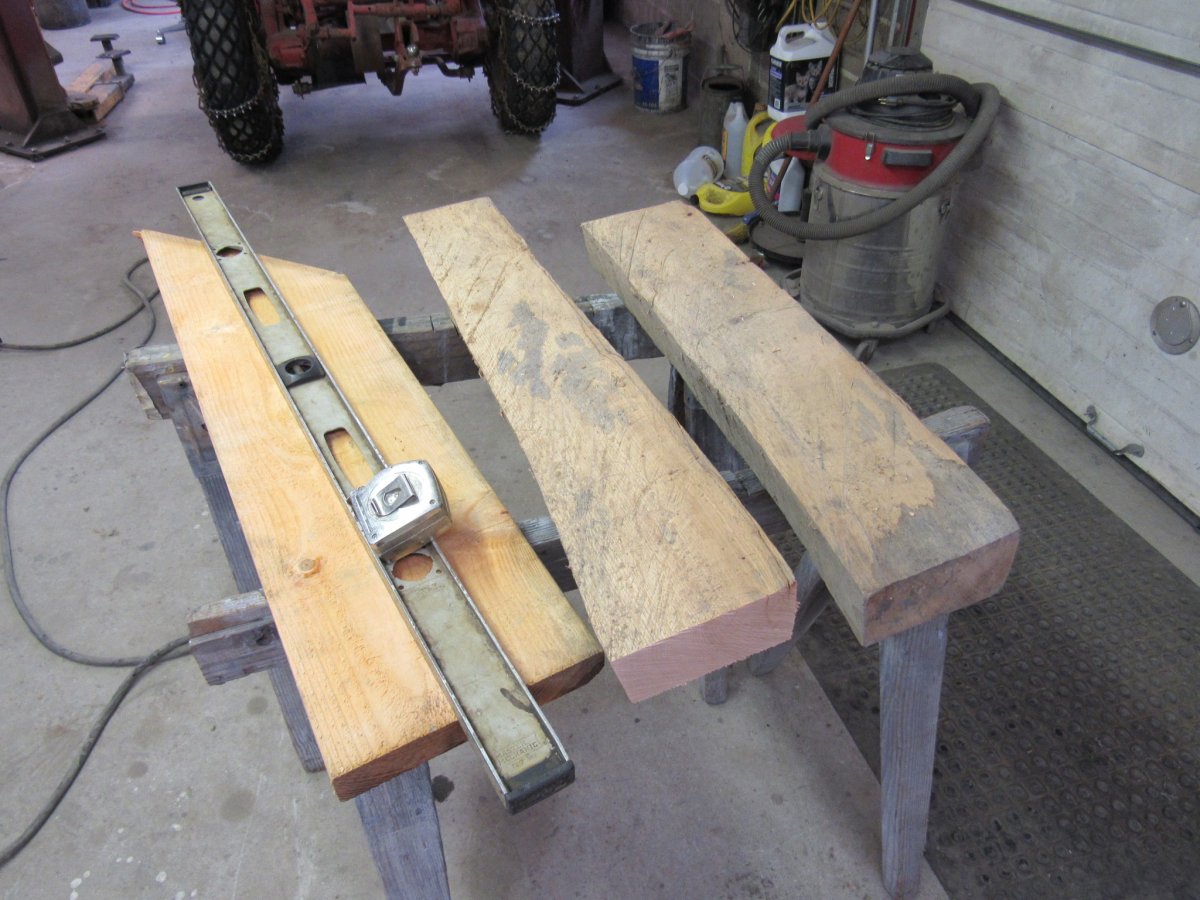

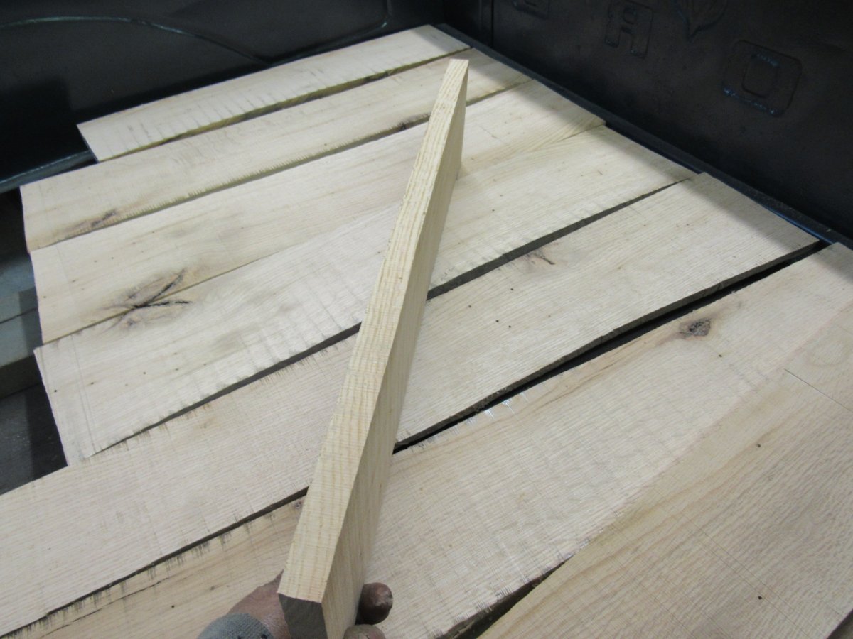

    now that both saws are up and running I wanted to cut the planks for the bed. since the fuel tank and battery take up the front half of the bed, and will be covered with a tool box, I only needed bed wood from rear spring crossmember back. I started by chain sawing the remaining two boards in half. I screwed the straitest edge of the board to a 2x12 to give me a sled to run the piece through the band saw. once one edge was straight I screwed the freshly cut edge to the sled and squared up the straightest edge. before I could finish the second cut the motor quit. the thermal protection ****on popped. I don't know where I had gotten the motor but it needs work. IMG_1680.JPG IMG_1681.JPG IMG_1682.JPG

    I put an aggressive 1" blade in the other saw and turned the speed up. I set up a "fence" and cut the boards to about 1". this should allow them to be planed to 3/4" . once I made 9 boards I cut them on the table saw to width. 5 of them are 4 3/4" wide and 4 are 5 3/4" wide. I will only need 8. IMG_1683.JPG

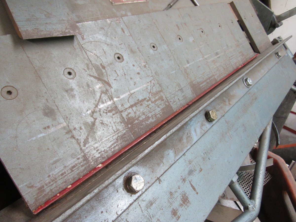

    I had saved a set of bed strips from a project the I had replaced with stainless steel. I cut one into three pieces and bent a couple to use as the out side angles. I fit them into the brake and bent them at the edge of the bead.
