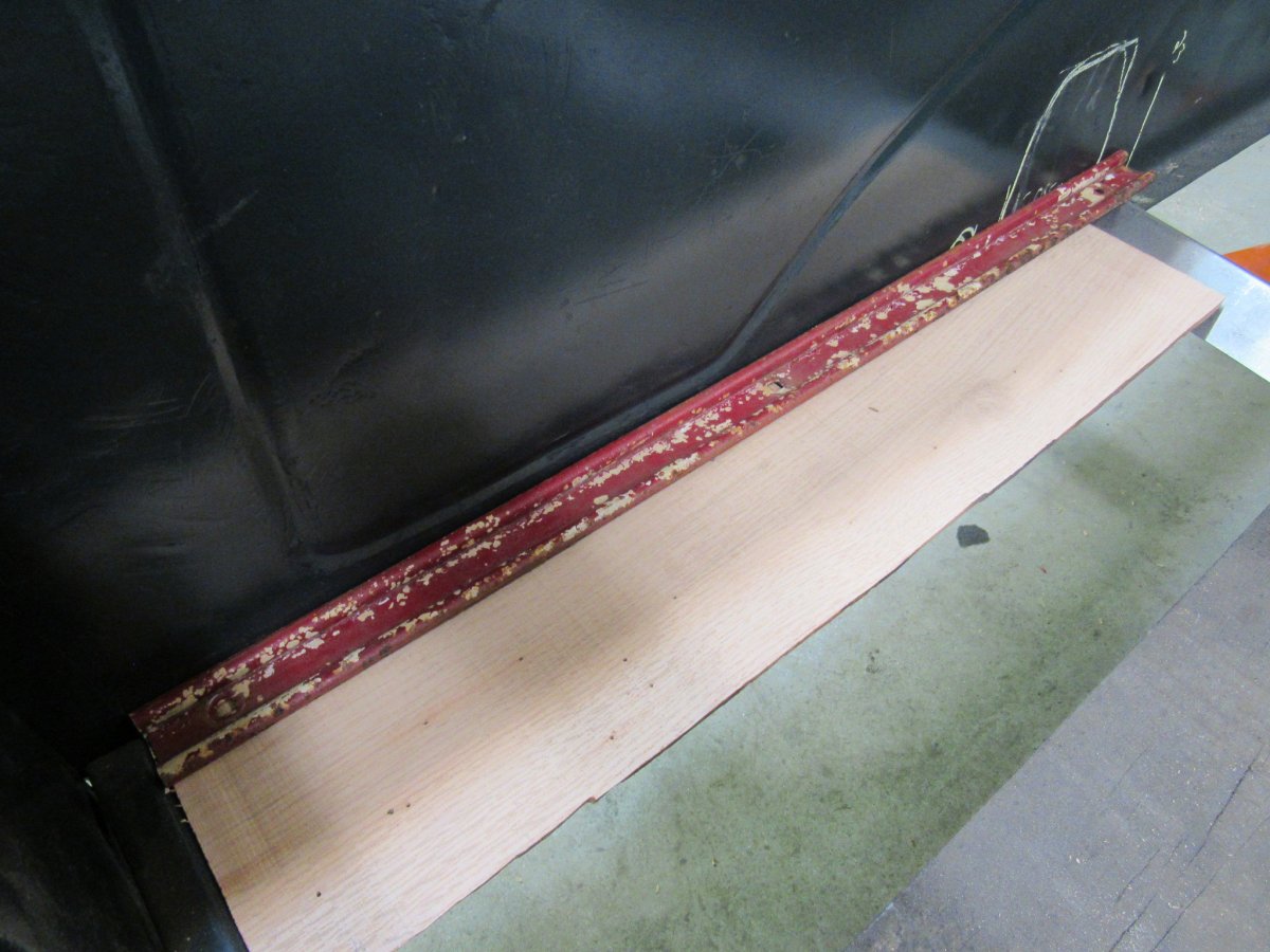

    I think this will finish the sides off well and allow the wood to move. IMG_1692.JPG

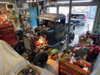

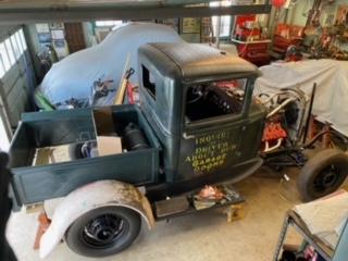

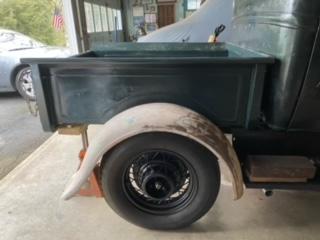

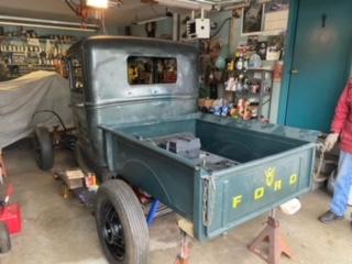

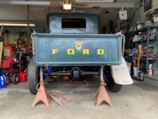

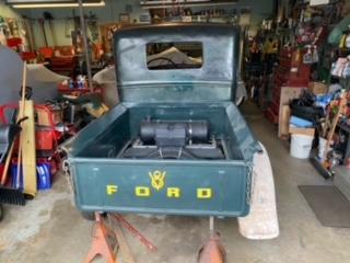

    brought the bed over to Charlie's to test fit it and get the measurements we need for the crossmember. and mounting braces. thumbnail-5.jpeg thumbnail-6.jpeg thumbnail-7.jpeg thumbnail-11.jpeg thumbnail-10.jpeg

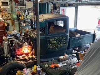

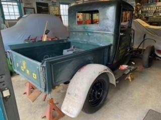

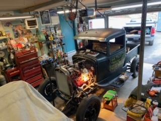

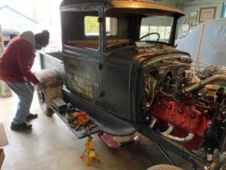

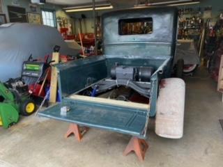

    note Charlie's "new " wheels and tires.
    battery went dead in camera so sorry for ****ty phone pics

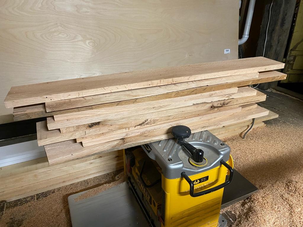

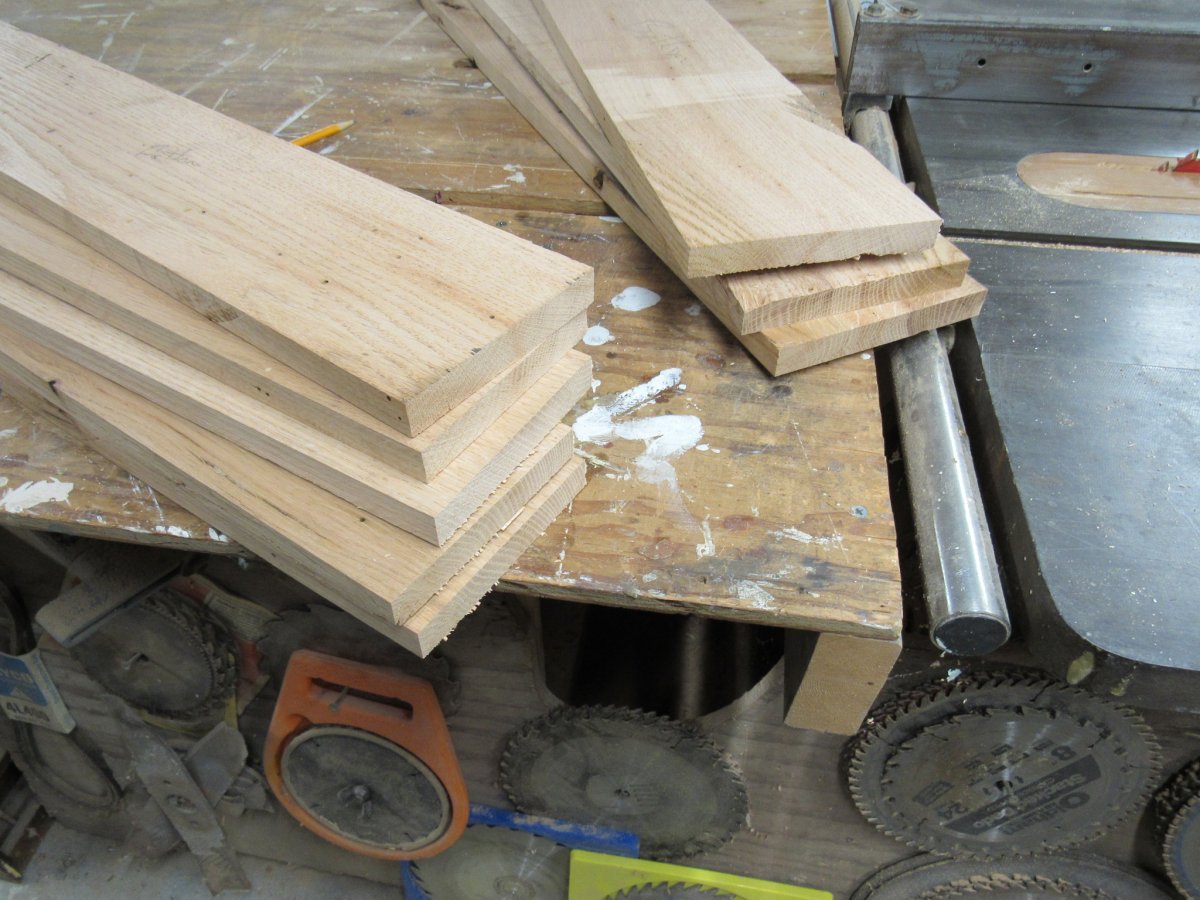

    Just ran some oak boards through the planer so Ted can build the floor of the pickup bed.

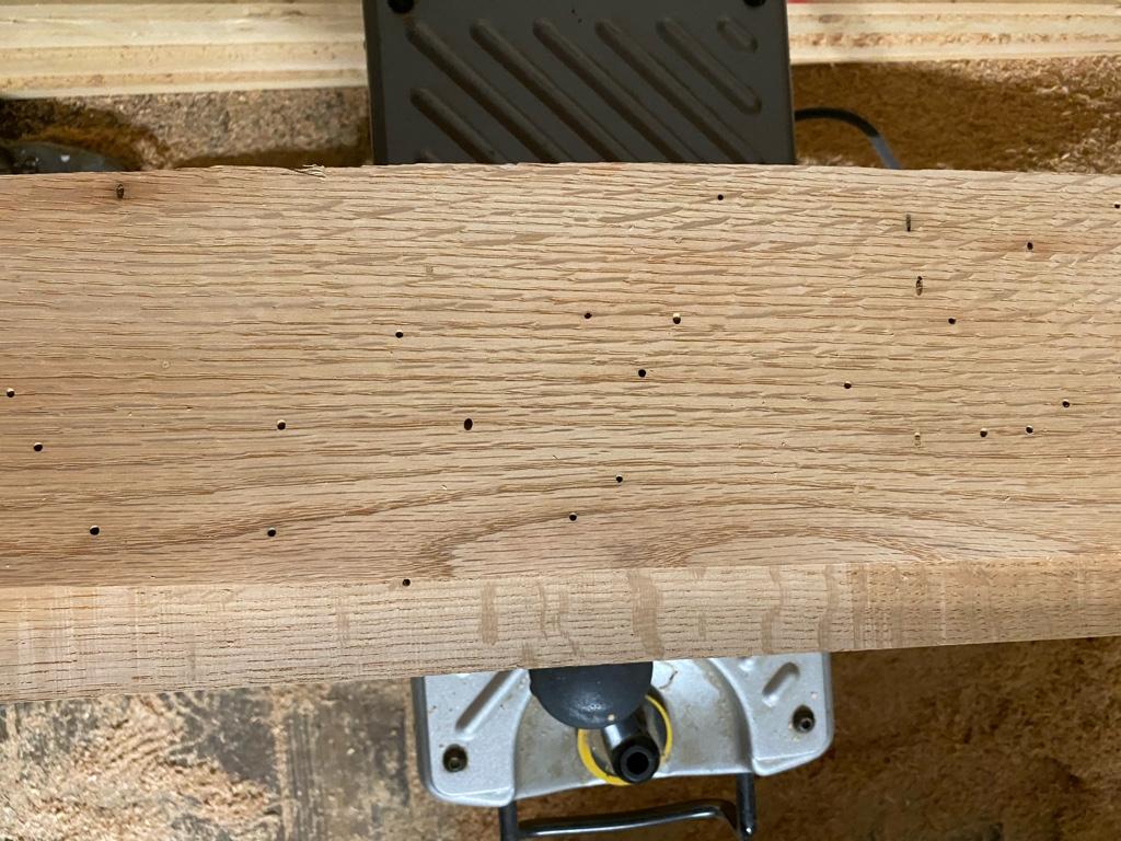

  8. Stogy
    Joined: Feb 10, 2007
    Posts: 27,523
    Stogy
    Mmmm...Bias Plys...;)
  9. Stogy
    Posts: 27,523
    Stogy
    Breathing Holes...them ****ers gotta duck when the blades are coming at them eh! 6 legged Drill bits​

    Never ran a plainer, how many p***es did it take to get them to finish thickness? Bob
  17. FolksWaggin
    Joined: Oct 15, 2010
    Posts: 45
    FolksWaggin
    These boards were all pretty close in thickness to each other, and the saw marks weren’t very deep, so I think it took me about 6 p***es total—a few p***es on each side. You can take more material off on the first p*** or two, and then you have to turn the dial down to only take about 1/32 or 1/64 of an inch on the final p***es on each side to get a smoother finish.

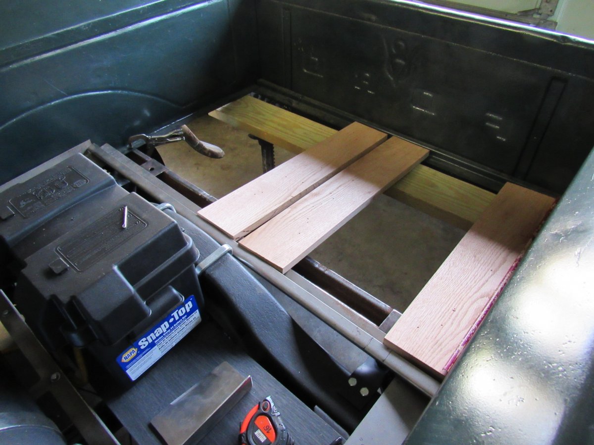

    I have the wood laid out, I have a couple extras in case I make a mistake. IMG_1724.JPG IMG_1725.JPG

    Will the boards be free floating or will you add biscuits'? I've got a DeWalt cutter if you need one. Bob
    TFoch and loudbang like this.
  22. tb33anda3rd
    Joined: Oct 8, 2010
    Posts: 17,595
    tb33anda3rd
    the boards will be clamped down with bed strips. I will cut a bevel down each side of the boards .

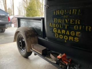

  23. tb33anda3rd
    Joined: Oct 8, 2010
    Posts: 17,595
    tb33anda3rd
    went to the slacker's to fit the pieces I made. he has decided to not raise the bed an inch so I had to change my design. I will need to make the side pieces longer and run the brace behind the shocks instead of above. IMG_1726.JPG IMG_1727.JPG

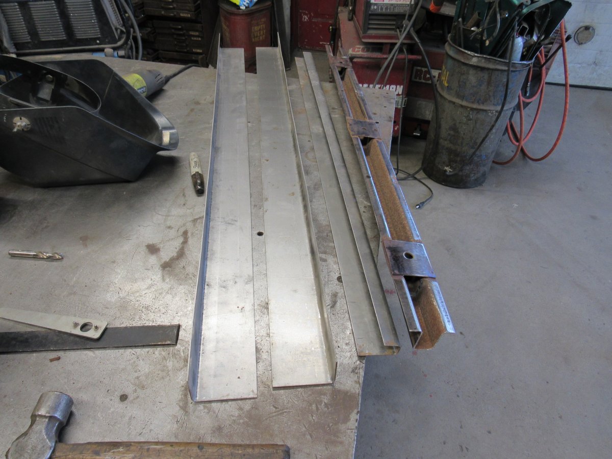

    I went back to my shop and bent up some longer side angle and welded the notches I put in the cross brace back in IMG_1736.JPG

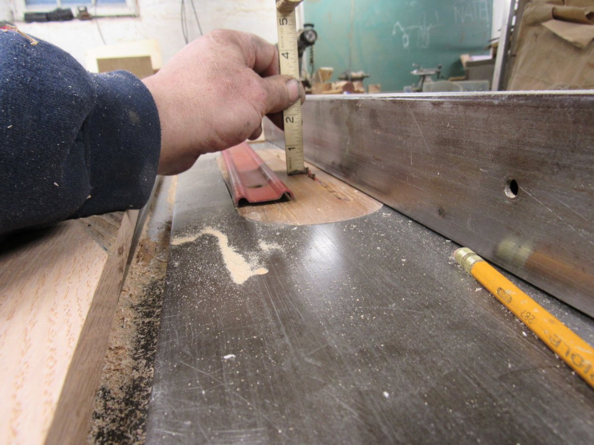

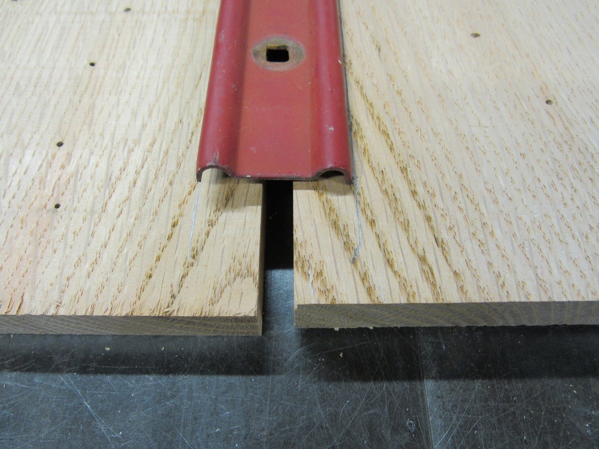

    I then marked for the rabbets that will run down each side of the boards. there will also be a 1/4" space between the boards to allow the carriage bolts to p*** between them. I then set the fence to 5/8" and lowered the blade to a 1/4" and made the face cut on the boards. IMG_1739.JPG

    what about similar grooves on the underside to try and prevent cupping at least 3!.
    Stogy, tb33anda3rd and loudbang like this.
  30. tb33anda3rd
    Joined: Oct 8, 2010
    Posts: 17,595
    tb33anda3rd
    I know they use grooves on the underside of flooring but I have never seen it on truck bed wood. maybe because the bed wood is exposed to the air on both sides and flooring gets trapped against another surface with only one side exposed? interesting thought and I could just run a few with my router and a beading bit.
