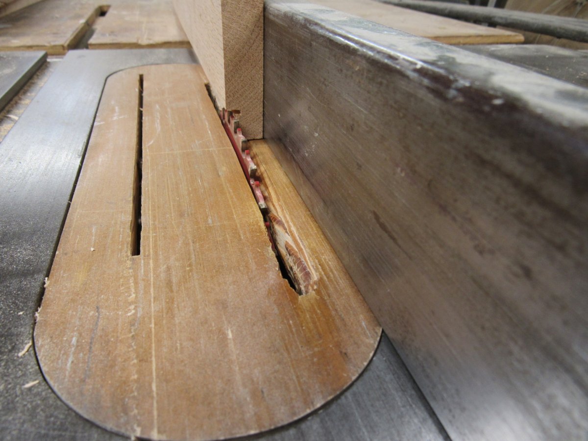

    I did finish cutting the rabbets along the wood. I did it by setting the fence, raising the blade and turning the wood on it's side. IMG_1742.JPG IMG_1744.JPG

    you could run the grooves on the table saw.my take on the grooves is they relieve internal tension in the wood allowing it to stay straight instead of cupping.and also to aid glueing timber to the floors in houses.if you varnish the topside of the boards varnish the underside and the edges esp the ends i had 3 grooves ran in my bedwood but some still warped planning on another 2 grooves when i get the time.

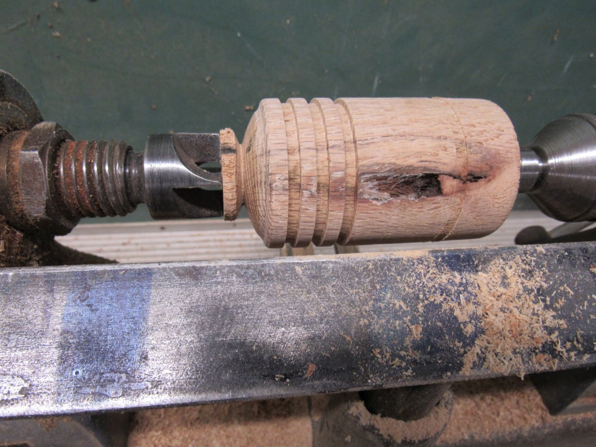

    rainy Sunday morning so I decided to make Charlie a new shift knob.
    I cut a chunk of the tree to length then trimmed the corners off . then I started cutting away wood. IMG_1776.JPG

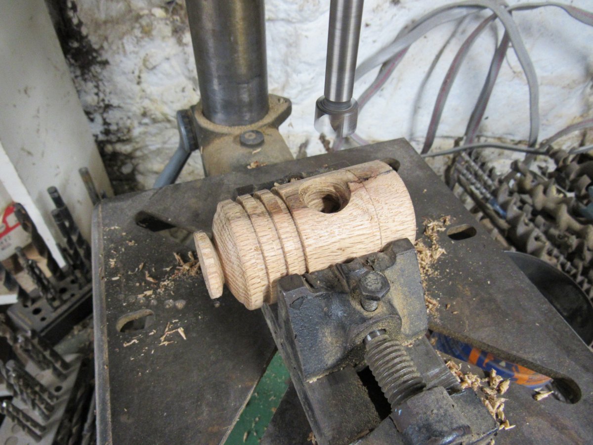

    once I had the general shape I took it off the lathe and clamped it into the vise for the drill press. 7/8 hole. an 1/8"deep then a 5/8 hole 1/4" deep. IMG_1779.JPG

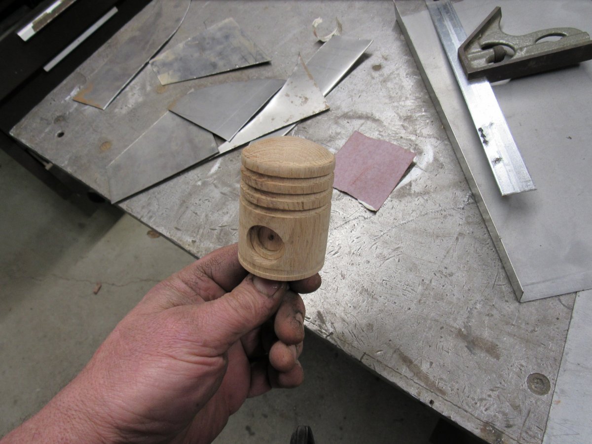

    then I put it back on the lathe and finished shaping the "domed flat head piston" IMG_1781.JPG

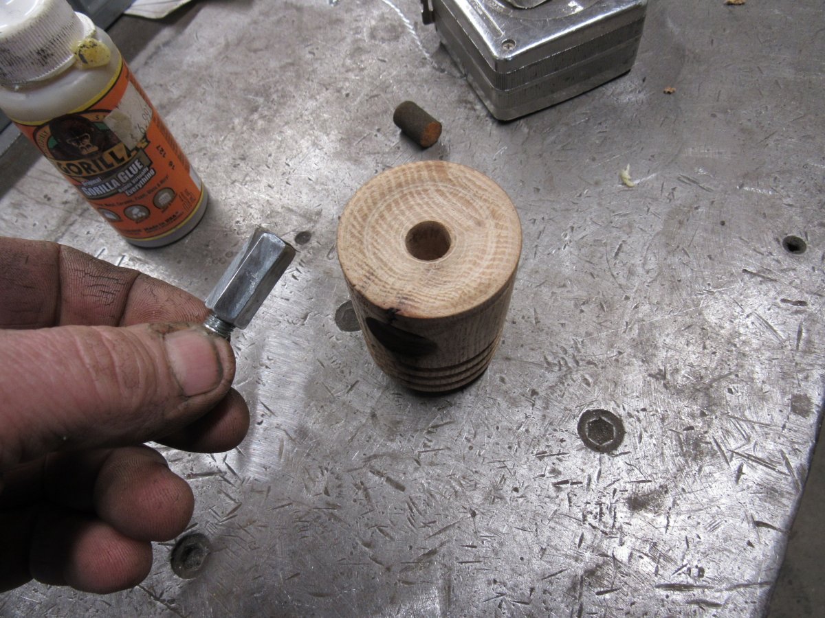

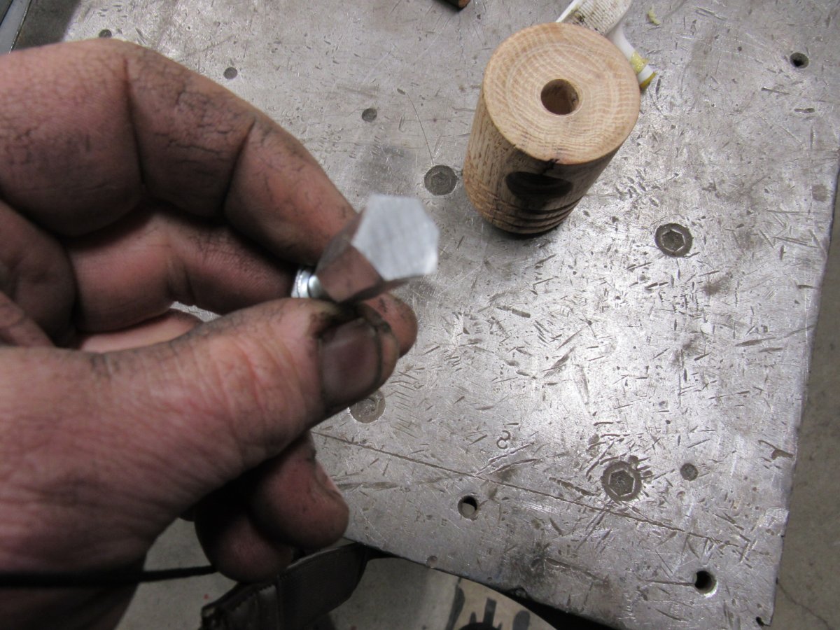

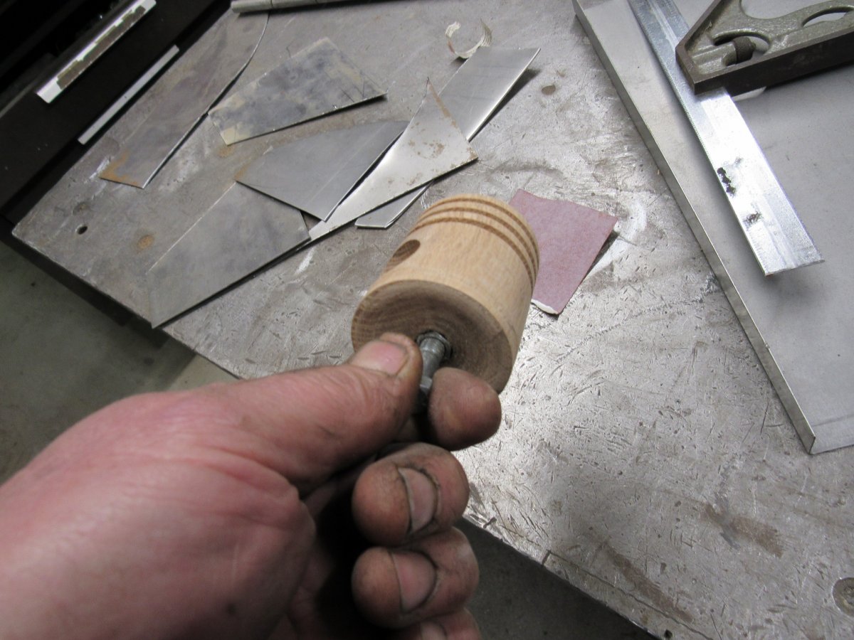

    I drilled a hole in the underside and glued a long 5/16" nut in the hole. I put a piece of tape over the inside of the nut to keep any glue from getting on the threads. when the glue dries I will give it to the slacker to varnish. IMG_1783.JPG

  13. The37Kid
    Joined: Apr 30, 2004
    Posts: 32,920
    The37Kid
    Nice, Just before Easter. :rolleyes:
    TFoch, loudbang, nunattax and 4 others like this.
  14. ct1932ford
    Joined: Dec 3, 2010
    Posts: 13,501
    ct1932ford
    Aren’t you supposed to painting my stuff? [emoji79]. Nice shift knob.[emoji41]
  15. tb33anda3rd
    Joined: Oct 8, 2010
    Posts: 17,595
    tb33anda3rd
    I forgot to put the heat back up in the barn, it was colder in the barn than out side:confused:
    TFoch, loudbang and Stogy like this.
  16. Stogy
    Joined: Feb 10, 2007
    Posts: 27,523
    Stogy
    What a Lucky Slacker...:D
    Fantastic job on everything including the Always Shifty Woody WoodPiston...:)
  17. Runnin shine
    Joined: Apr 12, 2013
    Posts: 3,385
    Runnin shine
    Is that a “3/8 inch” overbore? As in 0.365” or 2 3/8 x 2 3/4? Oh wait maybe it went with a “Merc” hickory 3” crank. You could chuck that up in a wood lathe right quick and stroke it to 3.125 and if your not afraid of a hot Flatty with a burning hardwood smell. Ooh, Canadian rock maple sleeves and exhaust valves you could go all the way to 3.250! Someone says nice aftermarket heads and intake whats the special casting material? Oh it’s a rare burl-wood.
    chryslerfan55, Stogy and tb33anda3rd like this.
  18. safetythird
    Joined: Feb 26, 2014
    Posts: 295
    safetythird
    Pretty sure he should be painting my stuff.
    Love the shift knob-I think I'll follow suit with a chunk of wood from the tree that fell on my Falcon.
  19. TFoch
    Joined: Mar 31, 2010
    Posts: 2,418
    TFoch
    Wow Ted multi-talented! Shift knob looks great!
    loudbang, tb33anda3rd and Stogy like this.

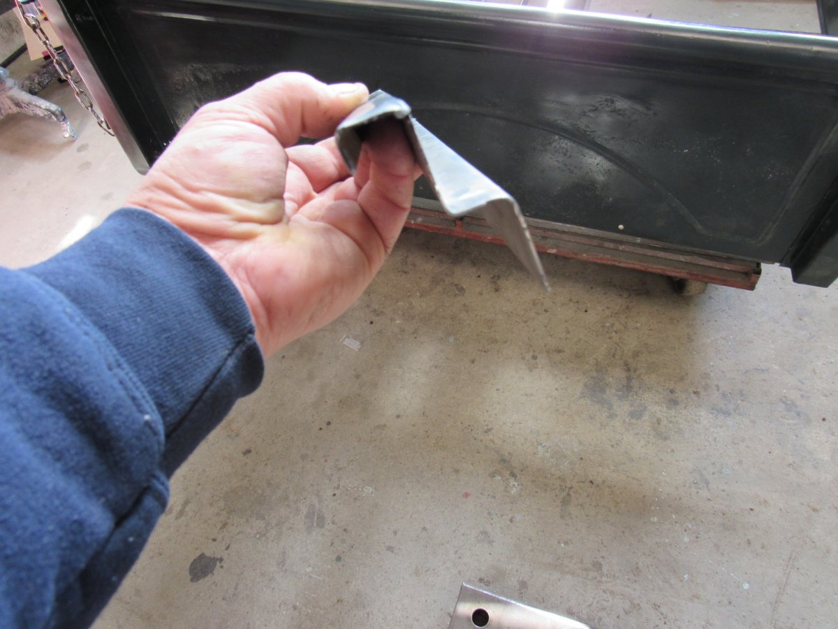

    I also bent up the part of the box that closes off the back. to allow the lid to seal over the sides, and give the appearance it is a box sitting in the bed and not just part of the bed, I put a stepped flange on each side. IMG_1813.JPG
