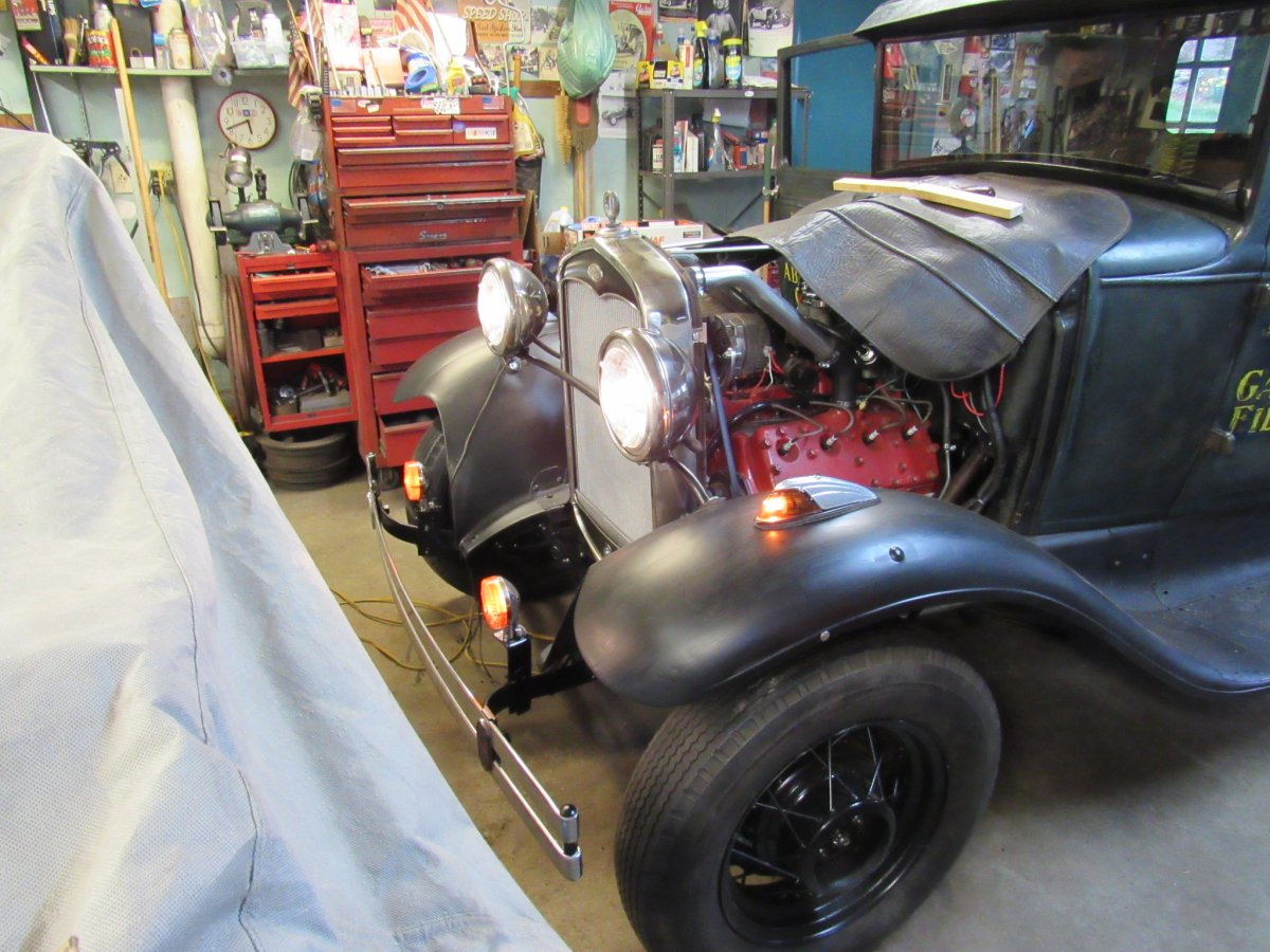

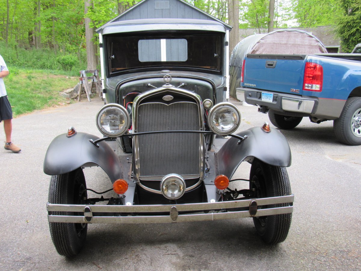

    IMG_1973.JPG IMG_1972.JPG he also got all the front lights working including the turn signals.
    nunattax, dwollam, TFoch and 9 others like this.

    the lights on the fenders are just running lights. the turns on the frame are vintage Harley.

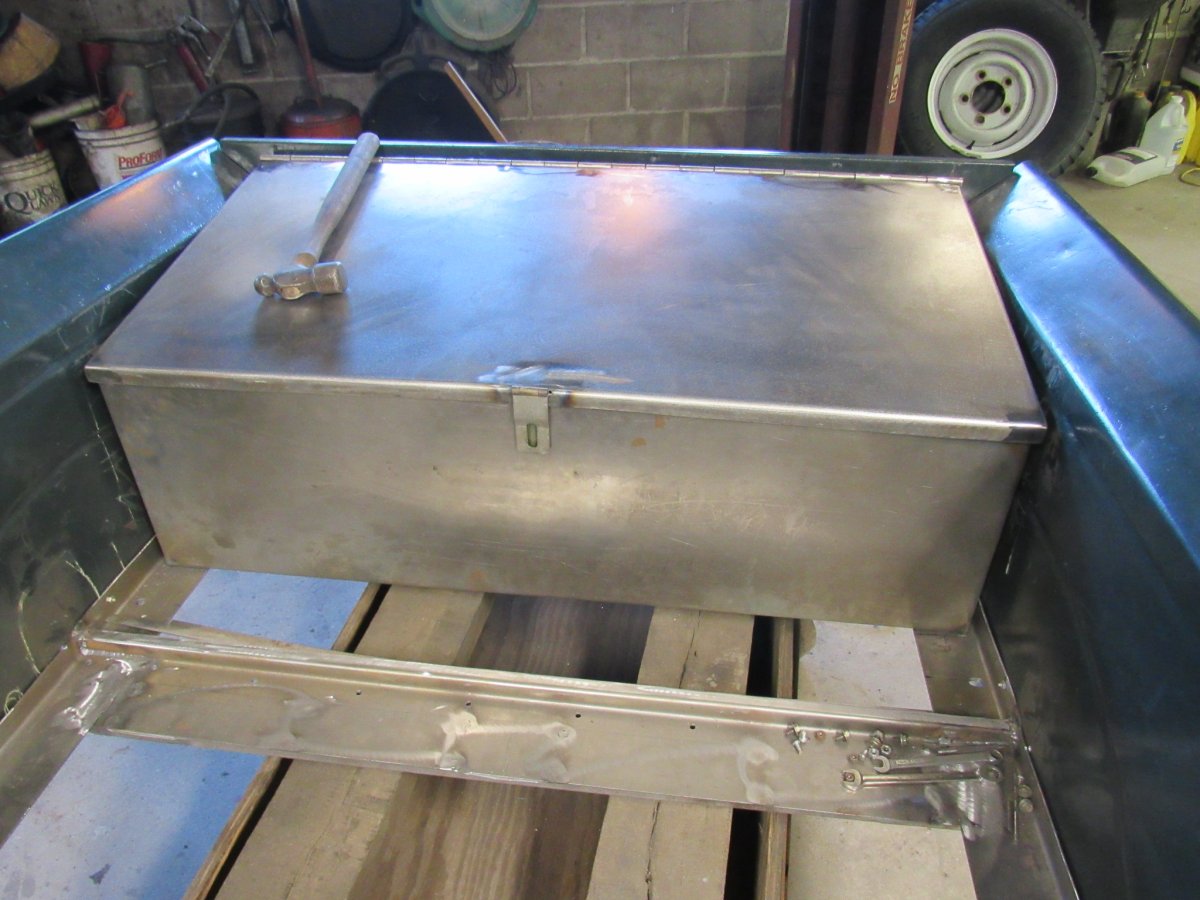

  15. tb33anda3rd
    Joined: Oct 8, 2010
    Posts: 17,595
    tb33anda3rd

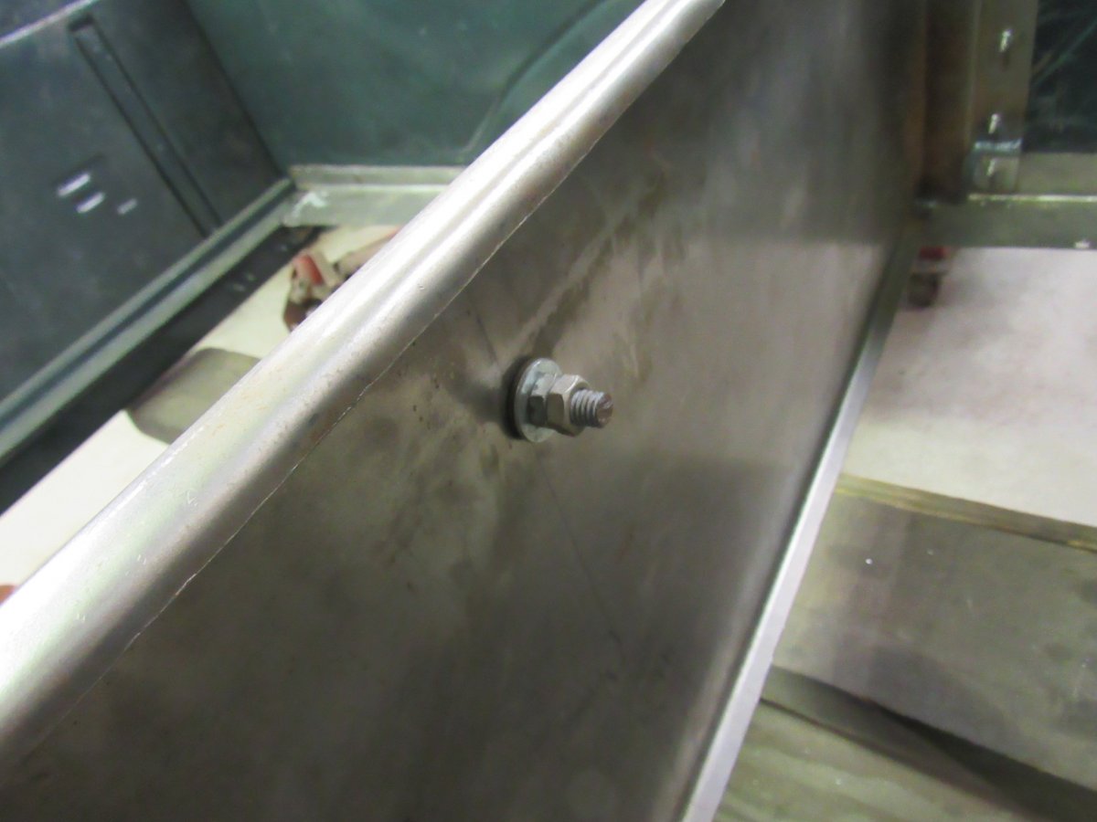

    made a little latch for the hasp. simple eye bolt, bent off set, double nutted with nylon washers against the box. IMG_2008.JPG IMG_2009.JPG IMG_2010.JPG IMG_2012.JPG
    dwollam, TFoch, Stogy and 10 others like this.
  16. tb33anda3rd
    Joined: Oct 8, 2010
    Posts: 17,595
    tb33anda3rd
    rotate the eyelet up and the hasp will slide over it. rotate it down to hold it in and/or put a pad lock on for security.
    TFoch, Stogy, OFT and 5 others like this.

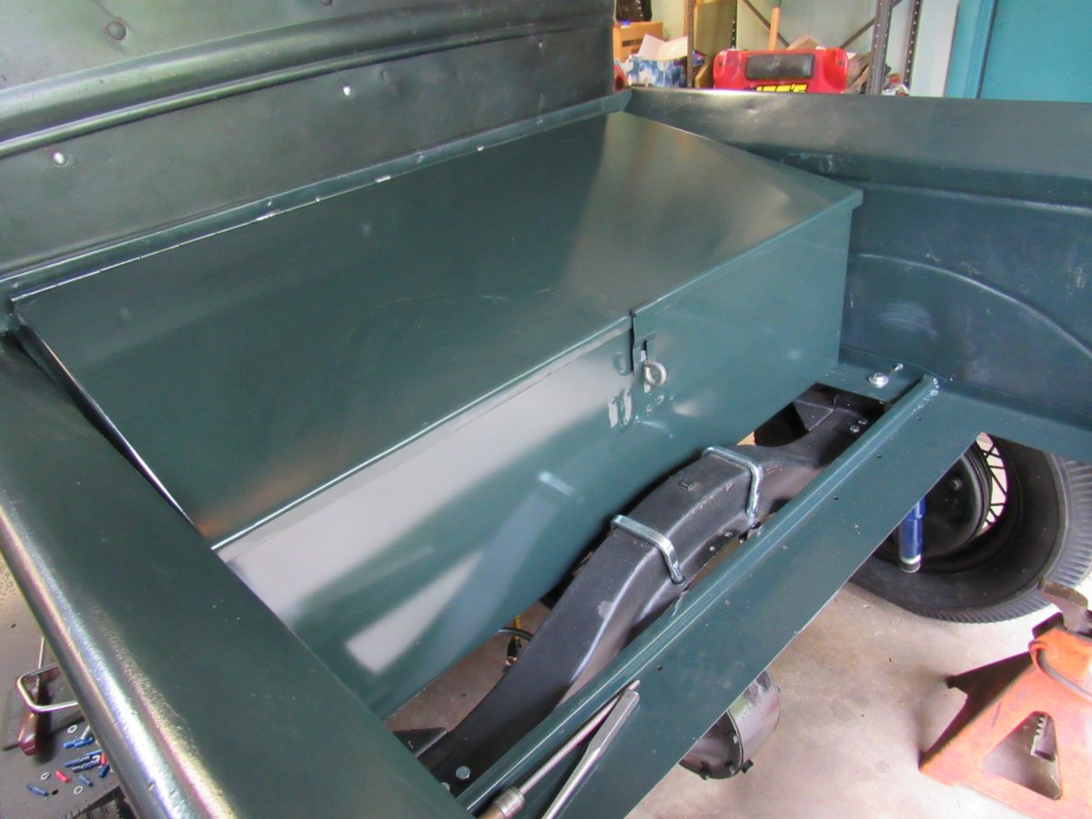

    I took the new "box " and sub frame out and welded up the flange I had made for it to finish and strengthen the back edge of the middle crossmember. IMG_2023.JPG IMG_2024.JPG IMG_2025.JPG

    the other night I painted the pieces and then ***embled it last night. IMG_2027.JPG IMG_2030.JPG

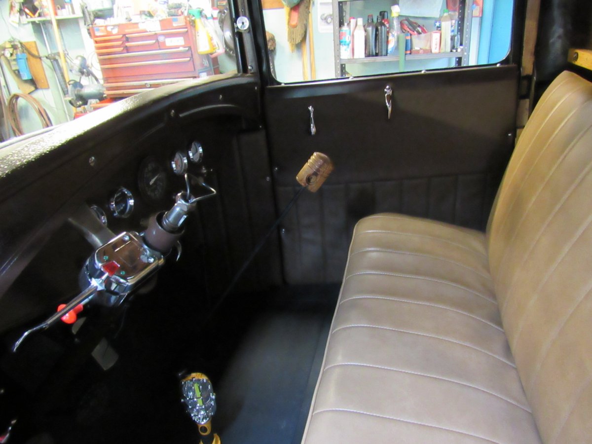

  25. tb33anda3rd
    Joined: Oct 8, 2010
    Posts: 17,595
    tb33anda3rd

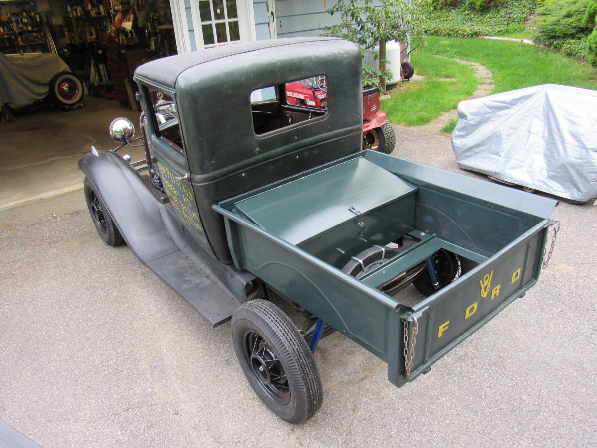

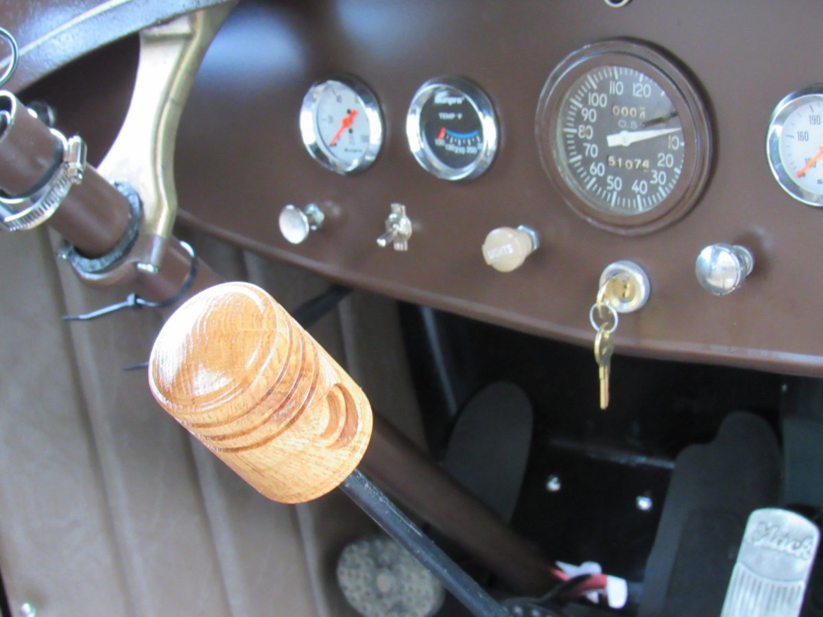

    since we had some muscle around we pushed it out of the garage to check the proportions. IMG_2039.JPG

  27. tb33anda3rd
    Joined: Oct 8, 2010
    Posts: 17,595
    tb33anda3rd
