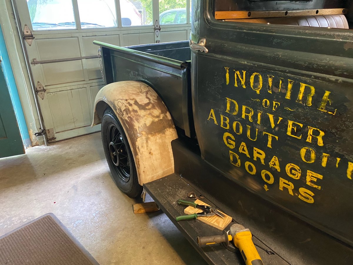

    stopped at Charlie's to hold the fenders in position, to drill for the mounting bolts. despite these really ****py fenders it is really starting to look like a truck.:) image0.jpeg image1.jpeg image2.jpeg image3.jpeg image4.jpeg

    fenders have character,will look great in paint

    when i bolted on my fenders with help we used double sided tape to hold the fender welt in place,notching the welt as needed to bend it and t******* out for the mounting holes with a scalpel.worked out very well.c

    the slacker primed and painted both fenders and got one on today. he filed square holes in the bed so that he could use carriage bolts.
    he skipped using any welting, he thought it wasn't necessary

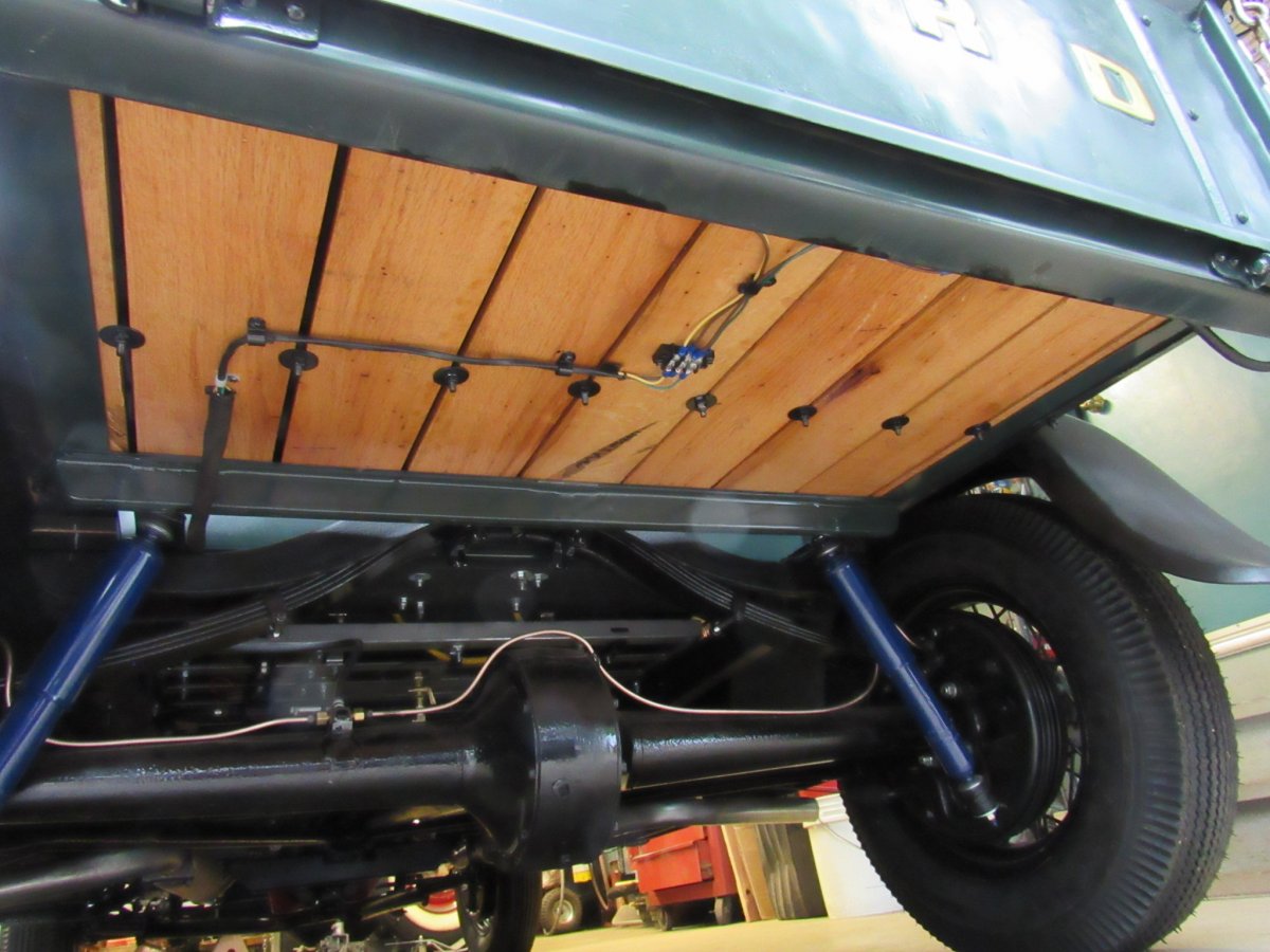

    the slacker is moving faster than I can keep up.fenders both painted and bolted on. IMG_2052.JPG IMG_2054.JPG IMG_2055.JPG

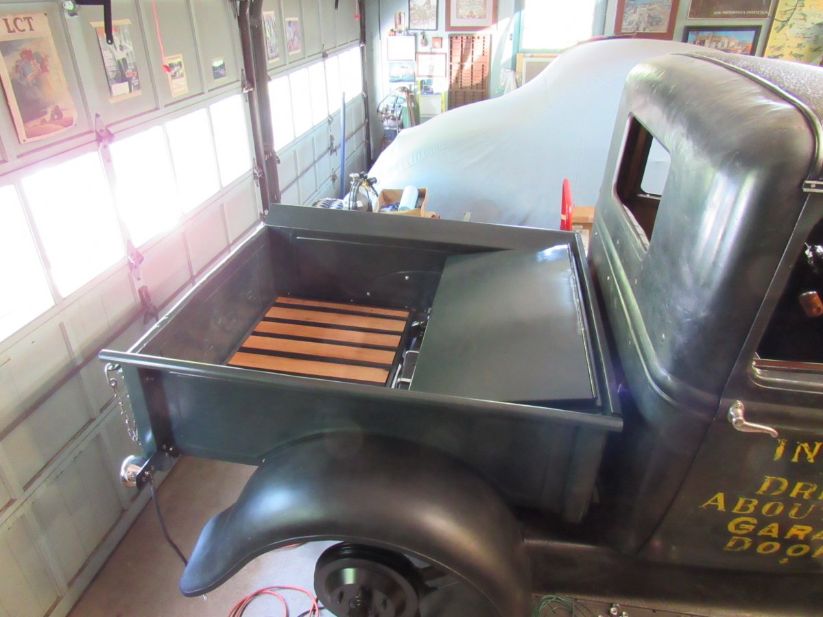

    he also got the wood and bed strips in place and bolted the tail lights on.he has the hardware for the bed strips all painted. IMG_2056.JPG

    turned out great!,you would never know it had been sqwished

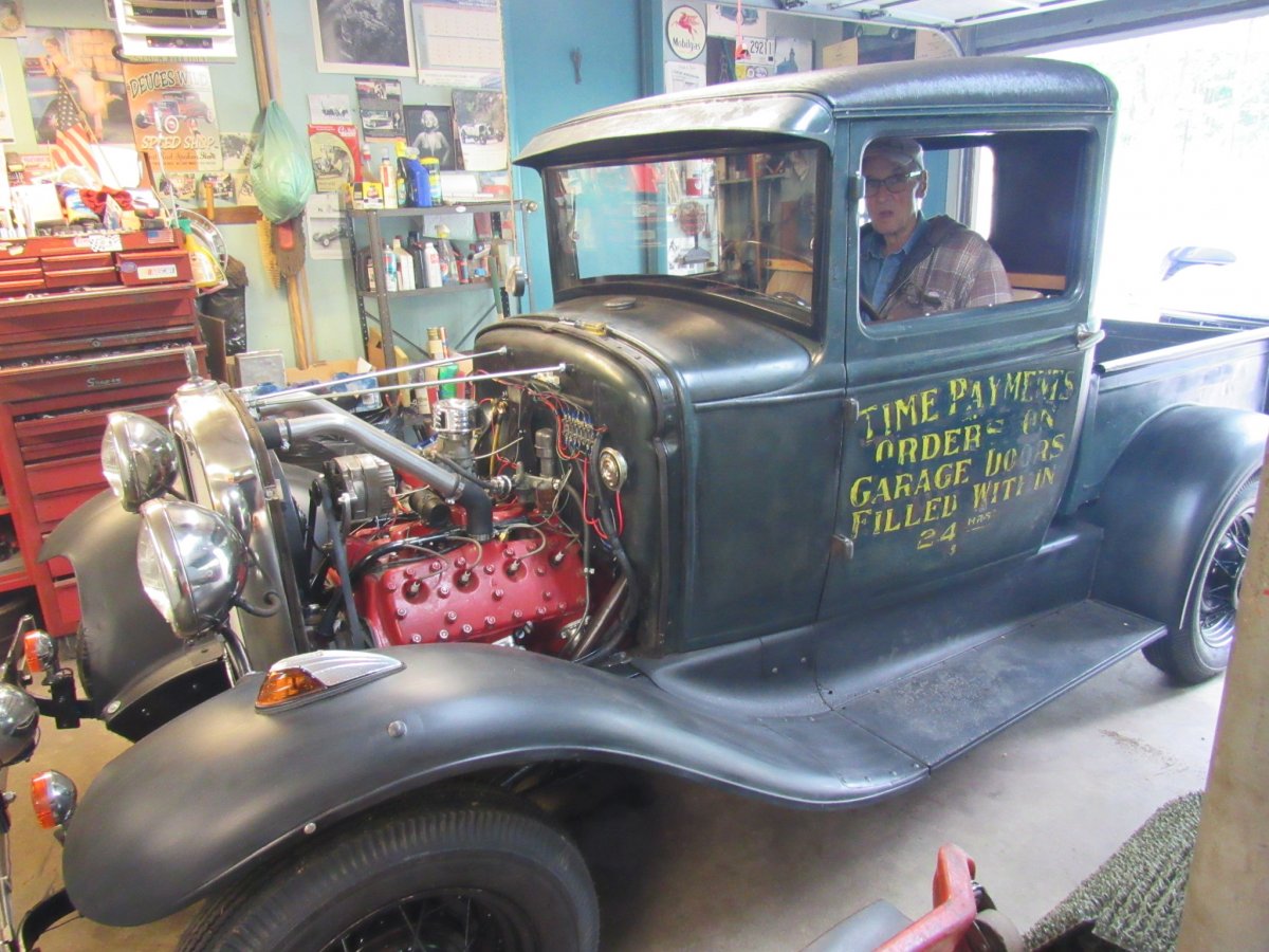

    truck starts and runs! we had a small fuel leak, but were able to get that fixed easily. motor sounds great. the slacker got all the bed hardware in, wired the tail lights, put the steering wheel back on and finished up wiring the dome light and front driving light. IMG_2070.JPG IMG_2071.JPG IMG_2072.JPG
