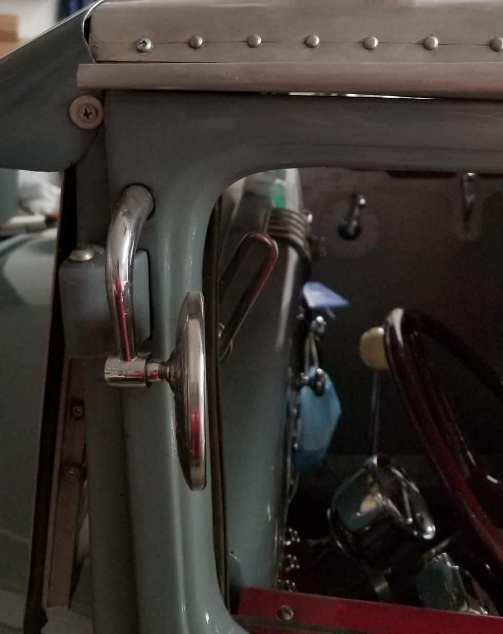

  26. nunattax
    Joined: Jan 10, 2011
    Posts: 3,394
    nunattax
    I took the clamp part off the hinges for my car. I drilled the holes carefully and haven't looked back.
    any picture of the finished job ?
    TFoch and tb33anda3rd like this.
  27. nunattax
    Posts: 3,394
    nunattax
    theres a 2" extension available comes with a longer countersunk bolt
    TFoch likes this.

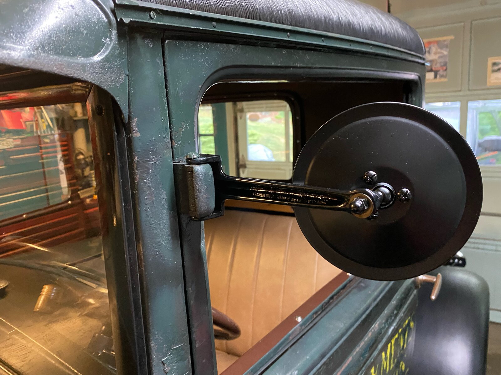

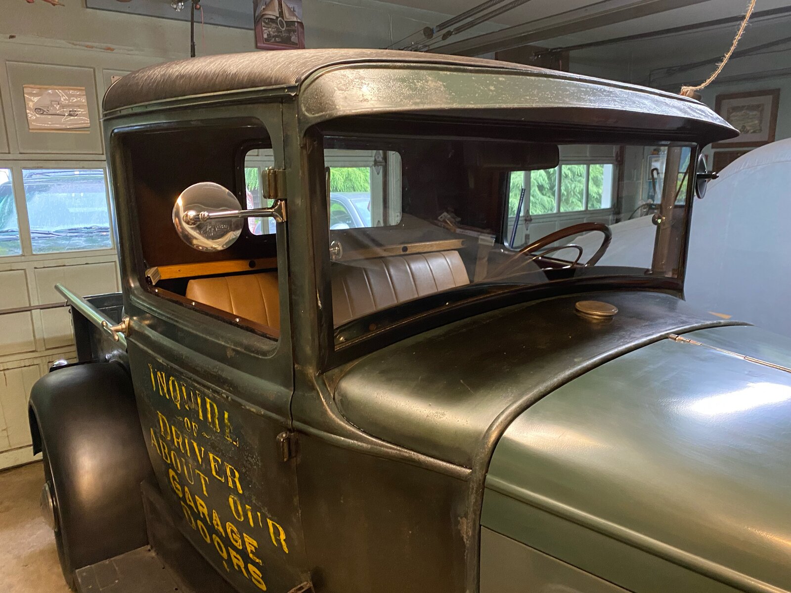

  28. tb33anda3rd
    Joined: Oct 8, 2010
    Posts: 17,595
    tb33anda3rd
    TFoch, BradinNC, ct1932ford and 2 others like this.
  29. tb33anda3rd
    Joined: Oct 8, 2010
    Posts: 17,595
    tb33anda3rd
    I left the one edge proud so it would sit against the front edge of the door to keep it from turning, drilled a hole and countersunk it for a machine screw.
