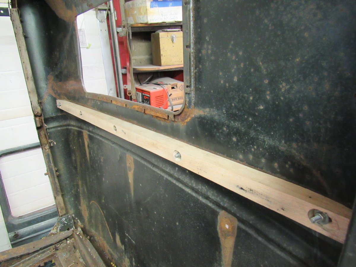

    this afternoon Charlie traced out the old cab support on the "tree". I cut it out on the bandsaw and finished it with the belt sander. Charlie drilled the holes and morticed for the nuts and washers. we bolted it to the cab to check the fit. IMG_4767.JPG

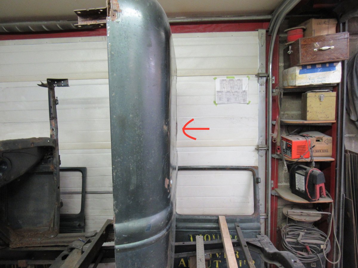

    this shot is looking across the back of the cab with the window reveals lined up. the arrow points to the stretched area I need to shrink more. IMG_4768.JPG

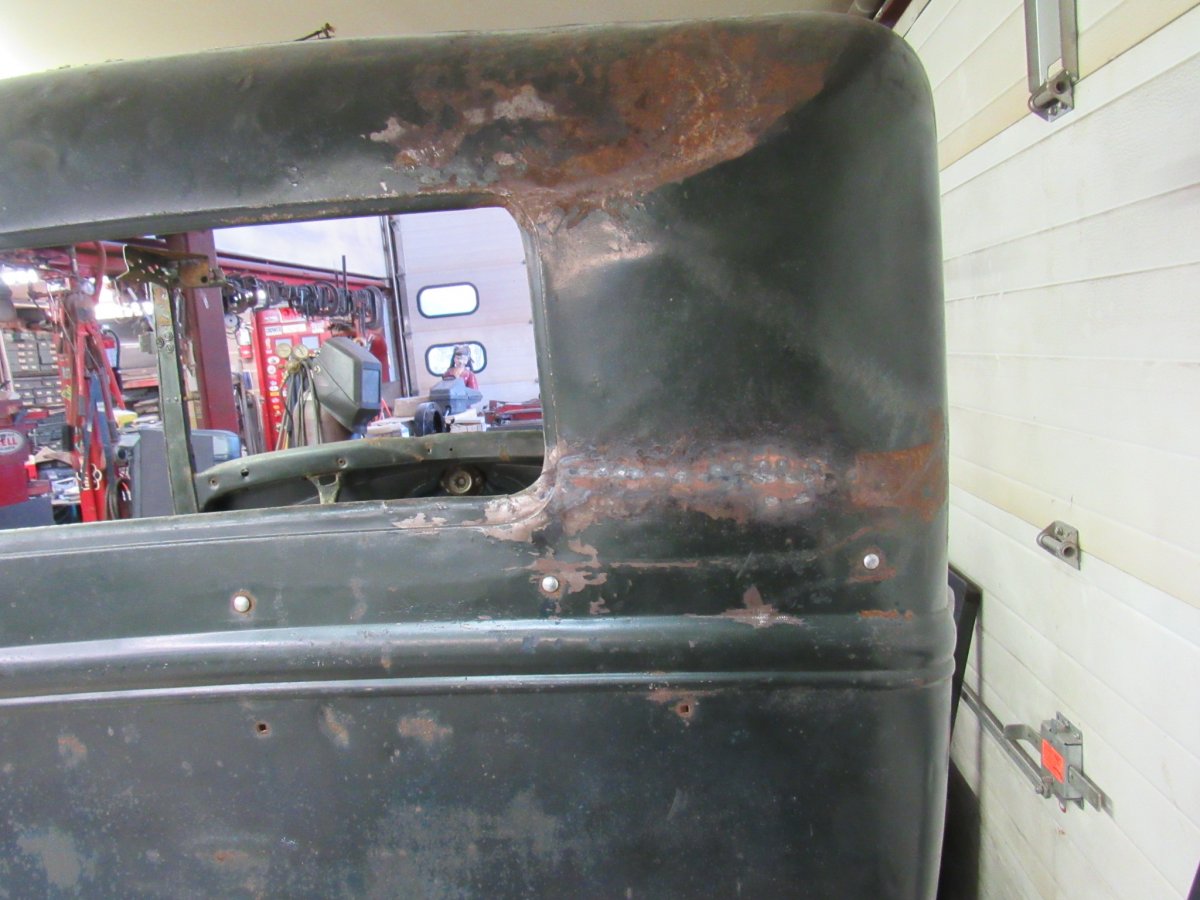

    this photo shows the series of dime size spots I heated red hot and then let cool. I was able to reduce it down to what is shown in the previous post.

    is this a job for a shrinking disc??

  9. Dick Stevens
    Joined: Aug 7, 2012
    Posts: 4,248
    Dick Stevens
    I think it is!

    My little bro is good with a shrinking disc, but I couldn't get the hang of it. I'm a heat, tap, quench type of shrinker. I would keep on shrinking like you are instead of cutting and removing metal. Use a surgical method as a last effort.
  12. I like the shrink disc. At first I didn't think I knew how to use one either. Proved myself wrong. Much easier now that the Torch and quench system I was used to. The disc makes a little Hot spot just like the torch. Using air to kool is better than water. Less mess on the floor. I'm not going back.

    Just a thought on the wood, are you worried about the wood shrinking because it was not kiln dried. I had a friend build a table out of no dried wood, and it sounded like a gun going off when it finally pulled itself apart.

    That is what I was thinking! That wood will move if that was a live tree.

    I d be more concerned about the timber deciding it was going to be hockey stick shape as it dries.it will pull the metal with it.thats why you should season the timber before you use It even then it will change shape as you rip it .try to use a piece with straight grain

    that tree fell on the truck over 10 years ago [I have been told] they cut it up not long after and stacked it. It is "seasoned" but not dried [different] because it was out in the weather. I have it cut and "stickered" . the piece we cut will shrink but it is not a trapped piece, it will not shrink in length just width. worse case we will have to tighten the bolts up. we will not get to the top wood till summer, we guess, and by then the rest will be dry/dryer.
    my plan was to get angles made to join the top/cowl, back together to get our dimensions. Charlie has to still build the ch***is, by the time the pre-build is done the wood will be stable.
