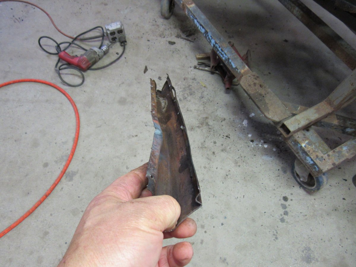

    Charlie and I spent 6hrs hitting things with hammers. we were able to get the dash rail support ironed out but no matter how much we tried to push the windshield posts apart, we could not get the p***enger side to "stay". so we decided to cut the outer sheet metal away from the post. IMG_4915.JPG IMG_4916.JPG

    once the spot welds were drilled out I used a hack saw to cut the piece off at the tear. the inner structure had apposing bends which were holding the post crooked. we now had it exposed so we could straighten it all out. IMG_4917.JPG IMG_4918.JPG

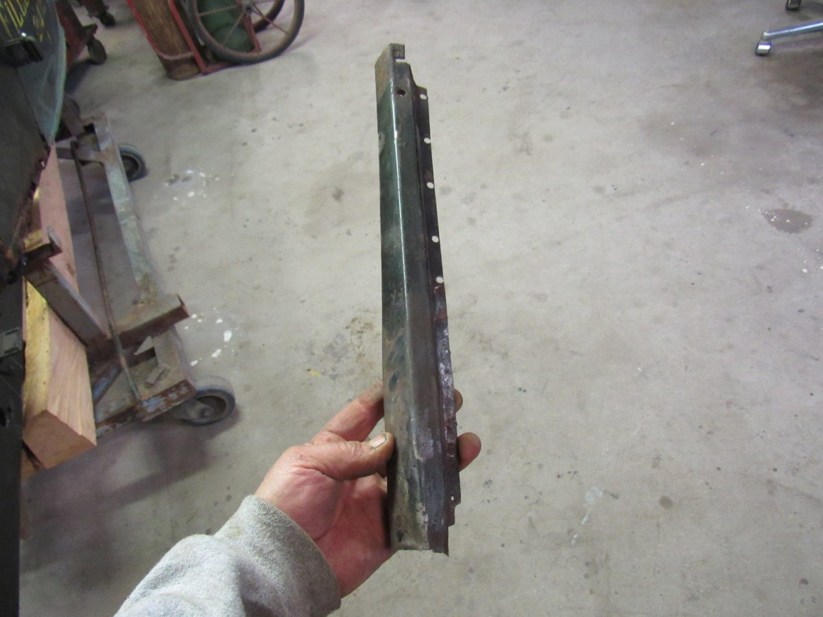

    we put the doors back on and used the jack to spread the posts into position. I drilled the spot welds out of the two horizontal supports on either post and also sandblasted and drilled the spot welds on the cross piece Charlie picked up. it had been cut in half so I used the measurements we took off the other truck to put it back together at the correct length. we then clamped and welded it to the truck. henry's spot welds were in the exact spots, it looked like I drilled straight through both pieces at the same time. IMG_4893.JPG IMG_4921.JPG

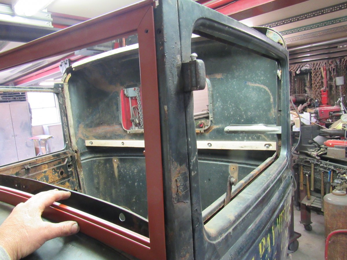

    we used the windshield frame to check for square and a straight edge to get the post straight. we are sure we have the cowl right were we we want it. IMG_4922.JPG IMG_4926.JPG IMG_4927.JPG

    we also spent some time getting the front door edge gaps good. driver side front is perfect and the back of the door follows the cab nicely. IMG_4924.JPG

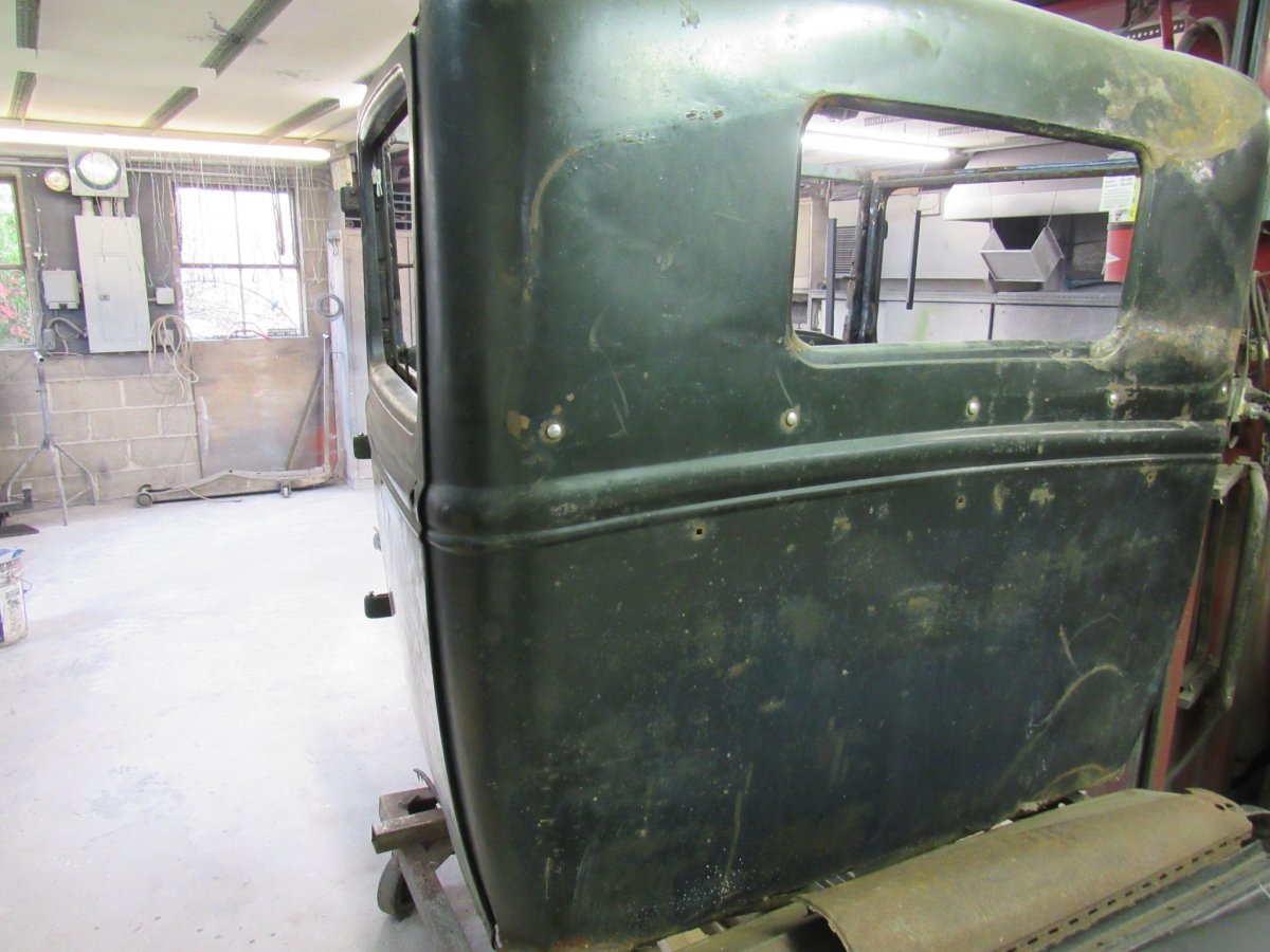

    p***enger side door gaps follow the cowl nicely but where it meets the back of the cab is another story. the cab is still bent and the window frame is a little bent. IMG_4925.JPG

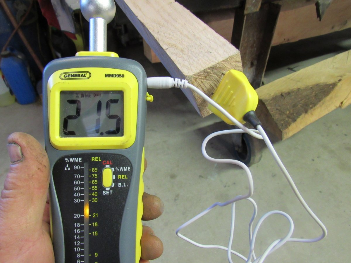

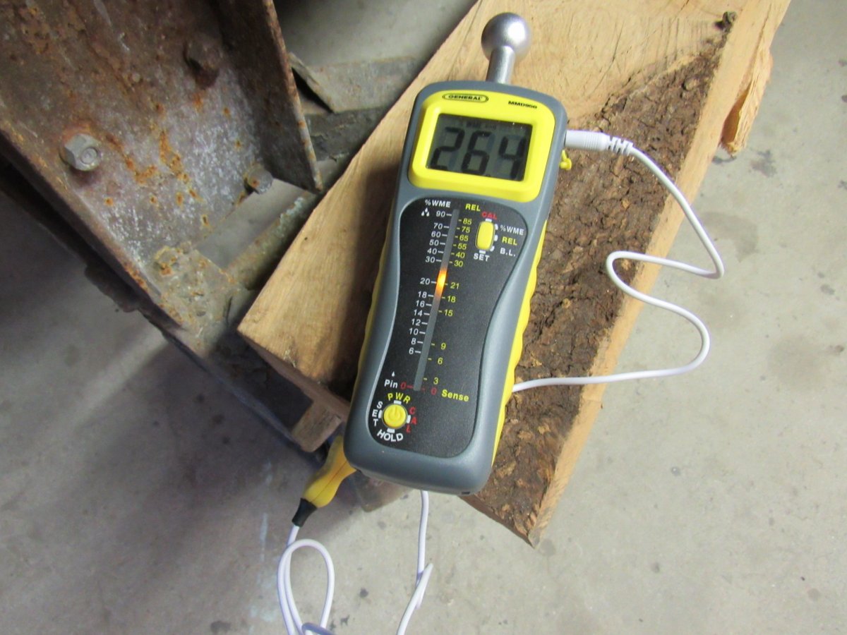

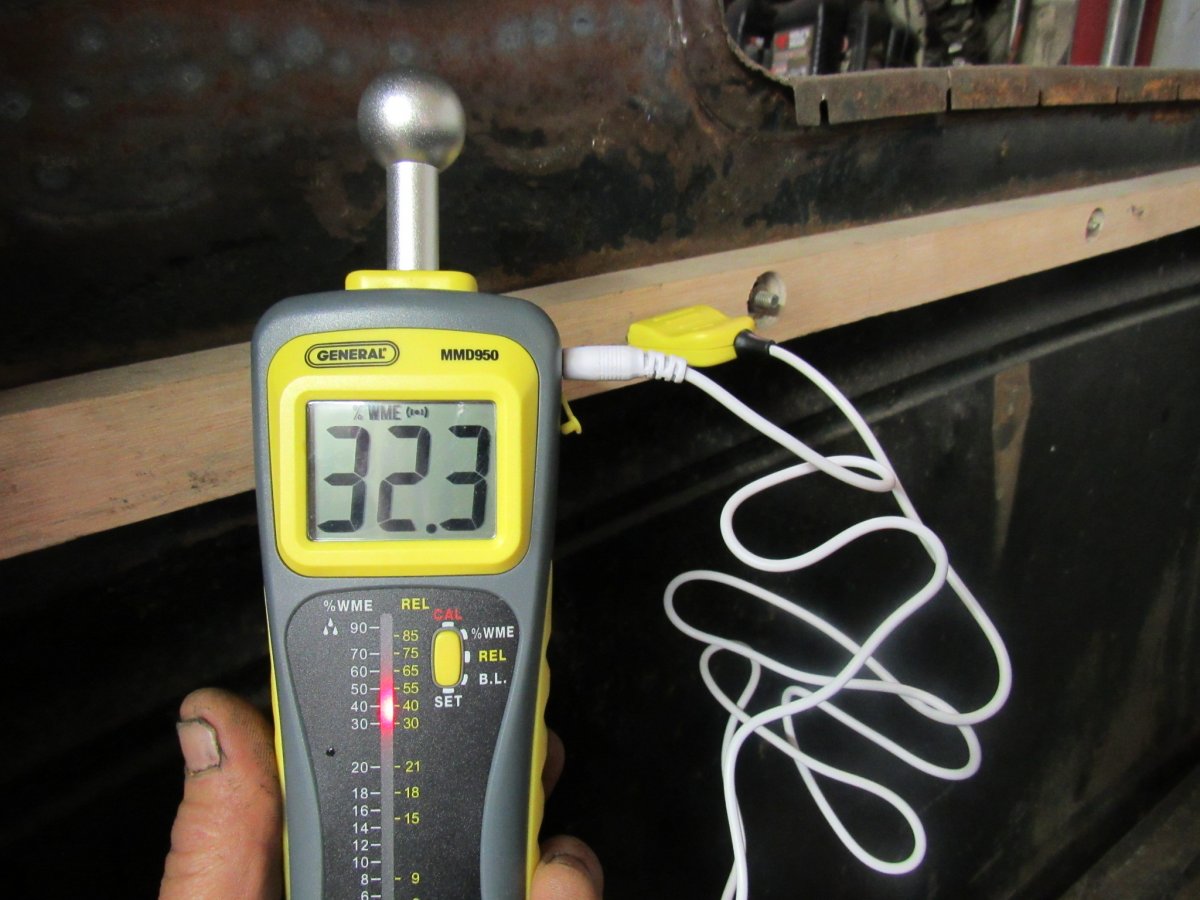

  29. tb33anda3rd
    Joined: Oct 8, 2010
    Posts: 17,595
    tb33anda3rd

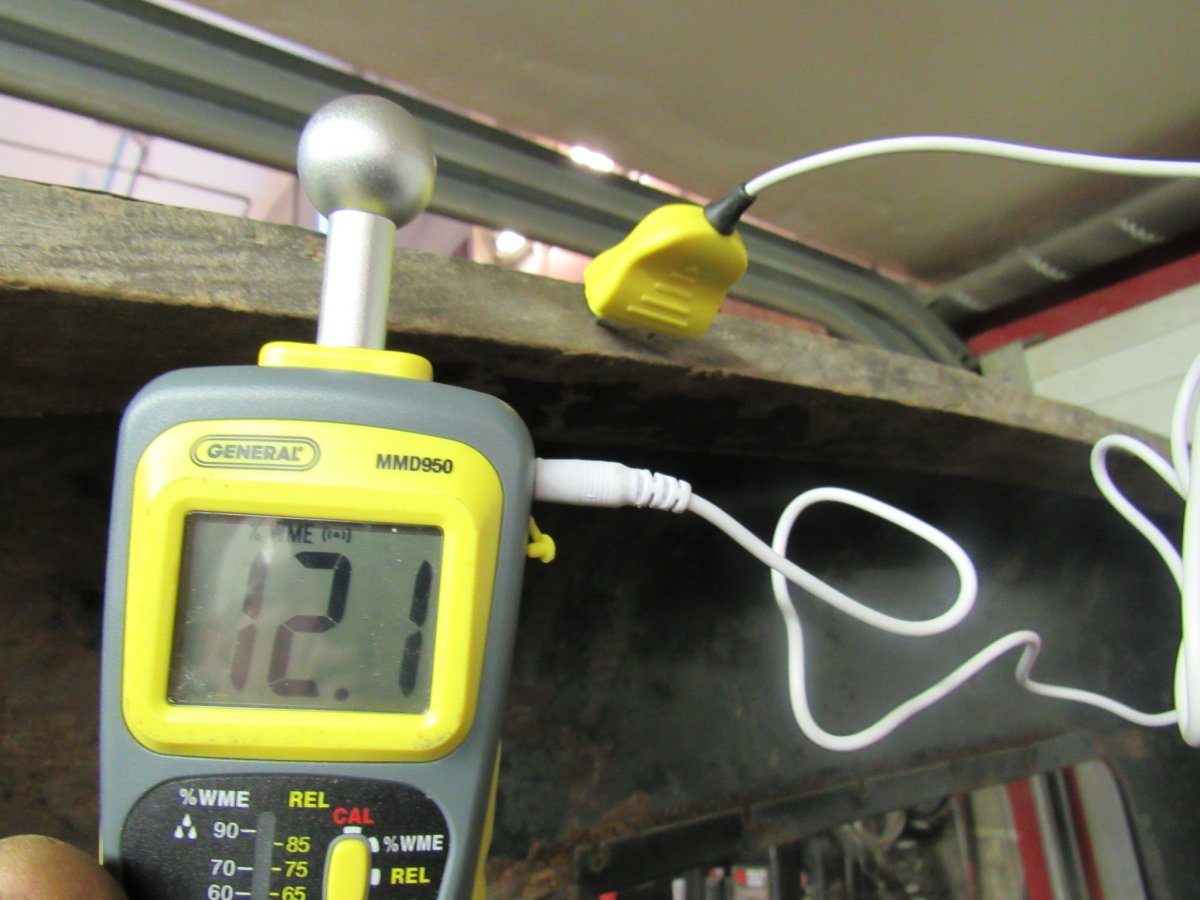

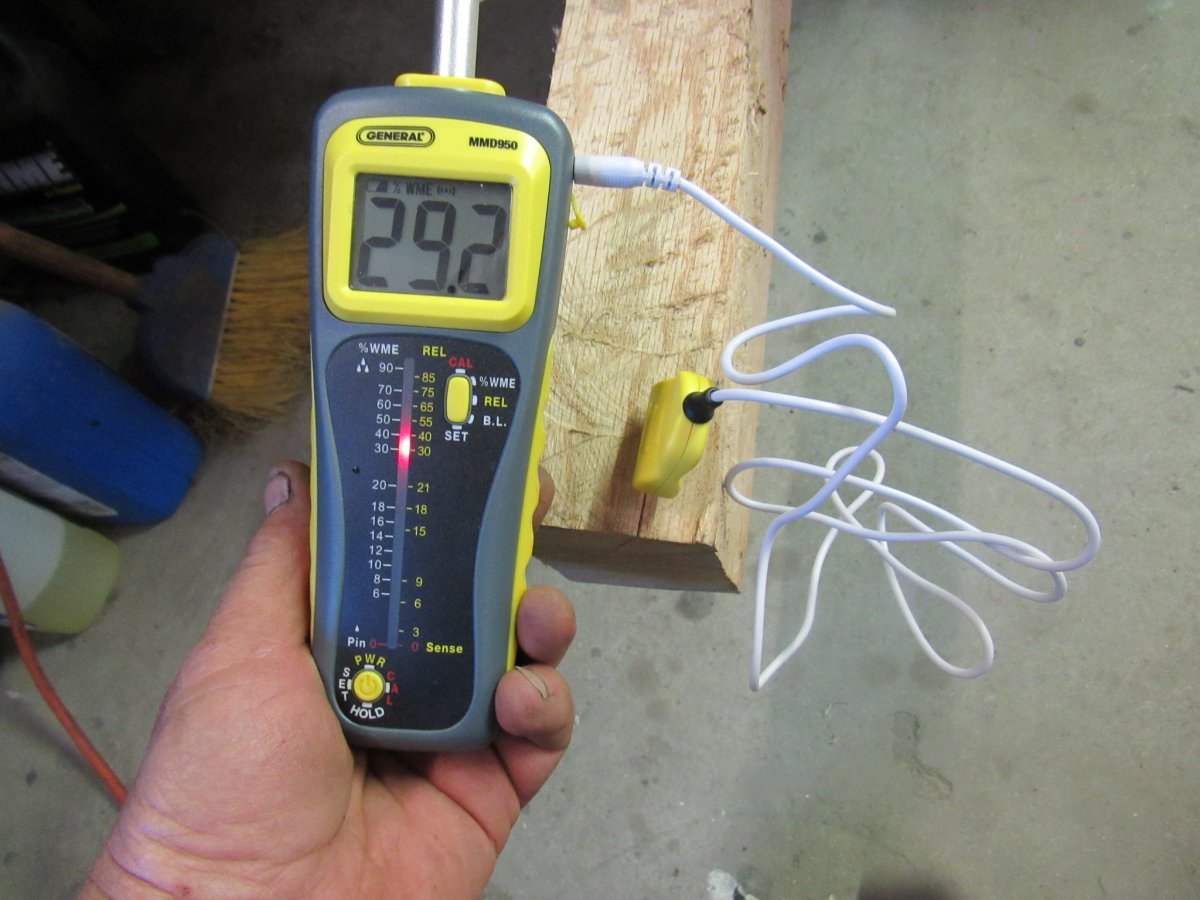

    Borrowed a moisture meter from @FolksWaggin and tested the wood to get some base numbers. I will check it again over the next couple months.
    it is weird that the piece I already installed has the highest reading. maybe because it is up against the metal? the piece I cut out next to it is lower than the rest of the timber.
    note the original piece is just over 12 percent.
  30. Stogy
    Joined: Feb 10, 2007
    Posts: 27,523
    Stogy
    Ones been dead a lot longer, different part of tree, different type of Oak? What do you figure?...
