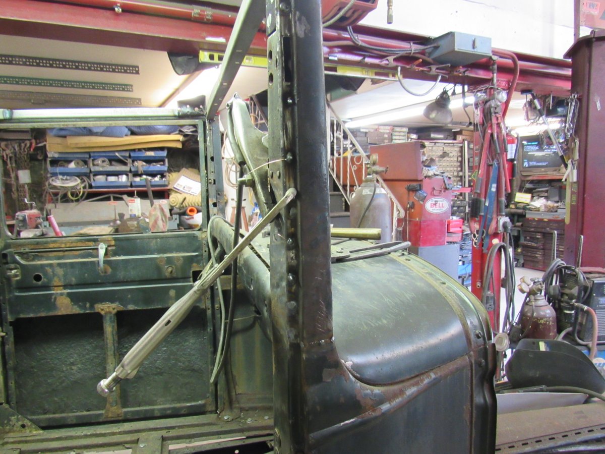

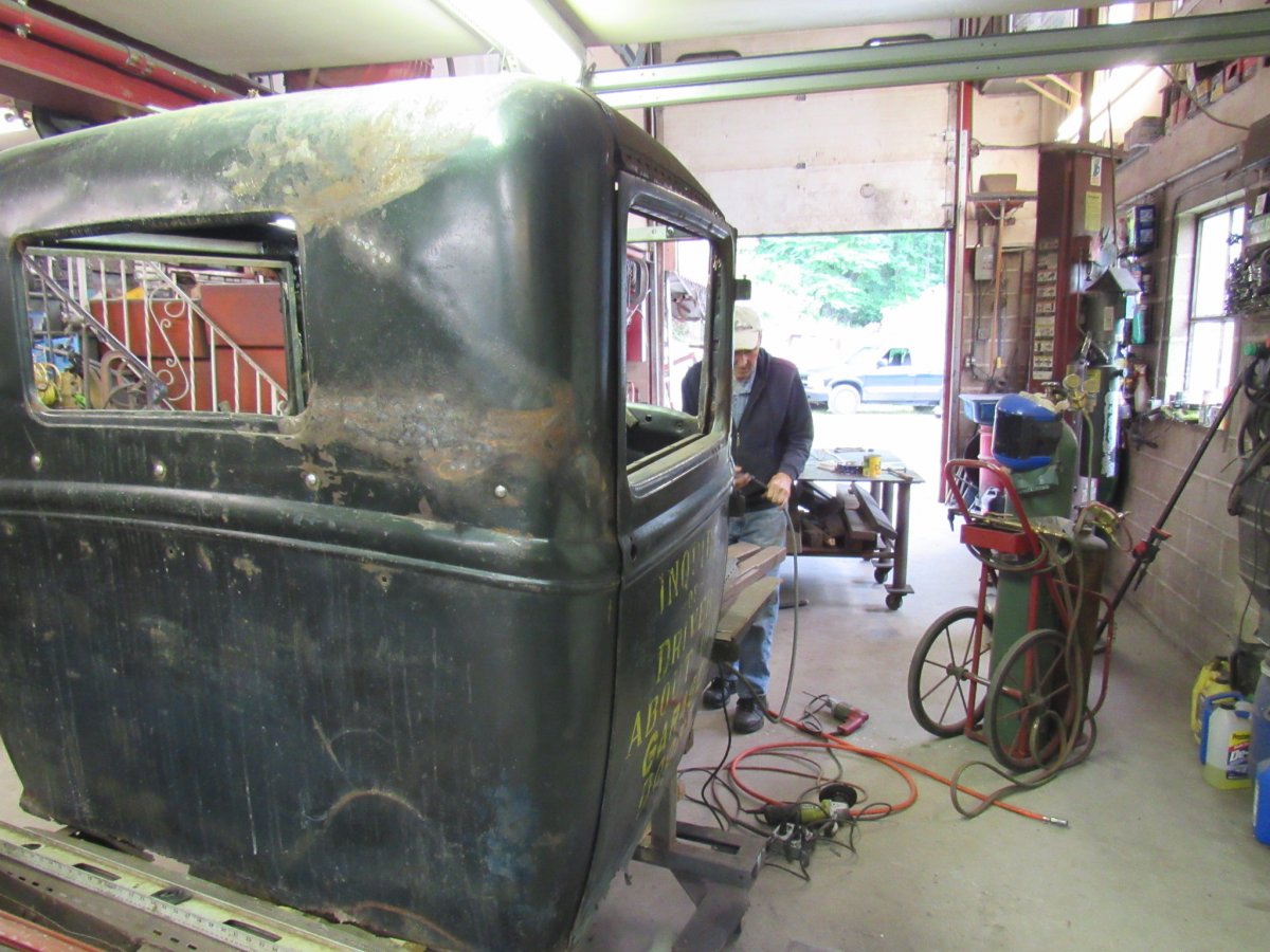

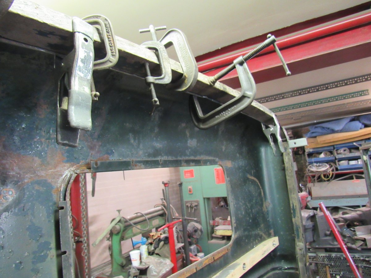

    Charlie and I spent the day working on the truck today. we made a piece of 10 gage to bridge the two rear pillars. we pushed the posts apart to get the right shape. this will be used along with a new piece of wood .we then jacked up the post on the p***enger side and cut a relief to take the bow out of it. matched the shape to the door and welded the cut back up. IMG_5597.JPG IMG_5598.JPG IMG_5599.JPG IMG_5600.JPG IMG_5602.JPG

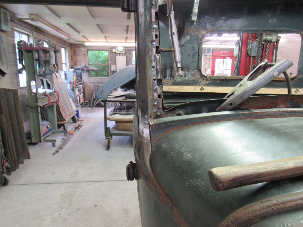

    we put the outer front post back on and then we made some angled pieces to connect the top of the windshield post with the back of the cab. this will hold the top of the door opening at the right width. we fit it to the doors. IMG_5603.JPG IMG_5604.JPG IMG_5605.JPG IMG_5606.JPG IMG_5609.JPG IMG_5610.JPG

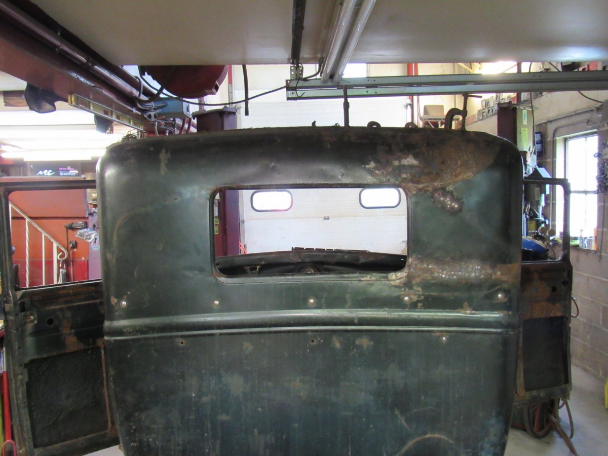

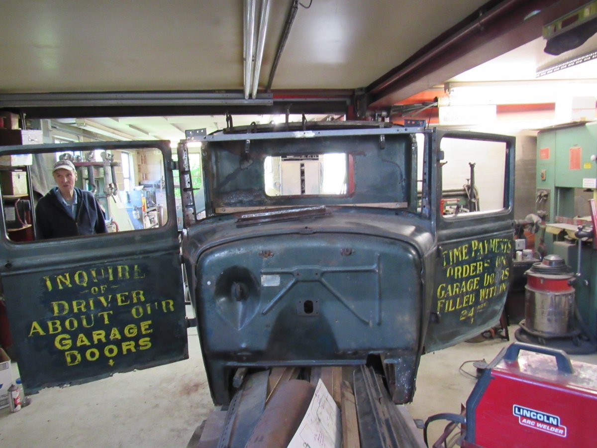

    cab is squared up and the doors fit well. we also did some more shrinking of the rear panel. IMG_5607.JPG

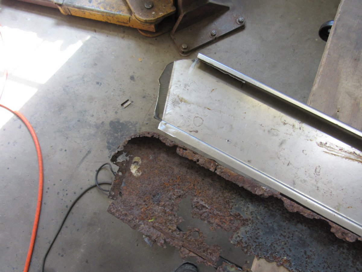

    worked on the cab this morning. Charlie was painting his patio so I was by myself. I ground the heads off the rivets holding the cross member and posed them out with the air punch. IMG_6631.JPG IMG_6632.JPG IMG_6633.JPG IMG_6634.JPG

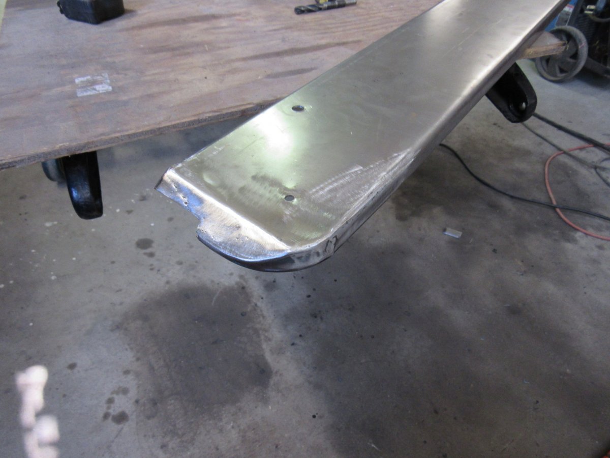

    once I got it out I matched it up to the one I had bent up. I made a template of the out side edges and cut them out. IMG_6635.JPG

    both ends are bent down to follow the sill so I bent the edges down. I then test fit the piece before making the curved edge. IMG_6638.JPG IMG_6639.JPG IMG_6640.JPG IMG_6641.JPG

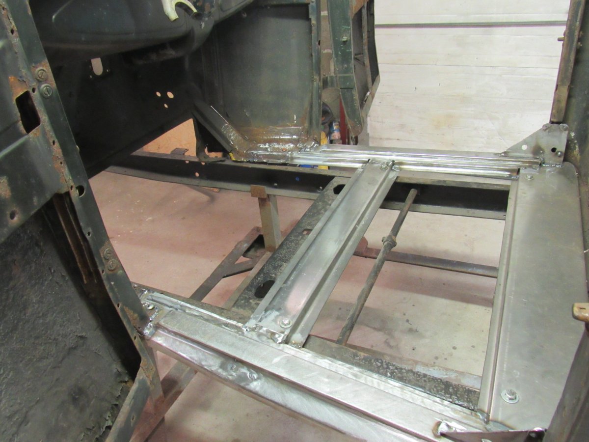

    tb33anda3rd

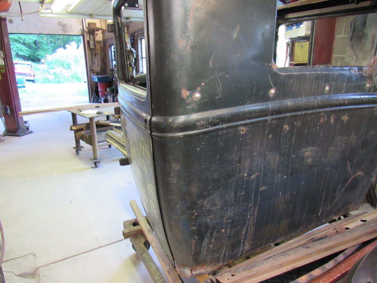

    so after I got the new rear sill in, I noticed the door on the p***enger side met the rear of the cab low. I thought I may have the sill mounted wrong or something not right under the post. the problem was the front windshield post. that door had a slight bind and the gap , even tho all the measurements were right, was tighter at the top and bottom than in the middle. the slight dip in the original rear panel compensated for the tilting door. there was a dent in the windshield post jamb, I decided to just cut it and pull the post straight, then re-weld it. IMG_6656.JPG IMG_6657.JPG IMG_6658.JPG
  27. tb33anda3rd
    Joined: Oct 8, 2010
    Posts: 17,591
    tb33anda3rd
    once that was back into alignment, I cut out the sill on the p***enger side and trimmed down the Tudor sills that were given to Charlie. once that side was fitted, tightened down and the door gaps checked, I made a new middle crossmember. I fitted the crossmember, tightened it down and checked the door gaps. gaps still looked good so I removed the driver sill, fitted, tightened and fitted it. IMG_6659.JPG IMG_6660.JPG IMG_6661.JPG

    tb33anda3rd

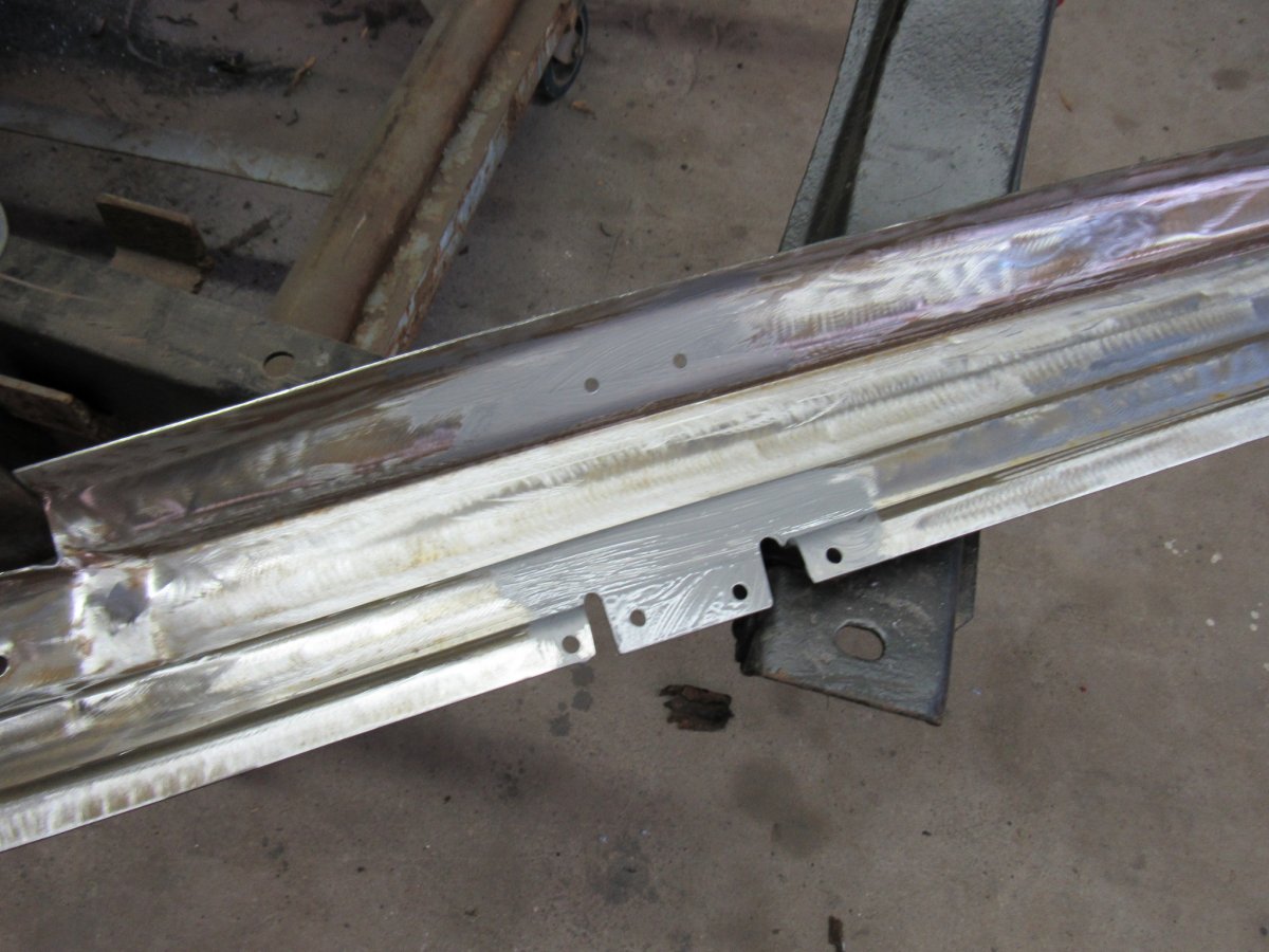

    charlie showed up after lunch and we took it all back apart. Charlie cleaned up the new sills and I cup brushed the mating surfaces on the body . I also removed the two rear post brackets and sand blasted them. we then brushed a weld through primer on all the mating surfaces. IMG_6662.JPG
    IMG_6663.JPG IMG_6664.JPG IMG_6665.JPG IMG_6666.JPG IMG_6667.JPG IMG_6668.JPG
  29. tb33anda3rd
    Joined: Oct 8, 2010
    Posts: 17,591
    tb33anda3rd

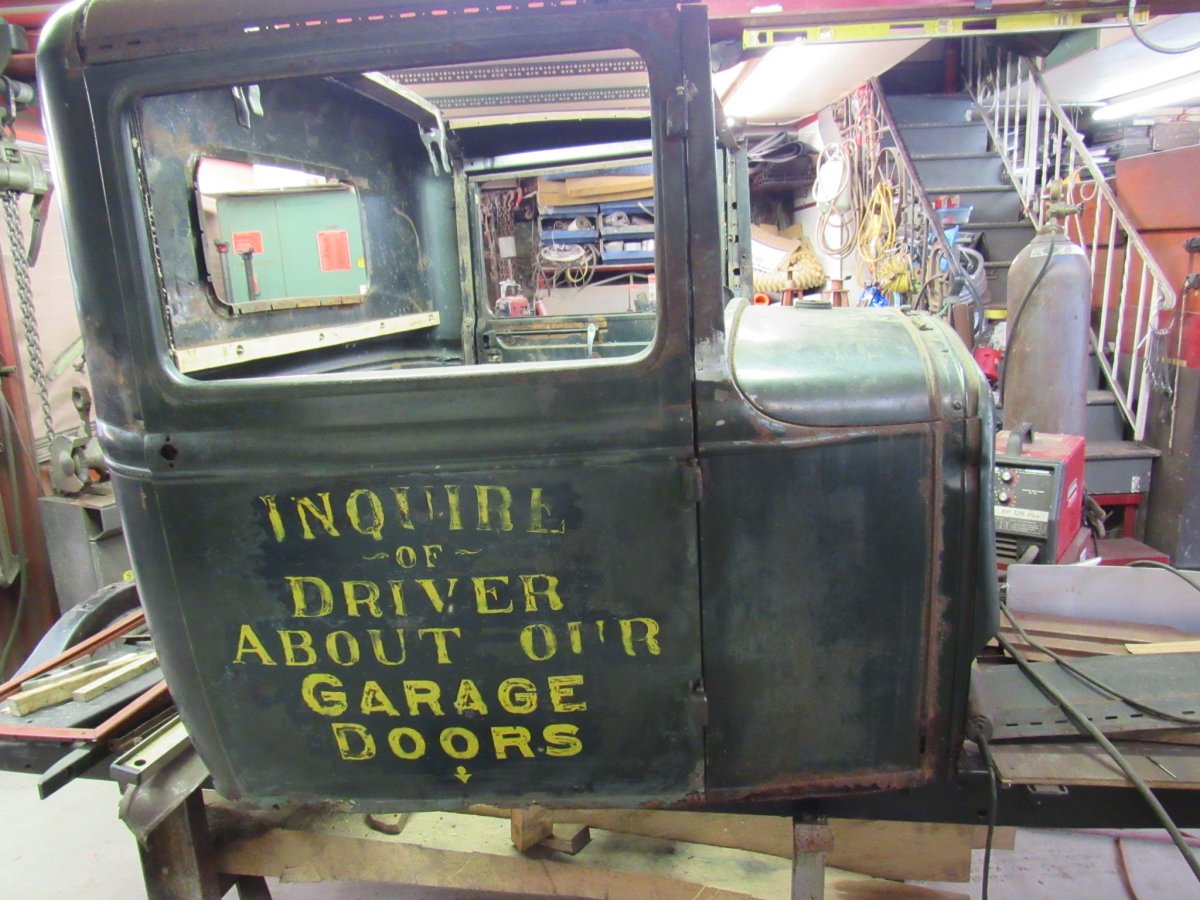

    we put all the pieces back on and fitted and checked all the gaps. I then welded all the joints. the truck is really solid now! IMG_6670.JPG IMG_6671.JPG IMG_6672.JPG

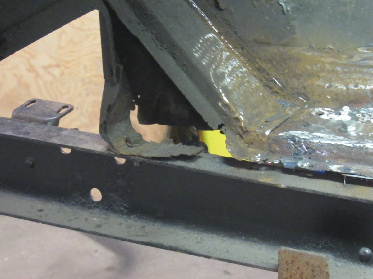

    tb33anda3rd
