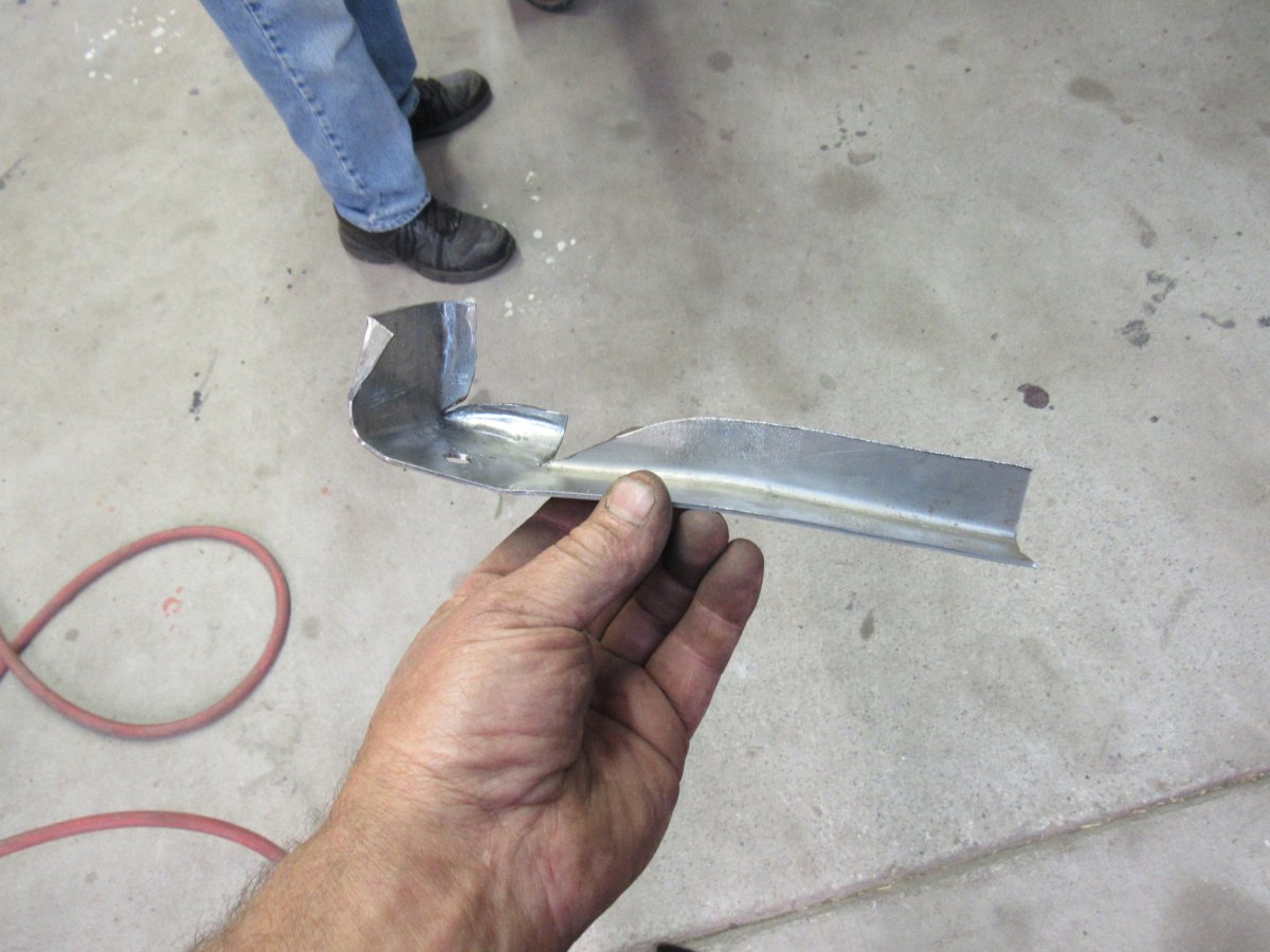

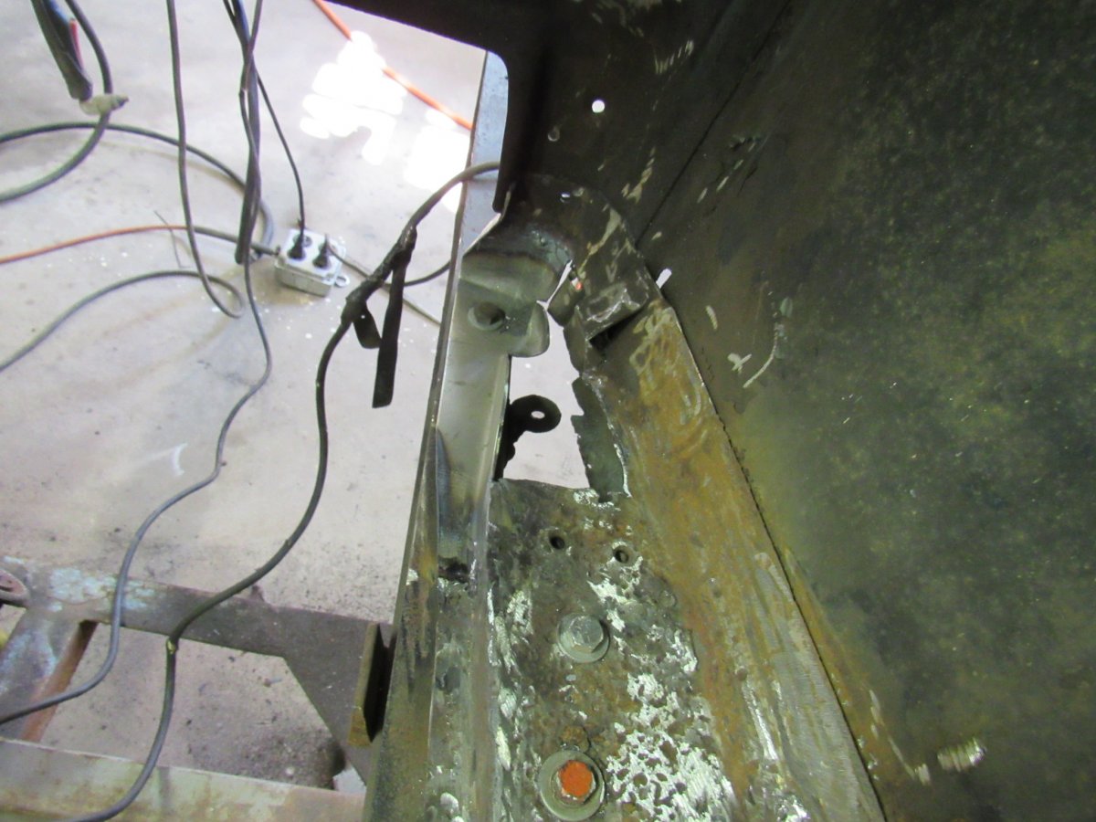

    Today me and Charlie fixed the front mounts. I started by removing the angled toe board braces. I then removed the rivets holding the inner brace, then cut out the rotted section. the front mount has a lot of different angles and bends so I needed to make it out of three pieces. here is a photo of the first piece. IMG_6675.JPG IMG_6676.JPG IMG_6677.JPG

    I bolted and welded the piece in and cleaned up the welds. IMG_6678.JPG IMG_6679.JPG

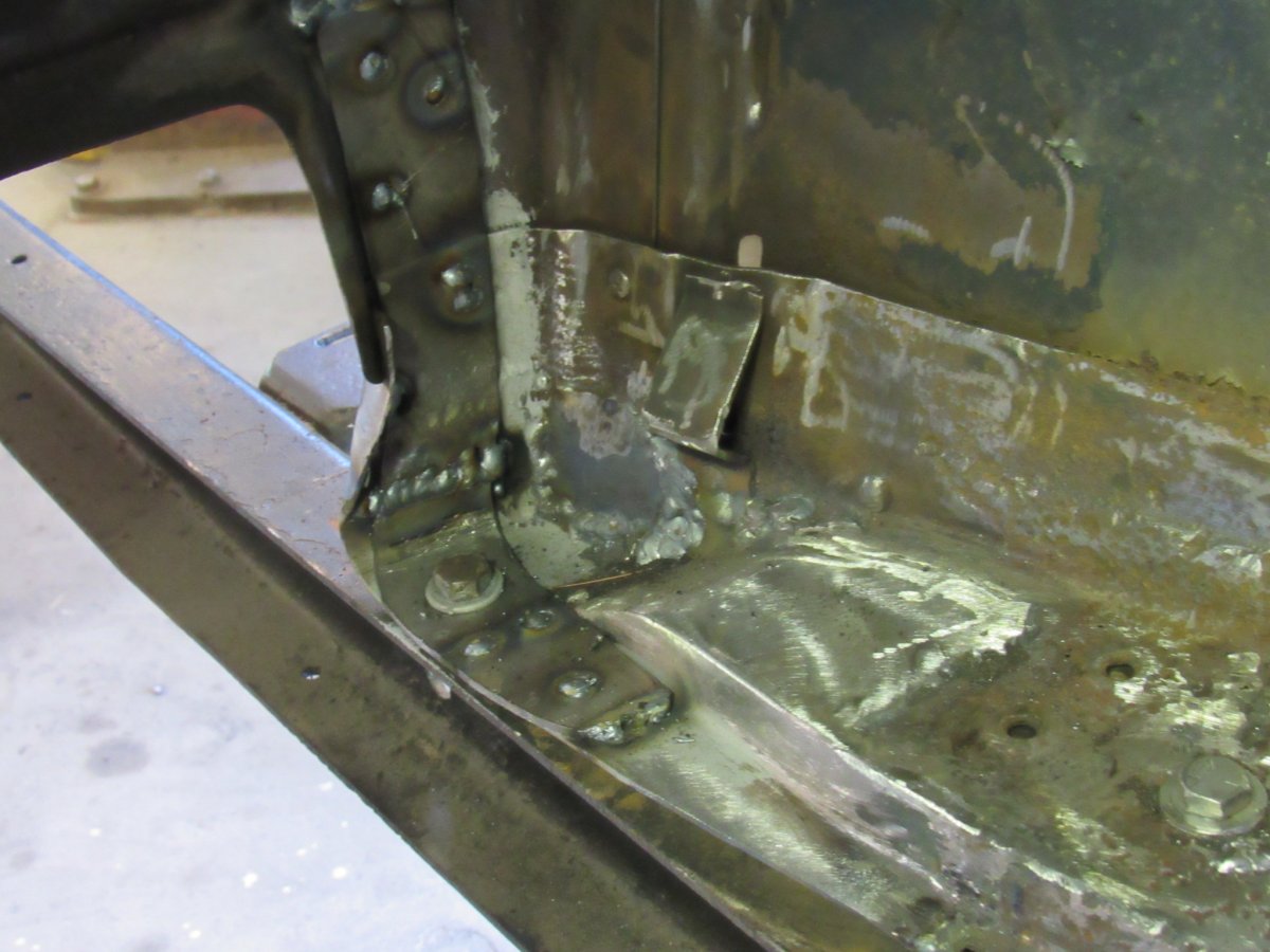

    I then put what was left of the inner brace back in and made a new lower piece and bolted and welded it in. IMG_6684.JPG

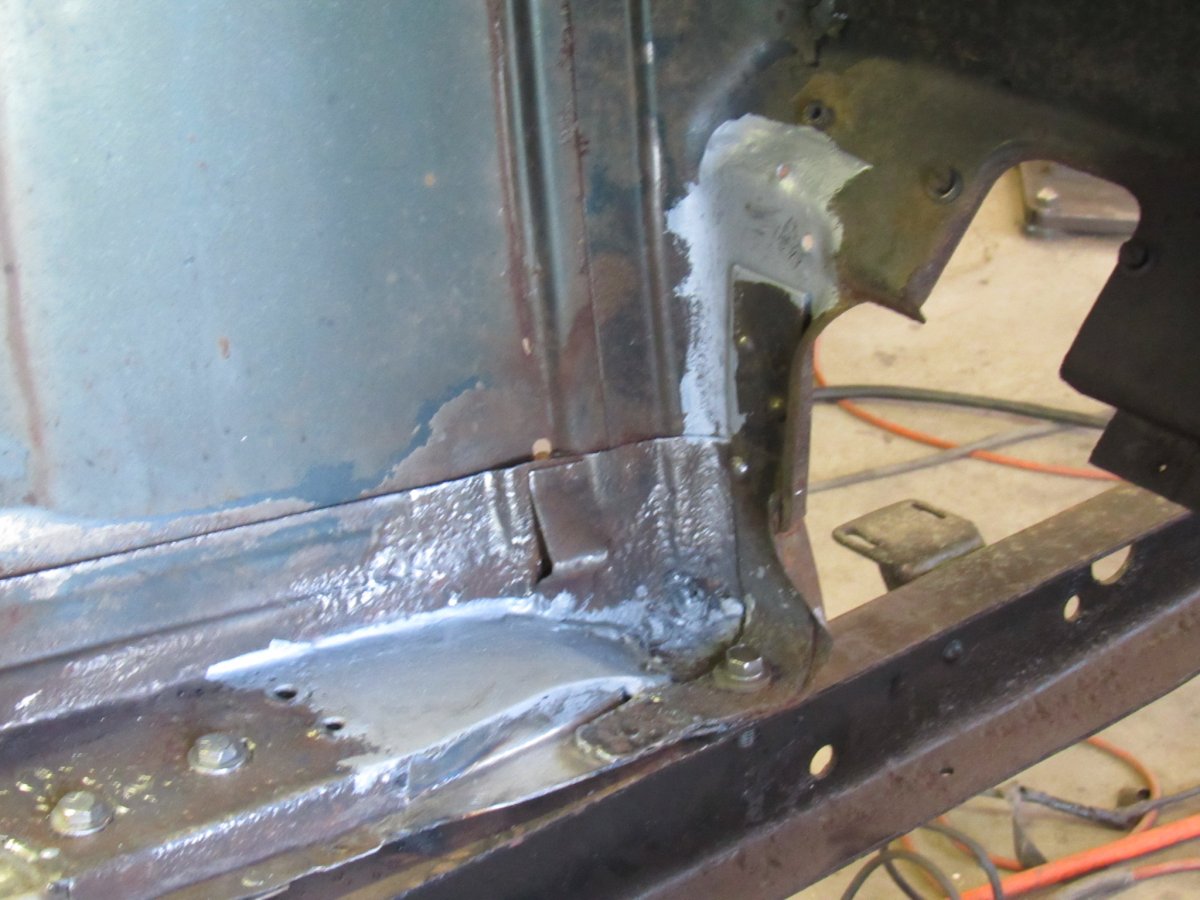

    the driver side was not as bad so I just bent the inner support up and cut out the rotted area. I then made the two pieces the same way. IMG_6682.JPG

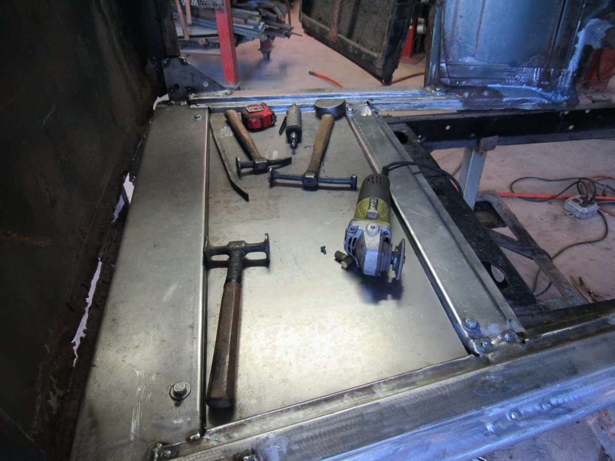

    while I was doing that Charlie was bead blasting the toe boards and made a pan for under the seat. we then coated all the mating surfaces with the "weld through" primer and welded them in. IMG_6685.JPG

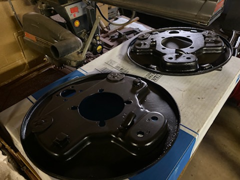

    we have been making some very slow progress. Charlie is working on backing plates and brakes, and he primed and painted a set of 36 wire wheels. I mounted a set of tires he had on them.
    I also had a job to replace a top header piece and filler on a model A truck. so I have a good template and some practice.:) IMG_7738.JPG IMG_7739.JPG IMG_7742.JPG

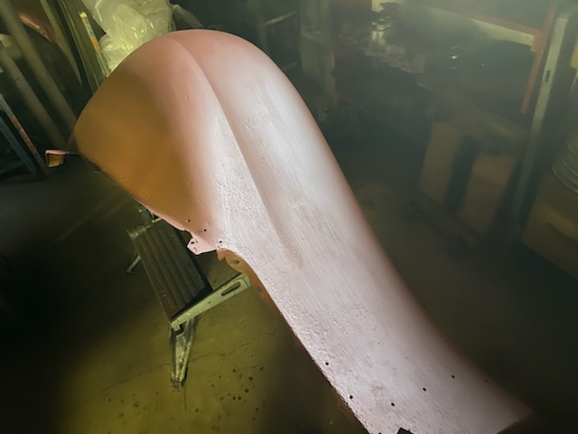

    I have done nothing with the body, but Charlie has been busy rebuilding, the ******. he has been cleaning the fenders and aprons and making patches for them. the axle and hubs are ready to go. IMG_0337.jpg IMG_0336.jpg IMG_0338.jpg

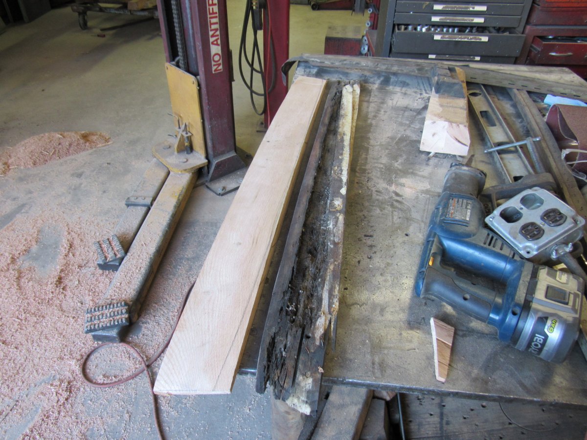

    I started prepping the chunks I cut to repair the top header. roughed them out with a hand planer and my skill saw. IMG_9508.JPG IMG_9510.JPG IMG_9509.JPG
