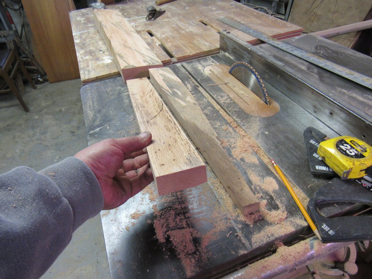

    so I did a quick re-enactment of the process I used to make the end pieces.

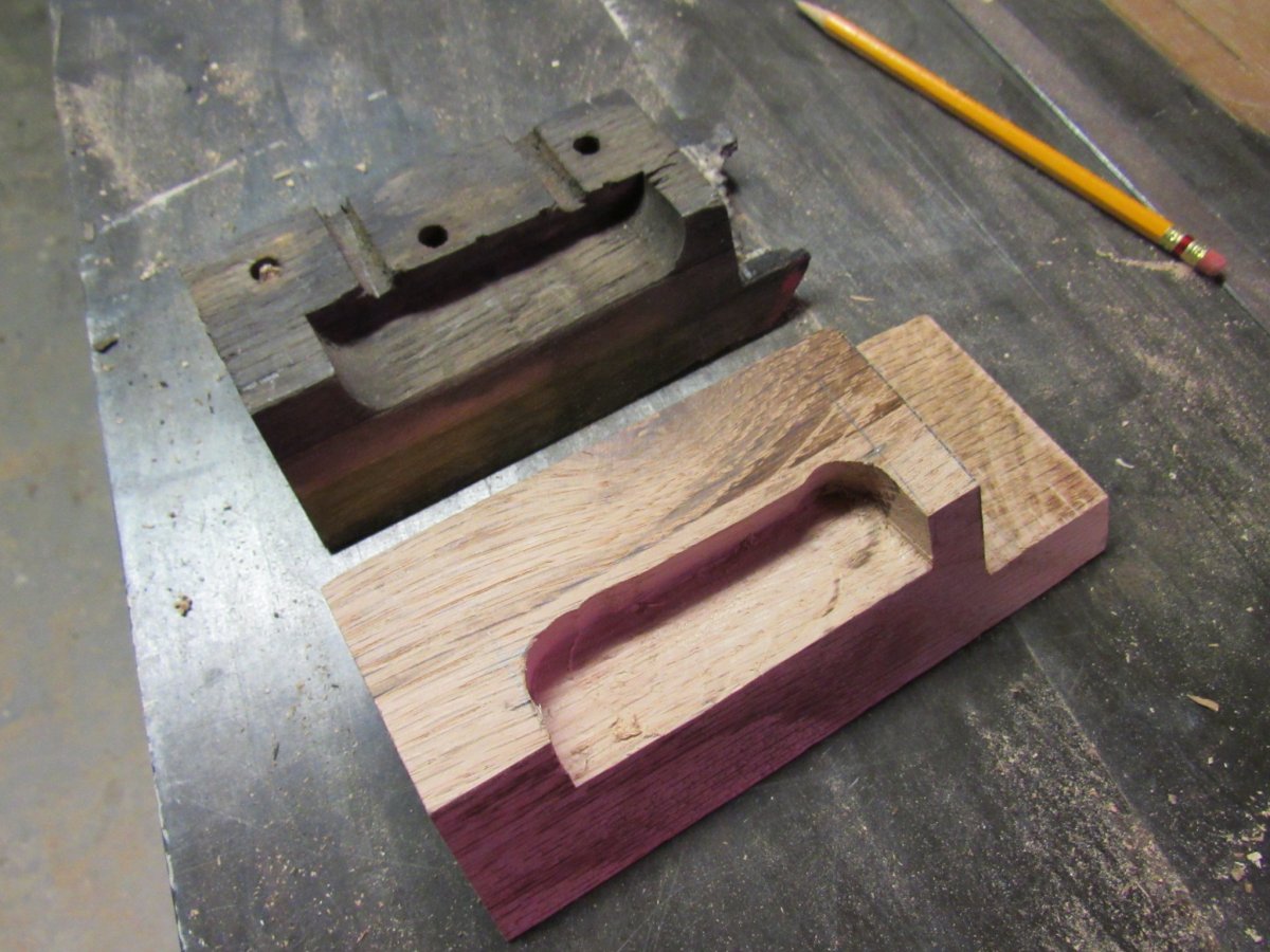

    I then cut the pieces to length on the chop saw and measured for the rabbet on the ends. they had to be done on opposite sides. I set the blade height and cut it using the sliding miter, then cut the chunk off with the band saw. IMG_9525.JPG
  7. tb33anda3rd
    Joined: Oct 8, 2010
    Posts: 17,591
    tb33anda3rd
    to cut the notch for the bolt hardware I used my home made router table. I made a mark where the board needed to stop and start and set the bit to the required height. I did it in a few p***es. the final shape of the ends will be done with the belt sander after it is on the truck. IMG_9527.JPG IMG_9528.JPG IMG_9529.JPG

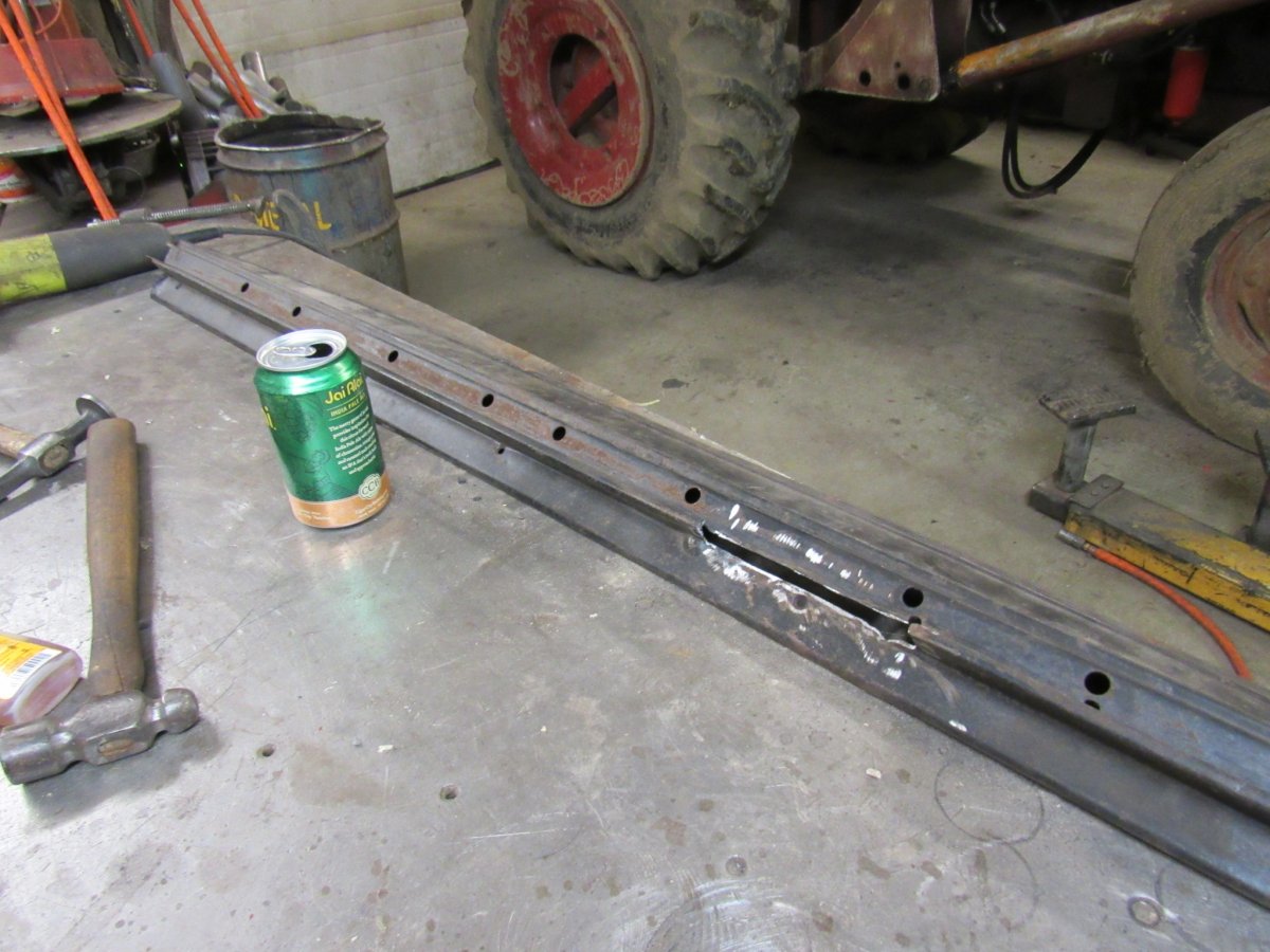

    glued and clamped up the header pieces today. still need to make a center block which I will do tomorrow.
    I also need to do a little more straightening and welding to the header and visor. IMG_9633.JPG IMG_9632.JPG IMG_9631.JPG IMG_9630.JPG IMG_9629.JPG

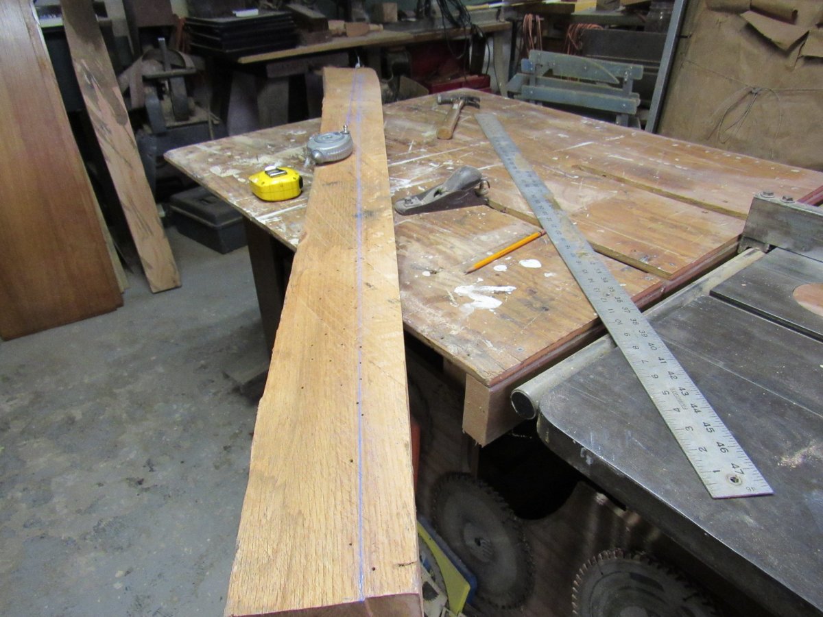

    this is how I have been making my dimensional lumber. I snapped a straight chalk line. then cut it using the home/kit built, band saw Charlie picked out of the dump. IMG_9634.JPG IMG_9635.JPG

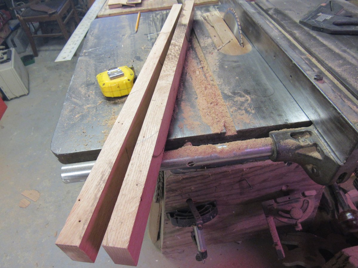

    I cut the piece I cut off in half to make the two pieces that will go above the door. I then cut it to size on the table saw. finished board on left. IMG_9636.JPG
    Stogy, Ron Funkhouser, brad2v and 9 others like this.
  14. tb33anda3rd
    Joined: Oct 8, 2010
    Posts: 17,591
    tb33anda3rd

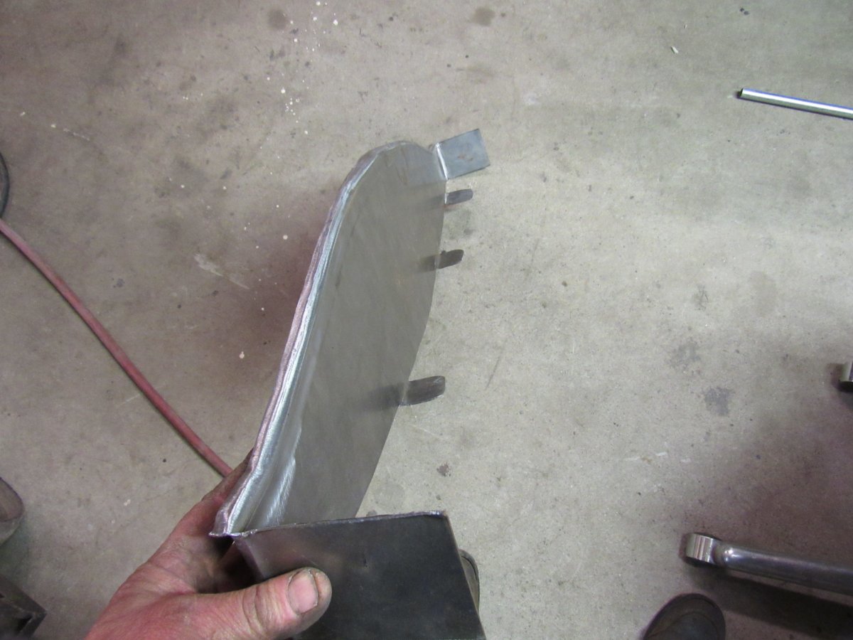

    I straightened and patched the header cover. I squared up the corners and edges and bent a piece of sheet metal to fit. I used my brake to start the bends then used my vise to finish the bends. fitted and welded it IMG_9647.JPG IMG_9648.JPG IMG_9649.JPG IMG_9650.JPG IMG_9651.JPG IMG_9652.JPG in.

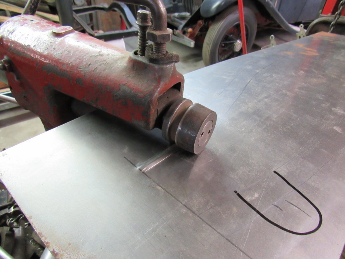

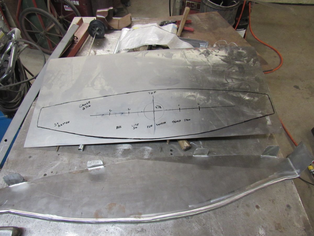

    Charlie and I have been socially distancing so we have not worked on anything together. he wanted me to make a dash panel so he could paint it and put it together at his house. he dropped off a template and a piece of 20 gage sheet metal he marked up. his plan was to cut out the gage side of the fuel tank and screw this to the tank with his gages in it and still look like the original tank [sort of]. I decided to make a few changes I think he will be happy with. his panel did not go all the way to the door jamb and the bottom edge would have been just cut out. I also decided to do it in 18 gage. IMG_9775.JPG
  21. tb33anda3rd
    Joined: Oct 8, 2010
    Posts: 17,591
    tb33anda3rd

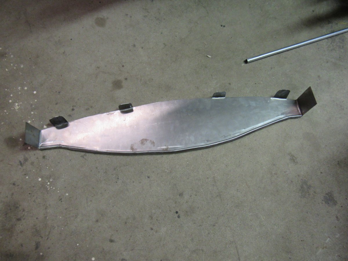

    I retraced out his design on a longer piece, and allowed enough to make bends on the sides and tabs at the top to use the tank bolts to hold it in. I then bead rolled the lower edge and cut it out leaving about a half inch extra along the bottom edge. IMG_9776.JPG

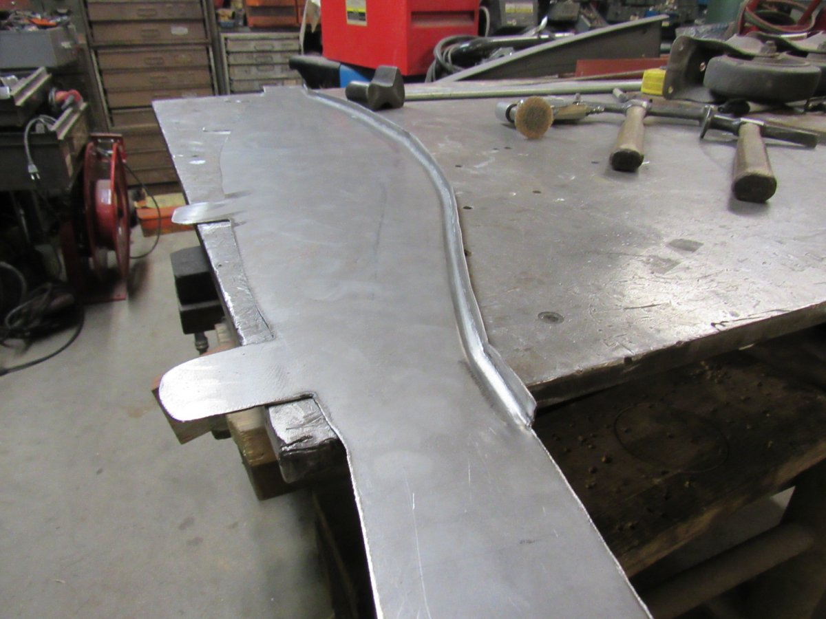

  22. tb33anda3rd
    Joined: Oct 8, 2010
    Posts: 17,591
    tb33anda3rd

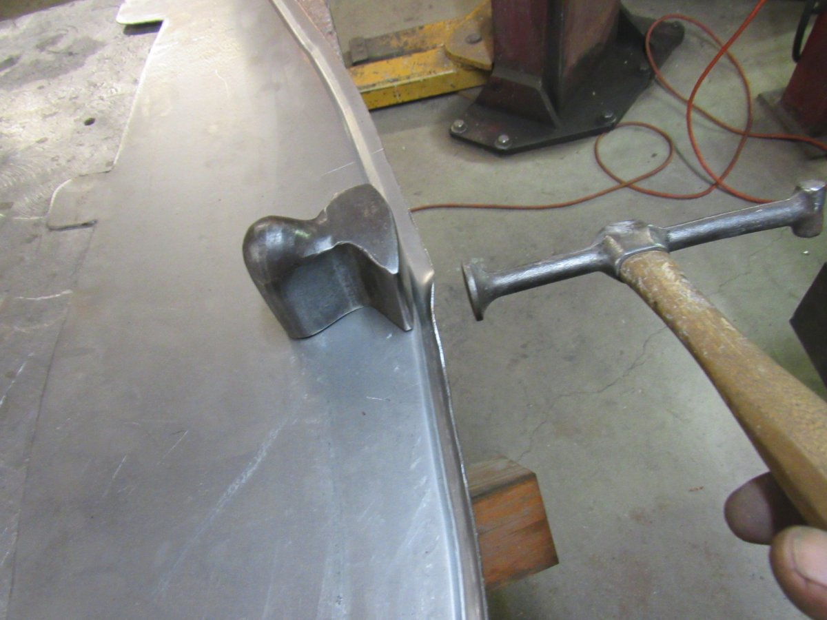

    I then hammered and dollied the bottom edge over to form a return to stiffen up the panel. I then cleaned up the edges. IMG_9779.JPG IMG_9780.JPG IMG_9781.JPG IMG_9782.JPG
  23. tb33anda3rd
    Joined: Oct 8, 2010
    Posts: 17,591
    tb33anda3rd

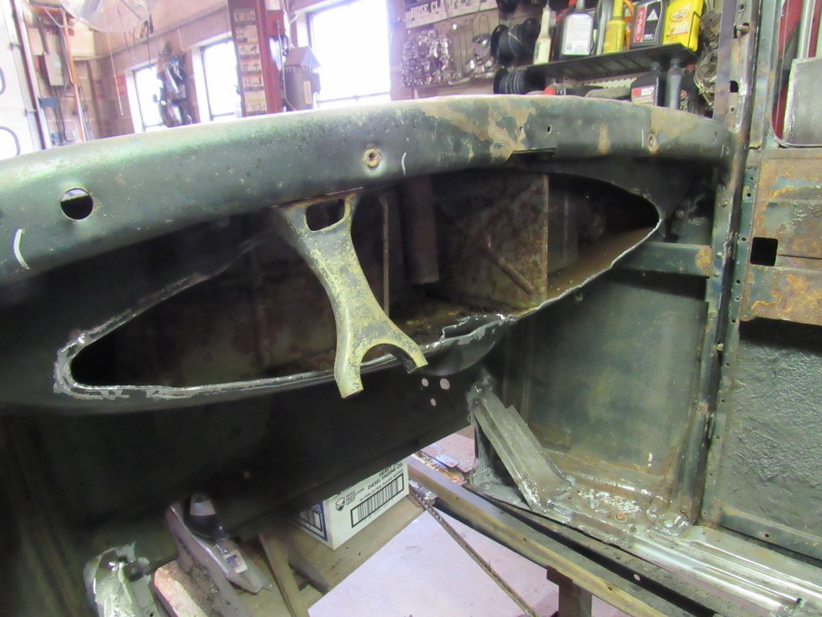

    cut open the tank to make room for the gages. about 3/4 of an inch of crud. IMG_9789.JPG IMG_9790.JPG

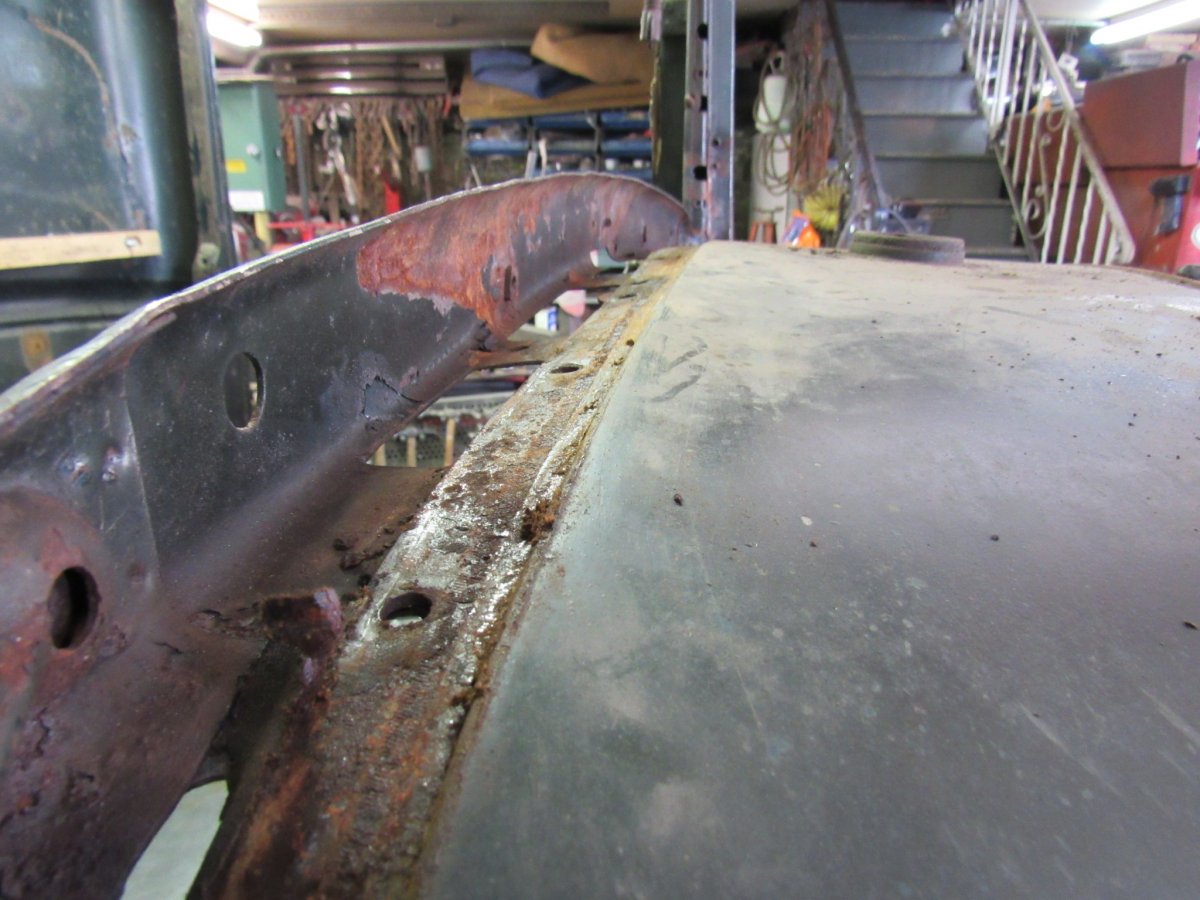

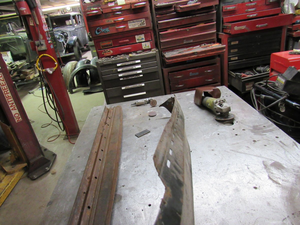

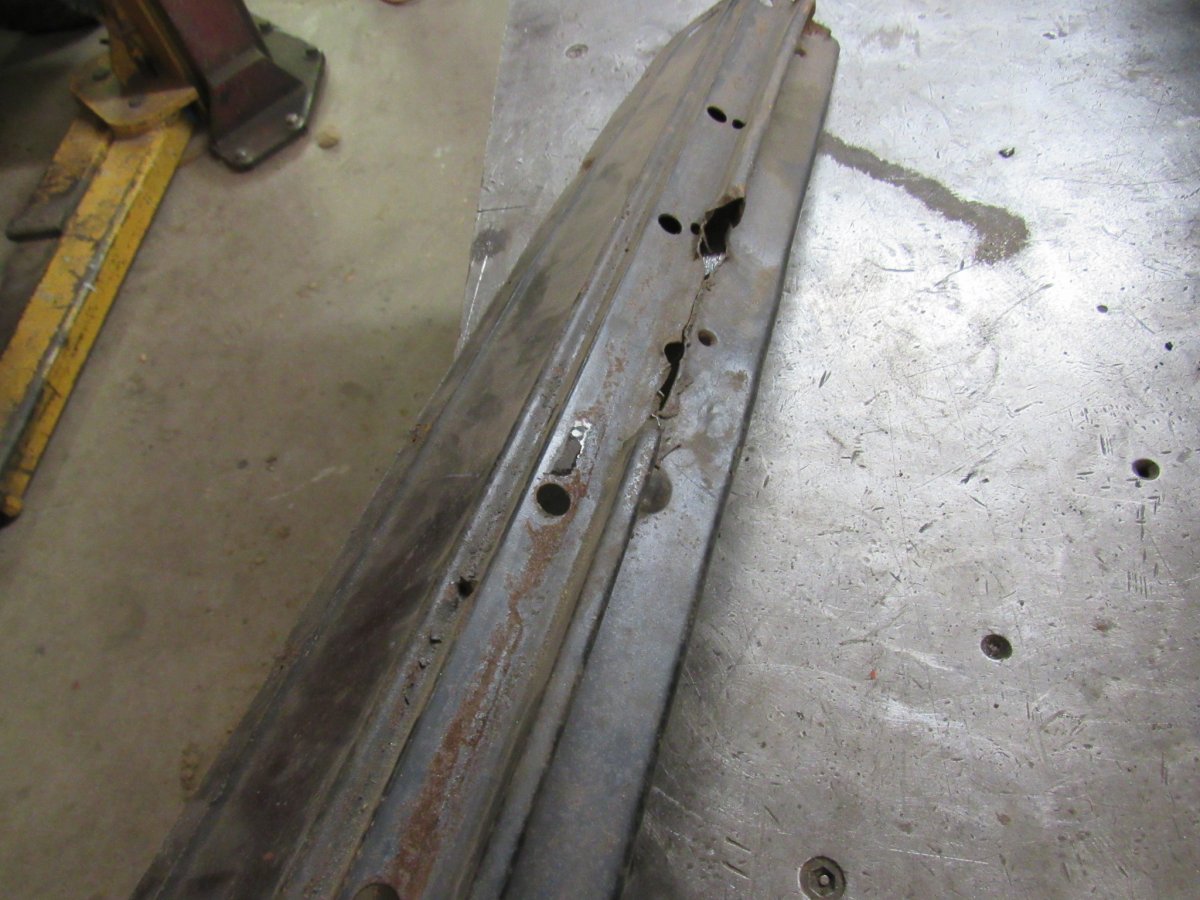

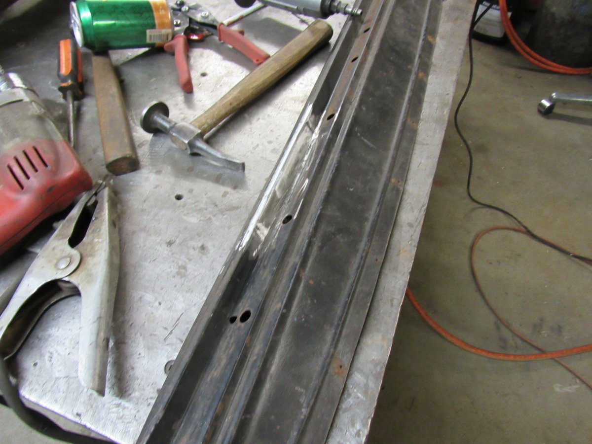

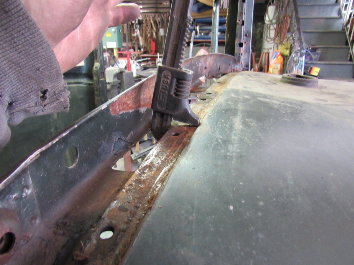

    today I removed the rail under the windshield, fixed a couple of the trapped nuts, and sandblasted the back side and bottom. I noticed the edge of the tank was bent down. I always wondered what those wrenches were for. :);)I then put a coat of rust shield on. I also cut the rest of the tank out. IMG_9791.JPG IMG_9792.JPG IMG_9793.JPG IMG_9794.JPG IMG_9795.JPG
