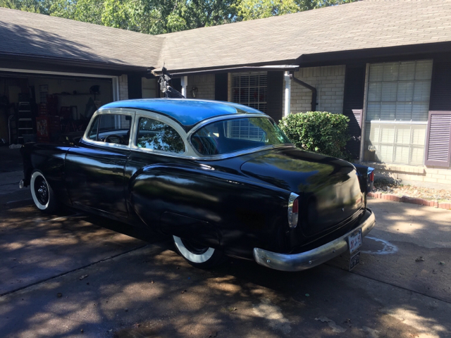

    Guys I have a 54 belair (pic enclosed) it sits on a zee frame. Front discs, the whole 9.. it's boxed and ladder bar set up in rear..
    I got the car as this. Built 502 BBC and geared.. I've checked the frame and it seems straight and doesn't look twisted.
    Body mounts are new. Bushings are new
    I rebuilt the hinges and done everything I can do..
    Initially I figured the body twisted. And it could have. My question is
    Does anyone know what I can do to make my doors sit right?..
    They sit about 1/2 out on top of one door and bottom of the other.. twisted obviously..
    anyone know a trick to untwist a body?

    Does the body actually look twisted? Can you run a spirit level across the front and rear fenders, screen frame, or across anything that is fixed and integral to the body? It might be easier to modify the doors, if the body is sitting flat and square to your frame.
    I once had a Nova that was twisted visibly on the front end, you could see it plain as day if you hunkered down in front of the car, but the body/door seams and all were dead parallel and square. I ***umed someone had wrecked it some day and just fitted and filled the panels to suit, without squaring the front of the frame up.

    show some photos. i bet it isn't twisted the doors and maybe the nose just needs to be aligned correctly. you may need to shim the doors or bend them to fit.
    57JoeFoMoPar and loudbang like this.

    before twisting anything, ALL the alignment issues need to be studied. fixing one spot by twisting or bending may make fixing the next panel down the line impossible. as mentioned b pulling the bottom of the front of the door out m,ay solve the problem without bending the door. i have seen cars that the nose was aligned to the door but the door wasn't aligned to the rocker/quarter.
    please post photos of all the gaps.
